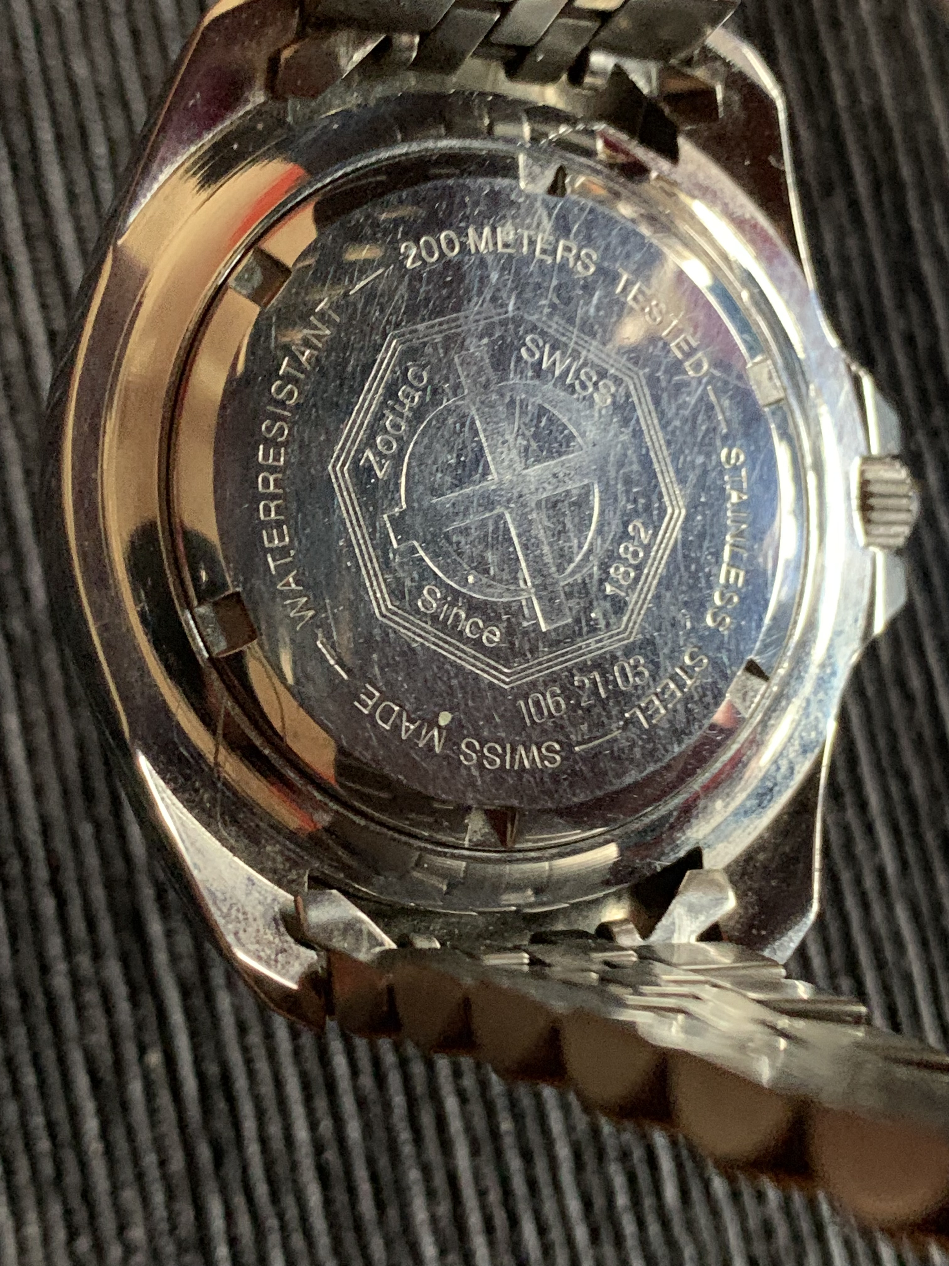

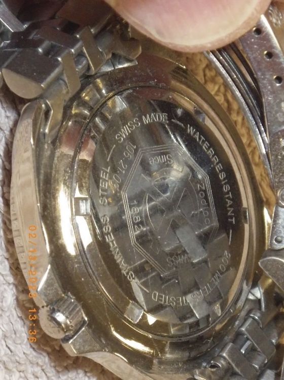

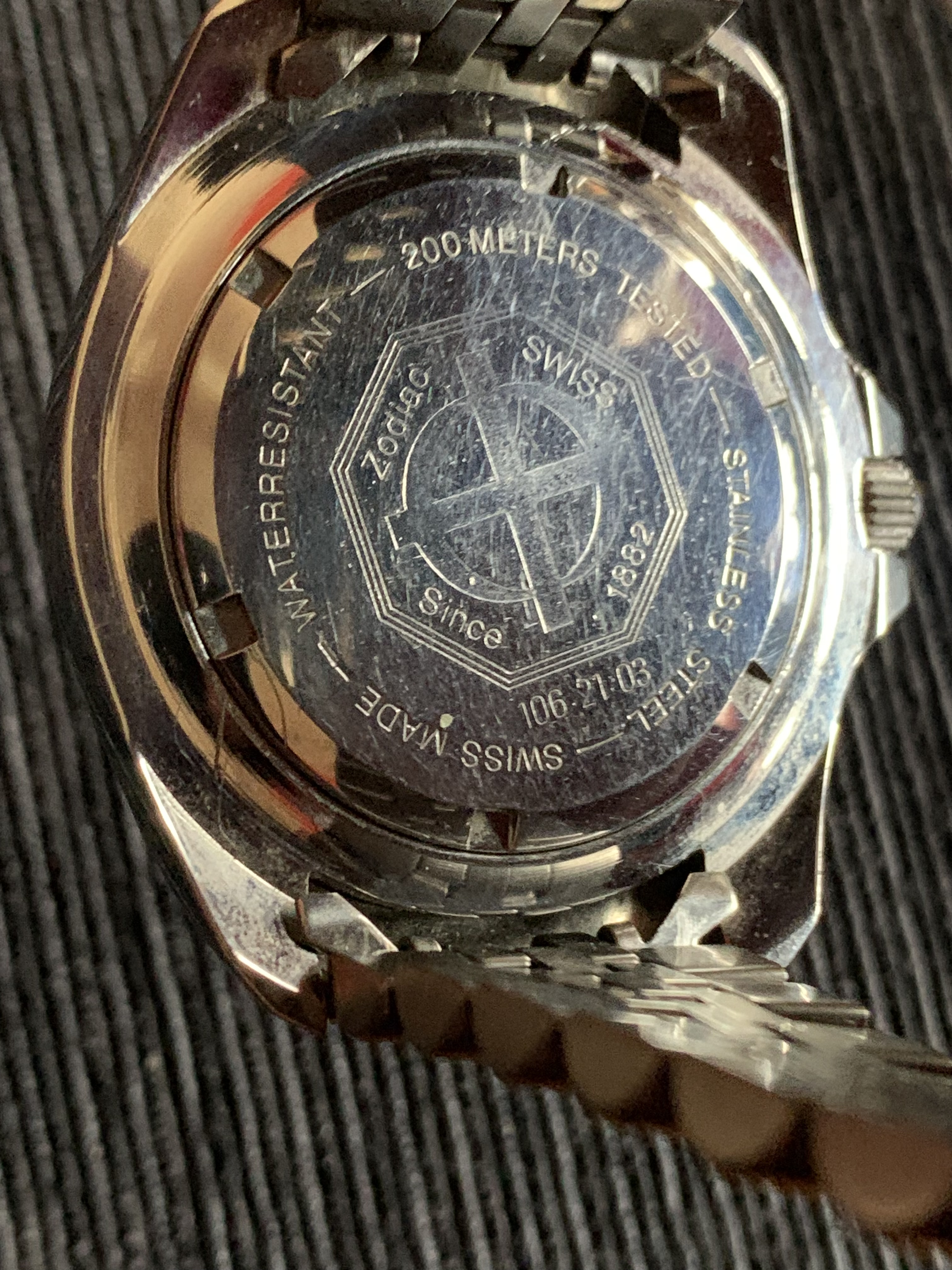

My forthcoming caseback below

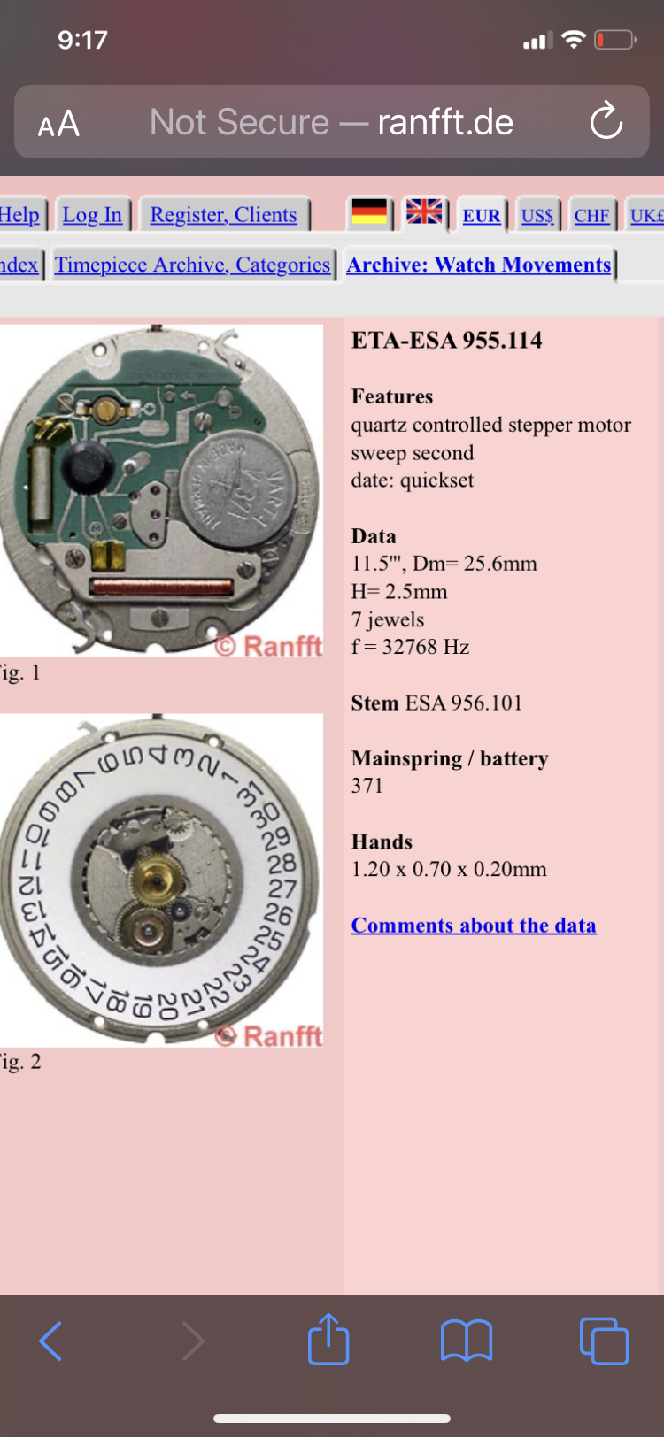

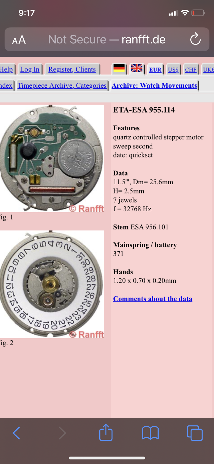

The quartz movement that’s in this watch is the eta 955-114.

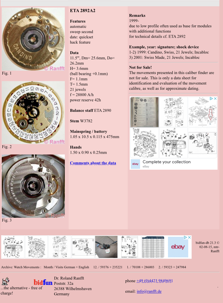

Since the 2824 is double the thickness of the quartz 955 and the stem position possibly being different, it won’t work with this case & factory back (perhaps an aftermarket exhibition case back??). But doing a little reading it appears the eta 2892-2 or A2 may work as they are slimmer than the 2824 by 2mm
Has anyone had experience with this kind of swap? I wouldn’t do this myself but rather have my watch handy friend undertake the project as this is right in his wheelhouse- but he has never done a quartz-mech conversion so want to be armed with info.

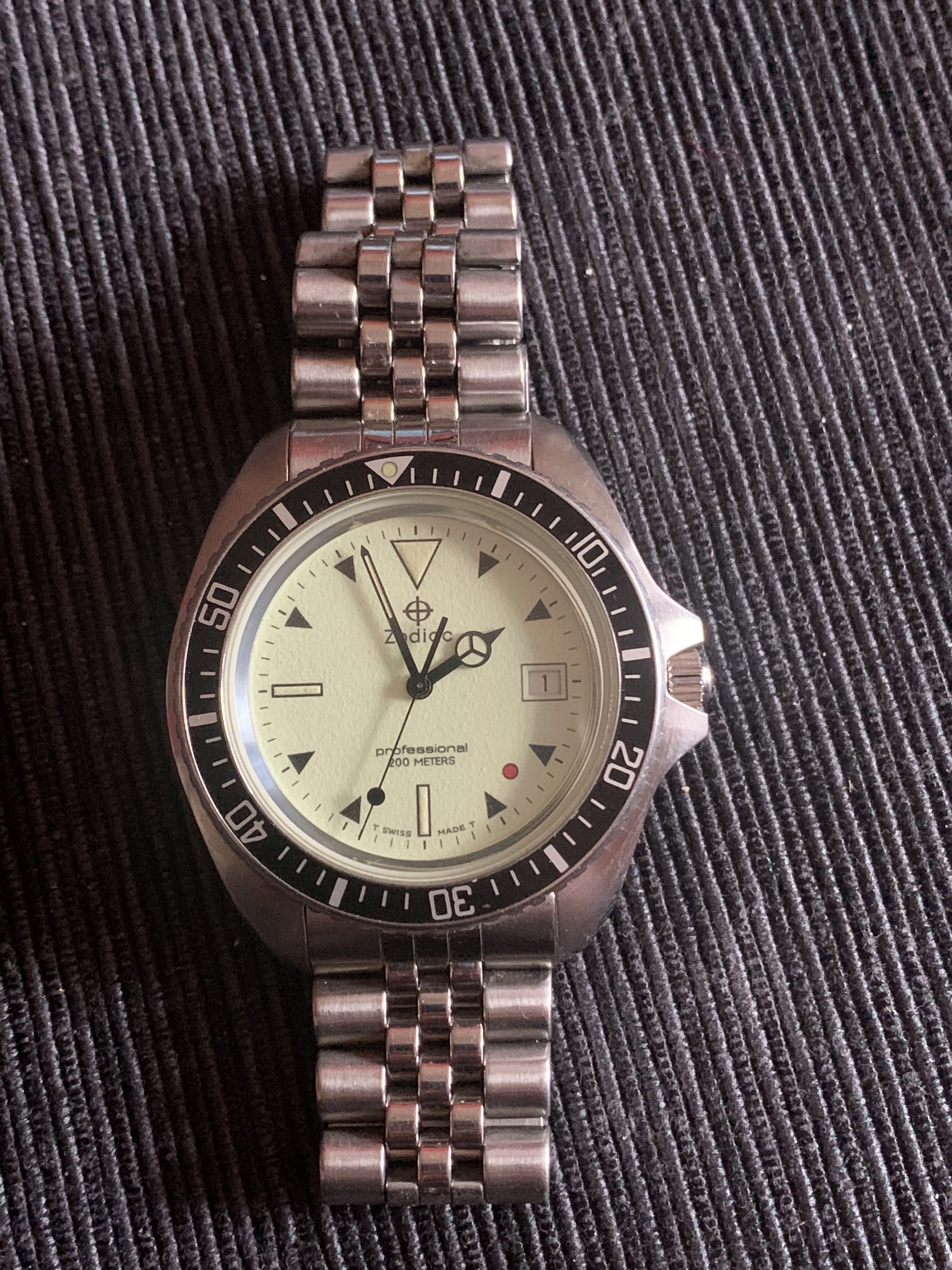

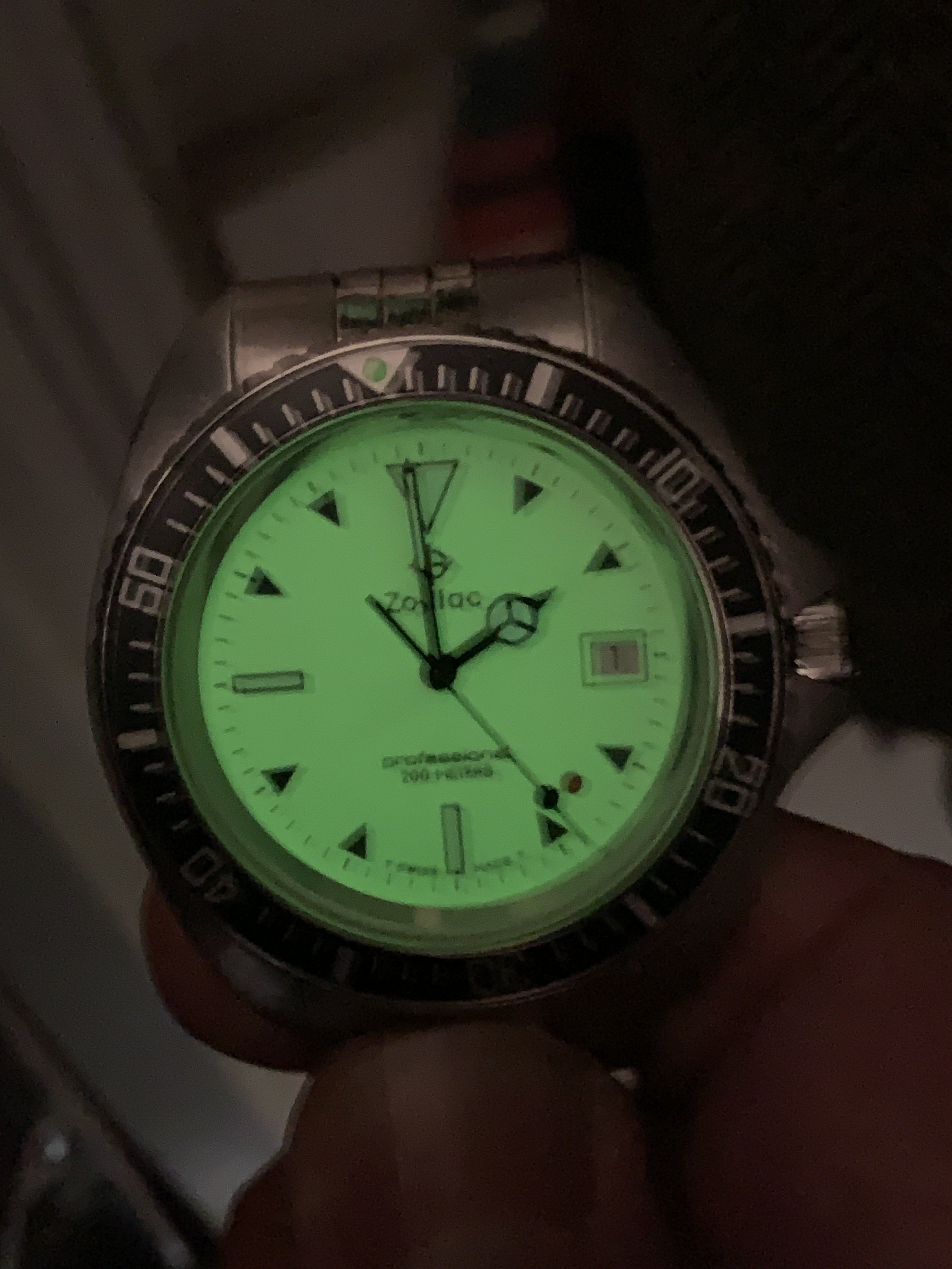

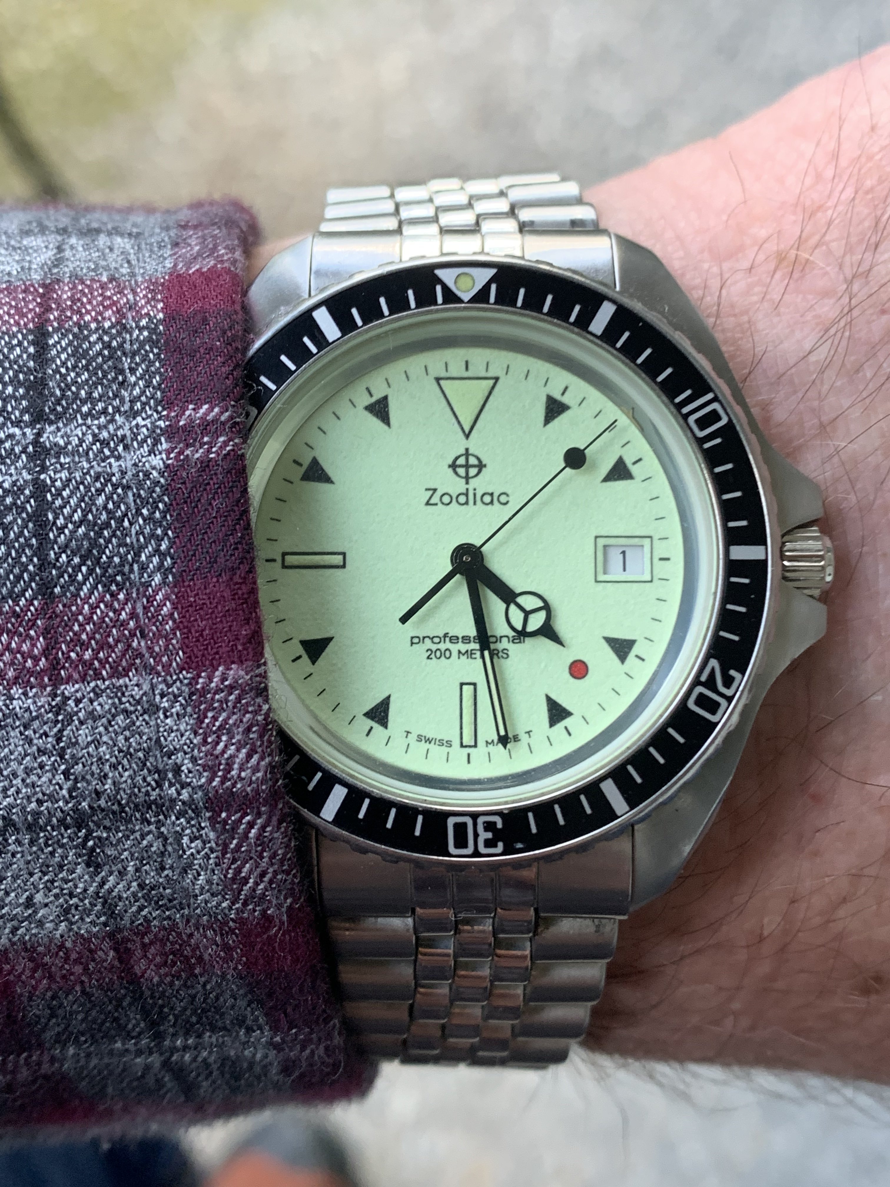

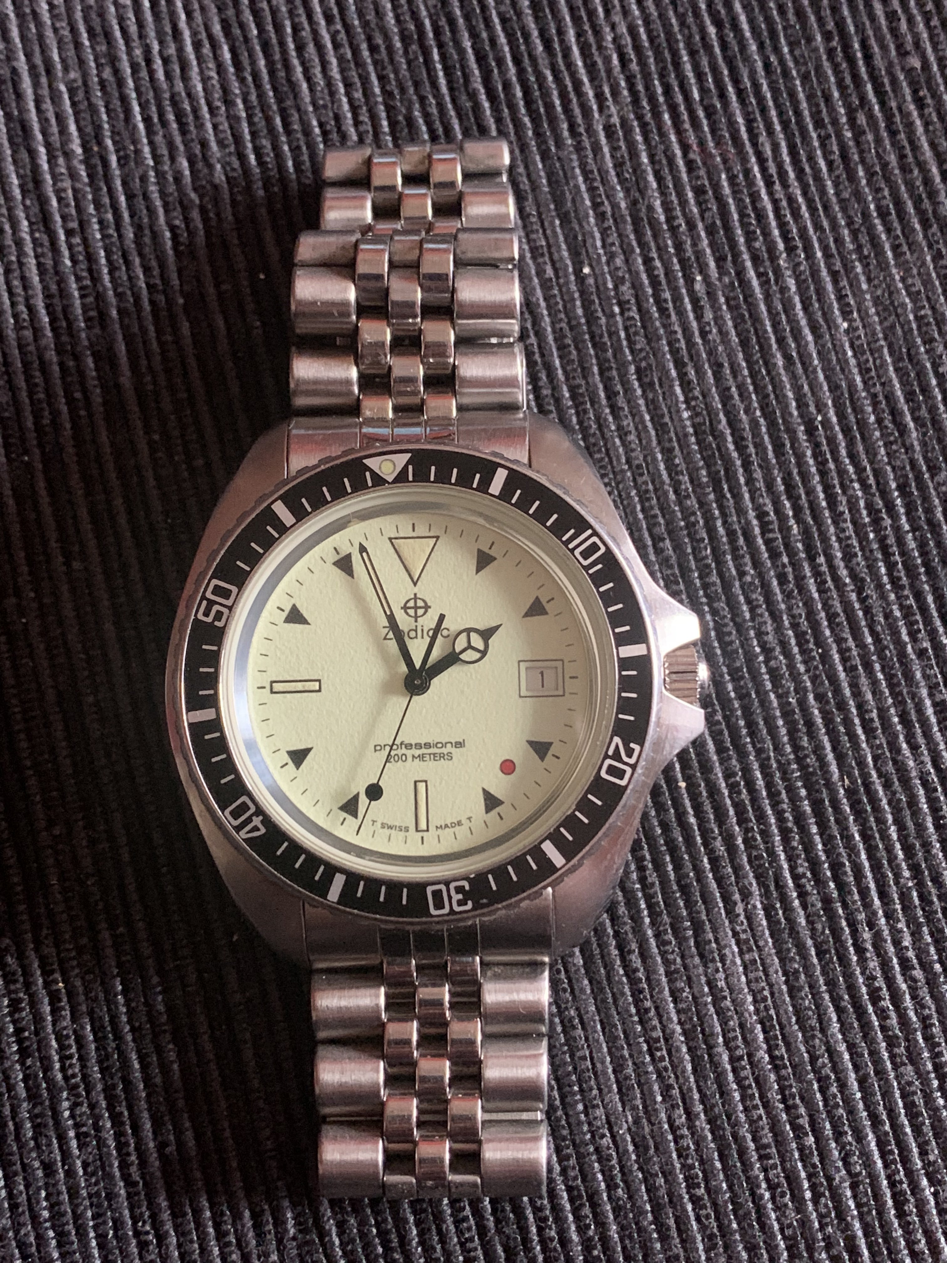

Watch arrived today- it’s stunning. Truly a time capsule and looks like a 1 year old watch with desk diver duty.
850
3,468
Looks like it has been kept in a drawer for all these years. Congratulations!
