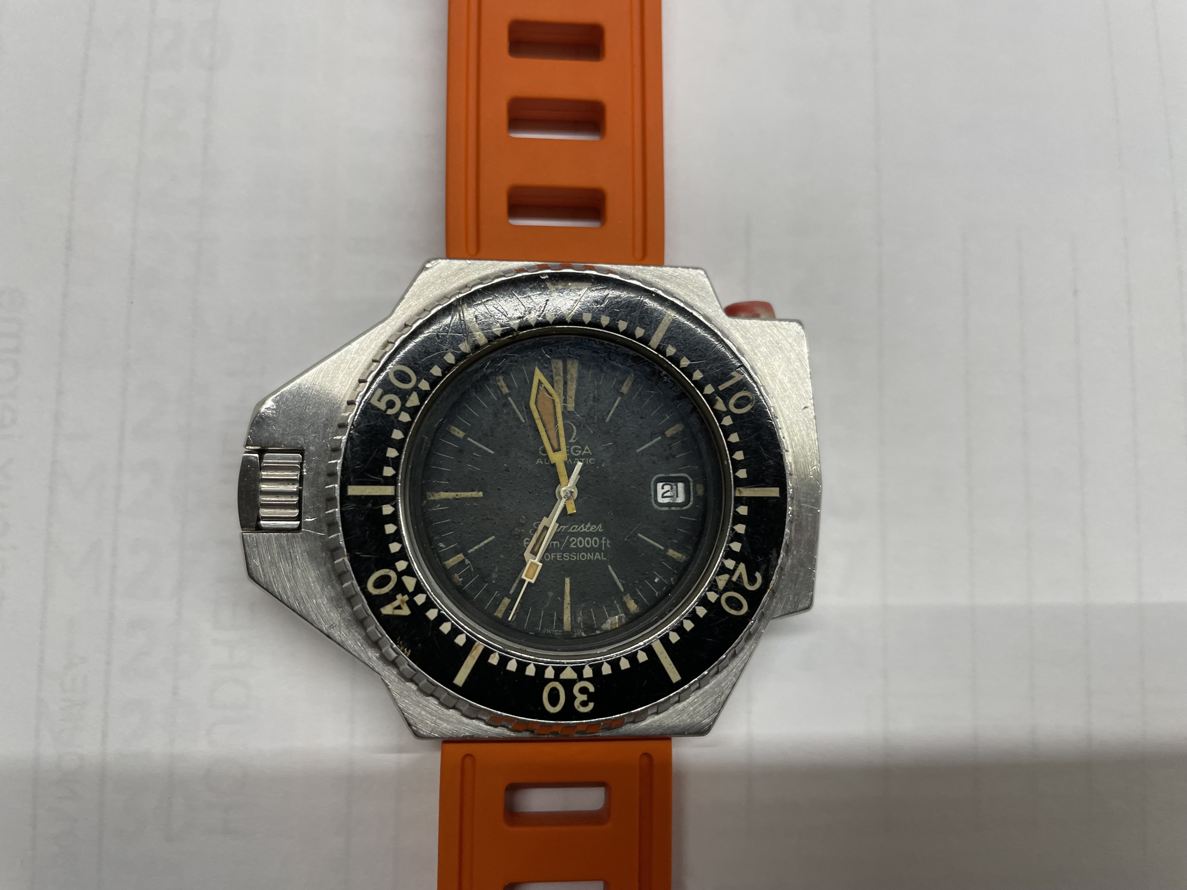

I have just had the same problem.
The old gasket glues the step ring to the case and movement so this is what I did.
I pulled the crown out (split stem) and then got a small steel rod with a small curve on the end, I pushed it down the case tube and gently levered the step ring up from outside, it was solid at first, I found putting the watch face up on a warm radiator for 5 minutes helped ease things up a little. Take it slowly and gently.
My brass ring had lost its black in a few places so I brushed it with a fibre pen and then dropped it into Brass black which turned it back to black almost instantly. The finish it just like factory now. If you have dings on your step ring use wet and dry on a very flat surface to get them out, sanding in a circular fashion is best, clean it furiously with a fibre pen and finish with panel wipe, then drop it in brass black.
The gooey gasket had got onto the movement and even on the date wheel stopping it working correctly. It cleans off with gentle perseverance.
The gaskets on your watch look drier than mine so a tiny bit of silicone free lube might help on the outer edge of the ring furthest away from the dial, I would be very careful though.
Good luck and show is when you finish please.

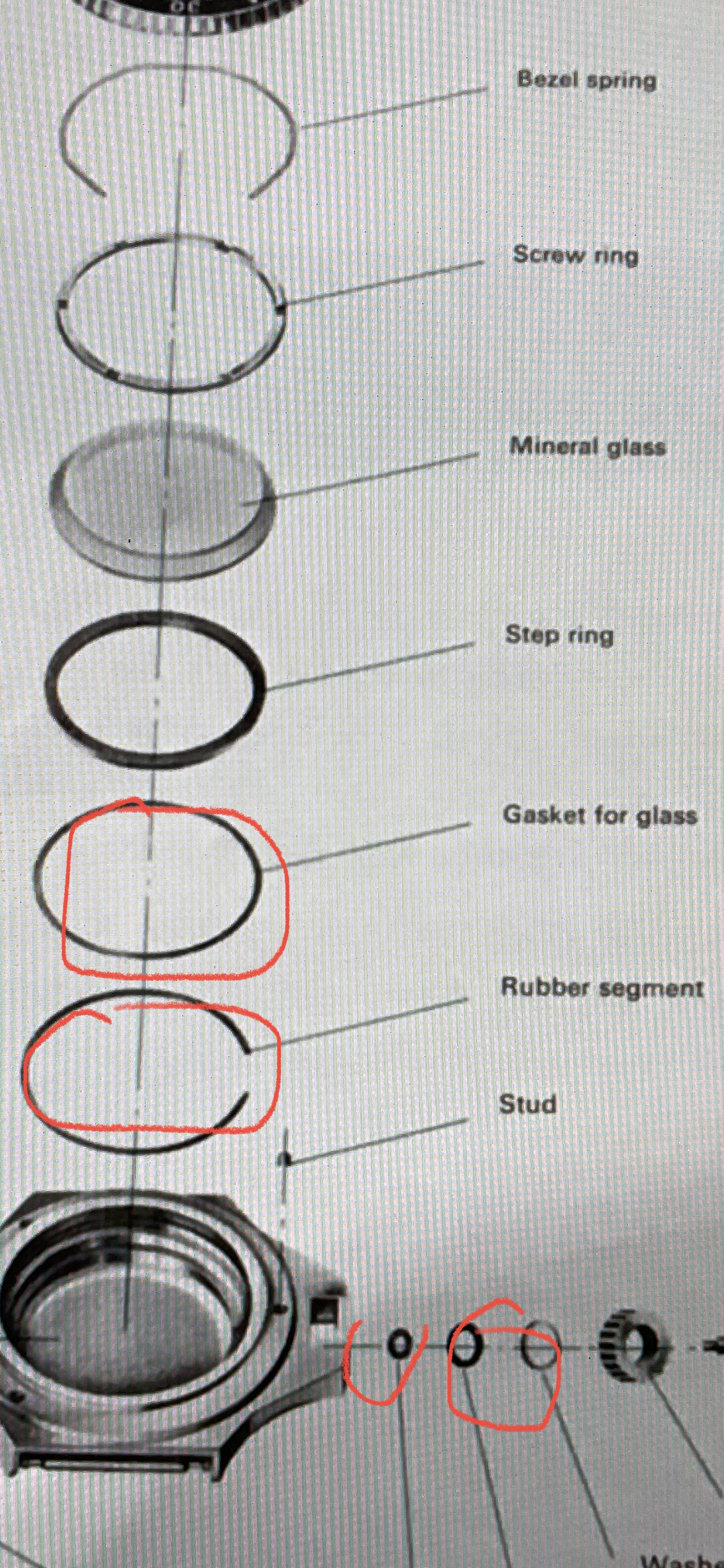

even the rubber segment ?
I think the rubber segment is just a regular gasket with a bit cut out isn't it?

sorry Achim I know you can find many things on e bay but the most of it is in america so for me it is easyer in europe . And I am wondering how is the rubber segment ?Is it the second glass seal that you cut ? is it in rubber or plastique because french original omega papers says plastique ? Thanks Michael for your answer .

Hello Chris i am just looking for the glass seals , rubber segment but I don’t really know what it is . The 2 crowns seals .I am in discussions on mp with Ash and it seams that only the crown kit is available. Apparently he as got everything.

I put my movement in first then the rubber segment on the first ledge with the cut out being where the stem comes through the case. My step ring was in two parts so I fitted the lower brass part and then the second whole gasket and then the top plastic part of the step ring last.

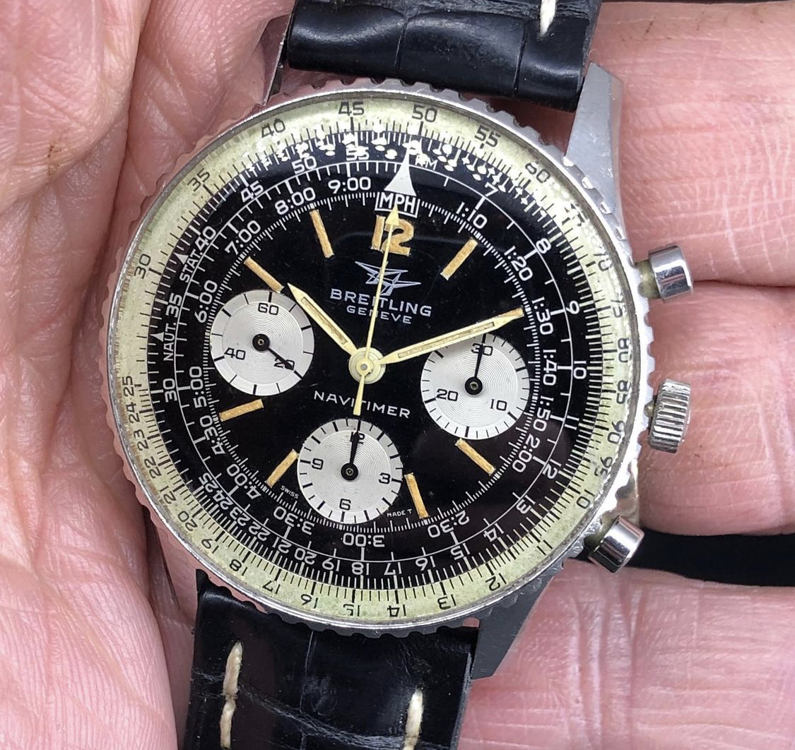

I had the same situation with this Navitimer.
I did not enjoy wearing until I relumed it.
I'm no professional but it looks better to me.
It was not very attractive to my eye with dark green lume.

Hello everyone .
My ploprof is finally finished .James Hyman did a very good job. I had to order an small part for the mouvment that is why everything took a lot of time.
Anyway I am very happy with the result .The watch is not perfect but 100% original except the isofrane bracelet that is new.That is what I wanted...
The watch is working perfectly and totally waterproof .
