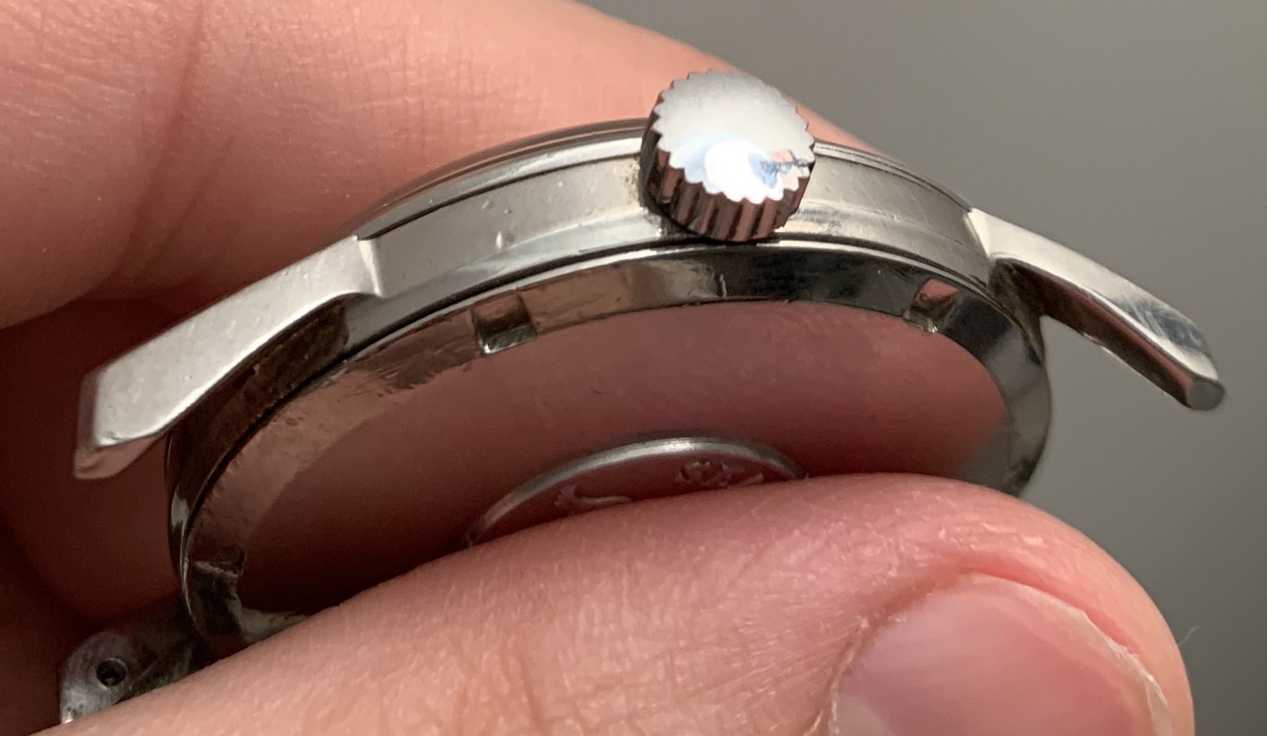

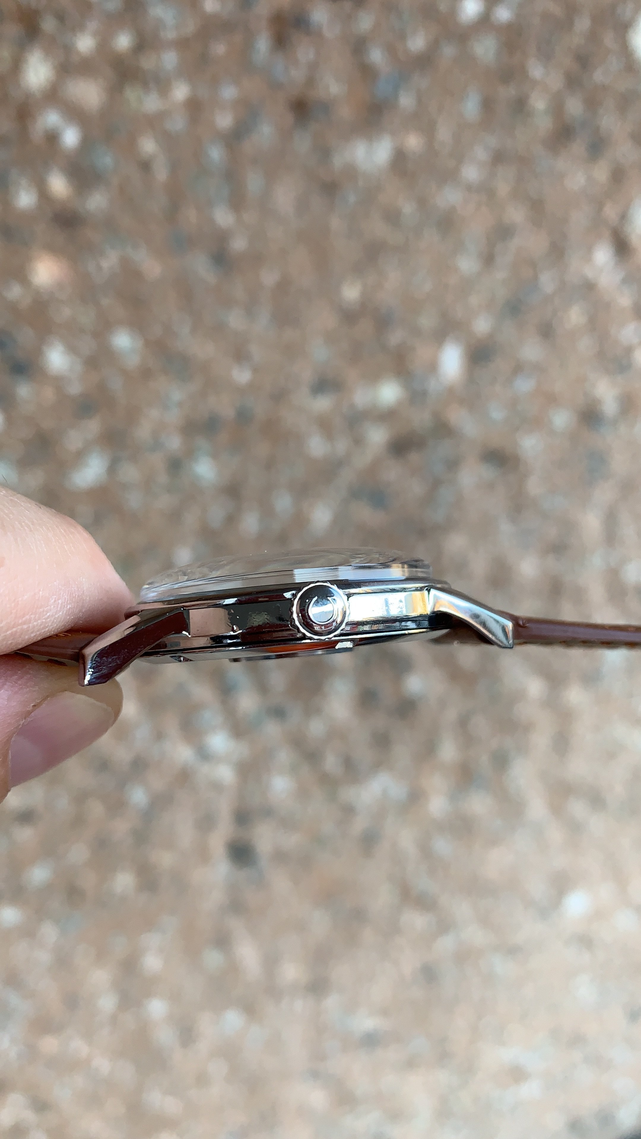

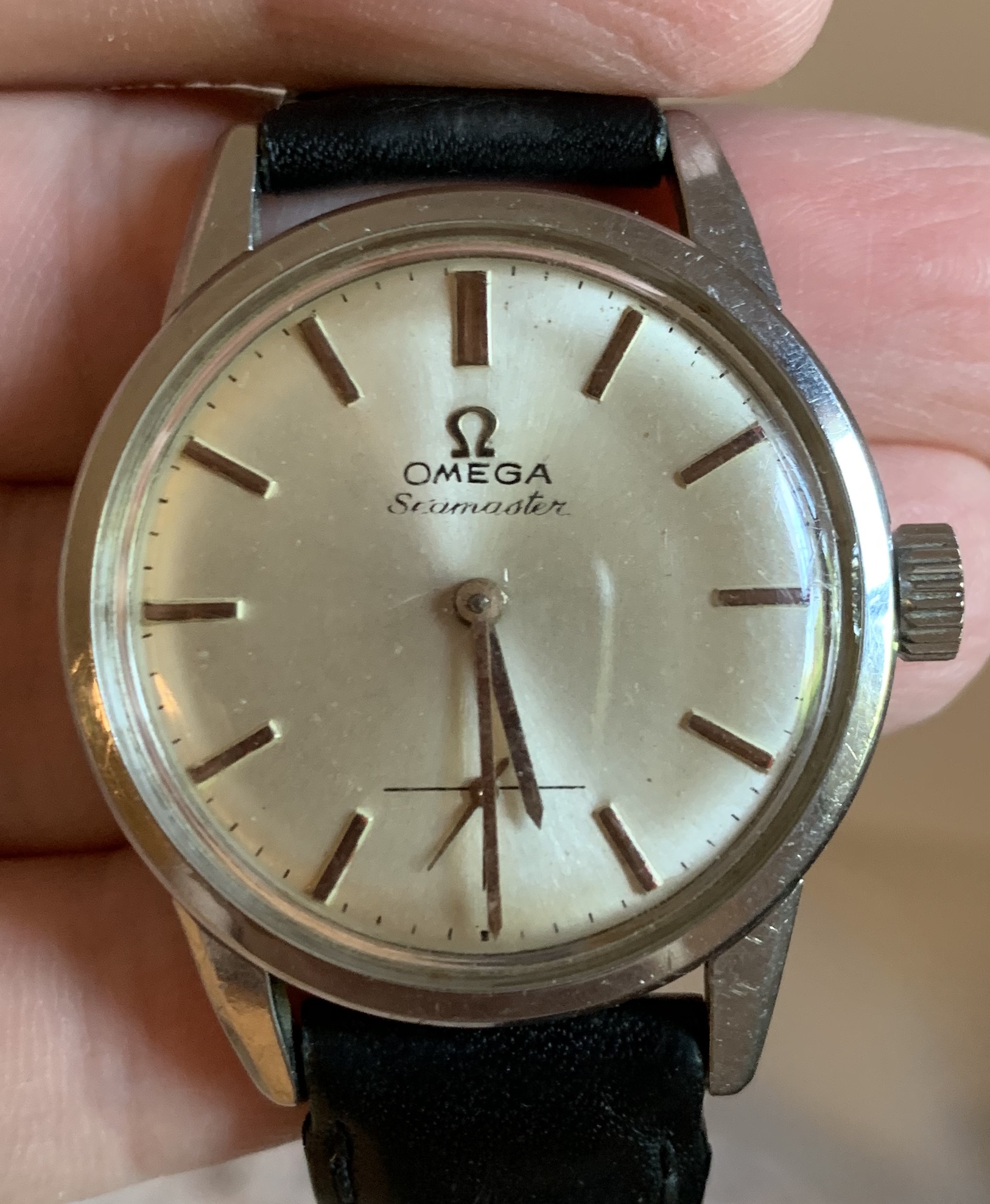

Hello everybody,
I’m happy and excited to be first time poster here.
As watch enthusiast, I am extremely happy to have found in the corner of an old piece of furniture what I believe is the first communion gift of my late father.
I have no reason to assume its not original given the source but I think the crown isn’t the original one anymore. On top of that, I browsed into pictures of Seamasters for a couple of days and did not find anyone which is exactly the same, so am wondering whether perhaps the hands have been replaced too.
The watch is not working currently, but from reading into other posts it looks like this kind of watch might get stuck just because the oil got dry. Therefore, I would love to have its strap changed, a little cleaned and the movement oiled.
I can’t wait to have your expert eyes on the pics I took (hope they are good enough) and read your feedbacks!
10,804
16,814

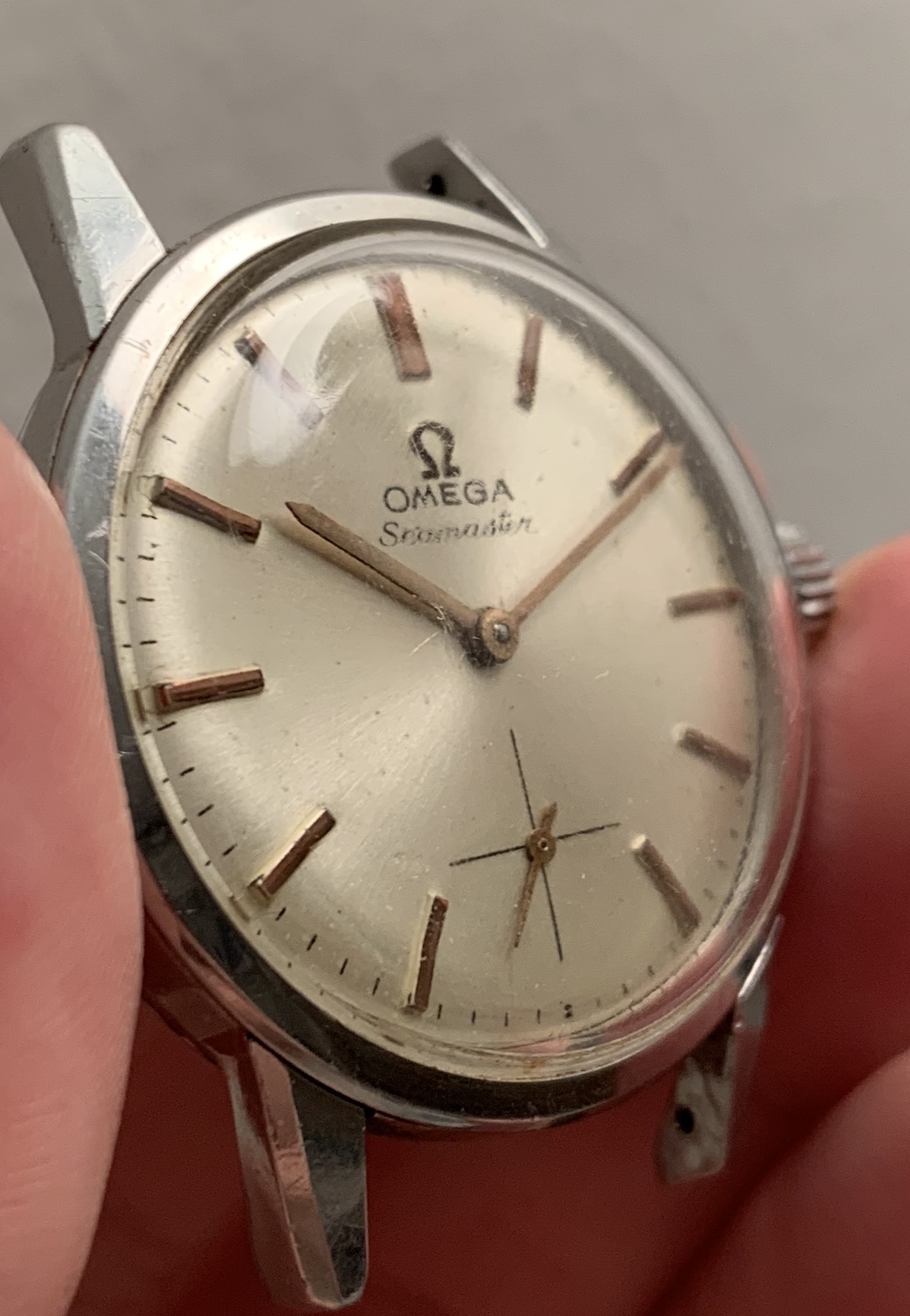

It looks genuine but in addition to the changed crown the dial has been repainted. It’s likely from the early 1960s. It won’t be cheap to get it running unfortunately, it’ll cost nearly as much as it’s worth, possibly more even. It might be something like a 125.0007
12
11
Many thanks, padders!
Assuming isn’t worth thousand of [add here the currency you like, I’d just say Swiss Francs as it’s my country’s currency], as I said it’s from my late father so I would be happy to having it running and wearing it even if it’d cost a few hundreds Swiss Francs.
You imply it’s a Seamaster 30, then? The hands really look like the 30, but the missing of the number 30 drove me away from considering it so.
Why would you think the dial was repainted?
I believe I’d look into bringing back at the original condition, so what actions would you suggest?
Because the font used is wrong

It looks to be an early 1960s SM using the one of the 30mm movement variants (eg 269) but whether it originally had the 30 on the dial, who can tell, maybe it was changed when it was repainted, or maybe it was never there. There are other models using similar cases so it might not be a SM30. If you get the back taken off you will be able to check the actual case number. It may be 125.XXX if it is post 1962, but it may be a 5 digit code if it is 1960-62. If you want to put it back to near original yes you can change the crown, but finding a dial will be harder. Though the redial kills collector appeal, you could just treat it as part of the piece's history. Yes you can find original buckles and plenty of fakes on ebay that look pretty much the same but it wouldn't bother me personally.
Yes I would think you could get it running and looking good for a few hundred CHFs or Euros.
Font, alignment, text spacing... Also the minute indices. Started off alright, going well to 30, then it all goes a bit wrong in the home straight. A bit like a 400m hurdler (we can't all be Edwin Moses!)
But if the watch is important to you, don't let it stop you getting it up & running, and leave it looking as you found it. Why change it again!

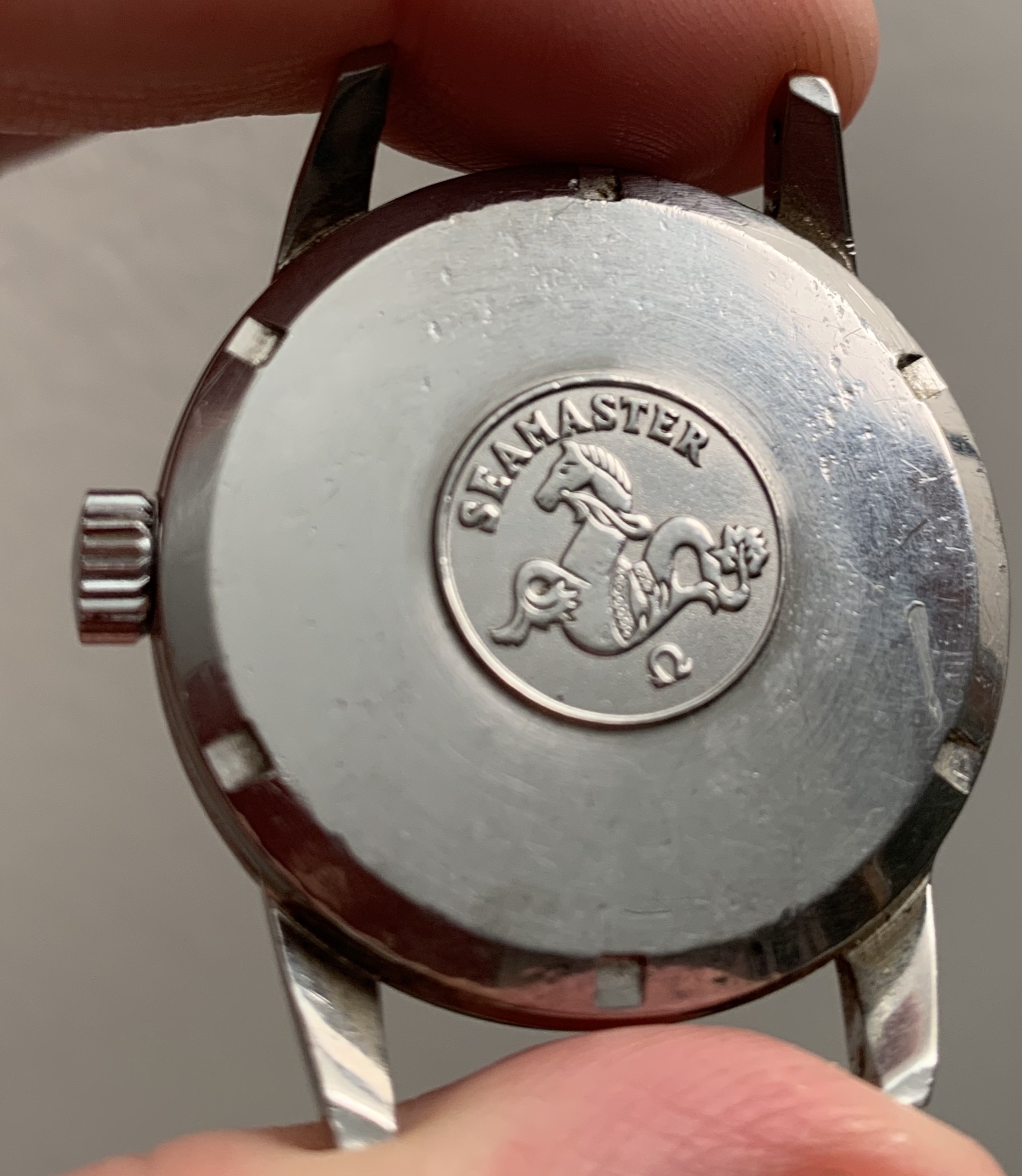

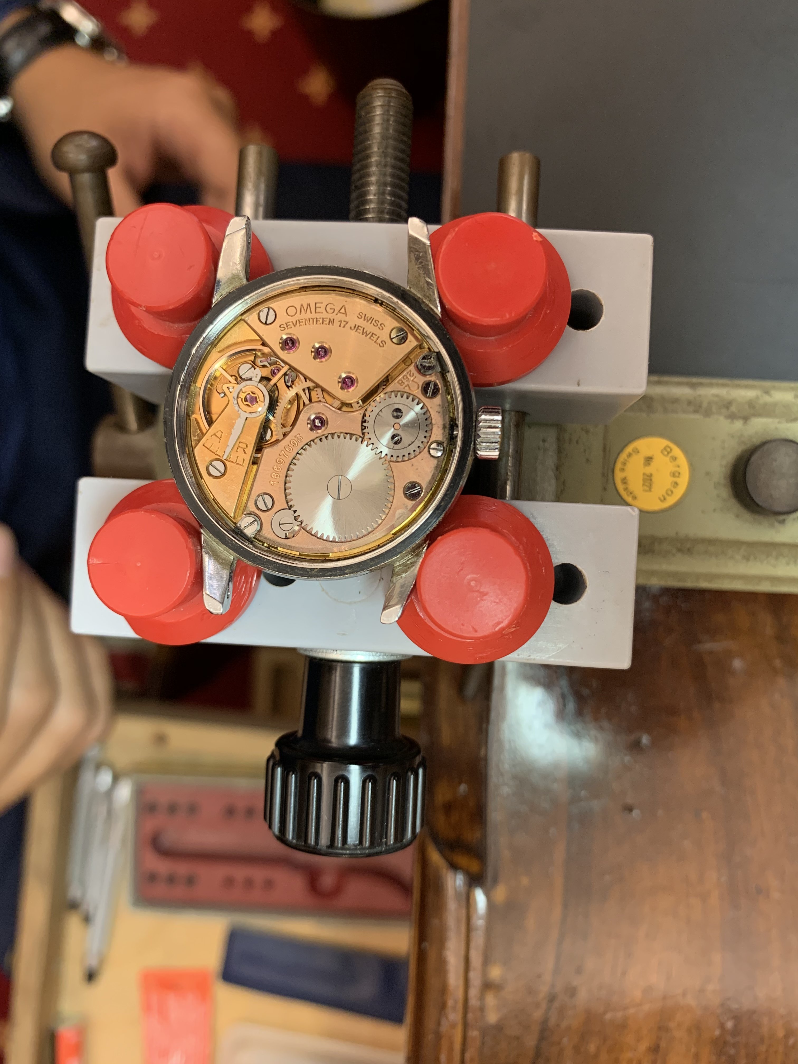

Hi,
Here I am again.
Taken to an Omega reseller today, who opened it and let me take this picture.
The watch is now being shipped to Bienne for assessing what is needed to be done and proposed further actions.
I will have a feedback in 2-4 weeks.
10,804
16,814
As I thought, 30mm movement, in this case the 268. The serial looks to be 1961-2. Did you get a picture of the inside of the caseback? That’s where the case number is.
12
11
As I thought, 30mm movement, in this case the 268. The serial looks to be 1961-2. Did you get a picture of the inside of the caseback? That’s where the case number is. I don’t think you’ll like what Omega Bienne will say. I would guess a quote of $750 plus.
I did not take any pictures of the case back as I didn’t spot any number on it. But it was a couple of meters far from me and I might have missed something...
I assume the proposal from Omega will include all the details, so we will have a clearer picture then.
I also mentioned I wanted a leather strap with the “vintage” buckle, which looks to be available.

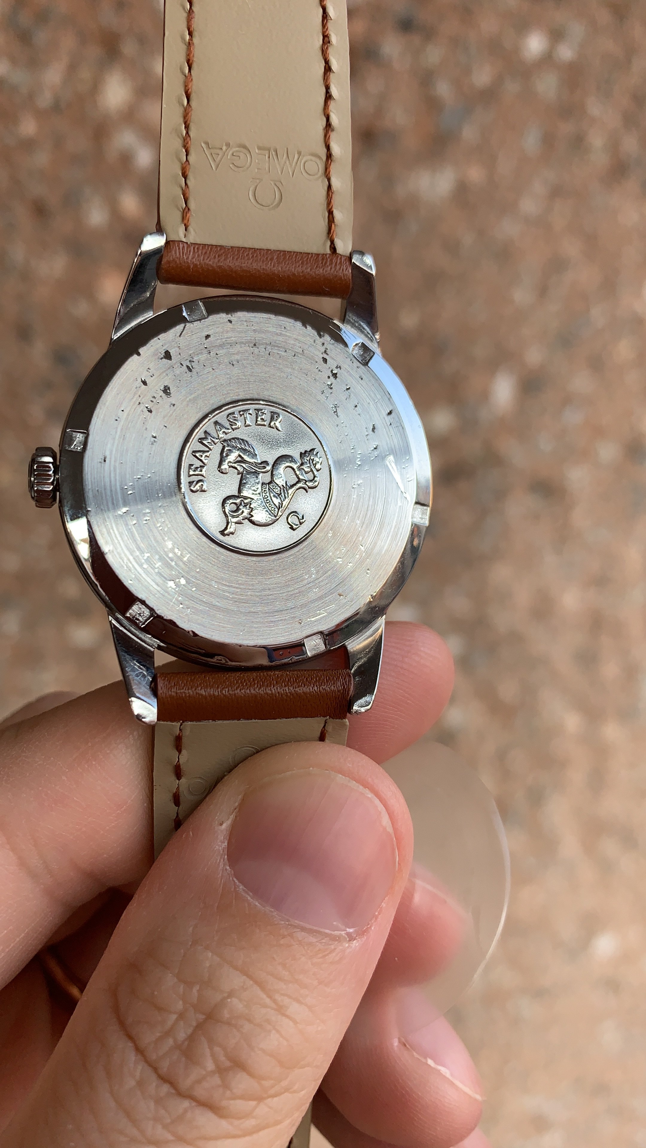

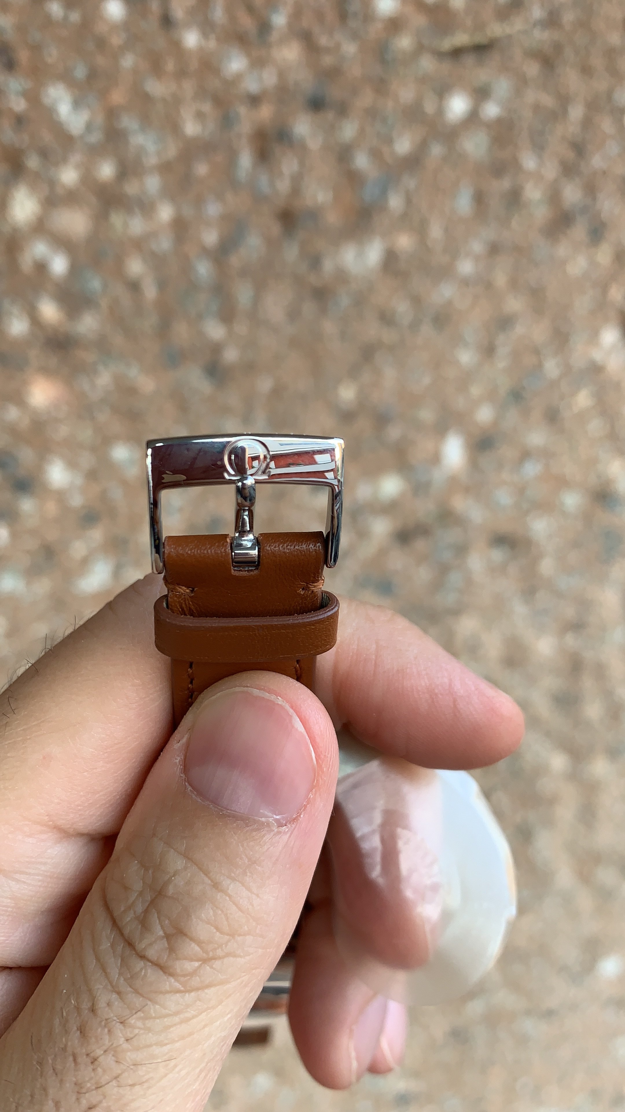

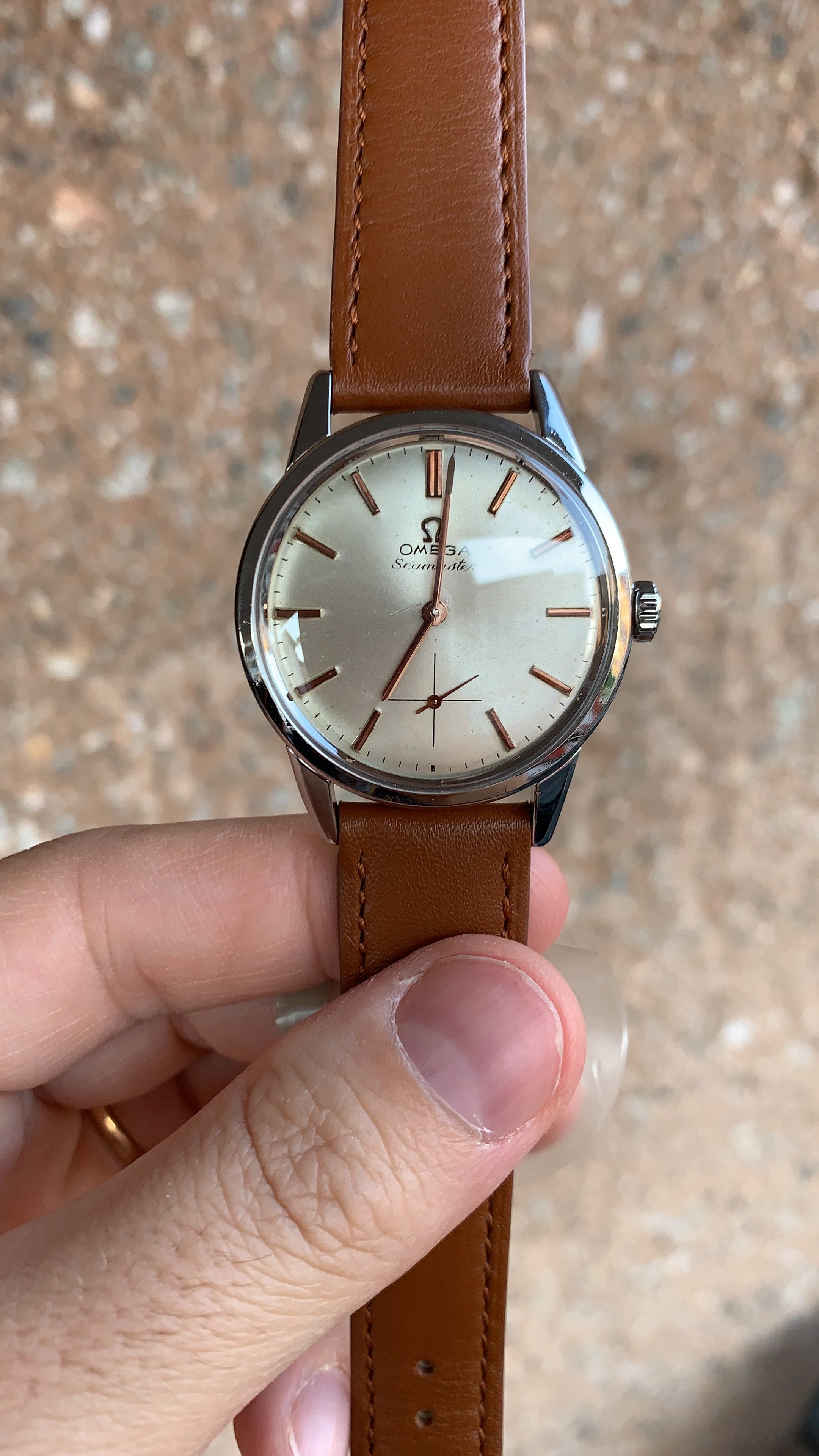

Hi there,
Yesterday my watch came back... it looks like an almost new watch. Super classy and stylish.
The total bill was in the high three digit range but am totally happy with the final result.
Have a look!
18,835
39,173
Hi there,
Have a look!
Do you have any documentation from Omega Switzerland stating what was done to your watch?
12
11
Yessir. I’ve been also given the replaced parts.
I don’t have the list here, but it include:
- cleaning the movement
- changing a few parts to the movement
- replacing hands, glass, crown
The dial is the “original” one (meaning they did not replace it, leaving the repainted on) and the water resistance isn’t guaranteed and hence advices against putting it in contact with water.
