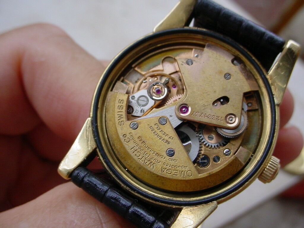

I found the watch below on ebay. It seems way too expensive (feel free to weigh in on that), but I'm more concerned right now with learning about the watches and how to identify/verify/appraise them. Feel free to correct all misuses of terminology. I'm very new.

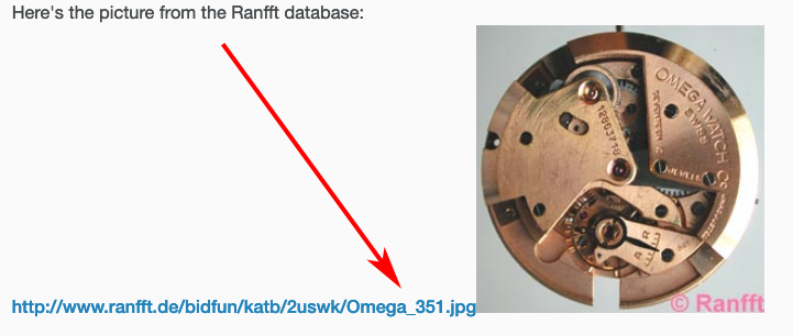

So, I cross-checked the watch's reference number, 2520, with the Omega database. That checks out. Font seems good Serial number (12 mil range) also makes sense. And the caliber written on the movement, 352, is what it should be. BUT, I looked at the Ranfft database to see what the movement of the 352 caliber typically looks like. And the picture provided by Ranfft is very different from this watch's movement. What's up with that?
Here's the link: https://www.ebay.com/itm/RARE-Vinta...738657?hash=item3b48759fe1:g:0IoAAOSwz3JaG0r-
Here are the (relevant) pictures from the watch on ebay:
https://i.ebayimg.com/images/g/0IoAAOSwz3JaG0r-/s-l1600.jpg s-l1600.jpg
https://i.ebayimg.com/images/g/aokAAOSwIJlaG0ti/s-l1600.jpg
Here's the picture from the Ranfft database:
http://www.ranfft.de/bidfun/katb/2uswk/Omega_351.jpg Omega_351.jpg

A redial I assume. The movement is probably correct, just badly oxidized, and the "rotor" is just in a different position in the Ranfft photo. Unless there's something else you're referring to, can you be more specific.

The movement is the same just the rose colour plating wore off. It can happen, most likely it was exposed to moisture for some time given that the hands look corroded as well

The Ranfft database uses the same photo for the cal 351 and 352 listings. That's pretty common for him to have only one photo for an entire family. The listing will often describe in words how the variations differ. In this case, it mentions the special regulator on the 352 but shows a photo of a 351. Of course, the OP's photo doesn't show the regulator anyway.

Shame that all the original "deluxe finish" is gone and is now bare brass. There are better ones to buy
Thanks for the quick response! What makes you say it's a redial? Also, I thought a redial only involved changes to the dial of the watch. Here, the movement doesn't match (maybe) the caliber that's etched on the movement itself

Watch movement - 352 - chronometer grade
Ranfft movement - 351 - standard grade
Except for a small number of special parts. Movements are pretty much the same design which is why Ranfft probably used the same image for both movements
The movement is fine, but the dial has been repainted. With experience it will be apparent to you.
13,492
31,811
The printing on the dial is horrible, fonts incorrect, line quality not even close.
The movement is correct, it is a caliber 352 with the correct regulator.
