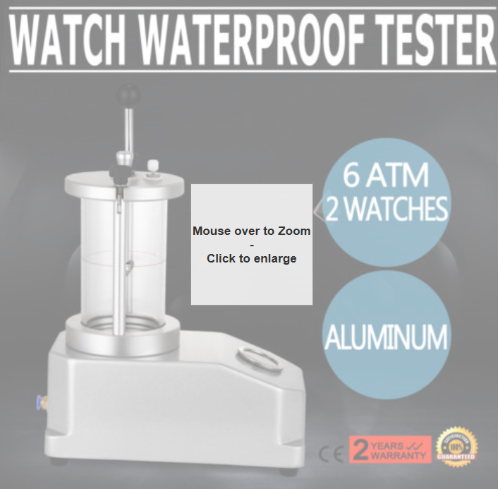

To me it sounds like he knows he's been caught out. Did you confirm that he only replaced one gasket? if so, he didn't do a full job if he did it at all.
Cheap copy of the Bergeon version - the real thing costs 10 times what this one is selling for. I can only imagine the quality of this would be very poor. Despite the acrylic cylinder being rated for 10 bar, I'm not sure I would want to stand next to it at 6 bar...
There's a reason why watch brands don't allow these testers. There is a real risk of the crystal blowing out of your watch while you are lowering the pressure inside the chamber. This is particularly a problem if the rate of pressure release can't be finely controlled, and in a unit this cheap I doubt they are using the best components. If the pressure drops too quickly...bad news.
I used to have a machine like this (mine was a Calypso that was capable of 10 bar though) and every time I tested a watch in it I would hold my breath. I have a few crystals blow out, but thankfully only after the watch had been raised back out of the water. Still when the crystals went flying there was enough water splashing around inside the chamber to cause me a lot of extra work.
This kind of tester might have been great back 30 years ago, but the technology for water resistance testing has come a long way since then. Proper modern dry testing machines are essentially risk free...
Cheers, Al
Cheers, Al
