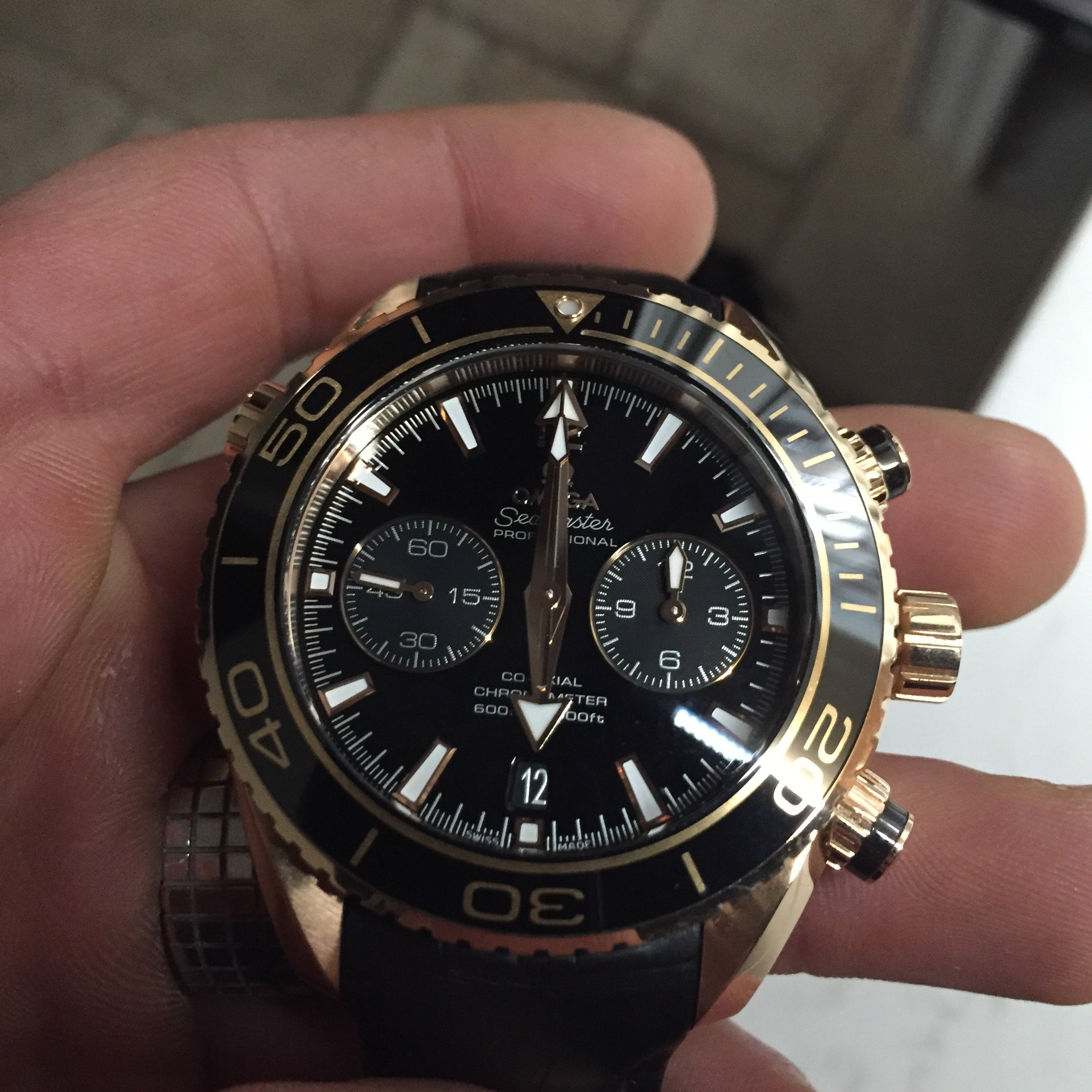

    Apparently not a terribly uncommon problem with the 9300 movements..
    Due to the jumping hours mechanism, the hour hand can loosen from the hour wheel..
    I had the same issue with my Ceragold...
    Look where the hour hand is relative to the hour marker... Over 10 minutes past the hour... image.jpeg
    It was all I could see... Plus it actually affected the ability to tell time...
    You won't be able to enjoy the watch until you get this fixed...
    Mine didn't start that way.. It gradually loosens, it will likely get worse..
