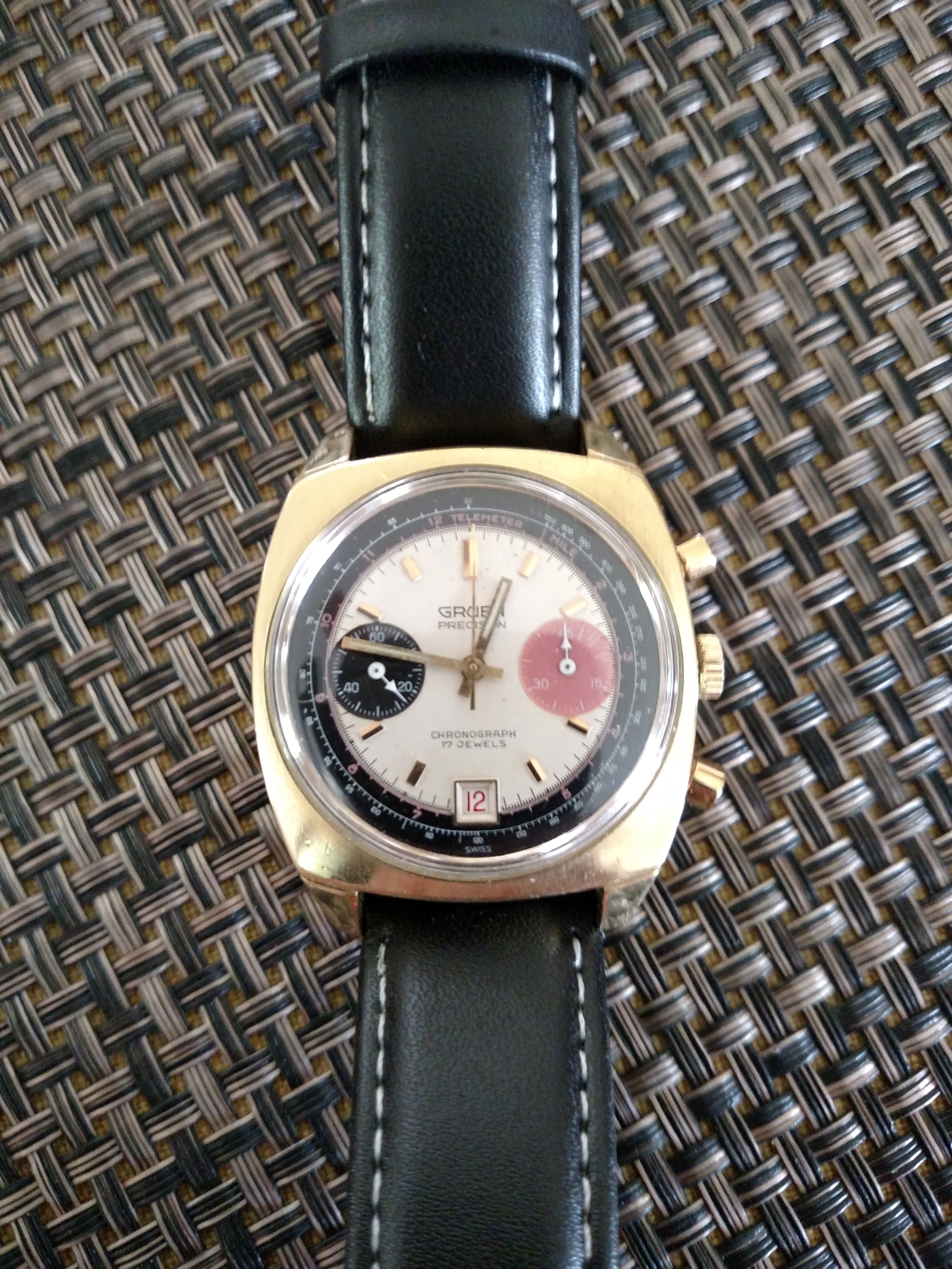

Small world, I found your image using a google search, here is my actual watch:
img_20160412_124733561-jpg.225121
and I do find myself wearing it frequently and learned a lot regarding the Heuer connection from this thread.

Yours has a Valjoux movement inside, not sure of the caliber. The same caliber was probably used by Heuer in some 1970's model.
gatorcpa
Good to know, I did buy it on a whim but it has served me well and functions like it should. I have seen some pretty poor examples as well as some sellers trying to get a lot more than I paid for the same watch. One keeps getting listed over and over on eBay for more than double the price I paid but remains unsold.
