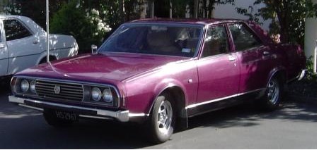

There's some memories! The Wedge as it was called. I had a grape/purple coloured one. Engine was great except on hot days whne it would stall - found out the fuel line ran along side the block head and the heat would cause the fuel to...I don't know...evaporate 👎 anyway it would just roll to a stop with no fuel getting into the carby. Solution was asbestos sheeting between the fuel line and the block. Lots of room in that car that's for sure, and you could easily get more than a few mates into the boot for the drive-in movies. The window handles wouldn't stay on, the windows would just drop into the door cavity if the car door was slammed too hard and on and on it went...but I loved that heap of Leyland shite. 😁 Wasn't it a joint venture with Leyland Australia and another company?
Not mine, but similar and far more ratty and faded.
Btw, not a destro to keep with the thread.

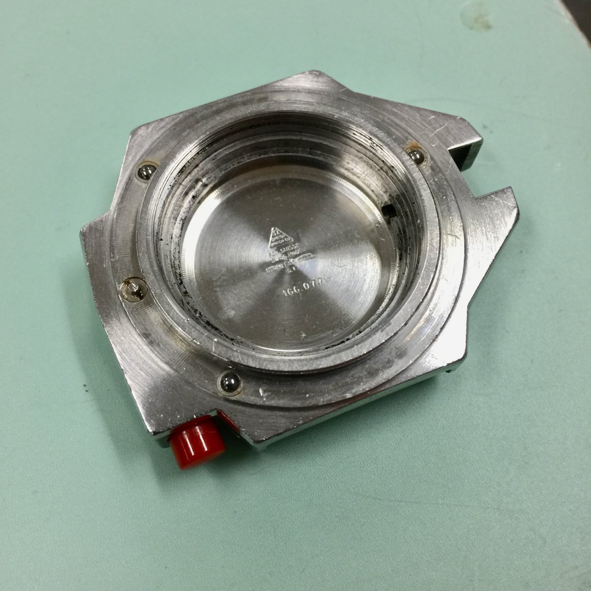

This is information directly from the Omega Extranet, their in-house computer reference system, I have an Omega authorised workshop....
'The Ploprof with case ref. 166.0077 exists in 2 versions. One with crown at 3 o’clock and one with crown at 9 o’clock.
The engraving in the caseback is the only reference point to tell which version you should have. The triangular OMEGA engraving is always facing up.'

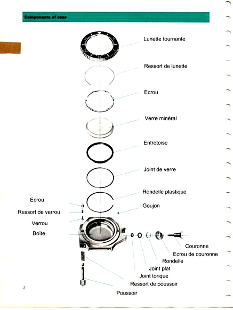

Here's my 0.02 Euro cts.
I have read in an article (that I cannot find anymore unfortunately) the discussion someone had with a former employee of the Omega "Bureau Technique habillement". He recalls that the original design of the Ploprof was what we now call "reversed", that is with winding crown at 3 'oclock, like a normal watch. That seems to be confirmed by the inside caseback triangular stamp of the prototypes, that was shown before.
But apparently, the first tests showed that there were practical problems with that design: for instance, the very large crown shoulders impeded the divers left hand movements; also, when they wanted to set the time, the divers tried to do it with the watch still on the wrist, which sometimes resulted in pulling the whole winding stem out of the case (the ploprof owners will know what I mean 😟). I don't remember anything about handling the bezel with one hand only, but that makes sense also.
So it was immedialtely decided to reverse the watch, in order to solve these issues. That probably included the prototypes that came back for service, I imagine.
That theory - I have read the story, but I was not there at the time, so I cannot call it a fact - would explain pretty much everything, including the existence of some very early prototypes that remained in that "inverted" configuration.
In addition: here's a sketch of the Ploprof case structure, taken from an Omega document. It clearly shows a watch with the winding crown on the... right:
But apparently, the first tests showed that there were practical problems with that design: for instance, the very large crown shoulders impeded the divers left hand movements; also, when they wanted to set the time, they tried to do it with the watch still on the wrist, which sometimes resulted in pulling the whole winding stem out of the case (the ploprof owners will know what I mean 😟). I don't remember anything about handling the bezel with one hand only, but that makes sense also.
That theory - I have read the story, but I was not there at the time, so I cannot call it a fact - would explain pretty much everything, including the existence of some very early prototypes that remained in that configuration.
That those 2 Ploprof photos are mirror images further muddy the waters!
62
58
Right, I have edited my post and replaced the picture by another one, more suitable to make my point

Can anyone tell me if "upside down" markings on the case always mean that the watch left the factory in the inverted configation?
And does someone know for sure if those inverted watches with upside down markings have any mention of their crown position on the extract?
Cheers & thx for your help😀
That’s the hundred dollar question.
one person claims it says one thing on the extranet (omega in-house data) but other people with access have not commented.
there are arguments for and against that the stamping orientation denotes how it left the factory.
At this time either orientation is accepted as long as the date wheel is the correct one for the orientation.

What about stamp upside down and crown to the (regular) 9 o’clock position? Just a case with a stamp with the wrong orientation caused by a simple mistake in the case factory? It is rather unsatisfying to not find a definite answer with reliable sources.
Who has access to this Extranet information? Is there any point to ask omega/ the museum for a confirmation? Could I ask my Omega level 3 certified, independent watchmaker to check for me? If one person claims to have seen this on the extranet, there must be someone to confirm (if I understand it correctly, it should be the same website for each person who is a registered user. I imagine it to be like a smaller version of e.g. Wikipedia with limited access...)?
