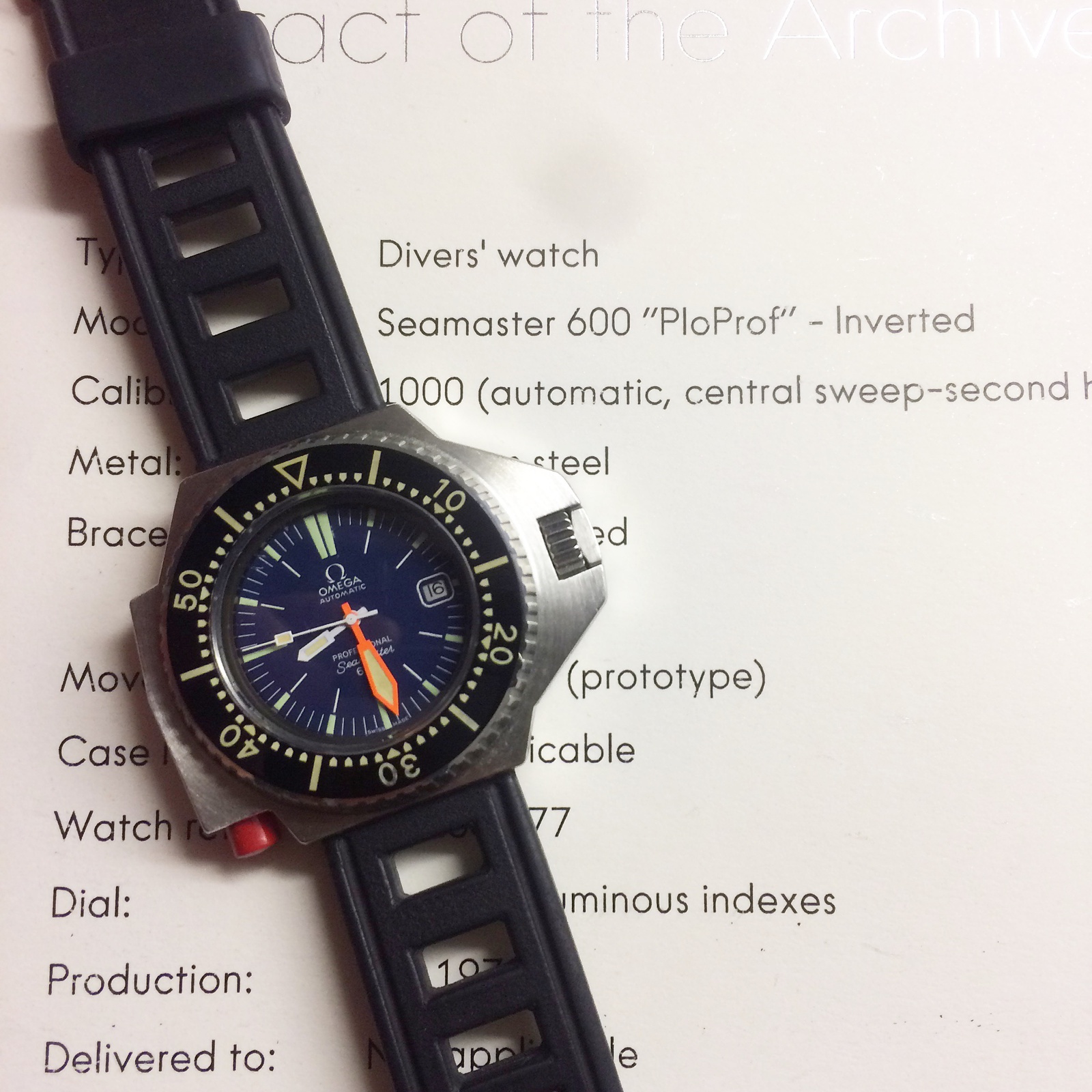

The destro, or inverted Ploprof existed as a factory version, this is confirmed fact. J.Wallis Ploprof book is nice, but outdated source of info, theory about mad watchmakers inverting watches because lacking correct date wheels is busted myth .
I can confirm that in Omega extranet are both versions as was stated above and the inverted version can be recognized by orientation of the stamped triangle, the top points always to 12 o`clock.
Also here you have ref of the two data wheels: 1000-1580A - inverted version, crown at 3; 1000-1589A - normal ploprof version, crown at 9.
And because people believe only what they see, here you go:

You have made quite a few suppositions. I see no evidence of anything you have stated here.
The extranet parts list proves nothing except 1000 series watches have at least 3 types of date wheel depending on what case they are for, gold, crown at 3 and crown at 9 o’clock.
Saying the orientation of a crown is dictated by the case stamp is also wrong. The SM1000m is always crown at 9 o’clock and yet the stamped triangle points to 6 o’clock.
That the watch is very difficult to use in inverted dial format, and has no benifits in that configuration make it hard to believe it would be put togeather like this originally.
That extract is also based on the same suppositions you have made and not actual archive data, and so in my mind not evidence of fact.

Hi @Knudsen1971
Not sure where your getting your facts etc....
I would use "old " Omega docs as a reference and not the current extranet to prove parts... etc...
I personally will still disagree with your conclusions... Just for your info ... I been collecting Omegas for a while. I have talked with old Omega watch service centers over the years all said the same thing to me about the date wheel is unique for the 600m ... and if the standard one was used it would have to flip the orientation of the crown.
Case stamping as a tale tail is also hard to believe.
Good Luck in making your case.

Is a Myth, always was a Myth. Makes no sense as a PLOPROF. kind regards. achim
