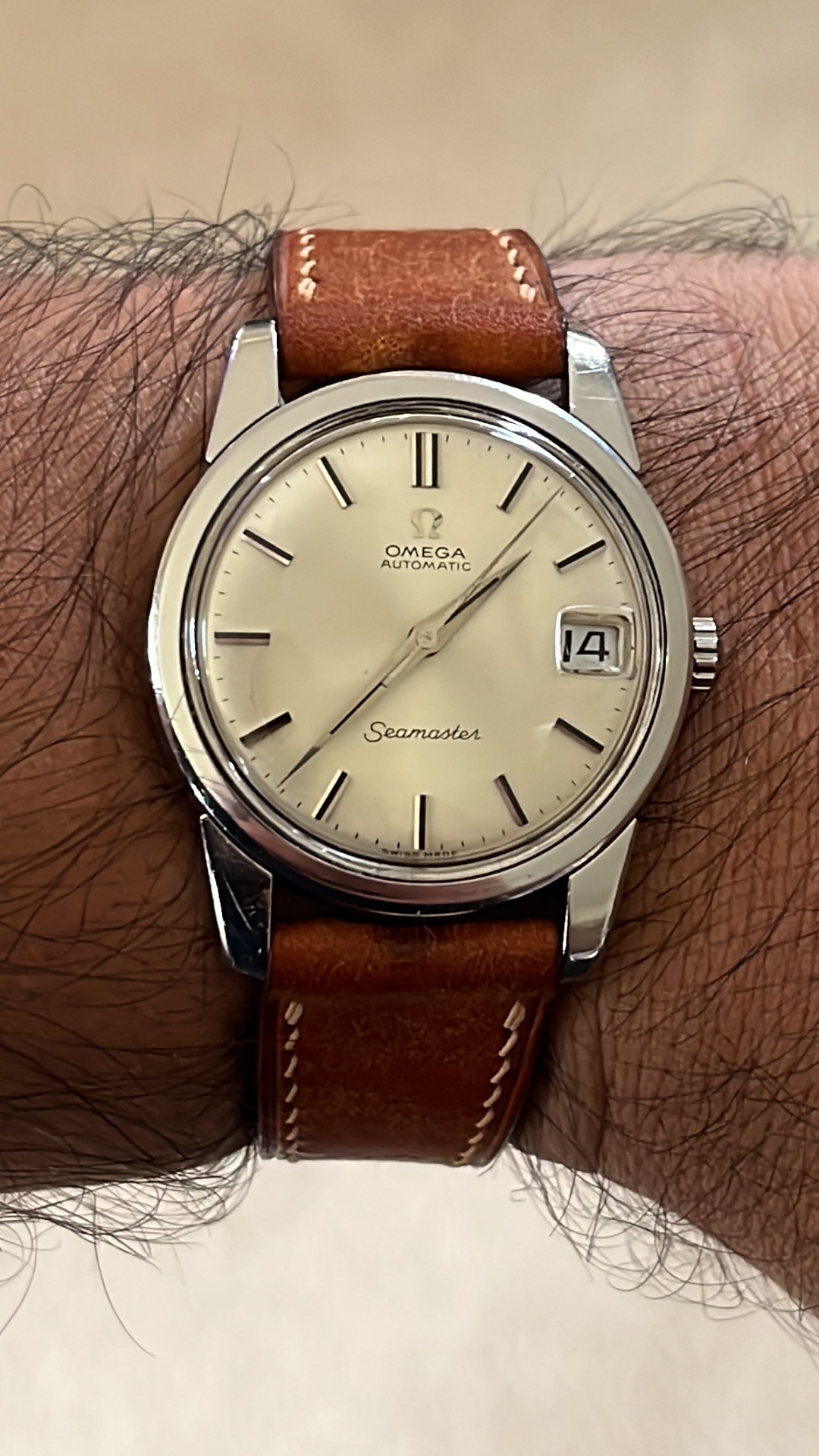

Hi all!
I recently purchased a vintage Seamaster and it has some stuffs on the crystal. What is the best way/product to remove them?
thanks!
