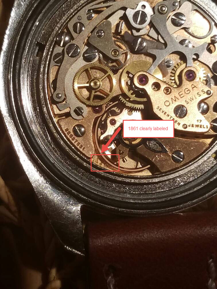

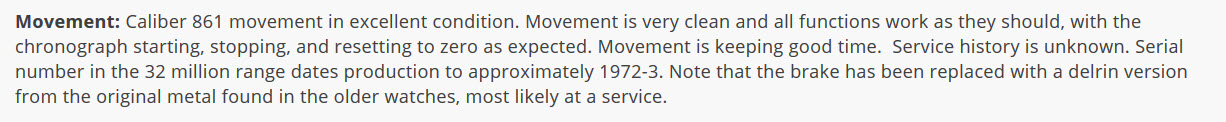

Here is an example of the "1972" Speedmaster I purchased. First the movement description
And now the actual movement
Obviously not the cal. 861 movement described in the sales pitch

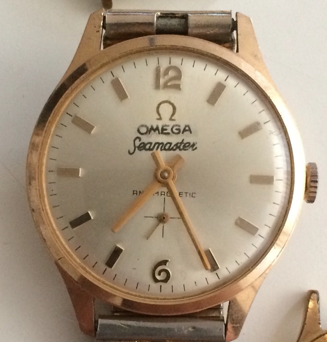

I got an offer to buy this one but the dial looks dodgy for me. Any experts? It's through internet, so couldn't check the caliber inside
13,492
31,811
Completely fake.
