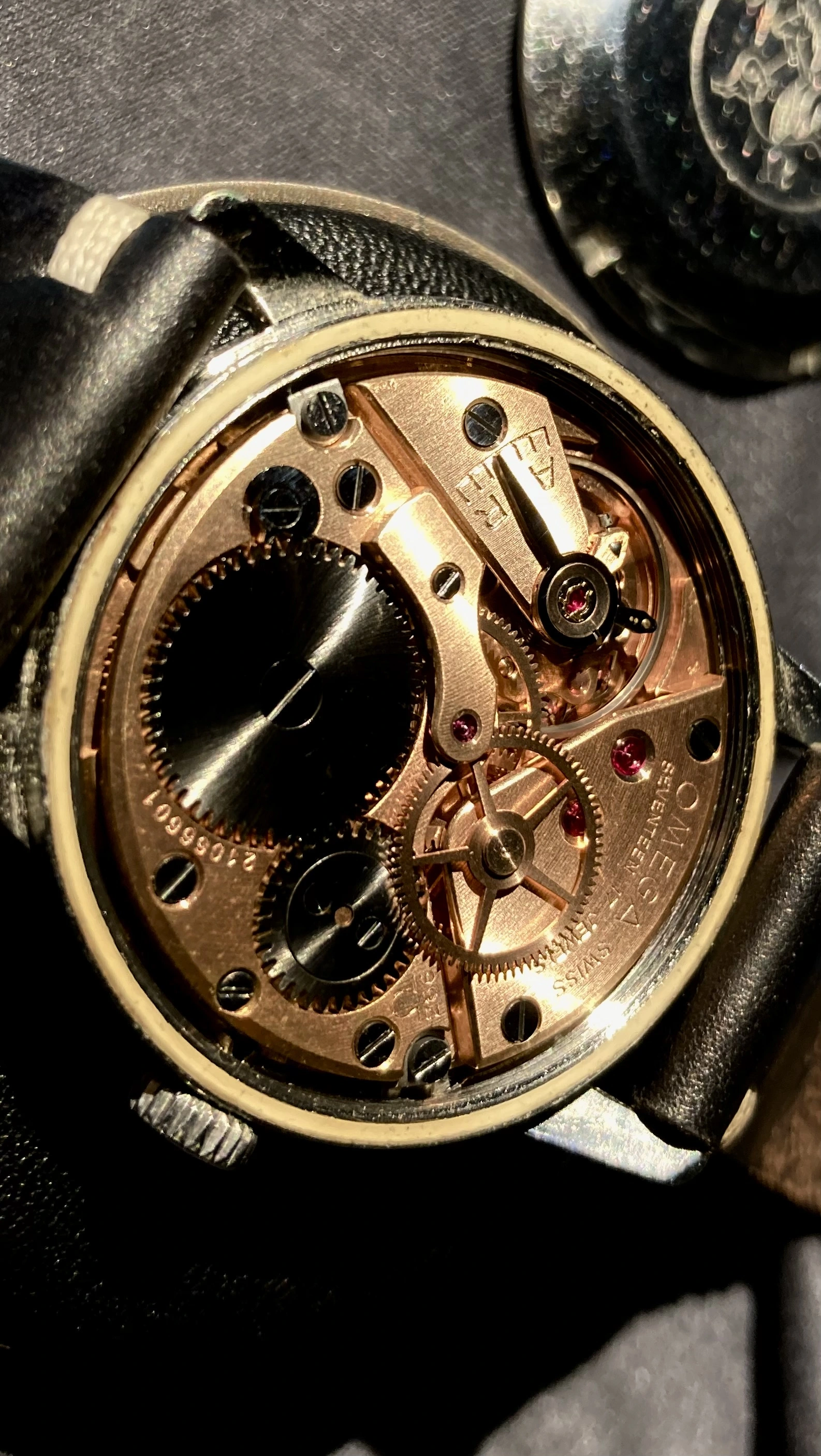

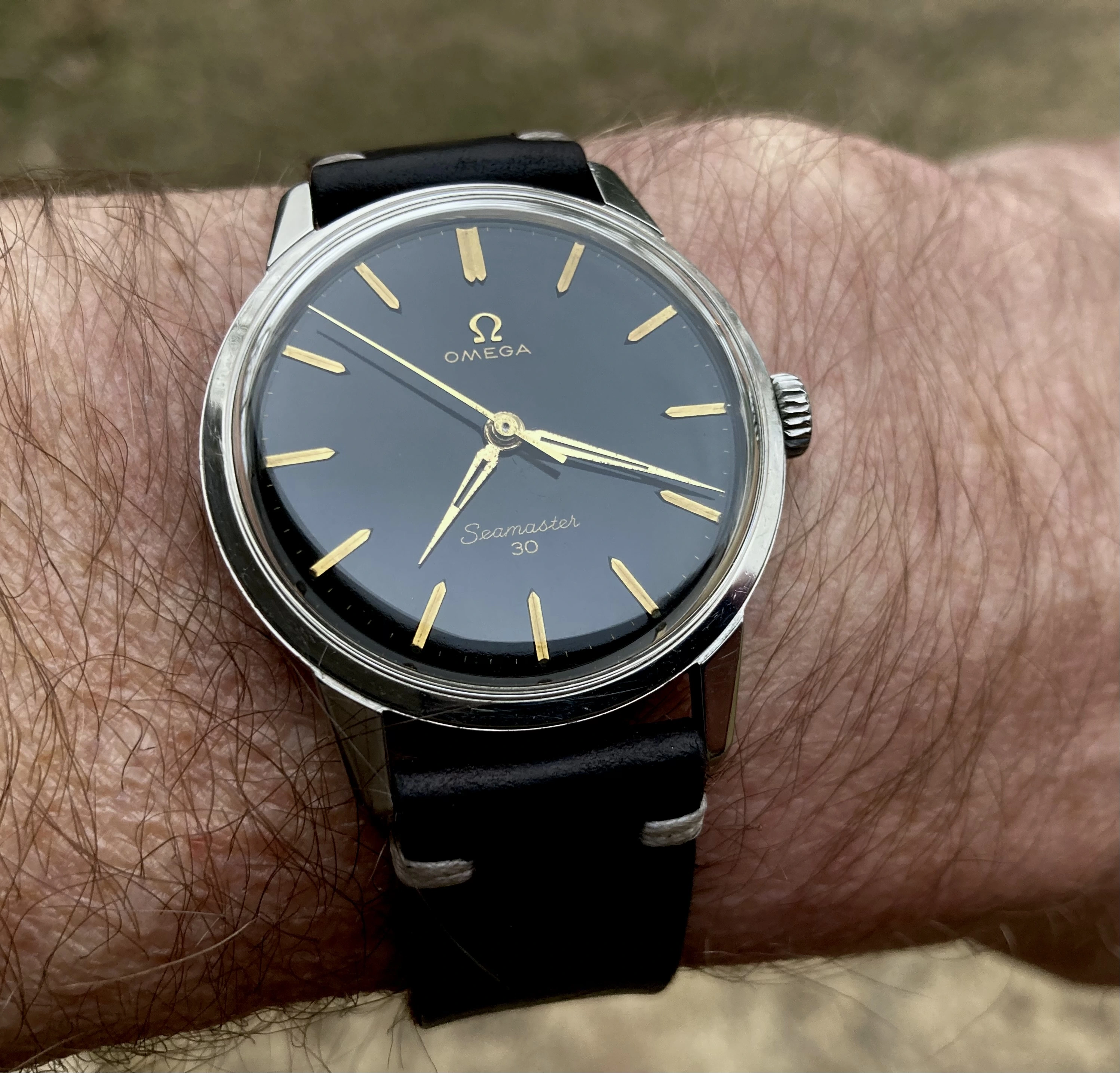

I bought this 1964 135.007 cal. 286 serial # 21xxx...earlier in the 2000s. Non-coathanger "S" font. For the few hundred bucks I have in it, I couldn’t care less if it’s a redial, but I think it’s most likely an original. The dial text and minute track print are gold regardless how it shows in the pics. There are the remains of “T Swiss Made T” centered under 6:00 that has scuffed off / faded. The tension ring crystal isn’t 100% correct for this case and it obscures what’s left of the 6:00 lettering. Impossible to photograph with the movement in the case and I don't have macro photo equipment anyway.
Rotted, aged tritium in the hour markers. I don't see how it's possible to repaint a dial with rotten tritium still intact, but who knows?
The Alpha hands are a curiosity, but I like them and I have a set of NOS luminous stick sword hands in my stash anyhow, so franken-hands don't bother me if they in fact are franken hands.
There is rotten tritium in the luminous hands too that seems to be as rotten as the hour markers, so who knows... There seem to be practically infinite variations of 135.007.
People in the know seem to say that "mirror finish piano black" paint is a dead giveaway because it wasn't possible to apply paint that smooth 60+ years ago apparently. Depending on how the light reflects on this dial paint, it definitely has a rougher finish than a mirror black finish.
Again, I have experience in this hobby now and I'm not looking for validation on this Seamaster. I just think the more pics and discussion about black dials, the better.

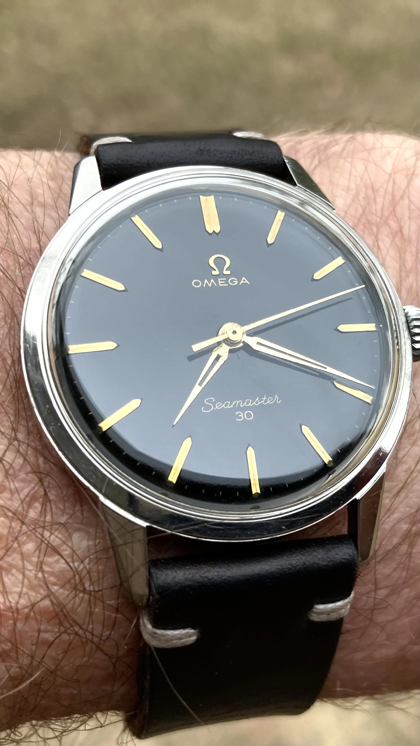

Either "Omega" print is crooked, or the metal emblem has shifted.
I think I can make out a "20xxx" serial #. (1963), so a coat hanger "S" could be right. '63-'64 was a transition period for "S" styles.
It seems like there should be some reference to the lume on the dial and hands, but no "T" anywhere for Tritium, but again, '62, '63 and '64 were transition years for lots of things. The gold print does seem to have the proper "sparkly" gold look in some angles.

If it is gilt text with 10x magnification I would say likely original. Very hard to capture on photos
And it’s only an issue if you plan to sell it then examining dial out of case etc will help.
Most of the 30s are shown with baton hands some with dagger style. But I agree the alpha hands look good and may well be original hard to know. I would happily wear it.
