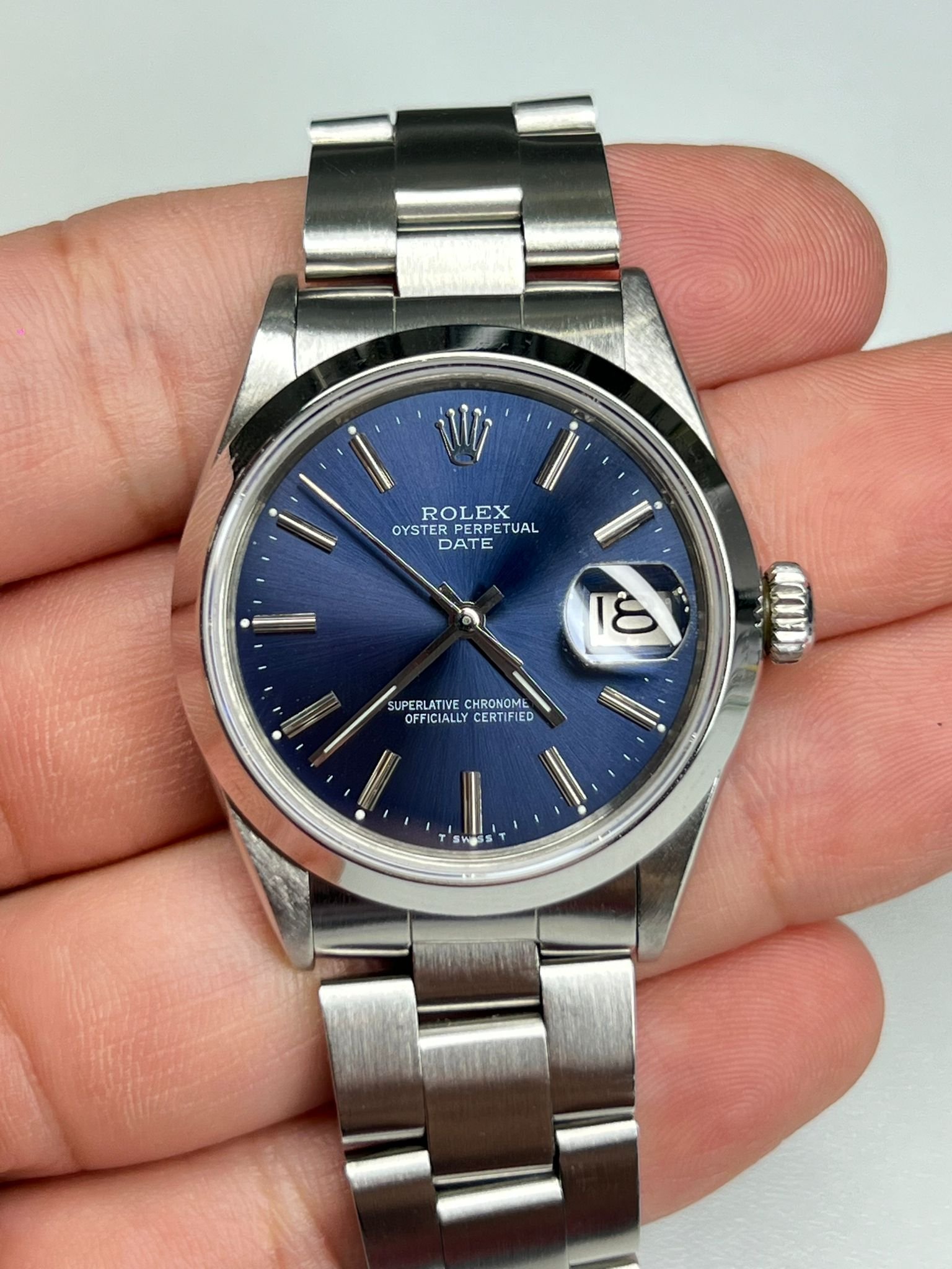

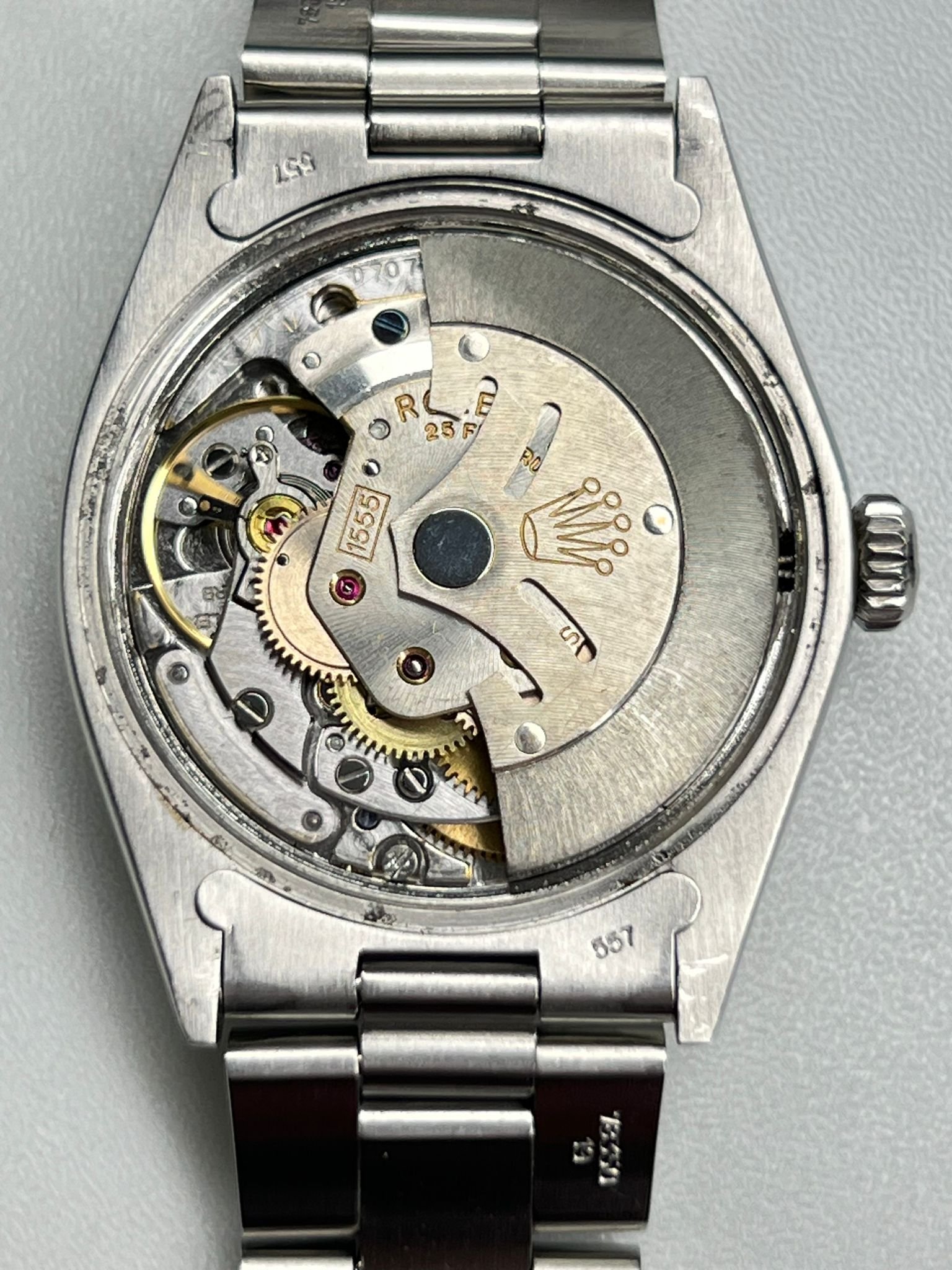

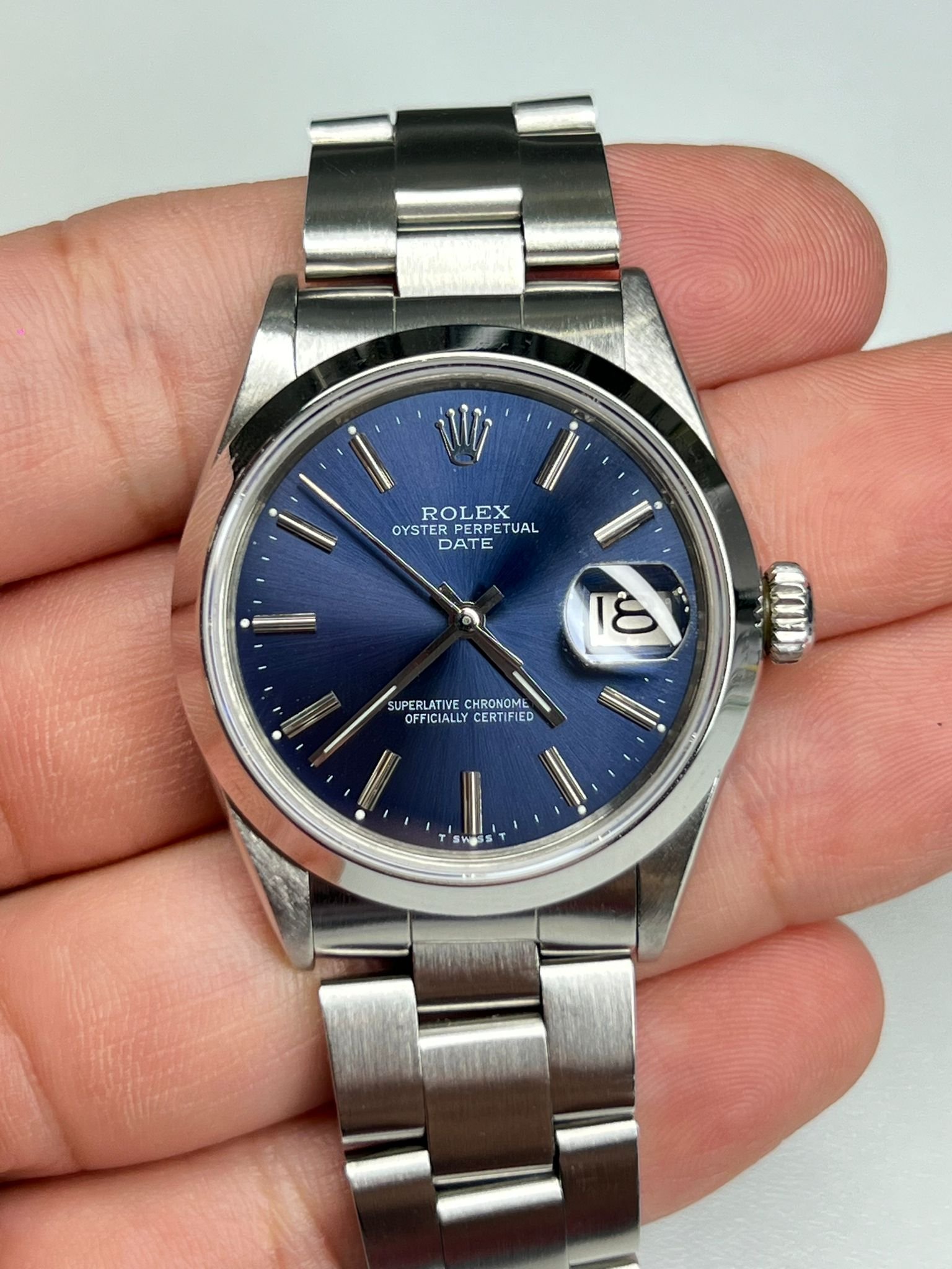

Hello everyone and thank you so much for your help. I was thinking about buying this 1500 as my first Rolex. Dial was restored. What do you think?

The dial looks nice and in good shape but why the heck is there a 1555 movement (day date) in there? Actually, it looks like a Frankenstein’d movement because there is a kif shock system, a non-chronometer balance setup, and a much earlier auto module with cal 1555 engraving, older reversing wheels and early butterfly weight.

How much would you price it?
