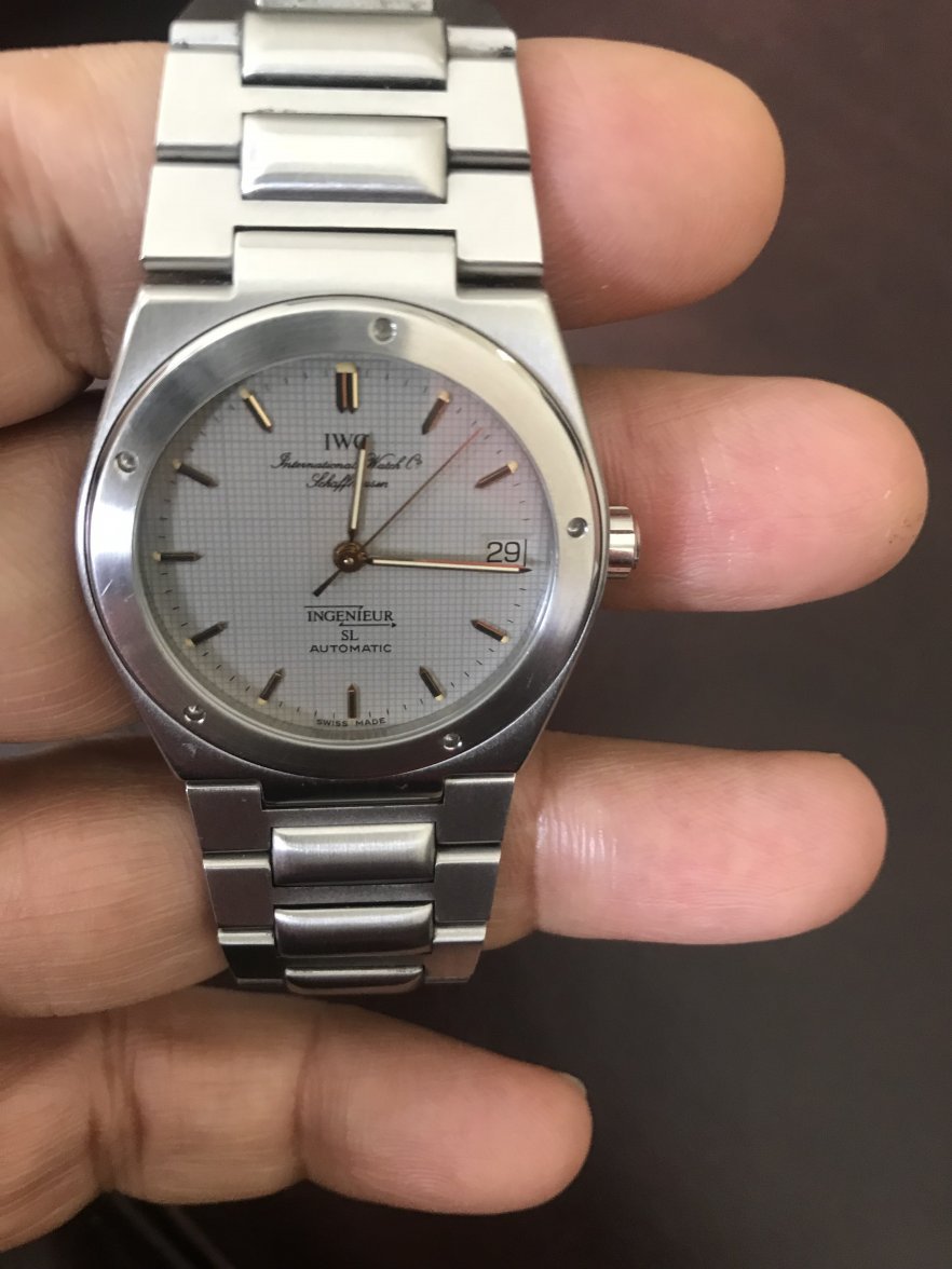

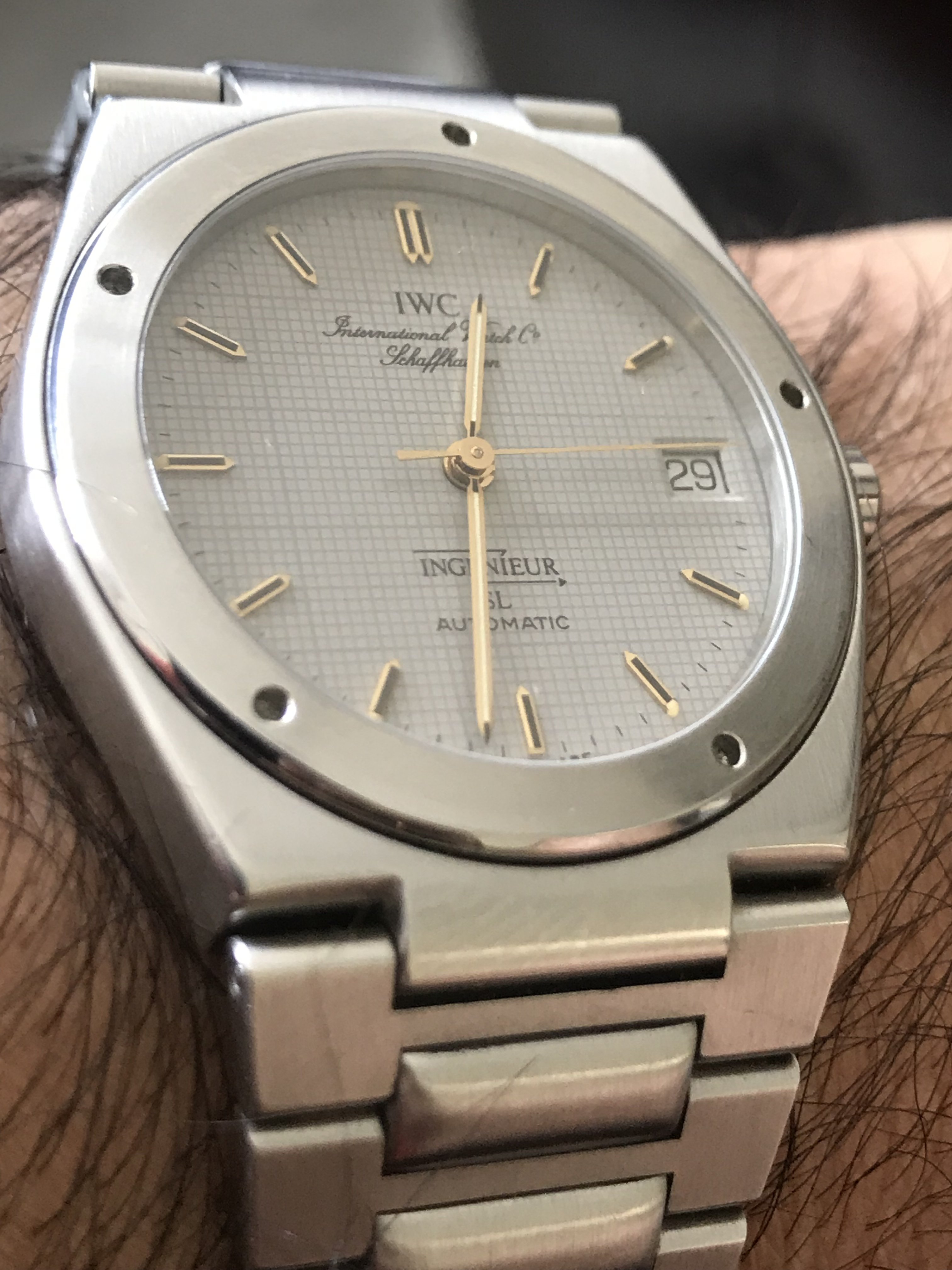

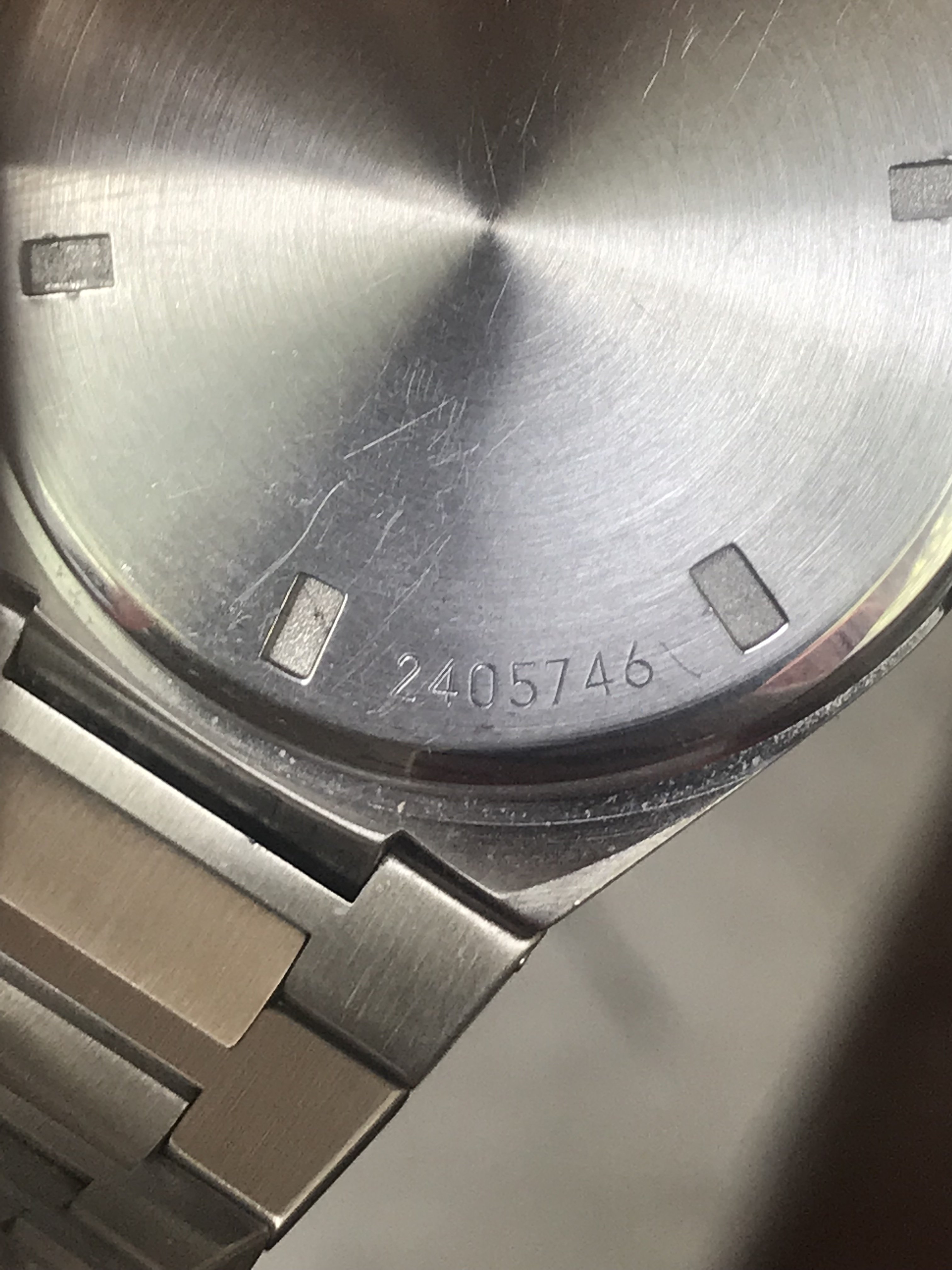

Friends, I just bought this IWC from a trusted seller. The watch is in excellent condition but is without box and papers. The only numbers I could see on the back is 2405746. It’s a screw down crown 34 mm watch.
I want to know the exact model number of this watch and the caliber inside the watch. Please help. Regards

In 1976, at the height of the Quartz crisis, IWC introduced a very small production run of Gerald Genta-designed "Jumbo" Ingenieurs. They were 38mm, massive (especially for the time), and were powered by the final iteration of the iconic cal. 85x series, the 8541ES. It was, of course, designed to resemble the already successful Audemars Piguet Royal Oak, but with IWC's superior technical capabilities. It was the reference 1832, and they are highly sought-after by collectors today.
That was the predecessor to your model, the so-called "skinny" Ingenieur, which is either a ref. 3505 or 3506. The model was introduced in 1983, and was powered by the caliber 375, based on the ETA cal. 2892. The 3506 (cal 3753) was produced from 1985 to 1989. While these models had antimagnetic qualities, they were only half of the capabilities (40,000 A/m) of their predecessors. This, coupled with the significantly smaller size, and downgraded, derivative (i.e. not "in-house") movement, makes them generally less attractive to many collectors.
The "SL" is thought to have originally meant "Steel Line", referring to the integral bracelets, but as there is evidence that they were subsequently sold on straps as well, it evolved into "Sports Line".

Thanks for your response dear. Is there any difference in 3605 and 3506 models? I meant movementwise.
7,979
27,927
As noted above, the base movement was the same (cal. 375), but the 3506 featured a slightly refined version (cal. 3753). What refinements were made, I do not know.
