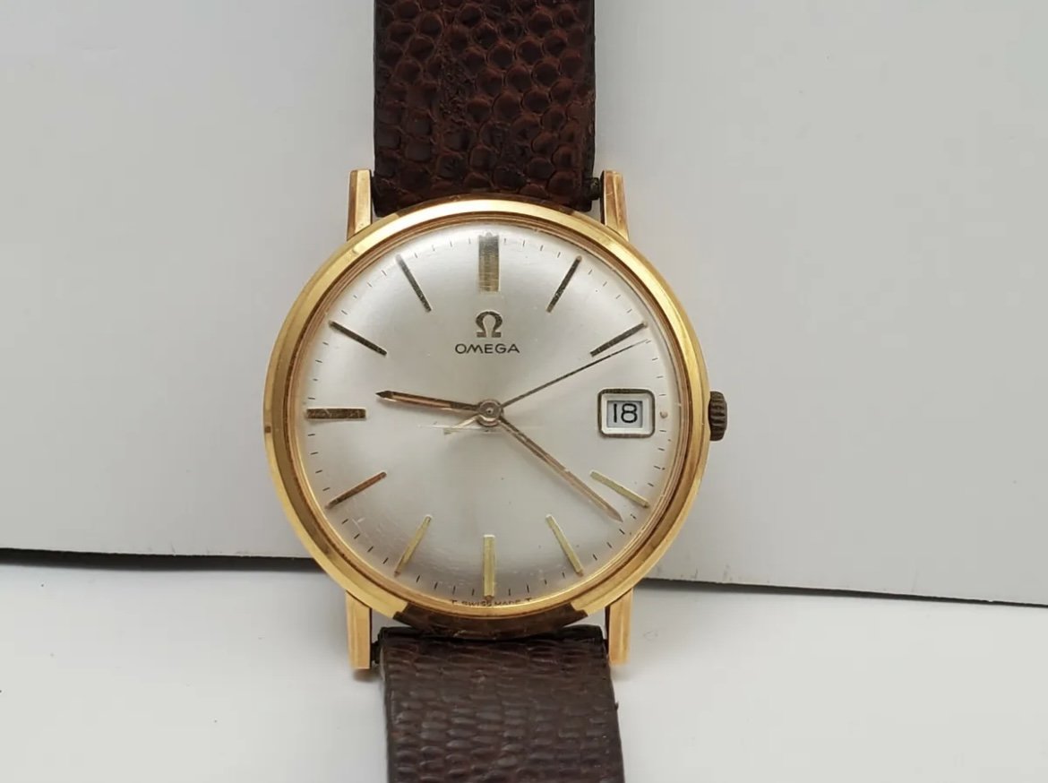

Hey! My name is Brian.
I was wondering if someone could help me locate a replacement gold filled crown, modern or vintage.. doesn’t matter to me.

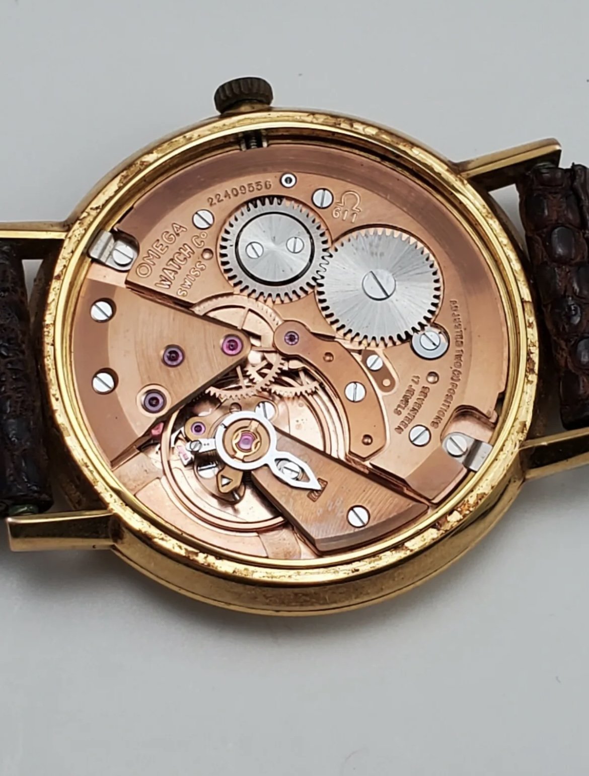

132.019 Cal 611

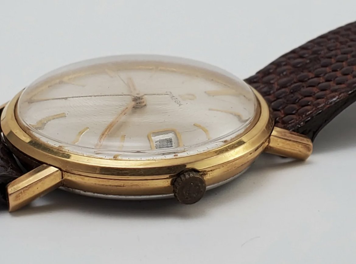

the crown unscrewed while trying to set the time and won’t screw back on. Not sure if the threads are worn on the stem but may need a replacement for that as well
thank you!! Here’s some photos

Any Omega workshop could get one for you. The part no. is 069SY32003.
Edit: That is the number for the pink plated crown, the yellow crown is 069SX32003.
2,346
1,475
If you’re in the US. Can email Jules Borel
give them the brand name, reference number and caliber number
also order a new stem
current crowns are gold plated
