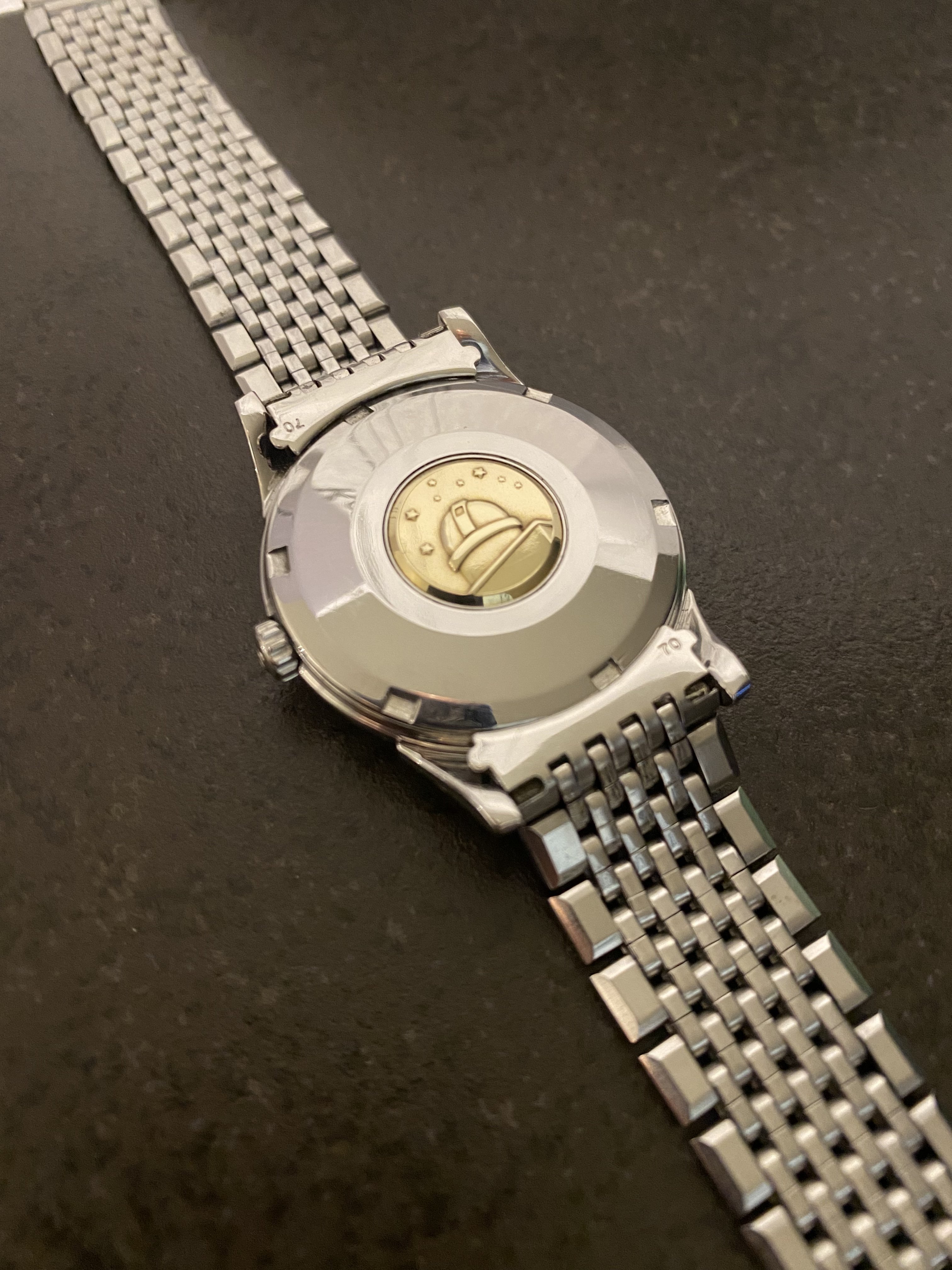

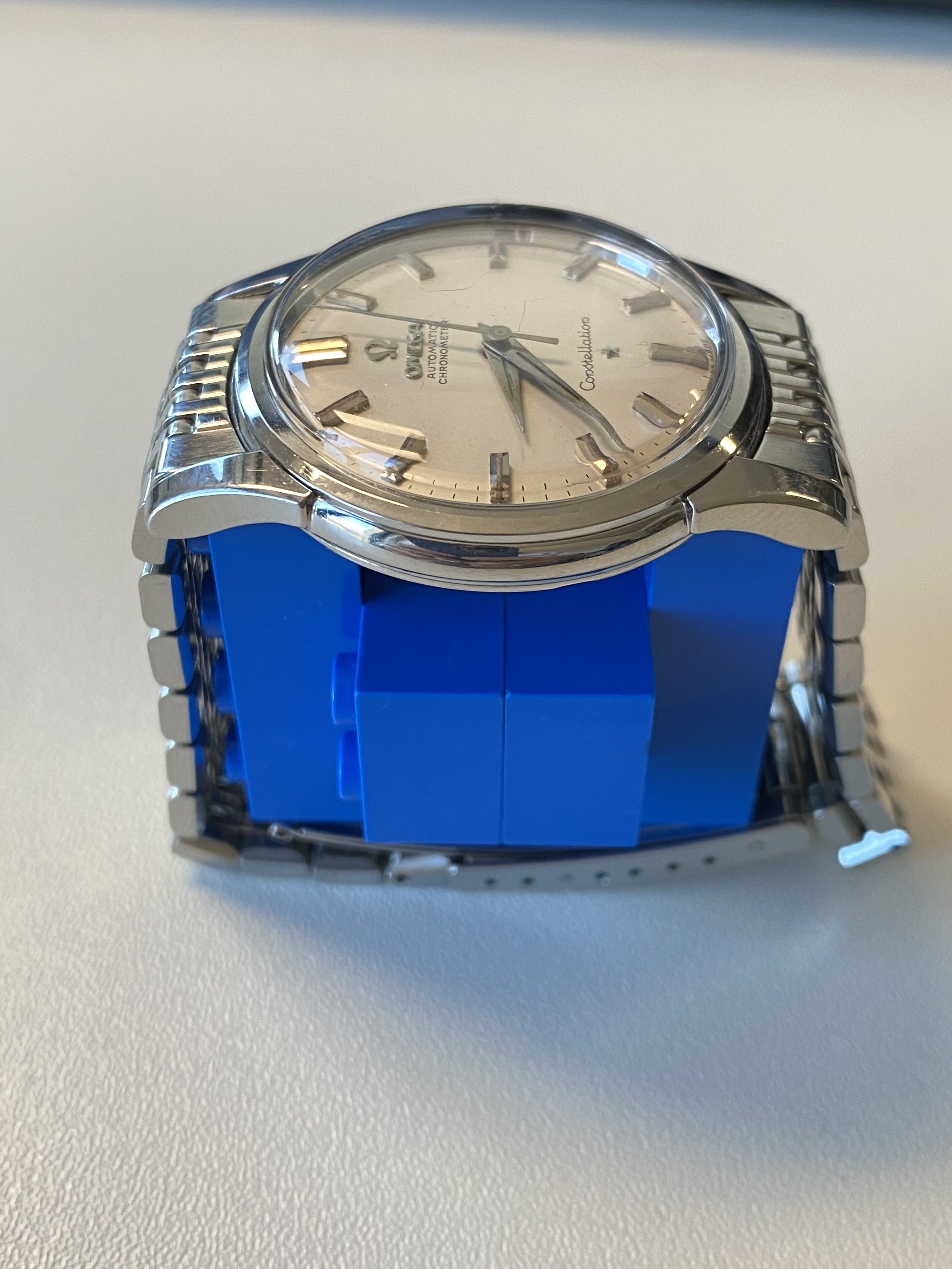

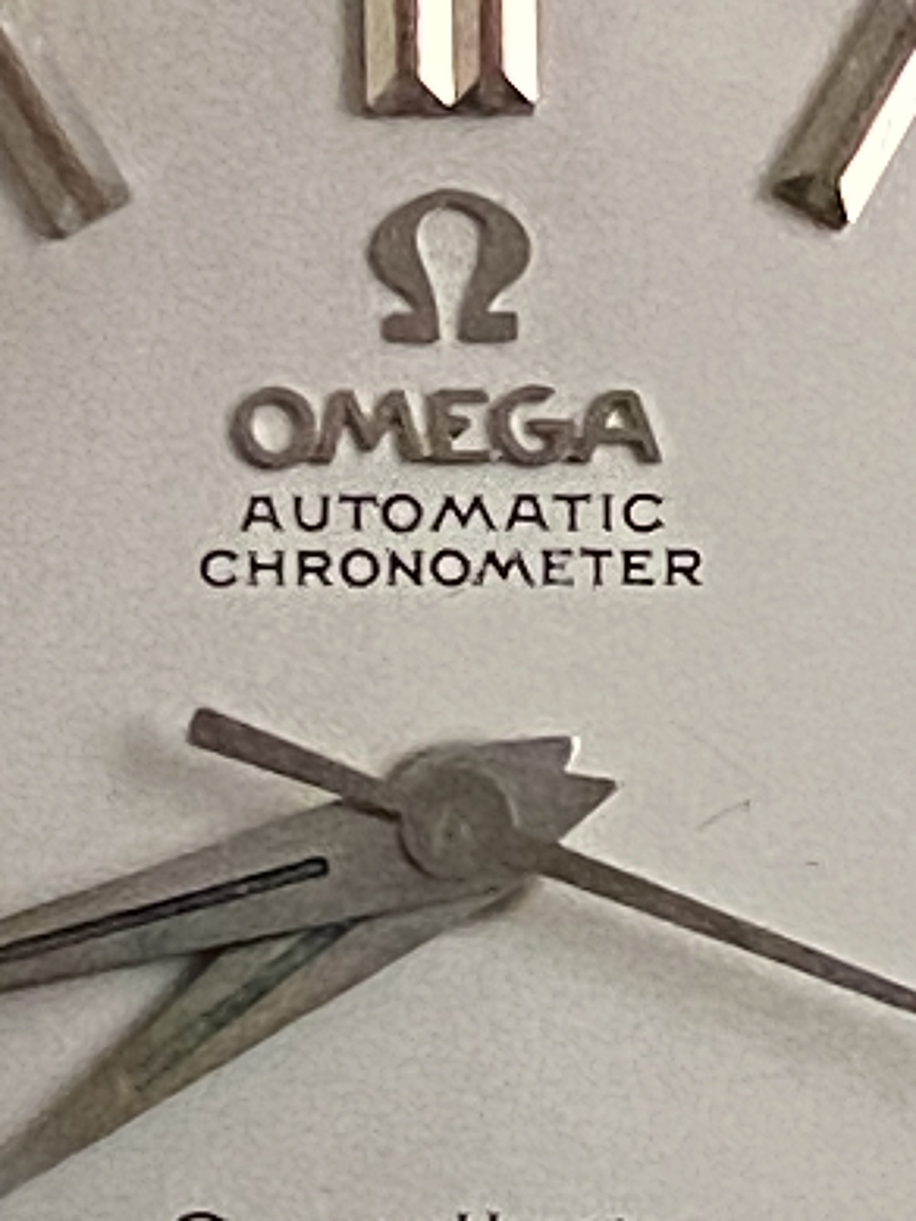

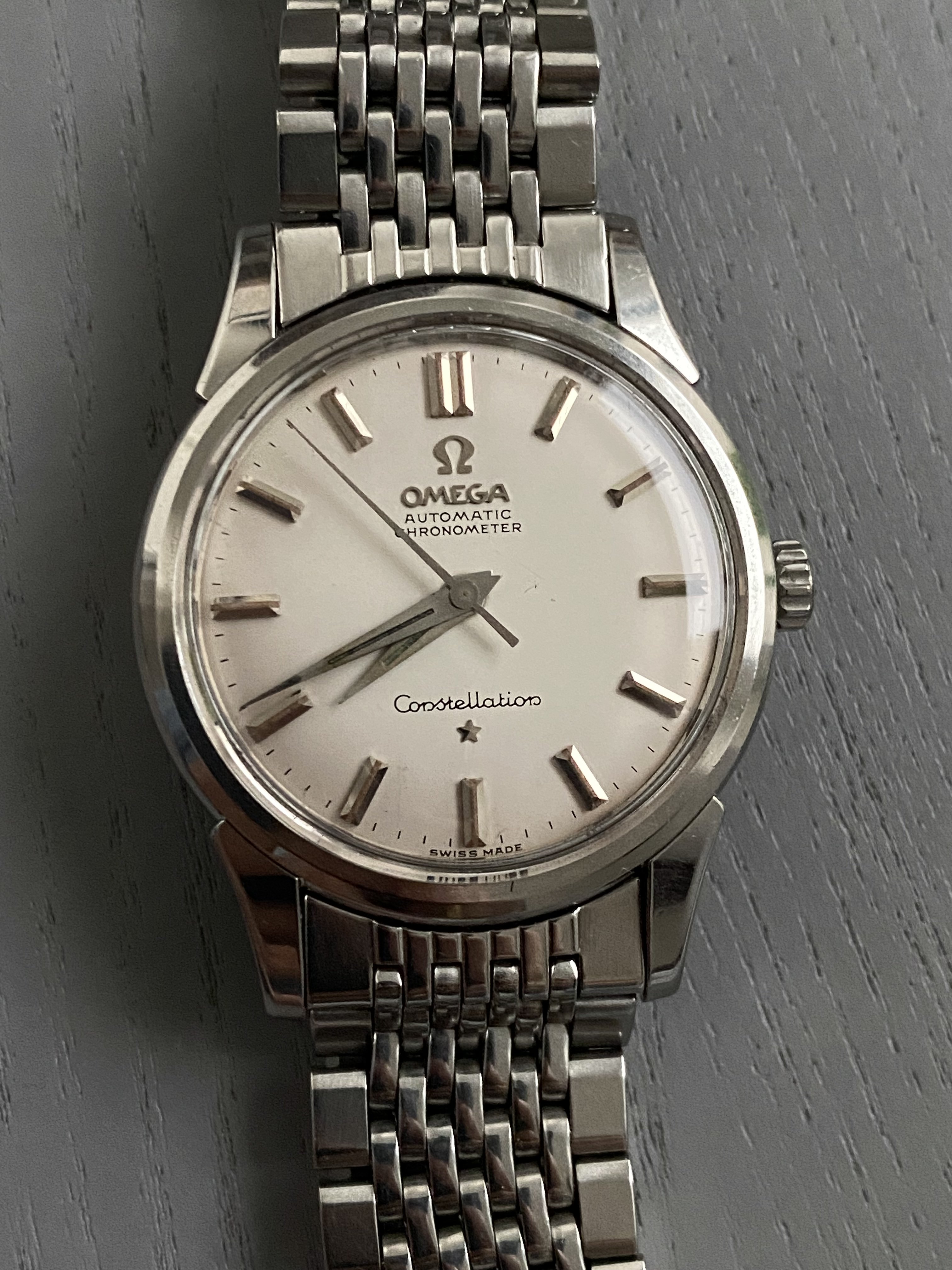

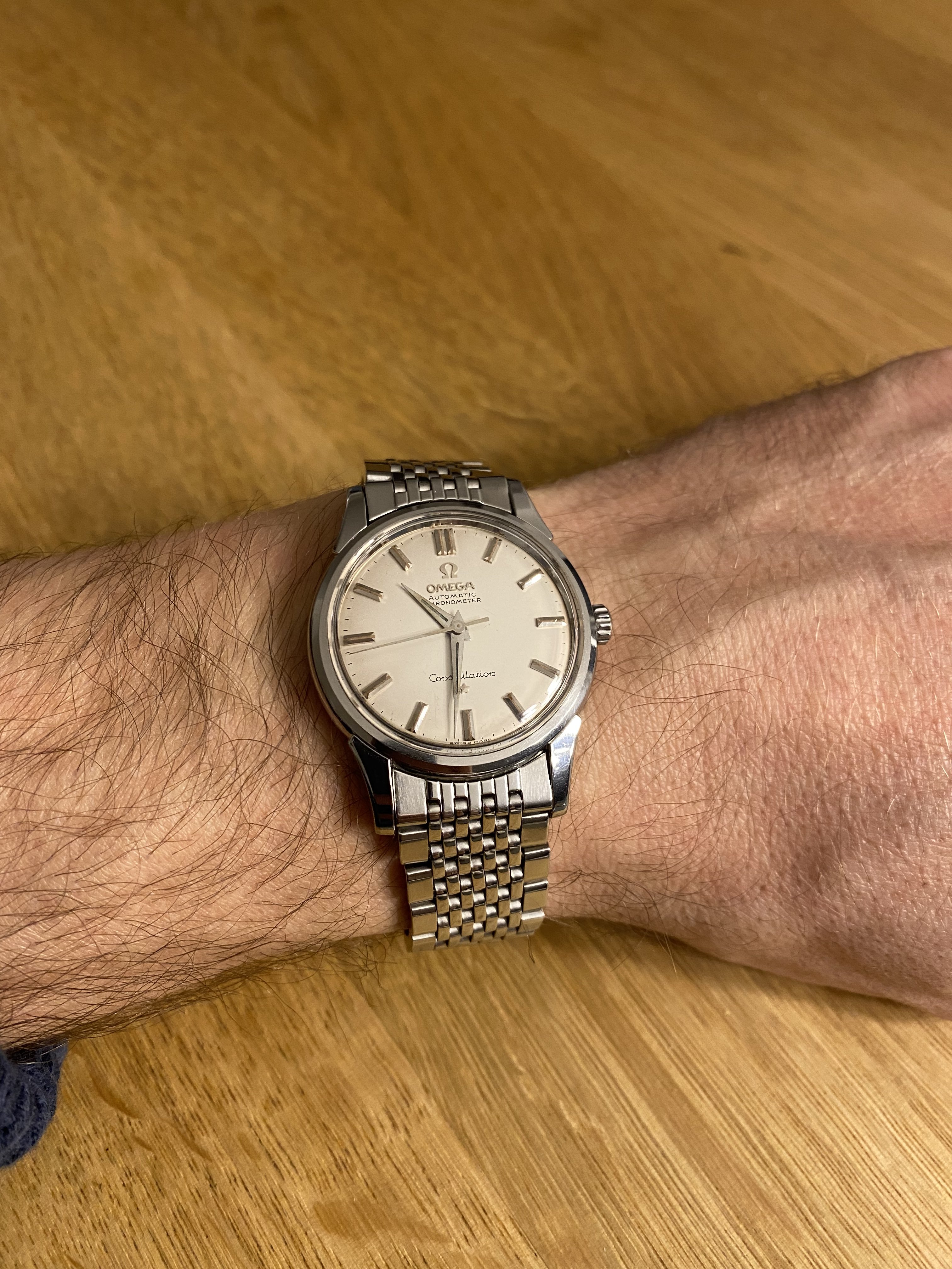

Hello all,
can you please give me your opinion on the dial of this 14381? As I understand the MOY test, everything should fit. But I am still a noob 😀.
Best, Andreas

Hello all,
Best, Andreas
Everything's fine. 😀
907
1,742
Looks to have been polished some, but not too much. I like the bracelet.

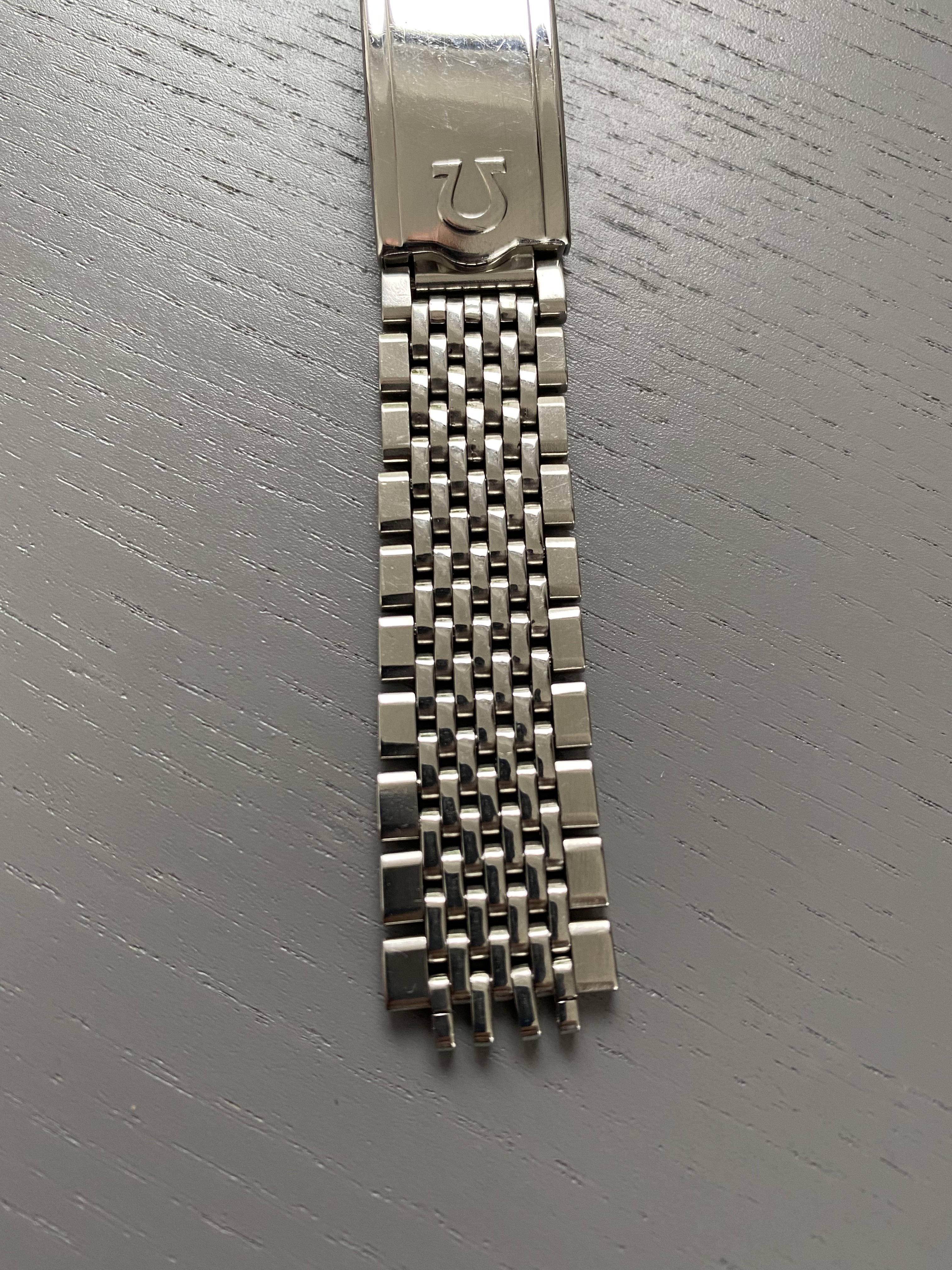

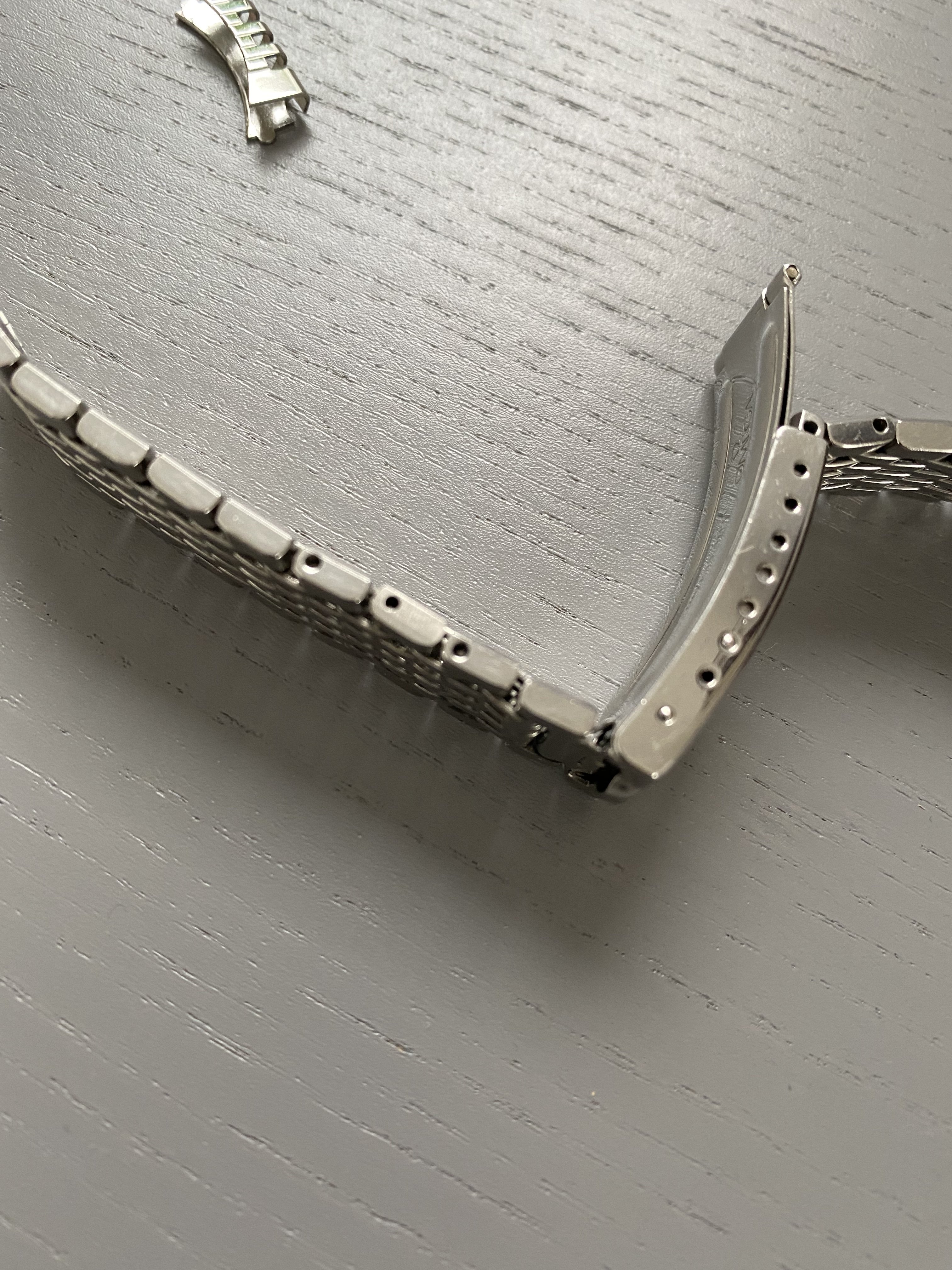

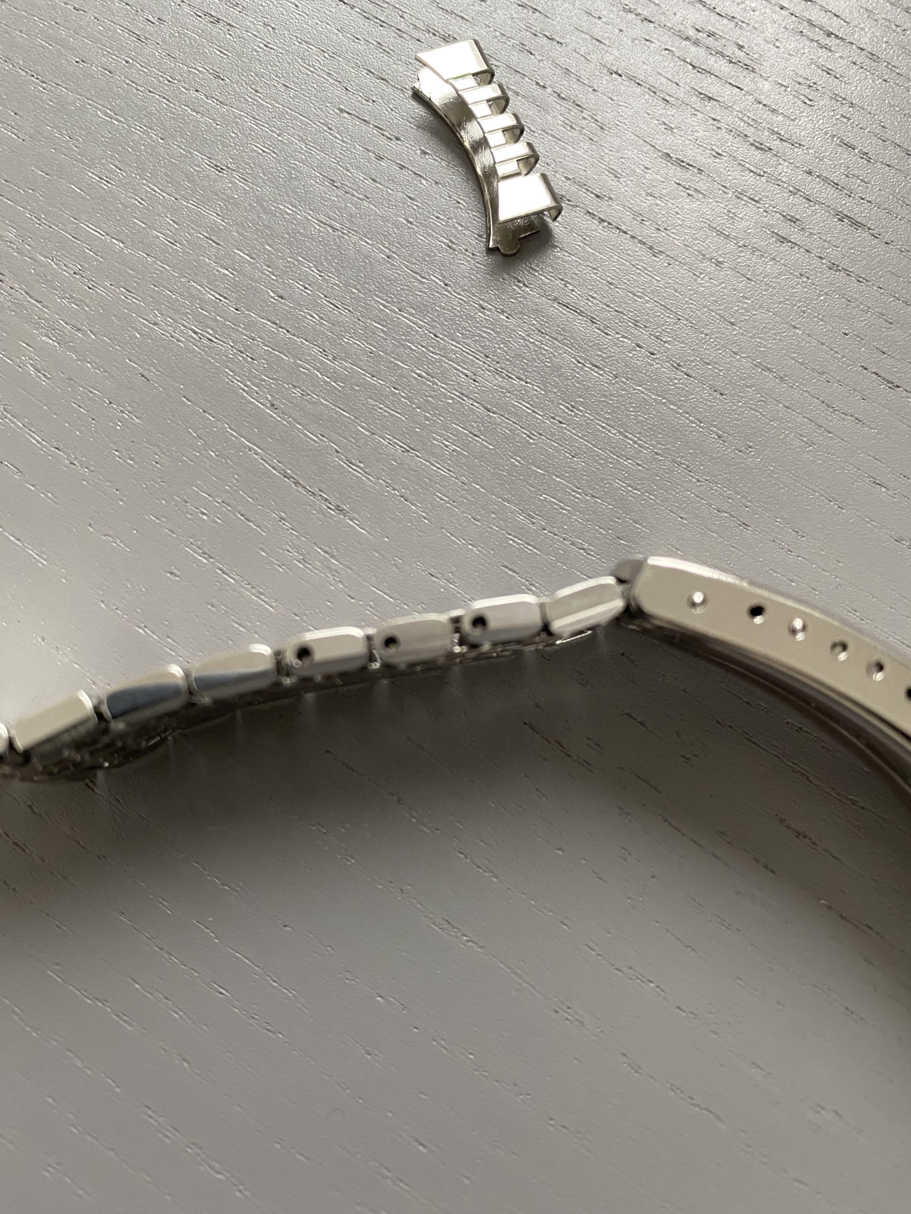

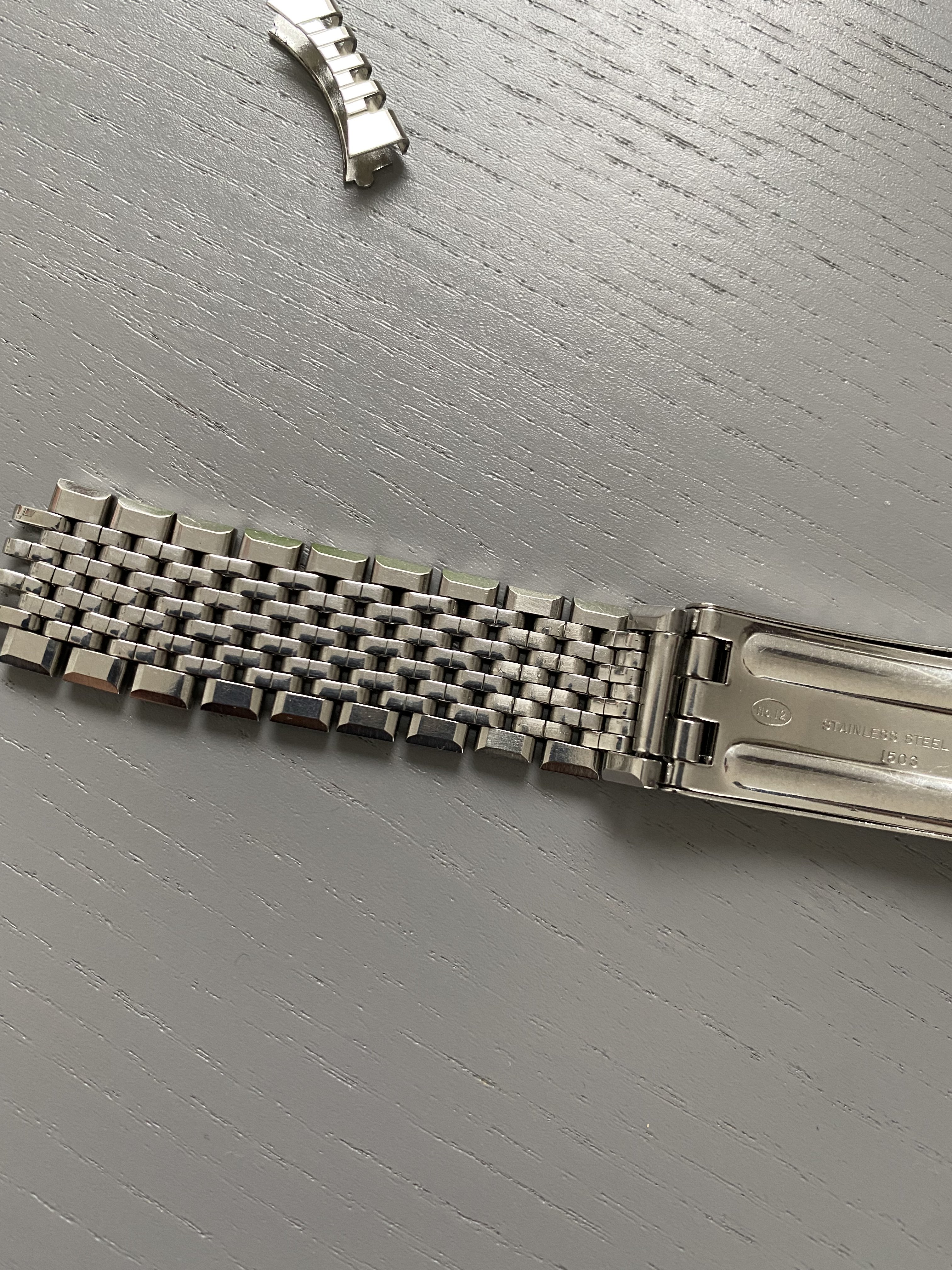

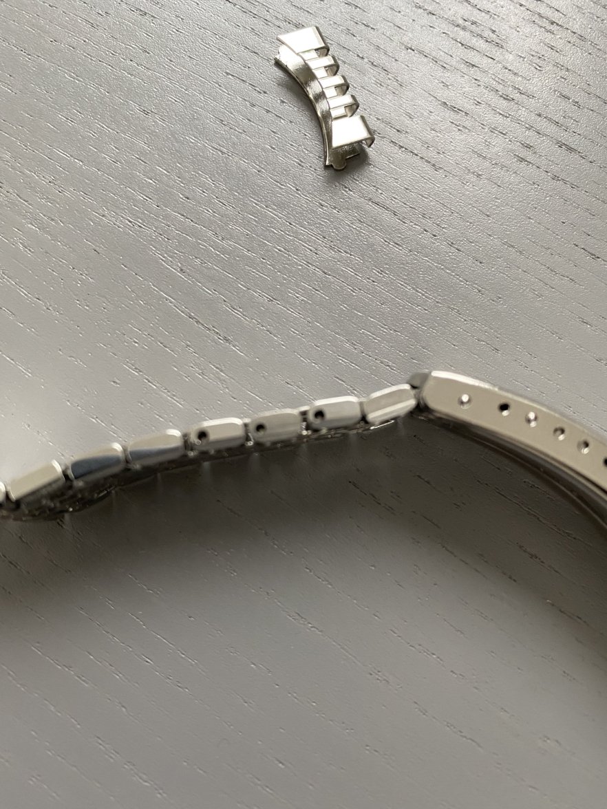

The bracelet is great on the watch. But i have to short it. The bracelet has pins that you have to drive out. Does it matter in which direction you do it?
Best, Andreas

Can we see photos? They may be small spring-bars.

Of course and thanks for support. Here some pics - let me know you need more or others…

Yup, those are small spring-bars, not pins. So don't try to drive them out.

Thanks for the good tip! Works well 😀.
I tried to take link out it was very fiddly. However with help of much cursing got it back together.

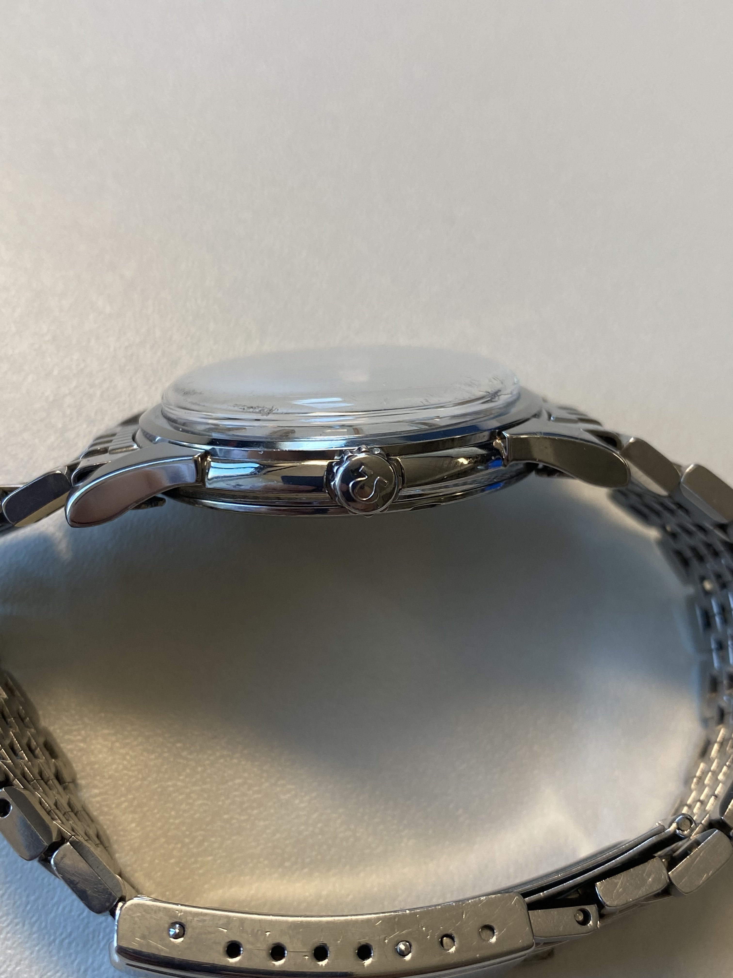

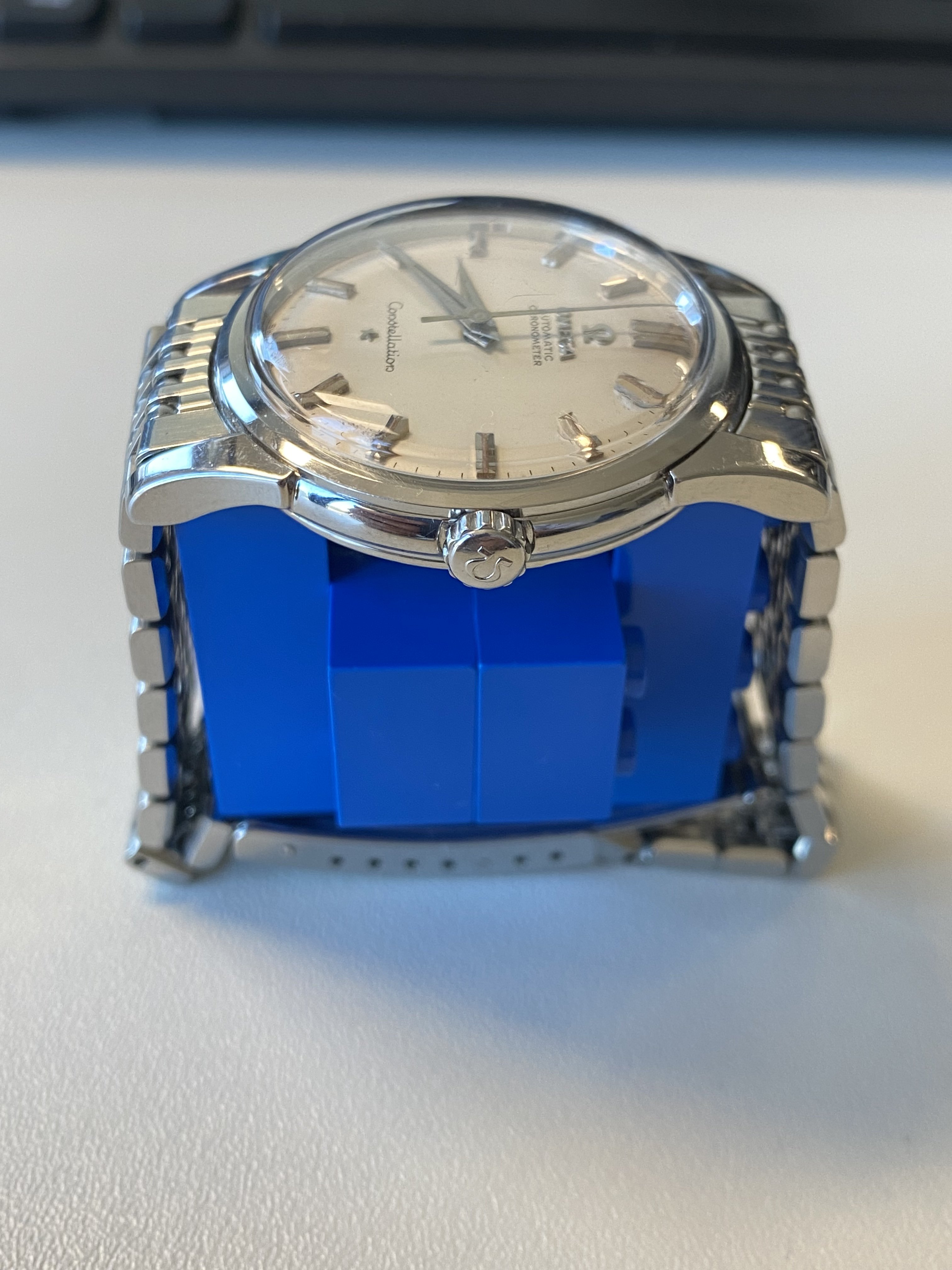

May I see more pictures of the crown (including the side view)?
