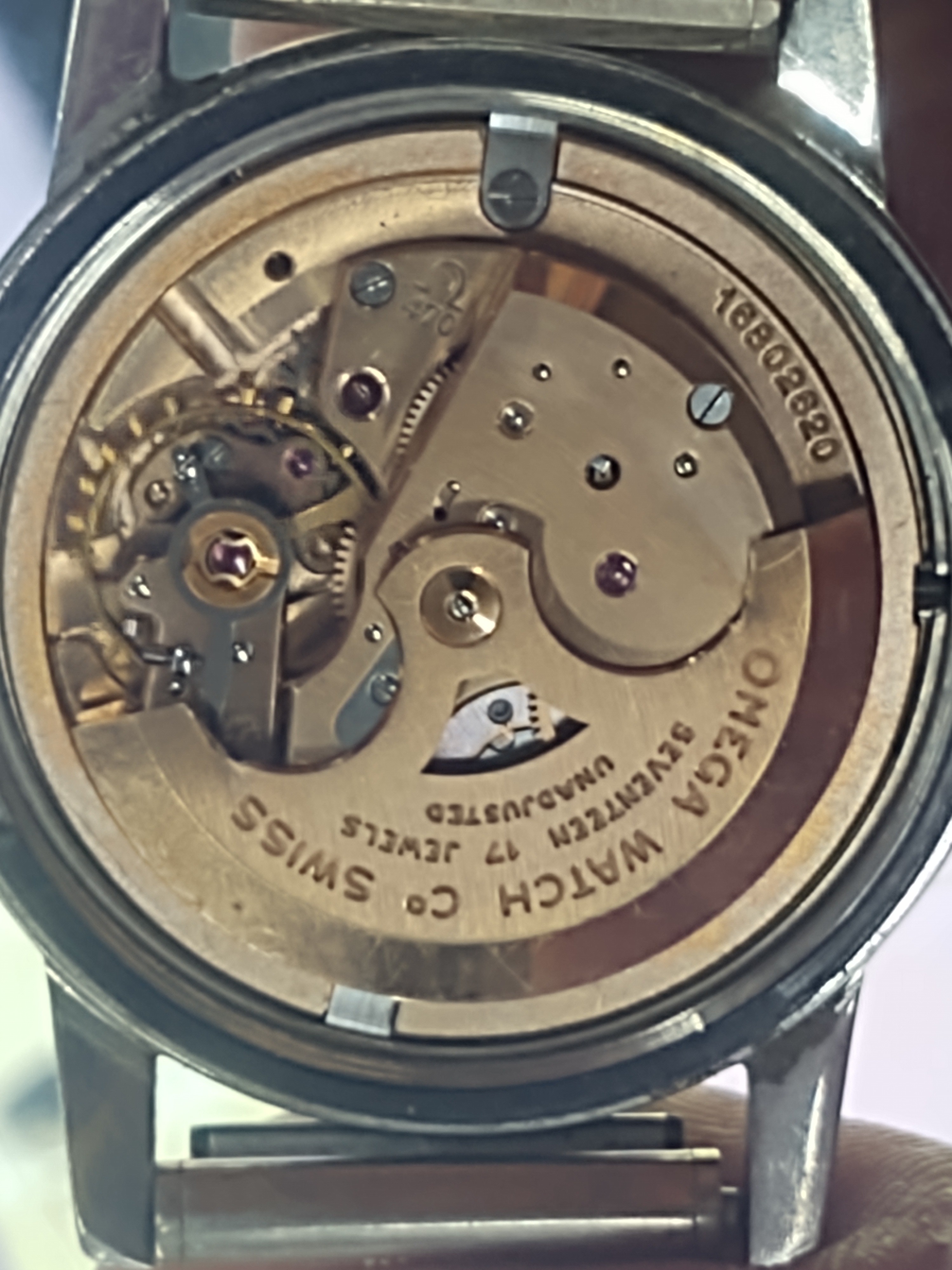

Please help decipher vintage Omega #'s
24,836
55,256

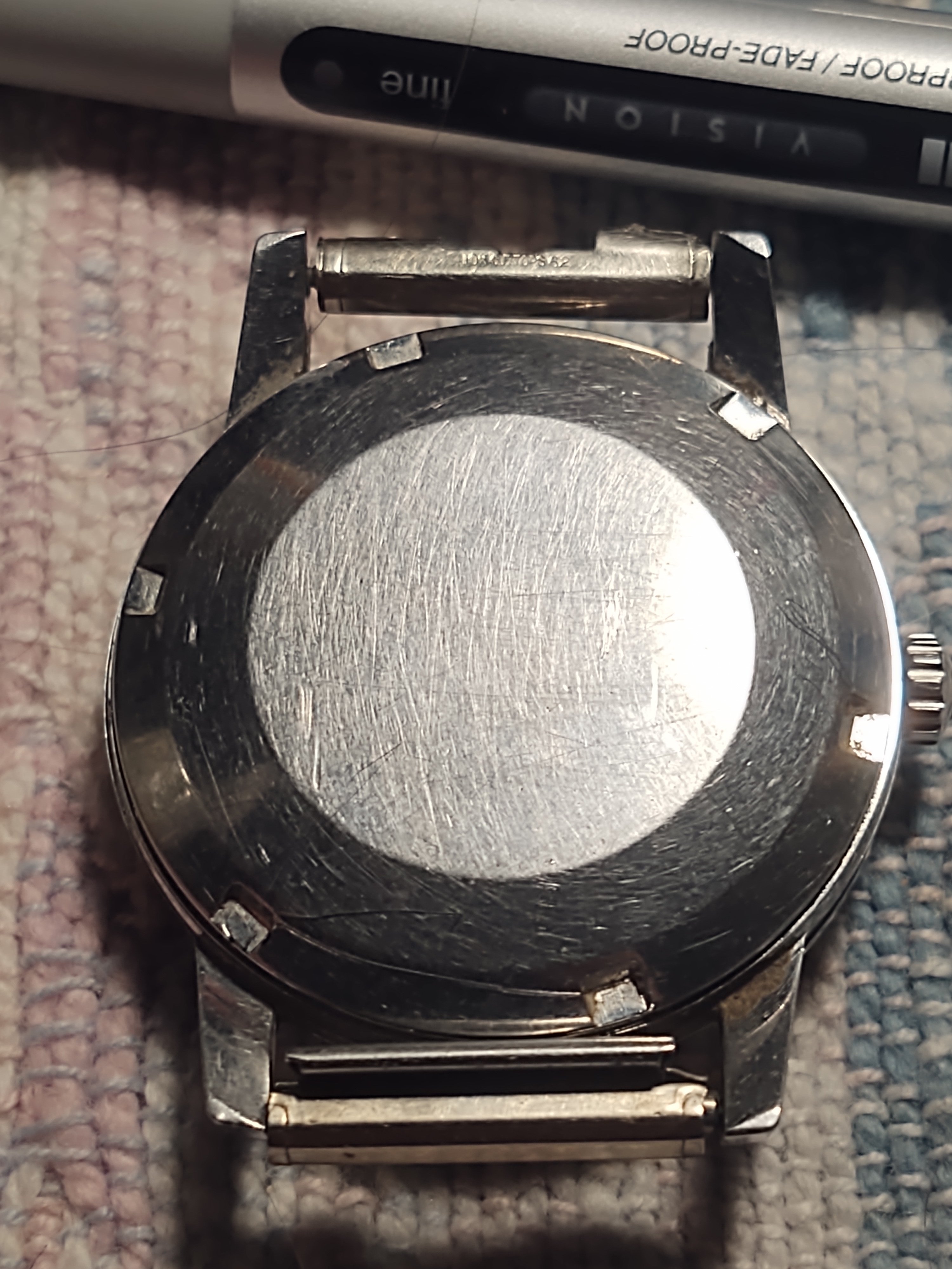

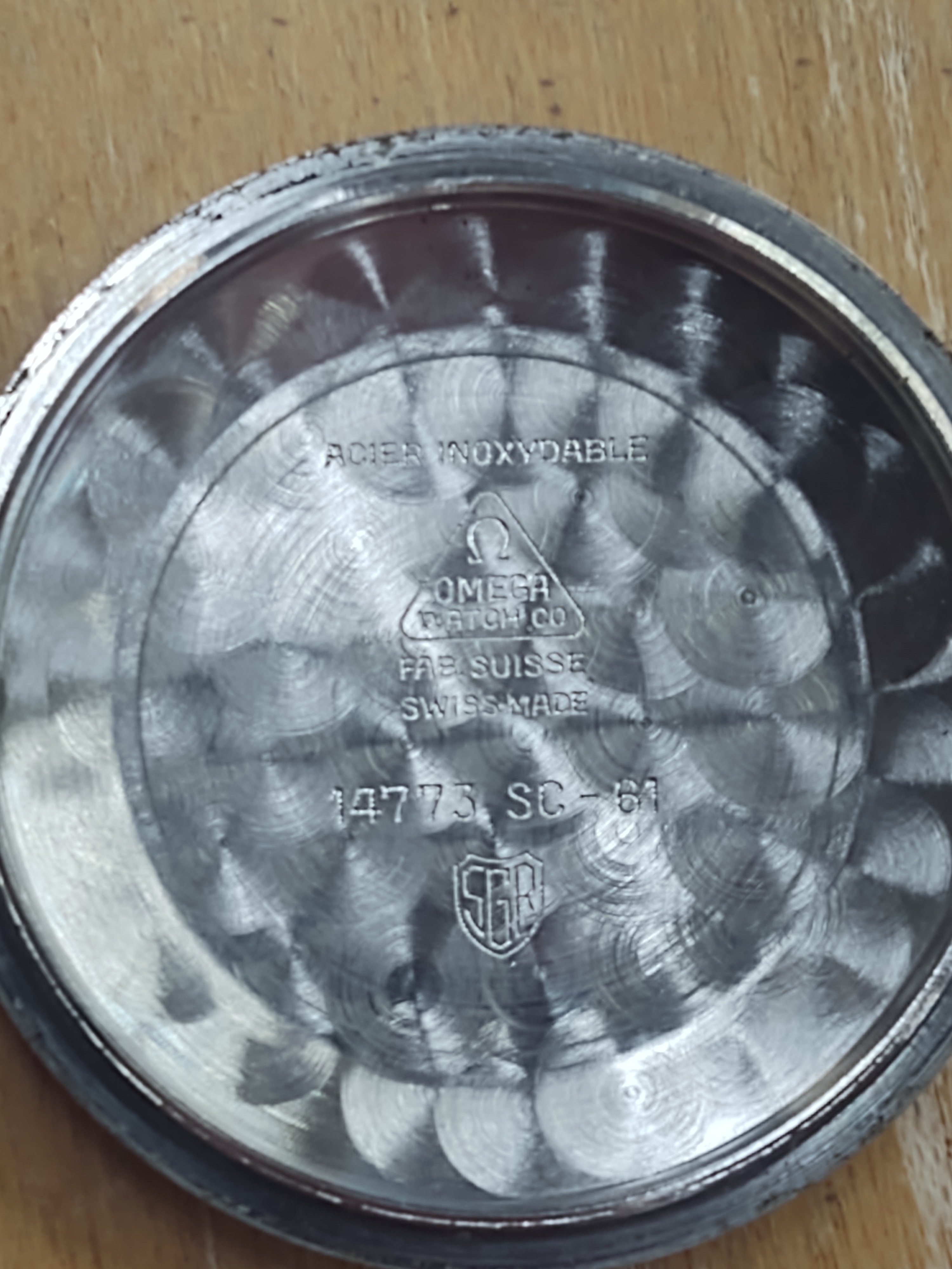

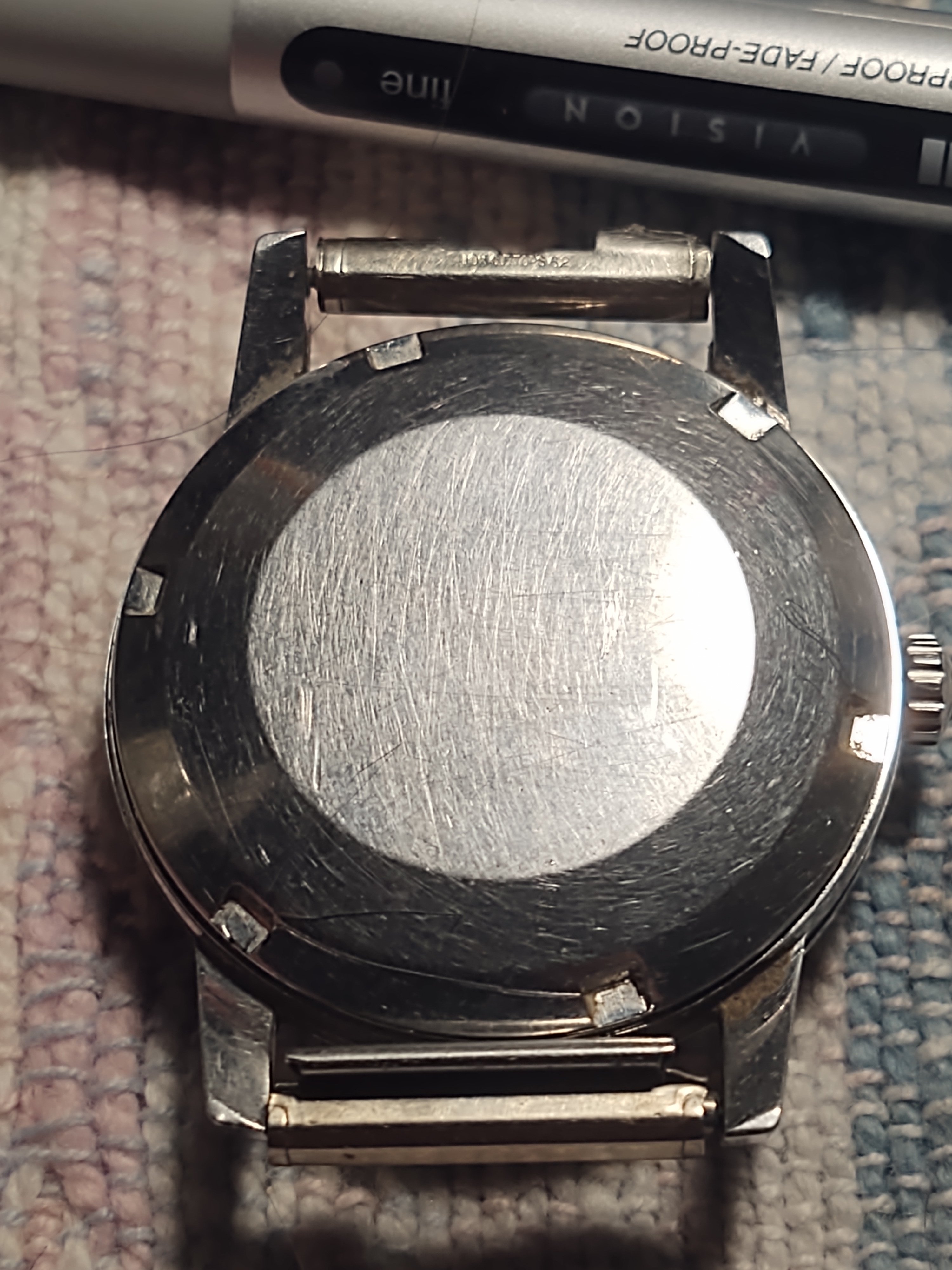

Here are more pics of the watch as well as the first two I attached. Watch runs perfectly. How do you tell what metal it is made of? I'm leaning towards selling it. Opinions on adding a band or doing anything else to it? Thanks.

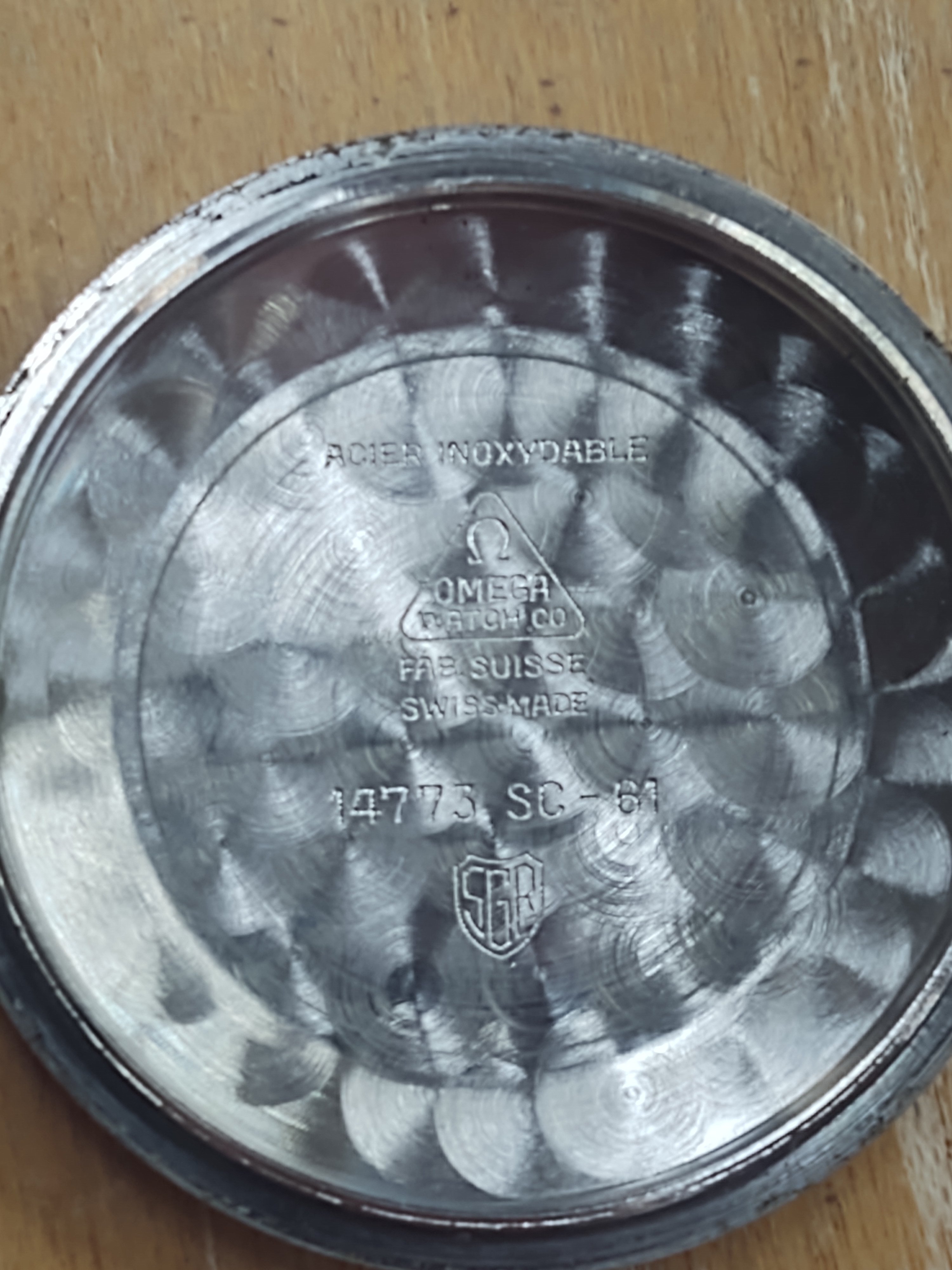

acier inoxydable = stainless steel
Sell it as is except for removing the remains of the bracelet.
Most people would prefer to clean up/service a vintage watch themselves.

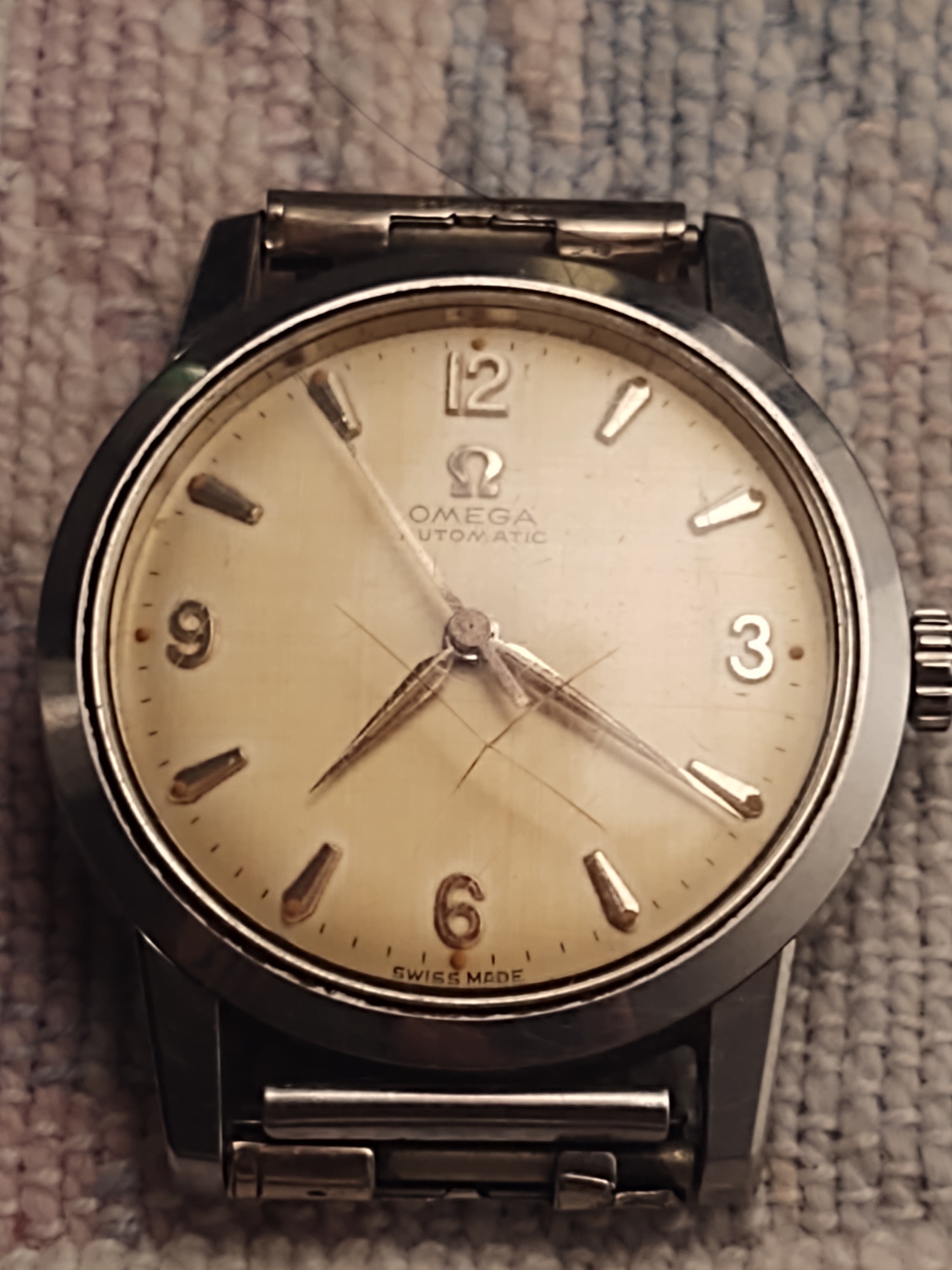

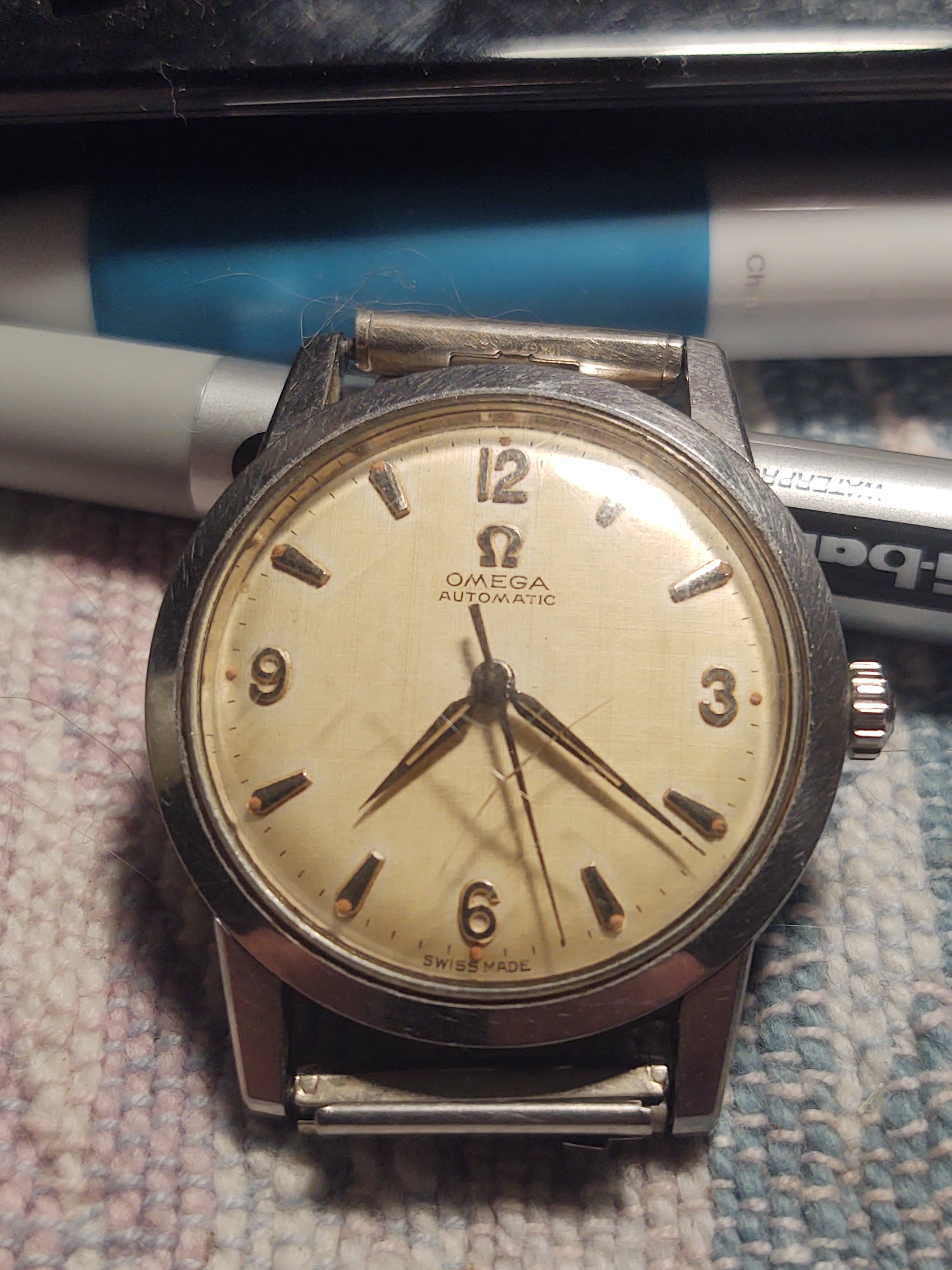

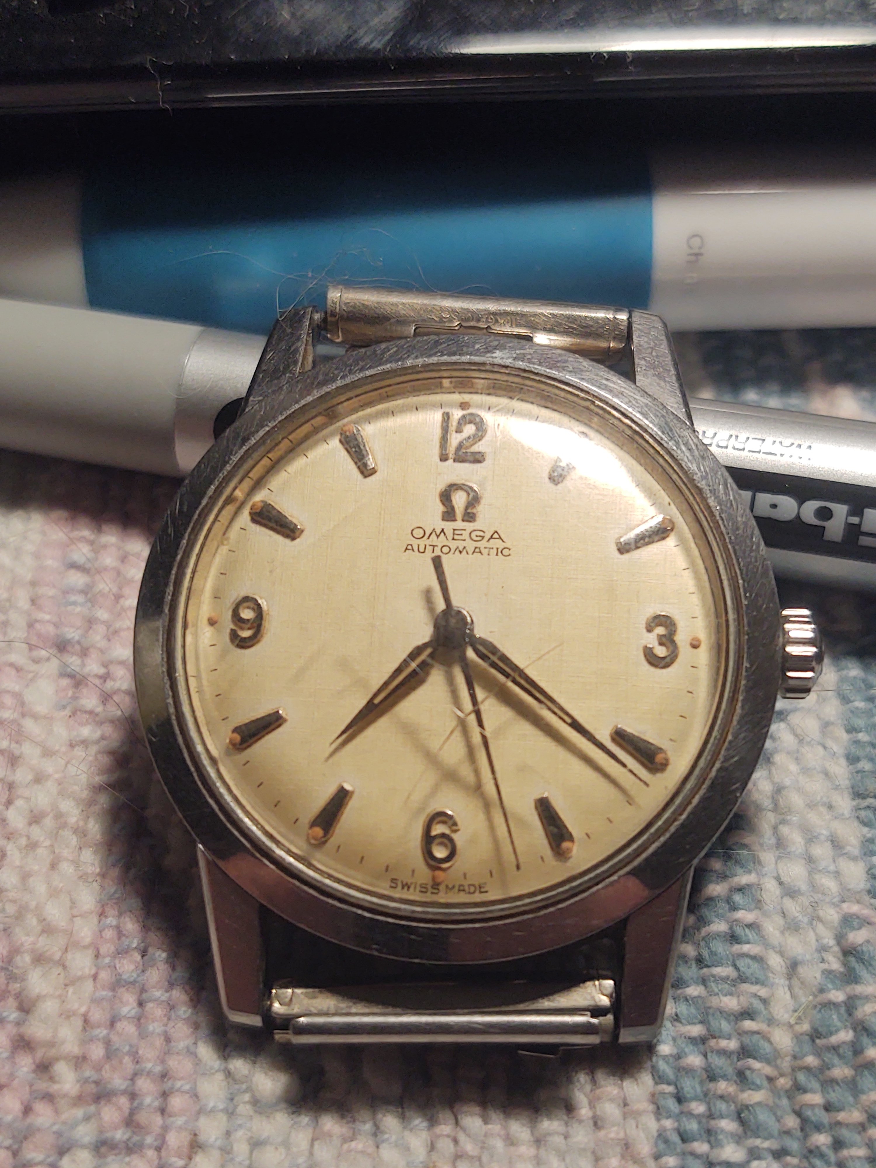

Sounds good, thanks. So I've seen a lot of comments about components being replaced. Is there anything that stands out as not being original?
13
Nothing to worry about with the case-back, just a variation, and yours is legit. The digits after the main reference "14733" refer to production batches and the SC is a code for center-second.

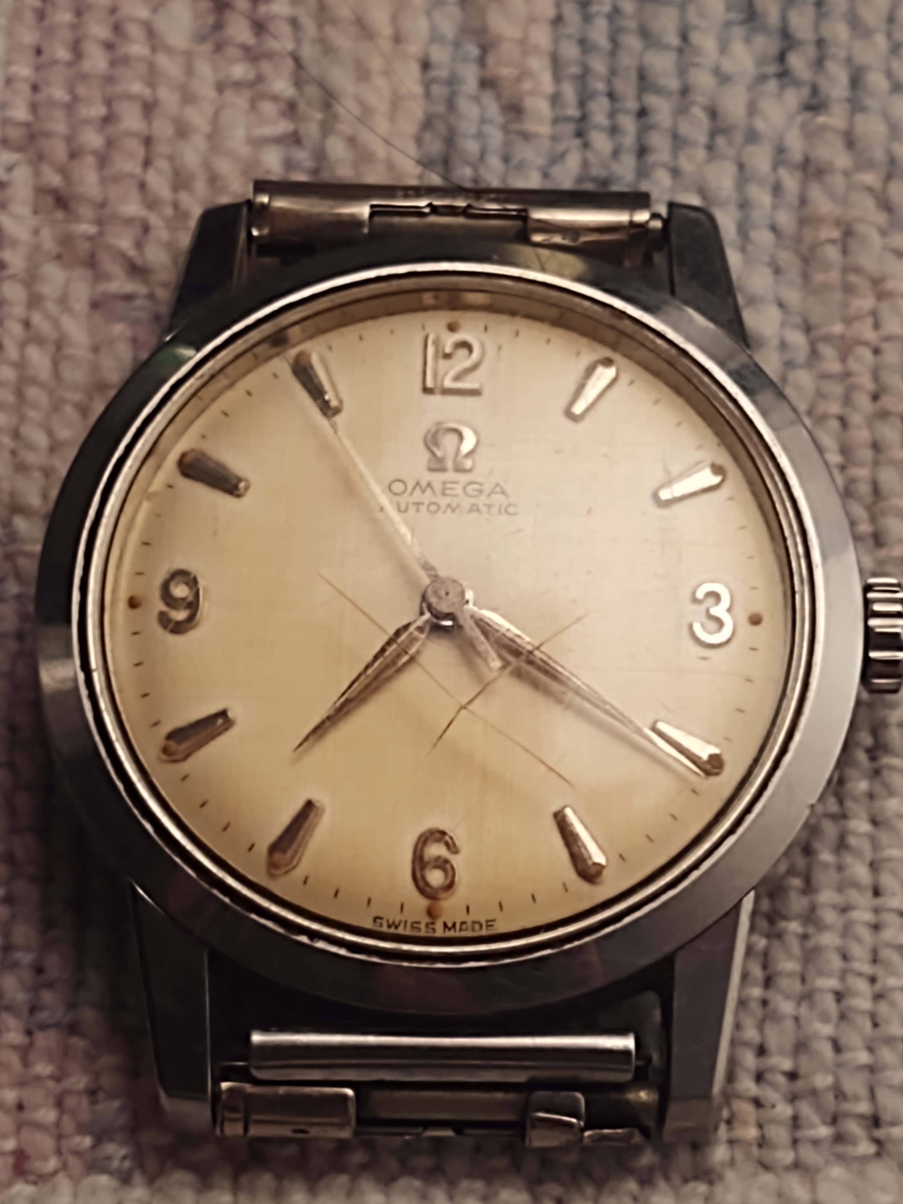

Some early Seamasters did not say "Seamaster" on the dial, but yours seems quite late for that. So it's possible that your dial was replaced or repainted. We would need to see good photos of your dial to give an opinion about it.
13
I added some other pics. Hoping to get your input on condition and anything that may not be original. Thank you!
13
