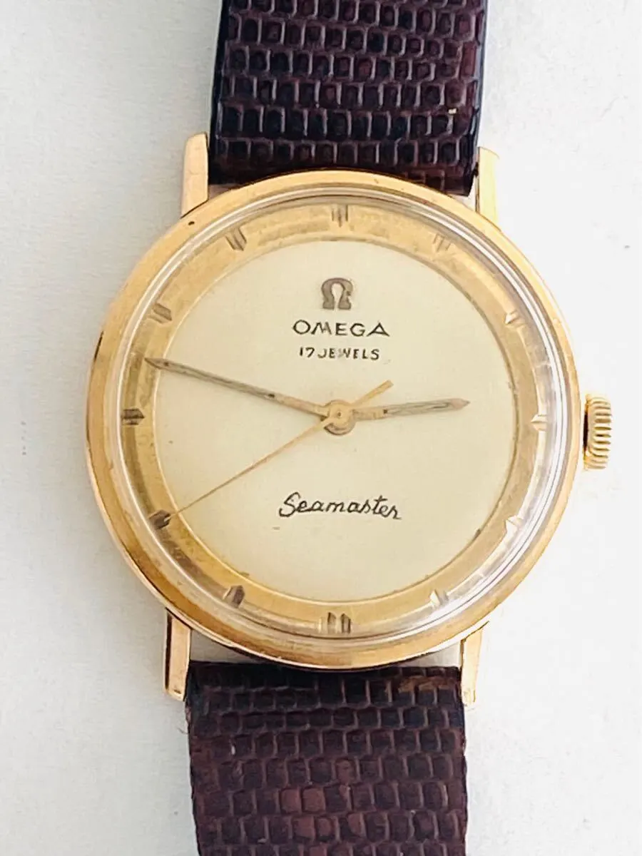

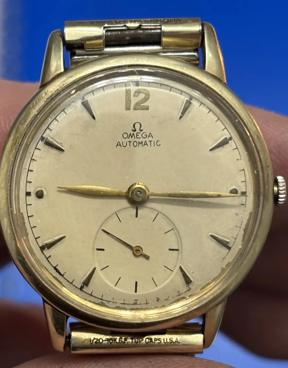

Hey guys,
I recently bought this Omega Seamaster from an online Auction in the US (I'm from Australia).
I'm just struggling to figure out exactly what model I've got here. Ref number is 2996-1 on the case back. Serial number is 16853036.
Going off of that serial I know it's a 1958 model but given the ref number is 2996-1 I was under the impression it was a Ranchero (Seachero) but haven't found any that are gold plated so I'm a bit stumped.
Any help/advise is much appreciated!
Cheers guys.

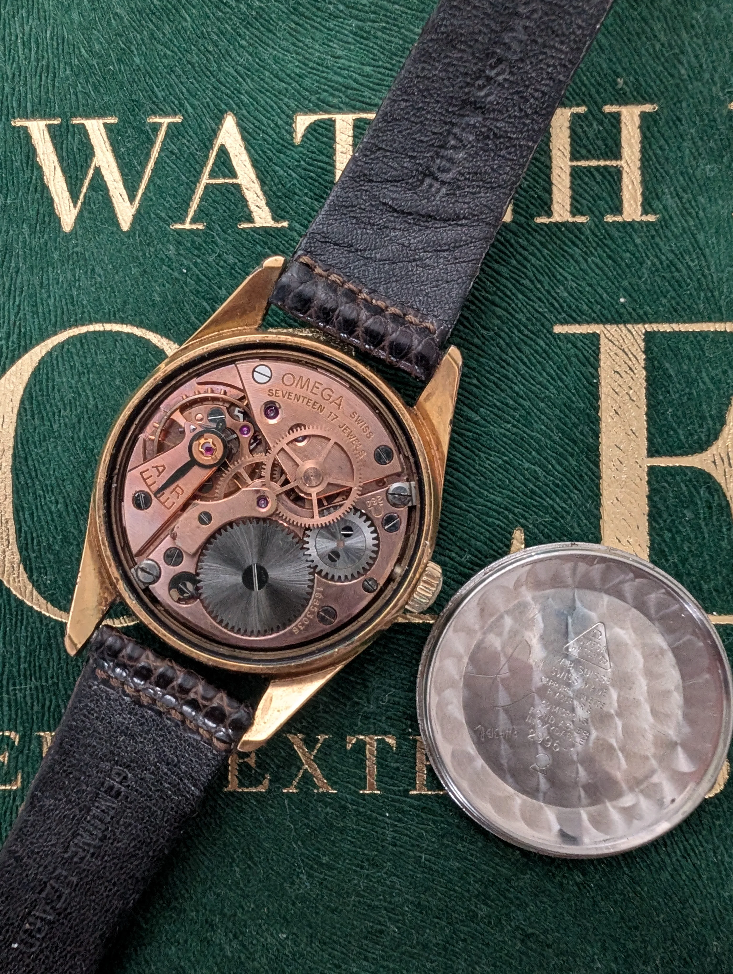

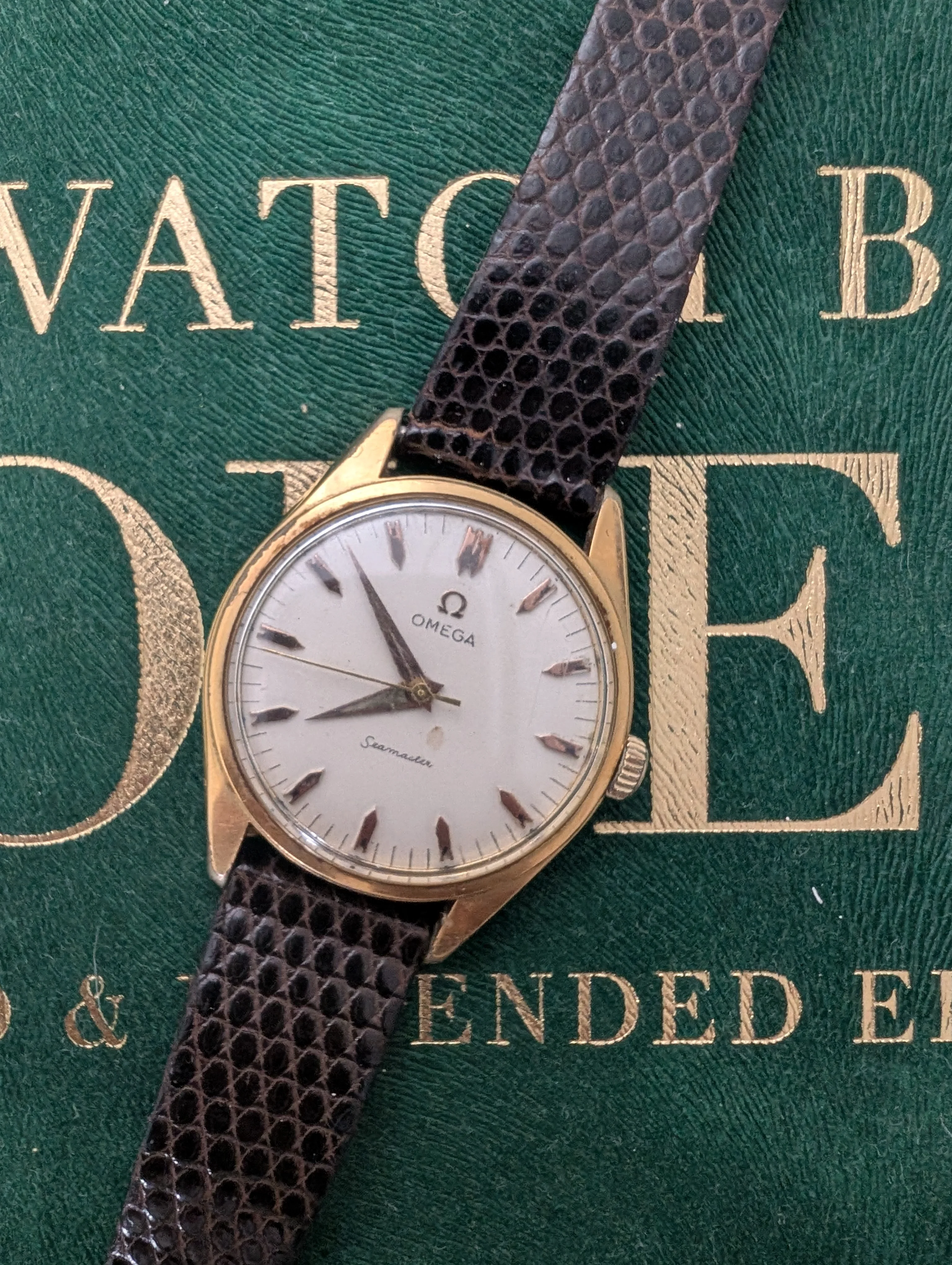

The movement and case look correct for a 2996. I fairly sure gold plated was an option.
However, the dial has been very poorly repainted and it looks as though some of the gold plate has worn away from the bezel and lugs. Hopefully you didn’t pay much?

Thanks, paid a fair price for the condition. Thinking of possibly getting it re dipped.
13,559
23,507
Obviously it depends on what you paid, what your plans are and how much enjoyment you’ll get from a restoration, but 9 times out of 10, it costs more to restore a watch than to just buy a good one in the first place, and you usually still don’t end up with a good example.
In this case, you could have the case replated, but the dial is still repainted which hugely impacts collectability and value

Yeah completely understand, would only be for my benefit, but I do enjoy the 'worn' look of it.
Can you give me a better understanding of how you can tell the dial has been repainted?

The more correct examples you see, the worse this one will look.
One has to look at 100s of examples, some here have seen thousands. These watches were mass produced and not rare. In many ways the best ever made.

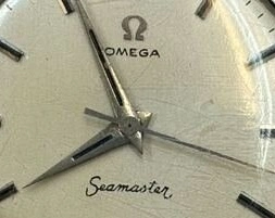

Extremely poor quality of the font, minute ticks etc. Swiss Made seems to be completely missing and Seamaster looks to be scribbled on by hand. This isn’t anywhere close to the quality of an original, unfortunately.

The obvious signs are the minute ticks (too big) the "Omega" badly done and out of proportion and the "Seamaster" is nothing like the text that should be there.

The capital S seems different than verified exemplars and the space between the a and m make it read "Sea master"

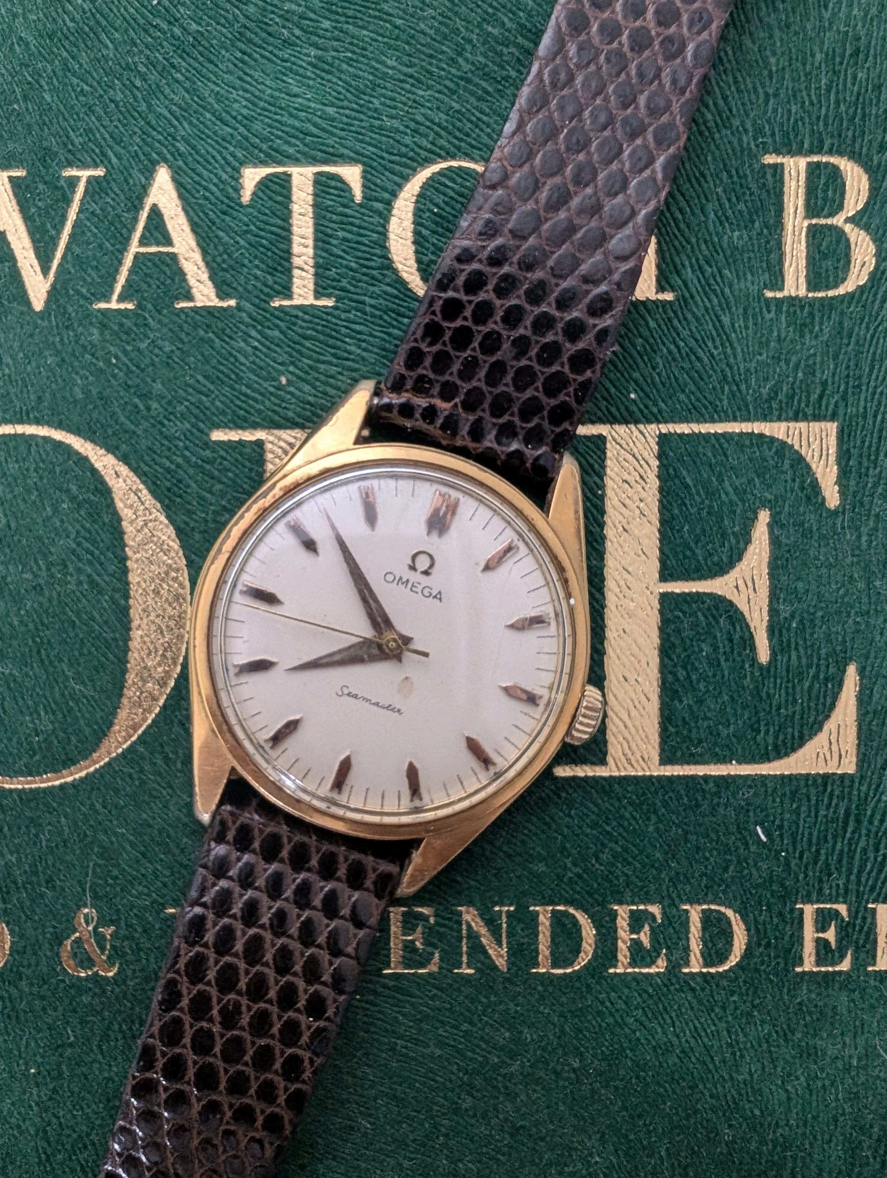

As others have said, when you know what correct looks like, this dial is very wrong. The print is very poor quality, the fonts are wrong, the minute marks are too large.
