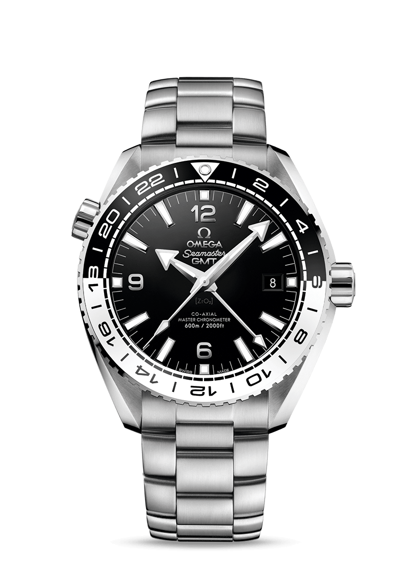

So, in regards to the misaligned bezel...
Look closely at this pic directly from the Omega site...
Can you tell that the primary marker on the bezel is just a little off of the 12 o'clock position? This is what I was trying to explain above.
I looked at the other PO GMTs, it's only like that on the Black and White models. The others are perfectly aligned. Weird.
718
732
Seems like just a weird render...
If you look at the bottom 6 o'clock position and the 12 o'clock on the bezel, its similarly slightly off in the same clockwise direction. Same goes for the 9 o'clock position. Yet somehow 3 o'clock is lined up.
Now look at the bottom of the bracelet and the shadow. Looks like the rendering of the entire watch was slightly off axis.

Does the bezel also seem more properly aligned now? I just can’t unsee that..lol
5
7
guppydriver...
Good question.. No, the bezel is still not perfectly aligned while in the 12 o'clock position.
From looking at various manufacturer photos, I'm under the impression that that is how these PO GMTs, with this style of bezel just are. Once I came to notice it consistently, it became less of a concern.
