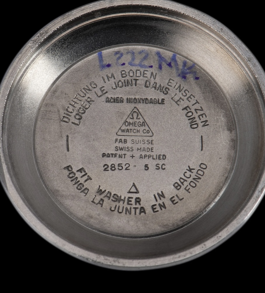

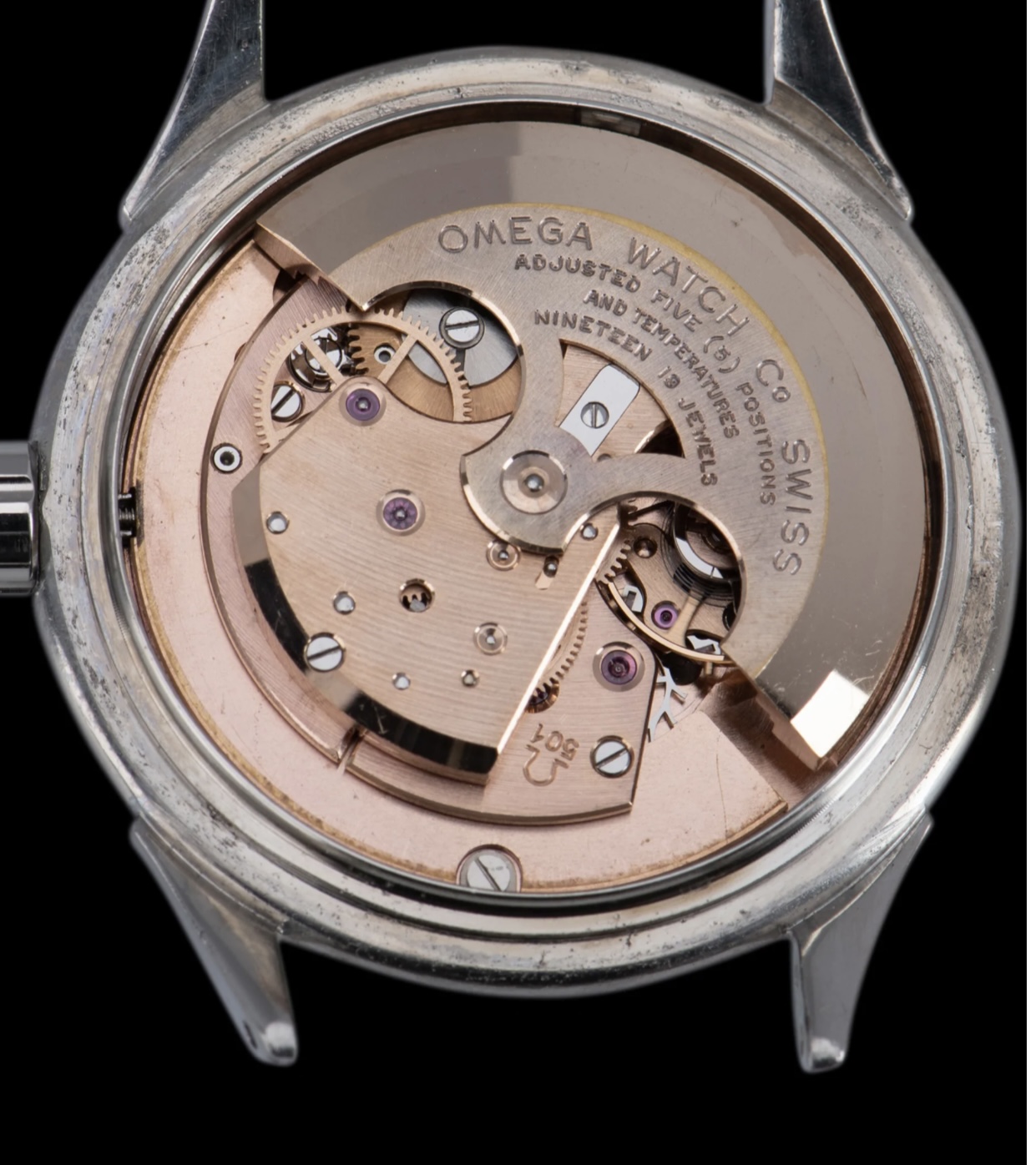

I might be confused...so...is it possible that 2852 / 2853 (don't know why there are two numbers?) could have a 501 movement then?...according to the Omega link you posted?
Yeap, I have a Cal 501 2852 chronometer, I’ve seen quite a few so I don’t think they’re all that uncommon
45
20

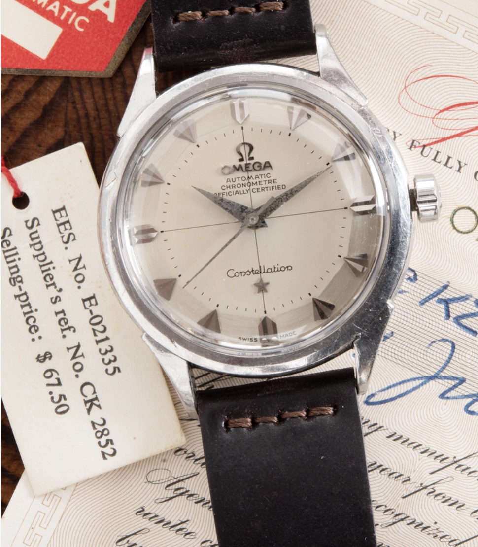

i noticed the back of the case says "patent applied" vs a number...could that further explain an older version of 1956 / 501 movement?
13,676
19,045
That’s a very good point and I never noticed it before.
Learn something new every day.

the one you sent a link to at VGW London ( has been sold) also says "Patent Applied"...so that's good news I assume. Appreciate the discussion - learning at the speed of fear!
1,024
4,126

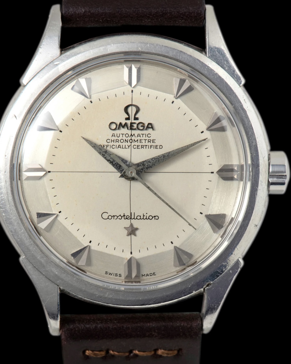

Need larger and higher definition pictures. The case looks good to me, as does the movement.
The one thing I would say is that if correct, this example would be the first one I've seen in almost 20 years of collecting that had a true pie-pan dial over a Cal. 501 chronometer movement.
The pie-pan dial was introduced around 1956. By that time, the Cal. 501 had been replaced in the Constellation by the Cal. 505 with a higher jewel count and improved automatic assembly.

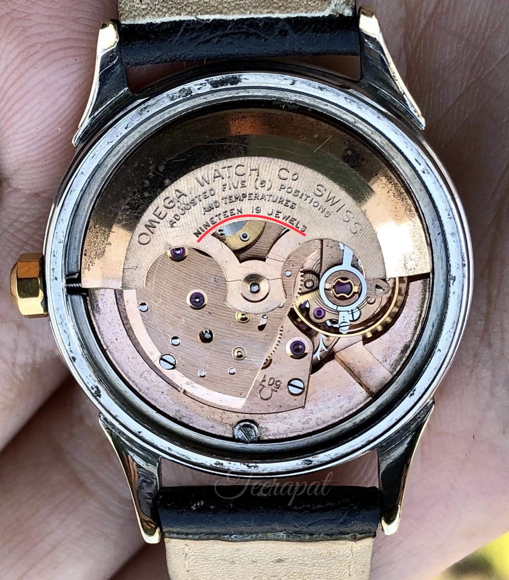

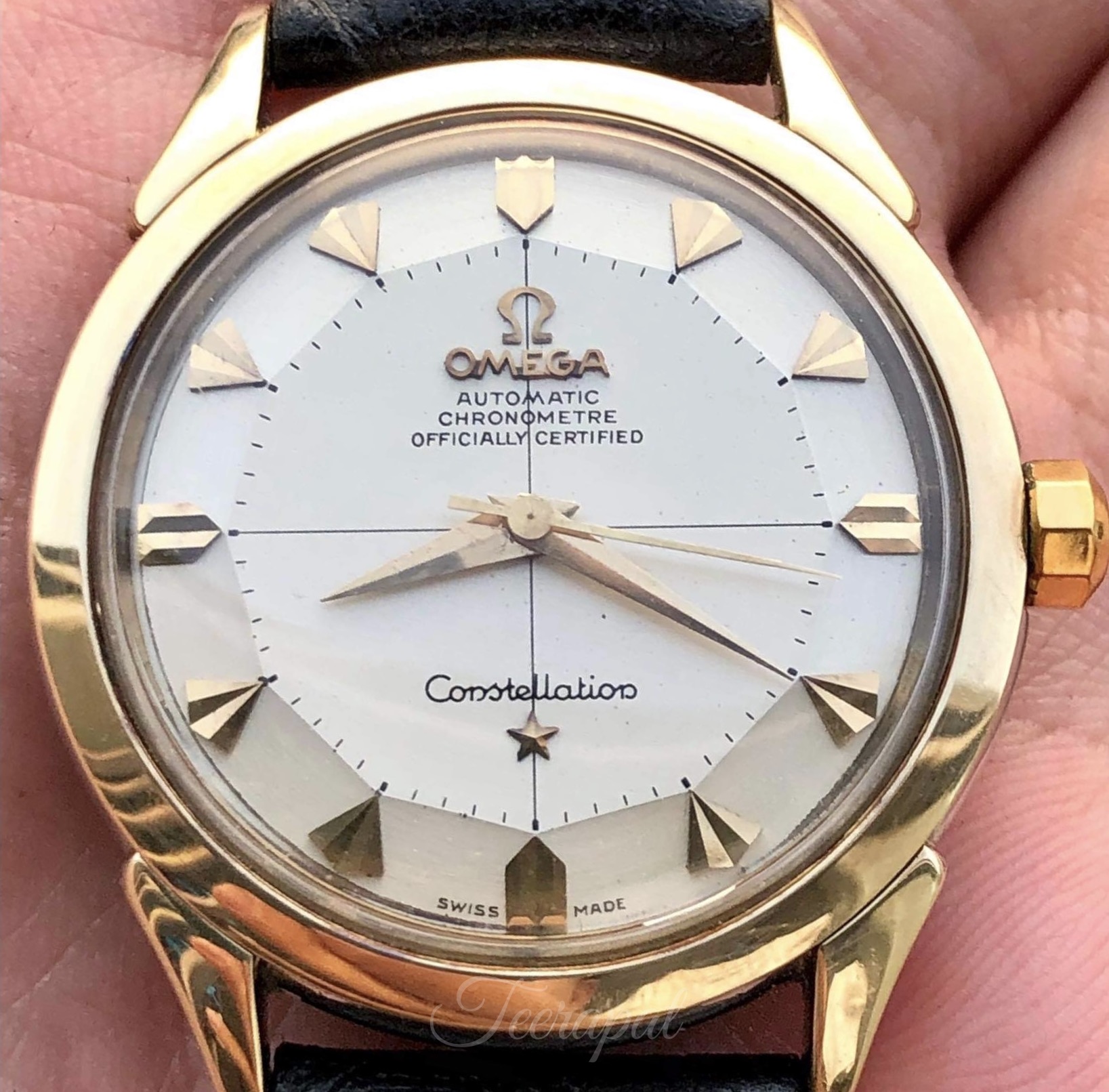

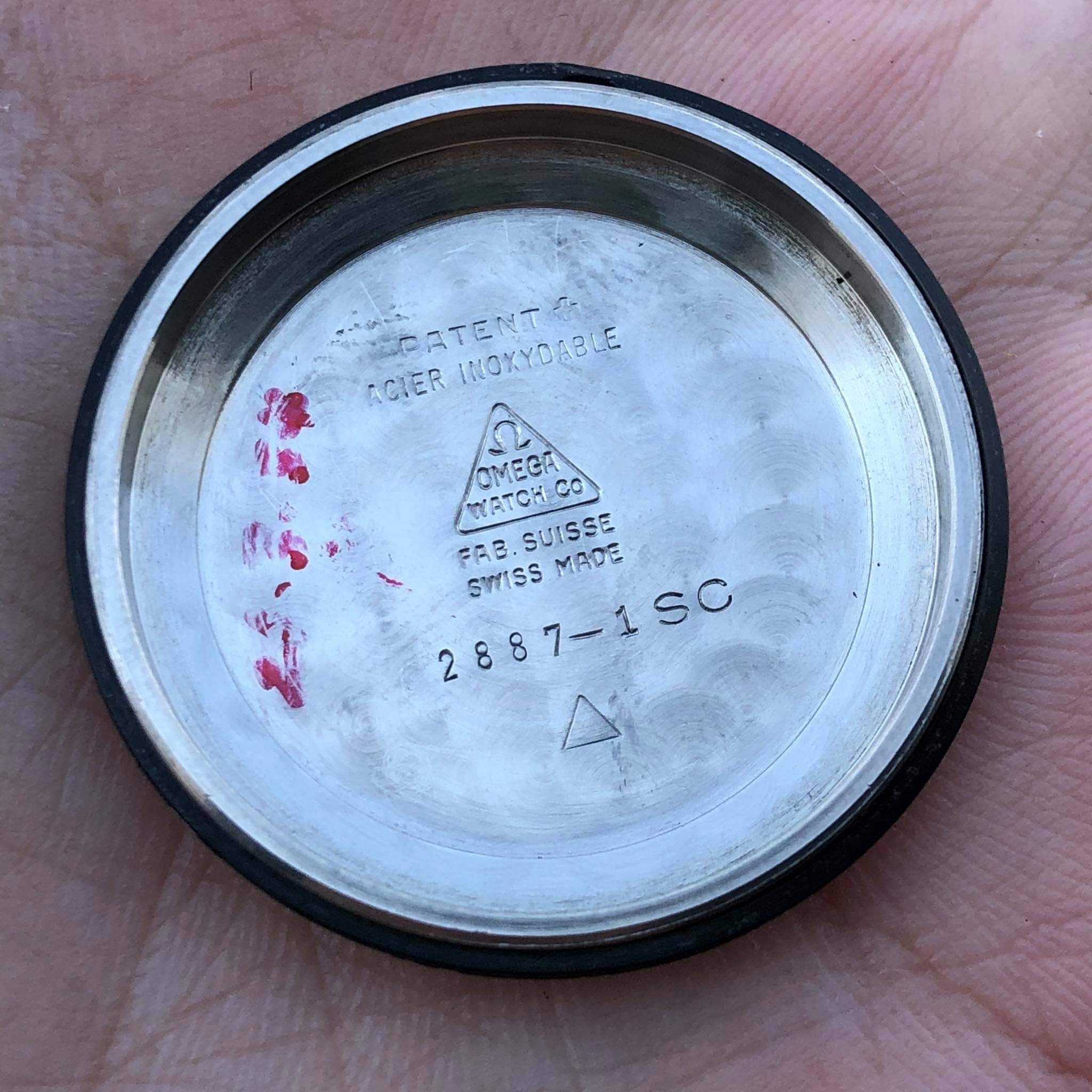

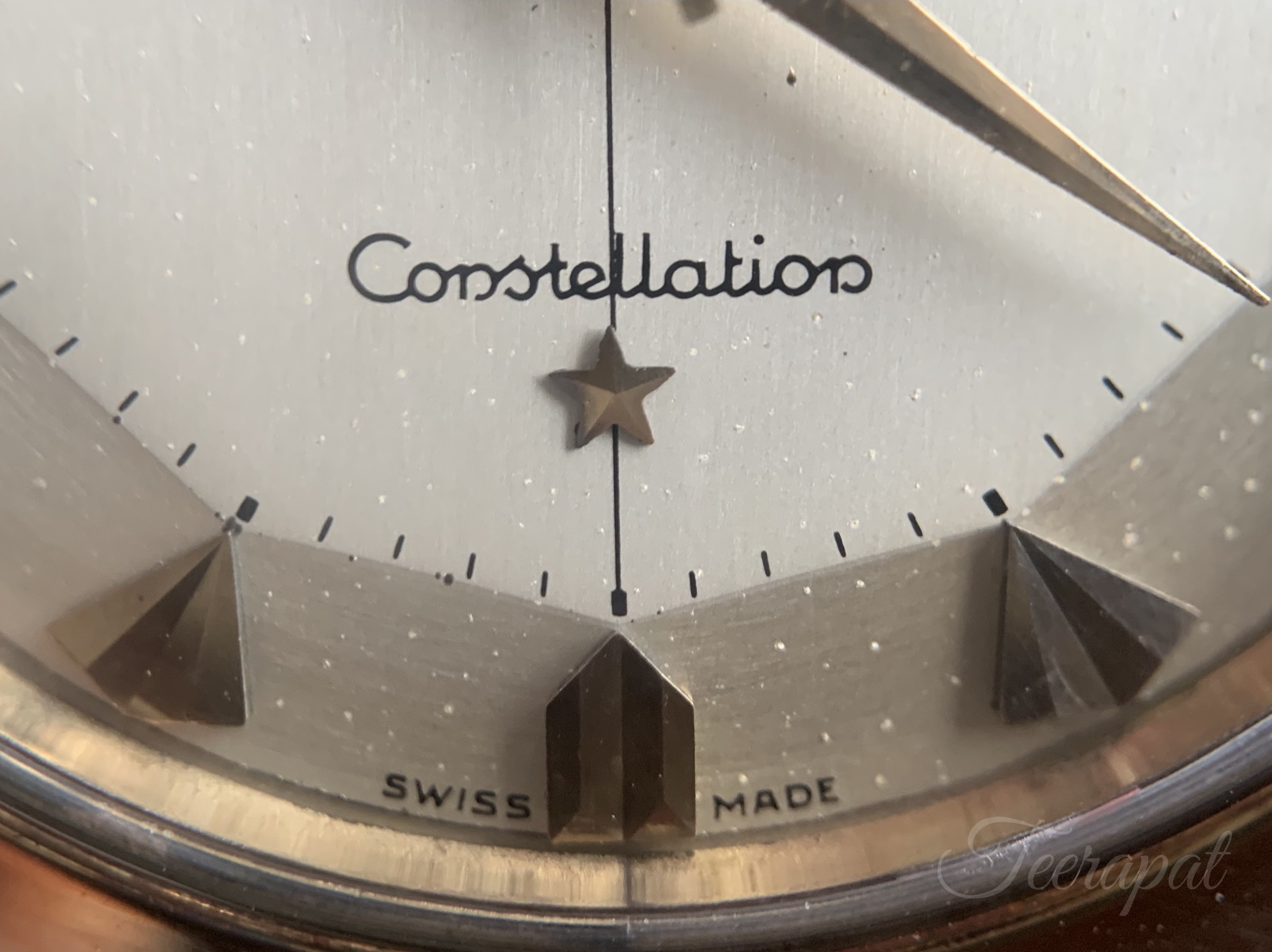

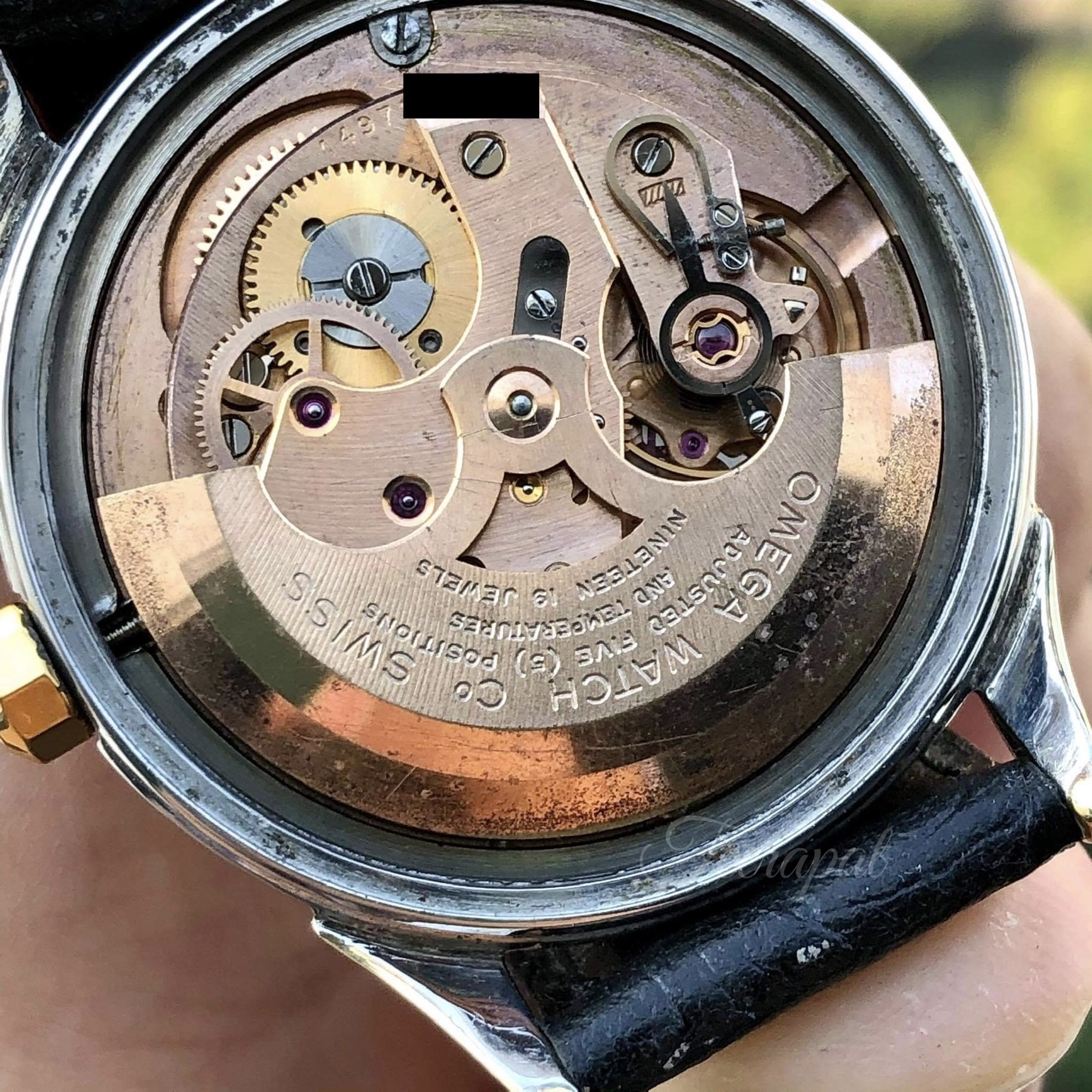

Hi, @gatorcpa ,
I am not sure that the one I owned also included?
The pie-pan dial of ref.2887-1 (the earliest batch of ref.2887) with serial no. 14,97x,xxx and cal.501 (19 jewels).
However, the case was too overpolished and the movement need to be serviced.😲

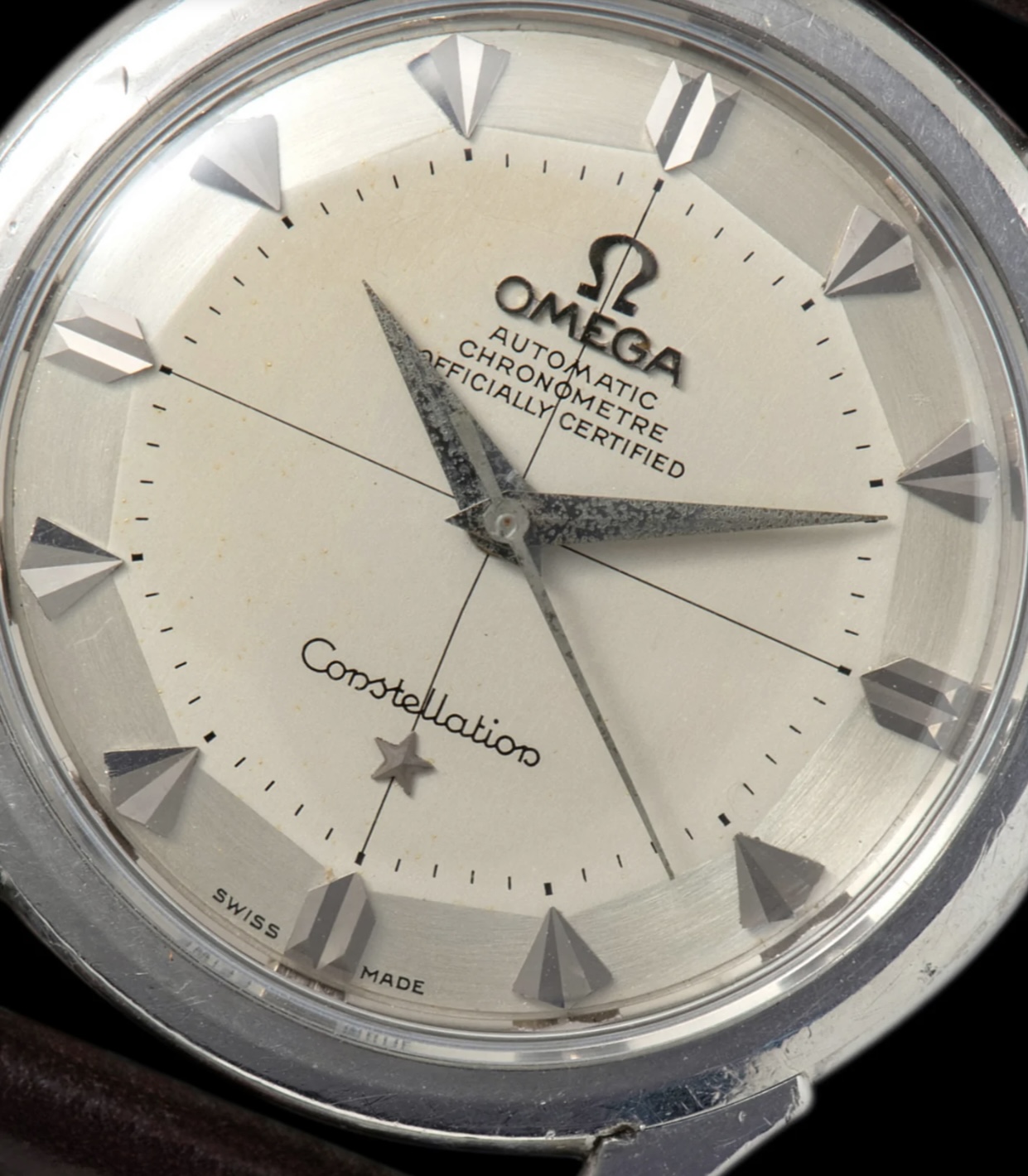

I did not consider the Ref. 2887. Those had pretty much any combination of dials and movements that you can think of.
However, the OP's watch is not a Ref. 2887. It is a Ref. 2852.
I should have been more careful there.

Cal. 501s were used for 2852s over a serial stretch of hundreds of thousands. So really not that rare at all, I should even have a few EotAs for proof in case someone is in disbelief. Love the “rabbit hole” though, to use @gatorcpa words, and have been collecting serials and data of 2852s for quite a while. I’ll bring it all together in a post at some point, maybe the serials along with infos such as caliber, crown style (clover or thick decagonal), dial form and layout, style of indices, -er or -re spelling of chronometre, straight or angled M, case material and sub reference will be helpful to some. My idea was to include example pictures and some explanations in the post, though, and that’ll take a while to produce.
