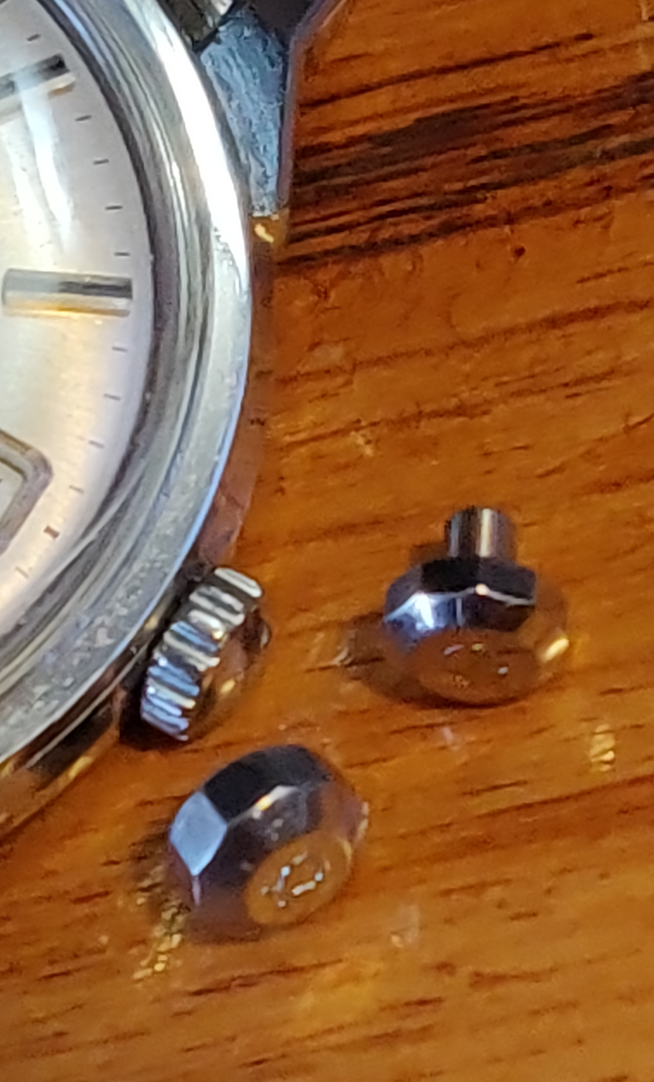

Pie pan dial genuine?
3,790
6,452
Crown looks like a bigger 4219 instead of the correct (and slimmer) BF1080
Sometimes both the slimmer and the bigger won't fit in these (14381/14393/14900/14902) then I have to settle with this.
But if you still want the slimmer then you have to change the tube.

I just noticed the set screw for the swan's neck is missing over the balance staff.

No one noticed the missing regulator screw? Should be pretty easy to source, however.

Not missing - broken...

Half missing.
Well, yes half missing (by weight I would say 2/3 if we are getting picky). But my point is there may be more than just a screw required. If the broken bit can be removed yes all you would need is a new screw, but I just had to replace a regulator where the old broken screw is simply not coming out...
