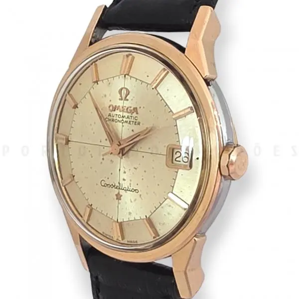

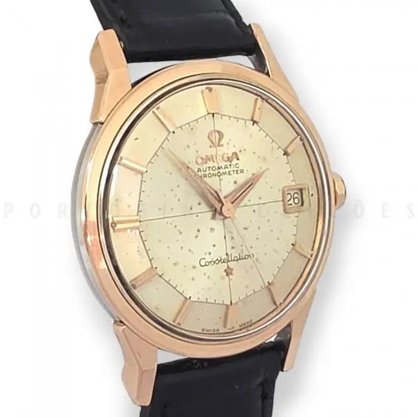

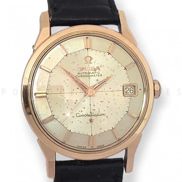

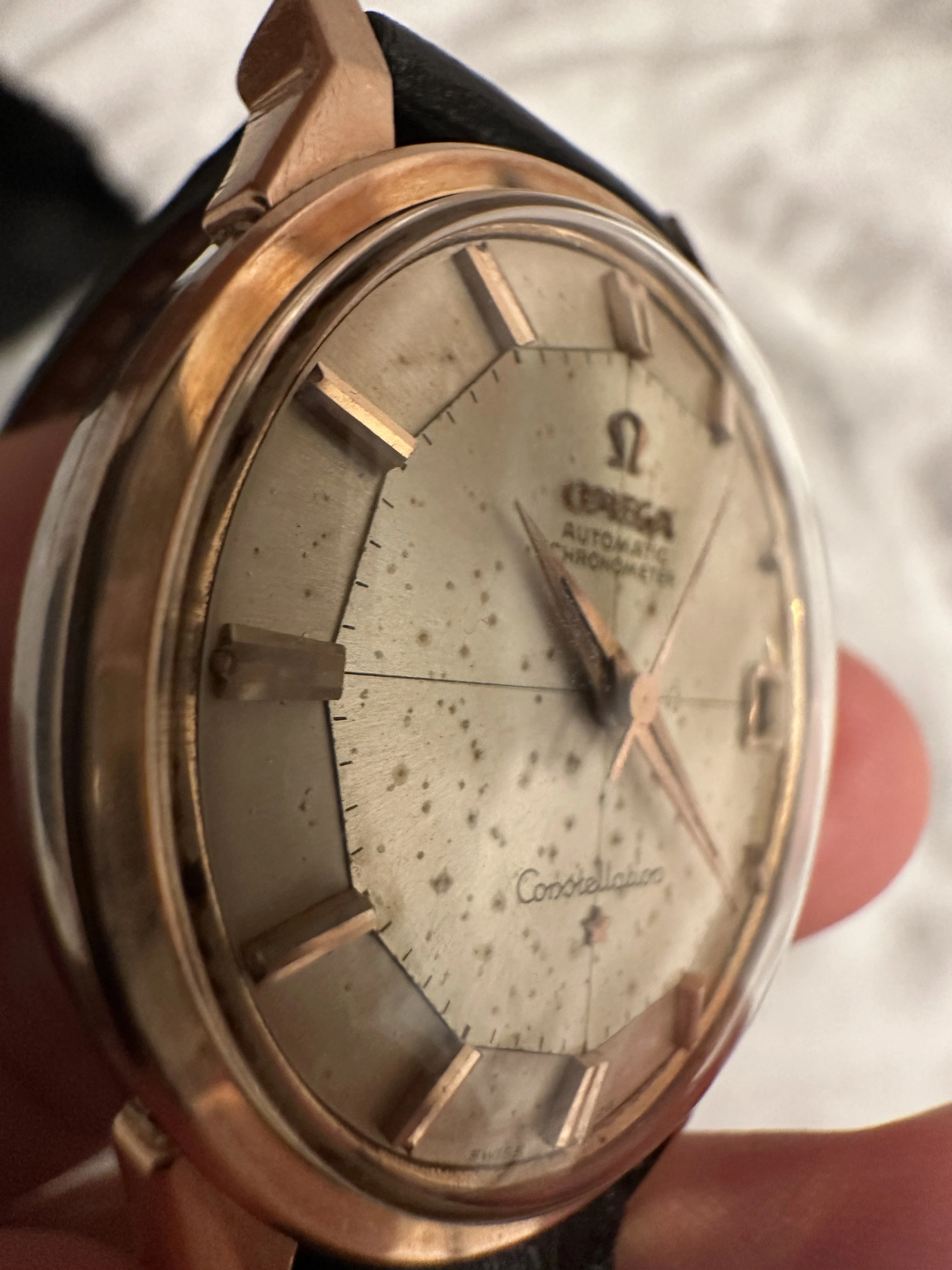

Hi everyone,
I recently bought a vintage Omega Constellation Pie Pan with caliber 561. The dial has a few small spots that look like mould or moisture-related staining.
Has anyone here ever tried to remove this kind of spotting from an original Constellation dial? Is there any safe way of cleaning it without risking damage to the printing, lacquer, or original finish?
To be honest, the spots do not bother me that much. Sometimes I even feel they give the watch a bit of character and are part of its history. However, if this is something relatively simple and safe to remove, I would consider having it done.
Would you leave the dial untouched, or would you try to have it carefully cleaned?
I would really appreciate hearing from anyone who has dealt with something similar.

I'm afraid it's rather difficult (perhaps impossible) to eliminate this sort of spotting without significant risk of severely damaging the dial.
I'd recommend leaving it as-is, particularly if the spotting does not bother you very much

Attempting to make the dial look better will almost certainly make it look worse. I suggest you leave the dial as it is.

Im not saying do this I’m asking, can you wash a dial with water and a Q-tip? Like what if it was just dirt? Again not say it is just dirt just curious? Is there any way to clean a dial?

Any cleaning attempt risks removing print from the dial. Even water and a a tip (or ideally a cleaning stick designed for watch dials).
People have removed the lacquer and reapplied, as that’s likely where the spotting is. However that comes with even more risk.
Essentially, only try cleaning the dial if you’re ok with perhaps making it worse.

Thank you for sharing this link. Indeed a really interesting experiment this gentleman has done. But after reading through all the process he describes, it’s definitely a no go for me! I wouldn’t want to risk losing the lettering or other details on the dial just for the sake of trying to remove dark spots.
Omg No lol this dial is nothing like what I done with my pocket watch
Most watch have very soft surface and very very thin lacquer apply water will just destroy it and will just rub everything off, the only reason soapy water and a qtip worked on my pocket was is because the dial is porcelain like with vitreous enamel which is very hard (ish) okay to gently wipe

Even patina … so it’s part of the character of the piece. Stop thinking about it and wear it. Intervention will end badly.

it is likely blistering of the lacquer. In general, this is pretty common and not usually something that can be improved without a lot of risk.
