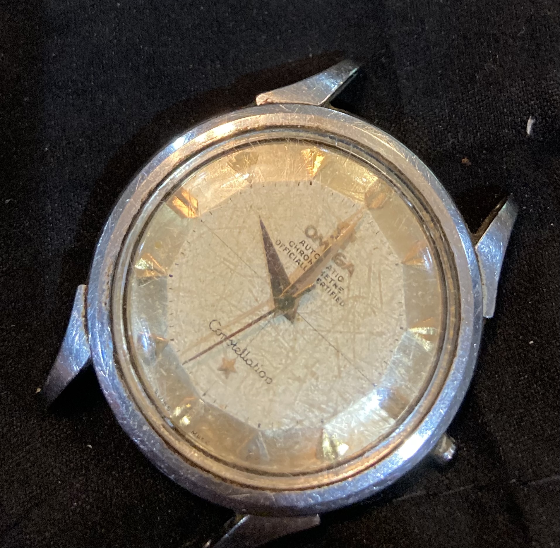

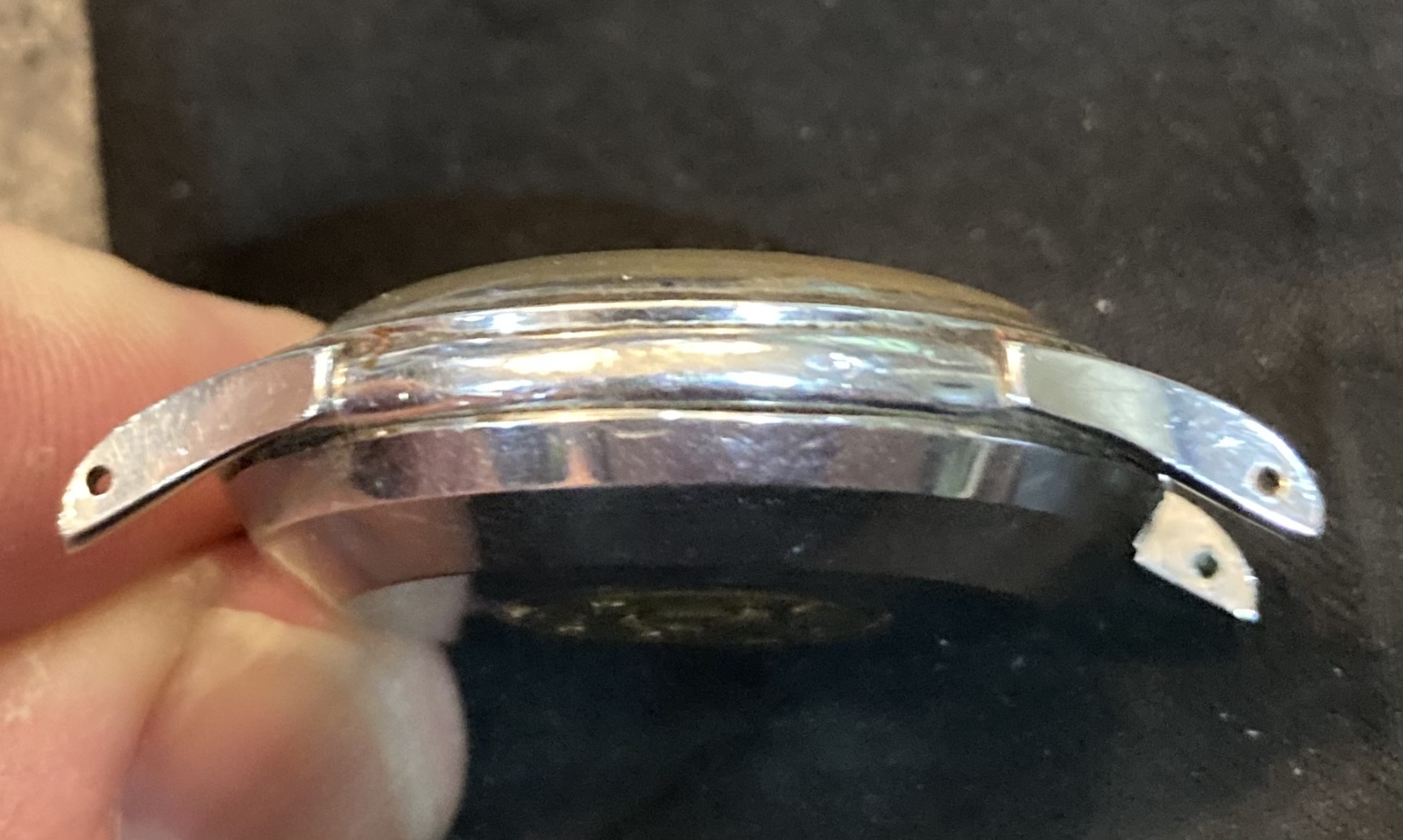

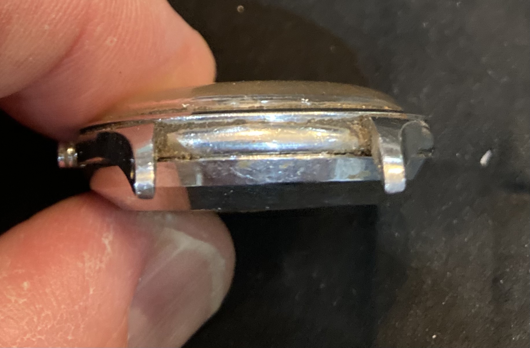

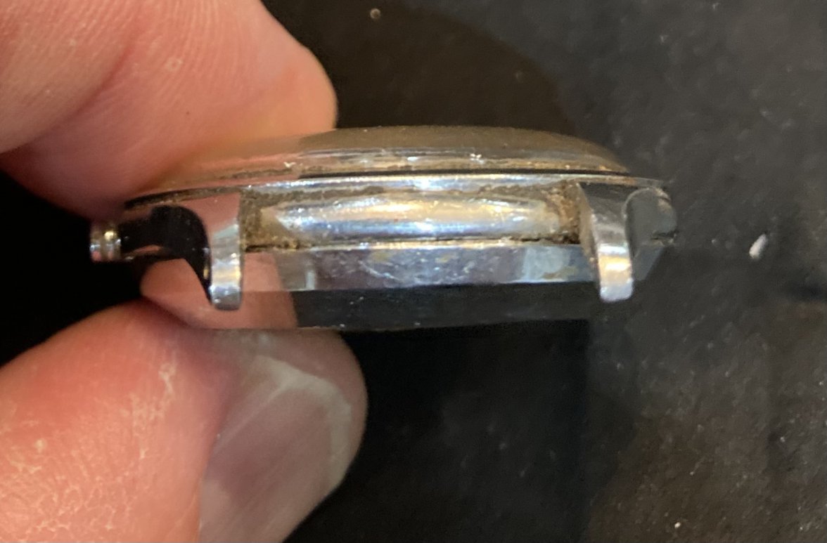

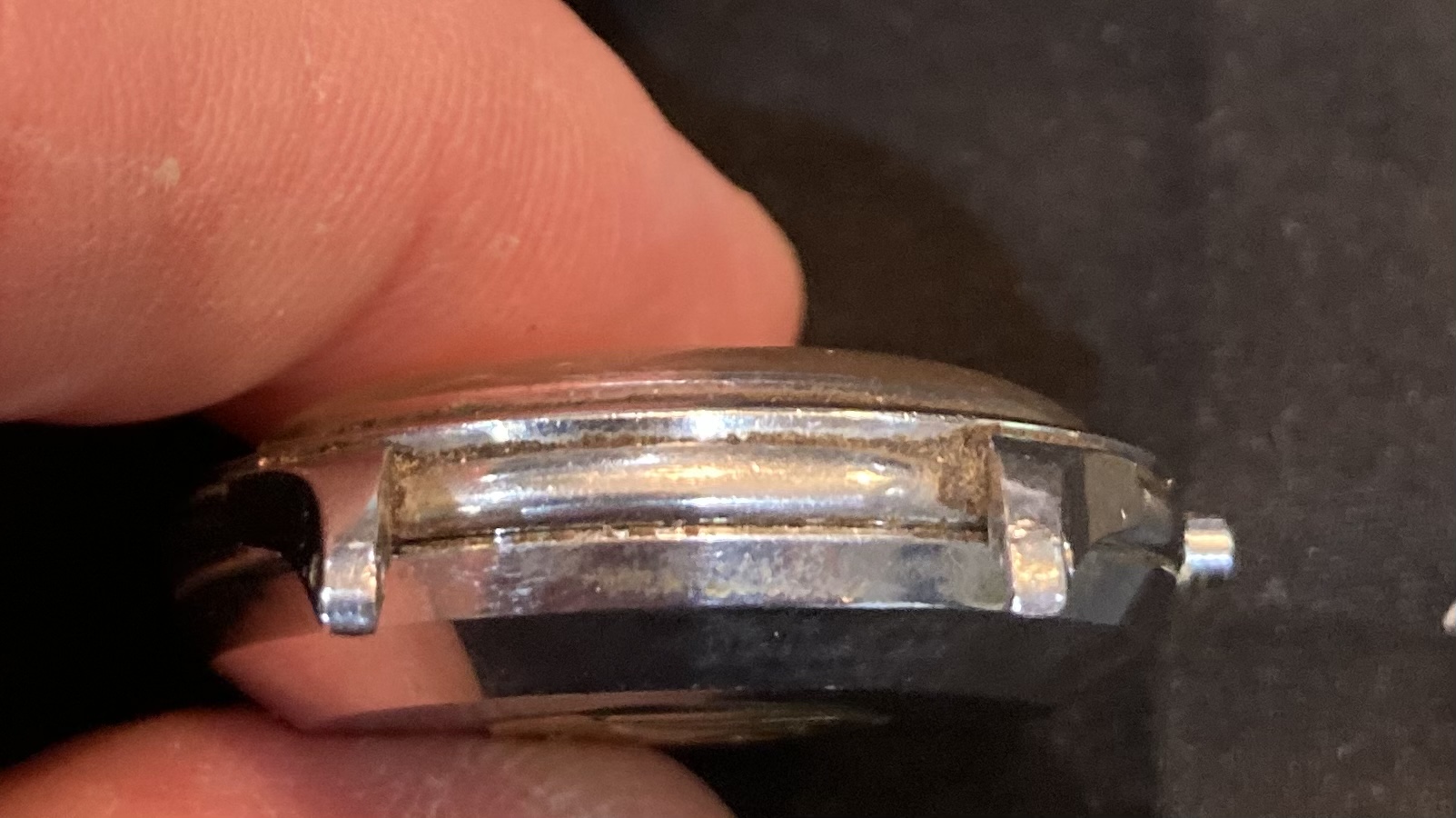

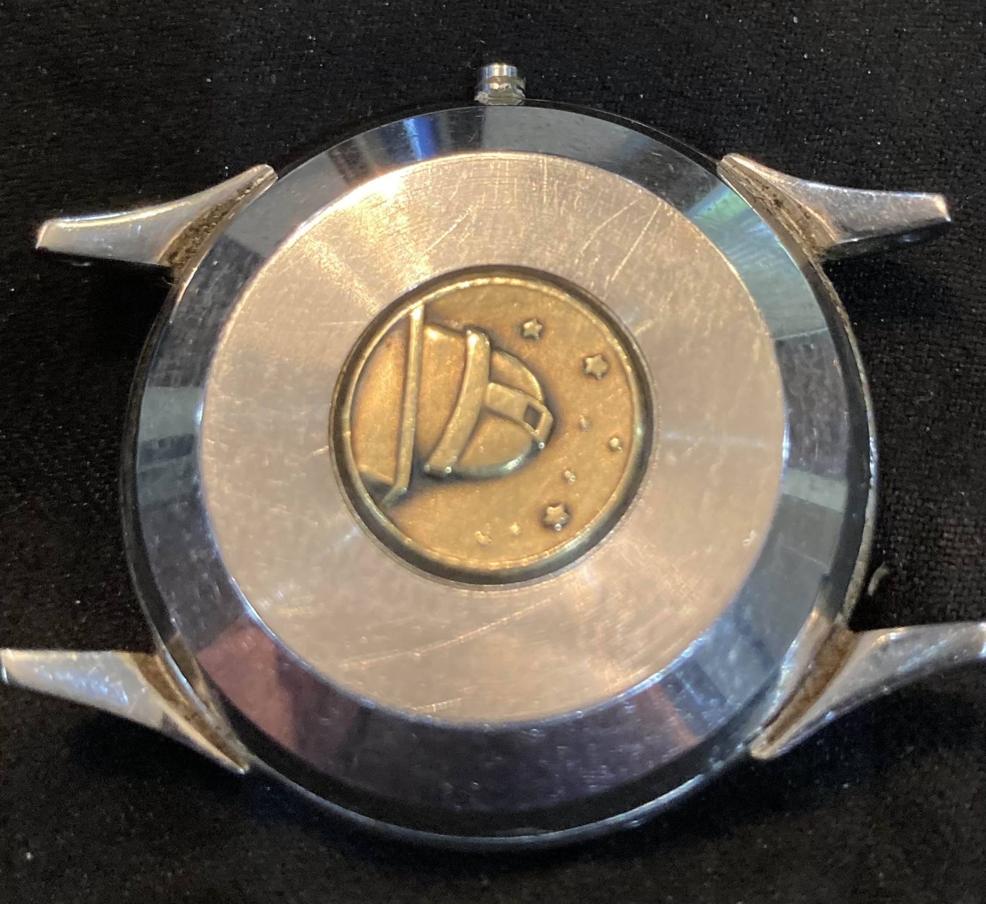

The condition of that case is really unusual, especially for a dressy watch, it's so beat up and worn, but not polished. It's as if it was left in a junk drawer. It will be interesting to see if Omega Addict can do a professional refinish.
10,125
57,954
I was thinking the same thing, Dan. I'm not familiar with OA's work, but I'll look forward to seeing photos of the watch when the service is completed. .
9
9
I'm betting he can.

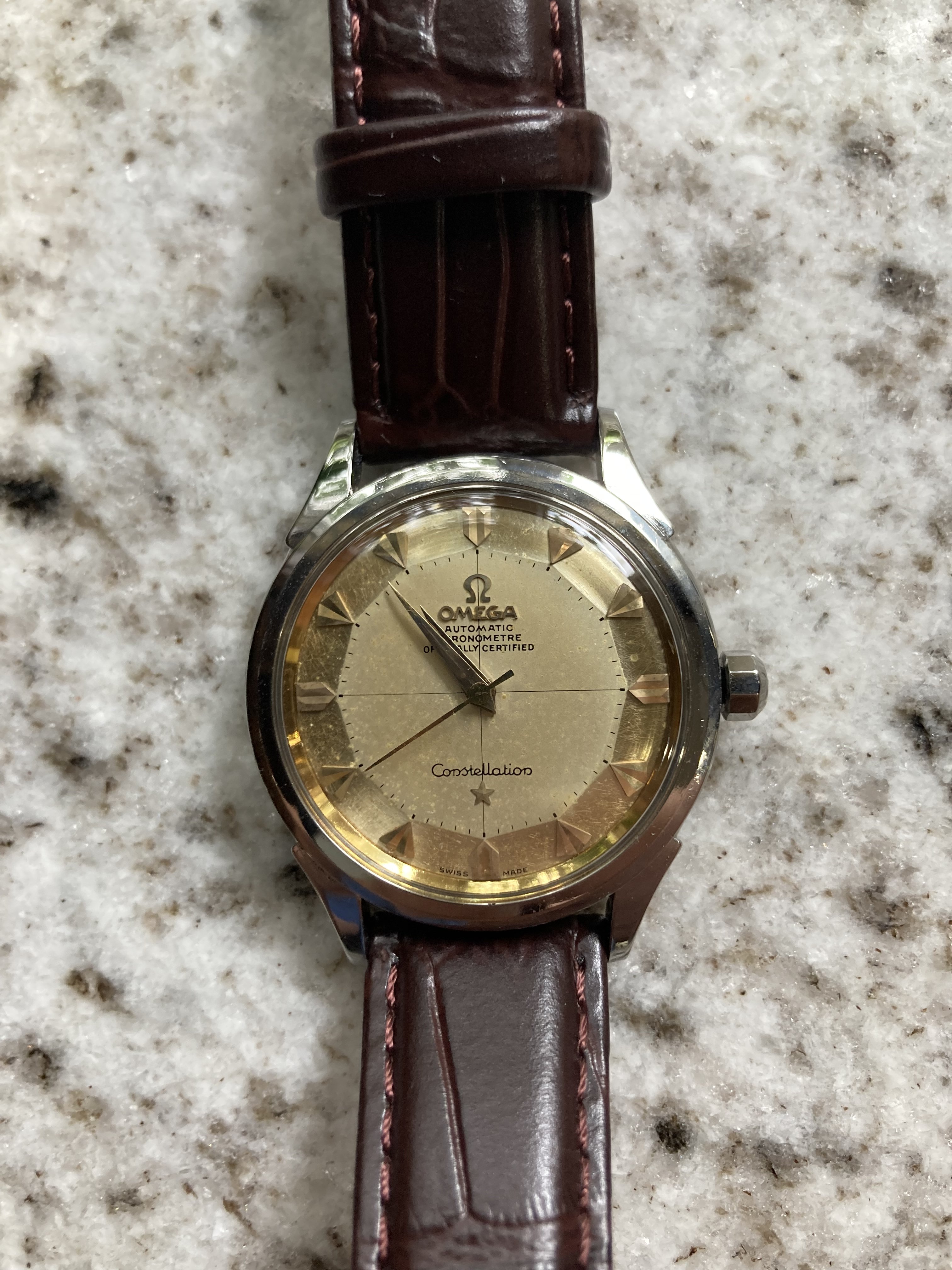

Omega Watch Service - 1956 Constellation Chronometer
service 300, mainspring 25, remove rust 30, screw extraction 10, 1 x screw 5, 2 x winding gears 30, setting spring 39, crown 50, stem 22, case detail 25, crystal 37, band 39
$632
$632

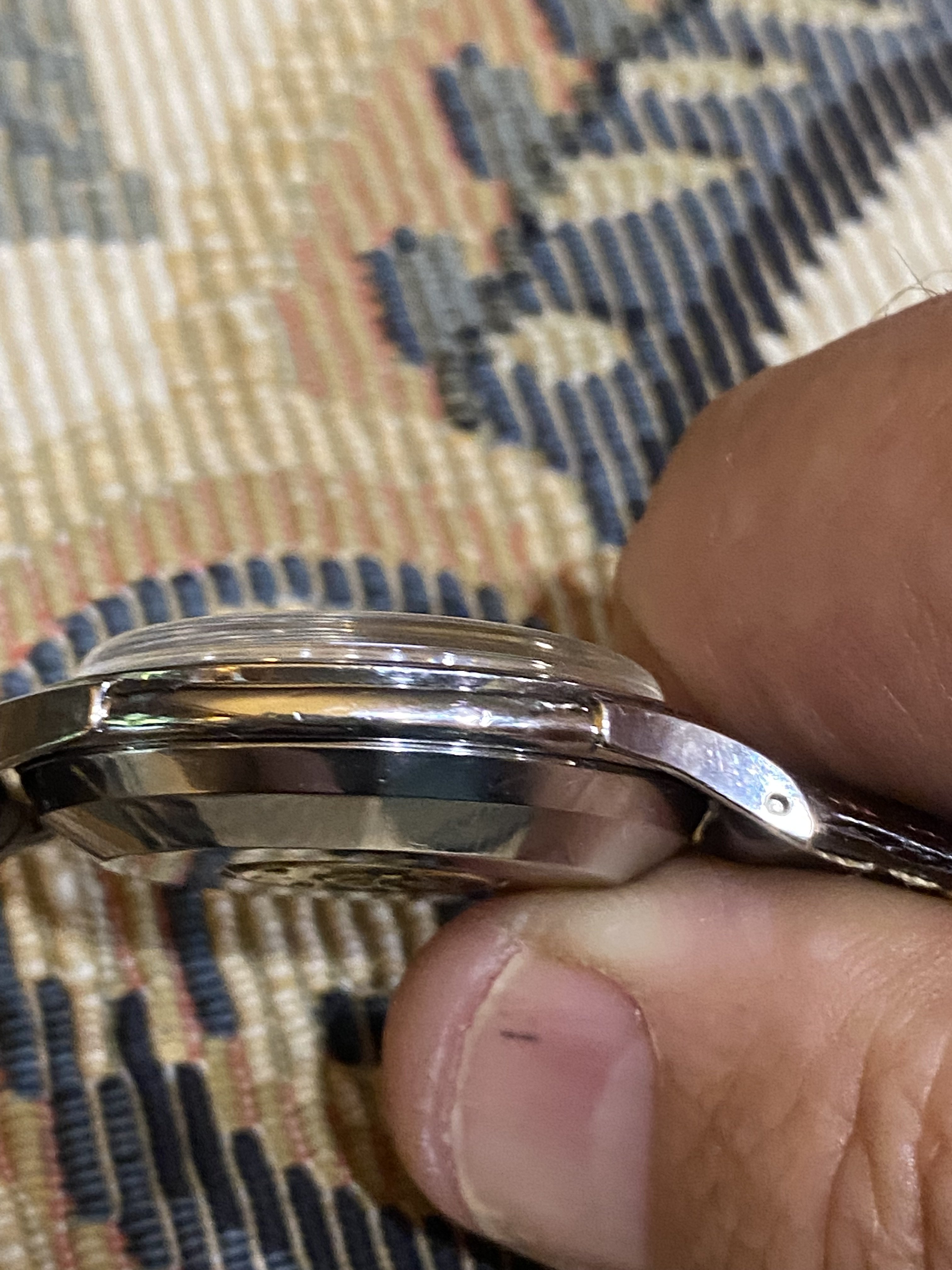

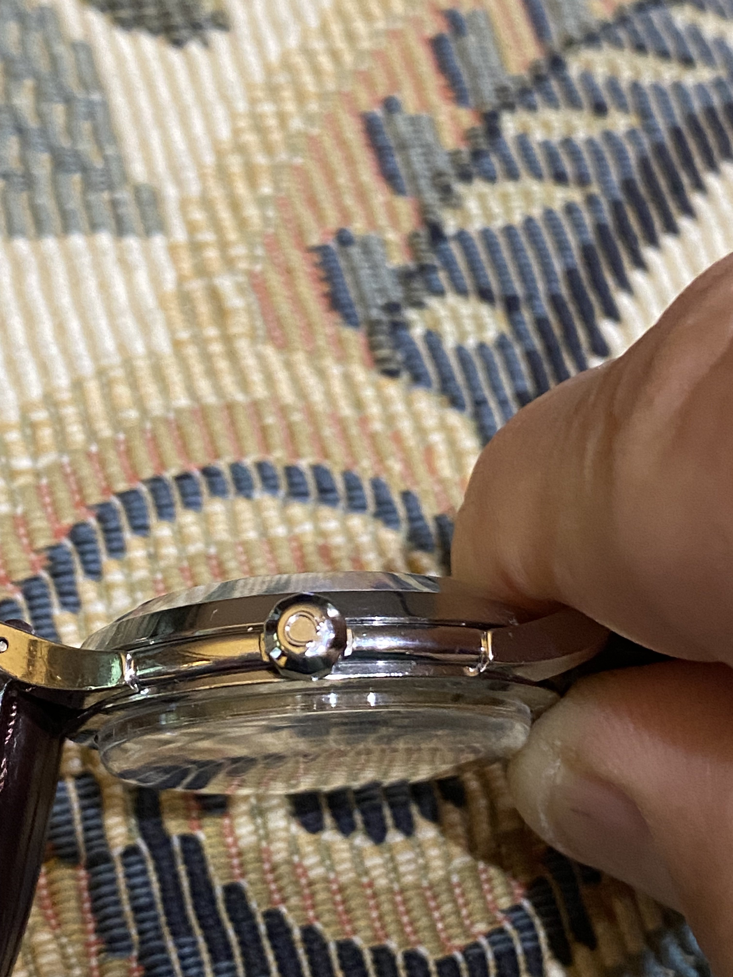

Not outrageous in my view for a watch in this condition, but a few observations. The price for the crown and the crystal seem cheap to me, but someone like @Archer would be better qualified to comment. Also, case detail for $25 makes me nervous. If that means ultrasonic cleaning of the case, fine. If that means polishing, red alert, because that price is way too low for a professional case restoration. Finally, $39 is not going to get you a strap and buckle worthy of a vintage Constellation. Just my opinion, your mileage may vary.

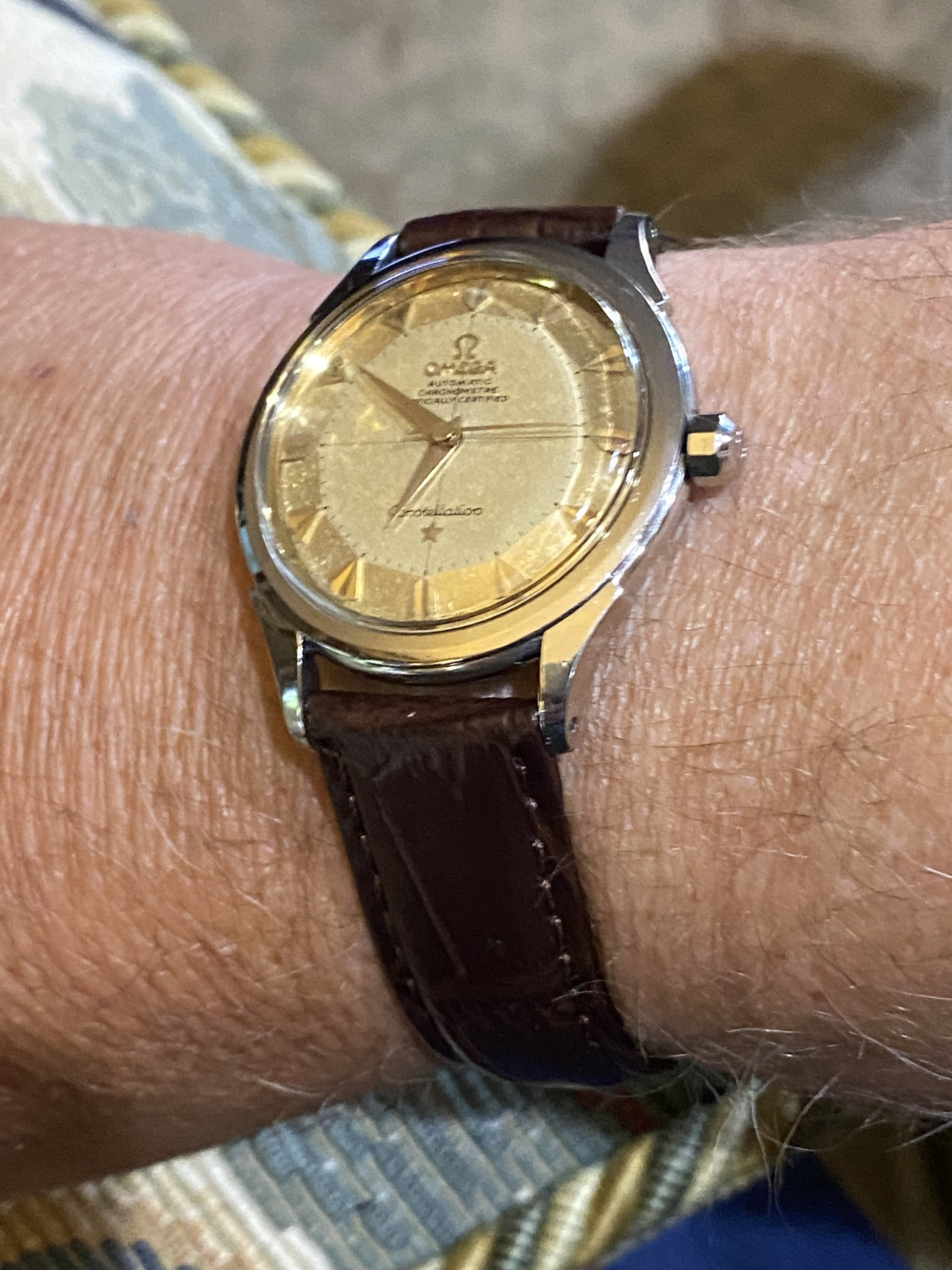

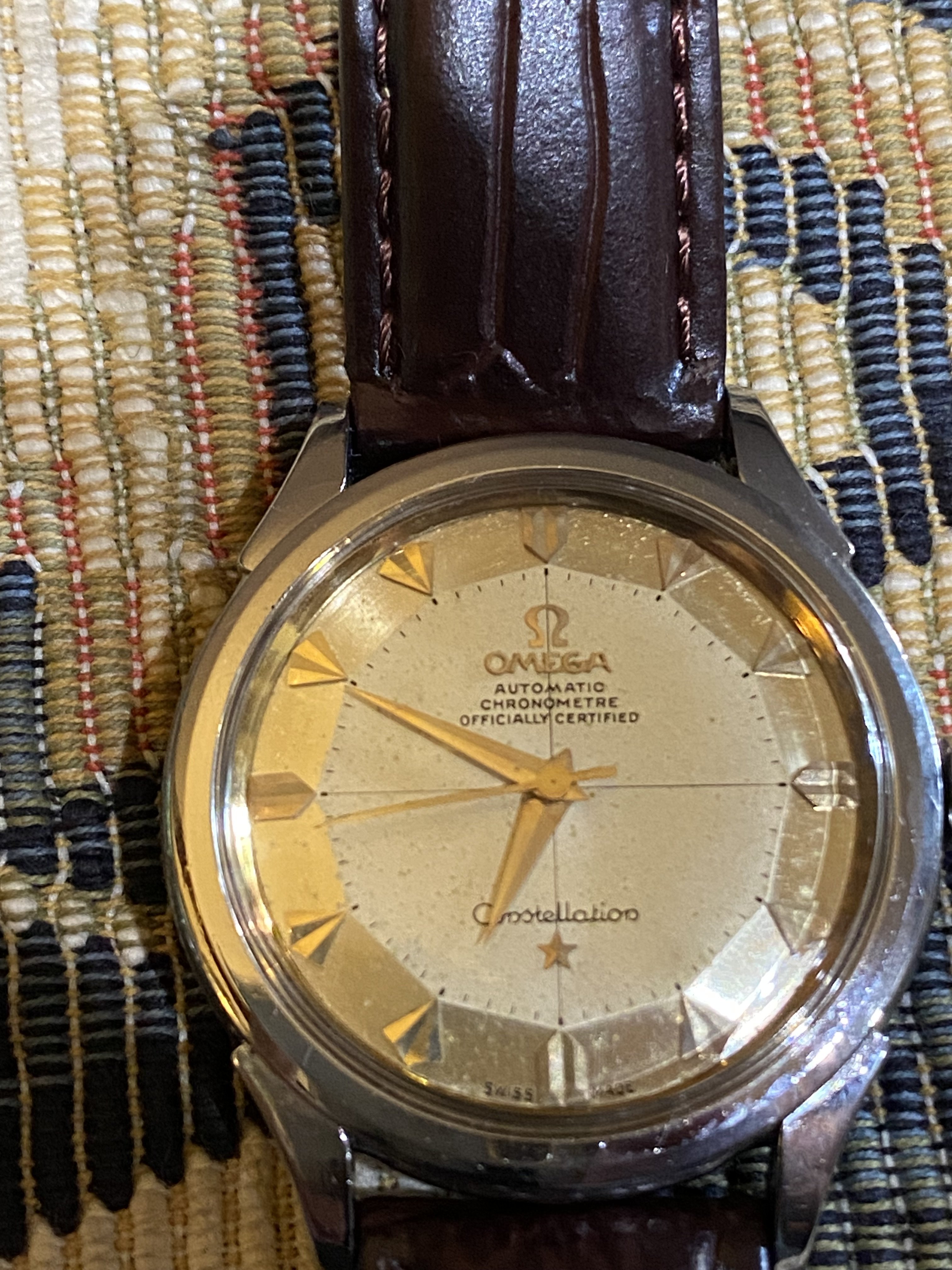

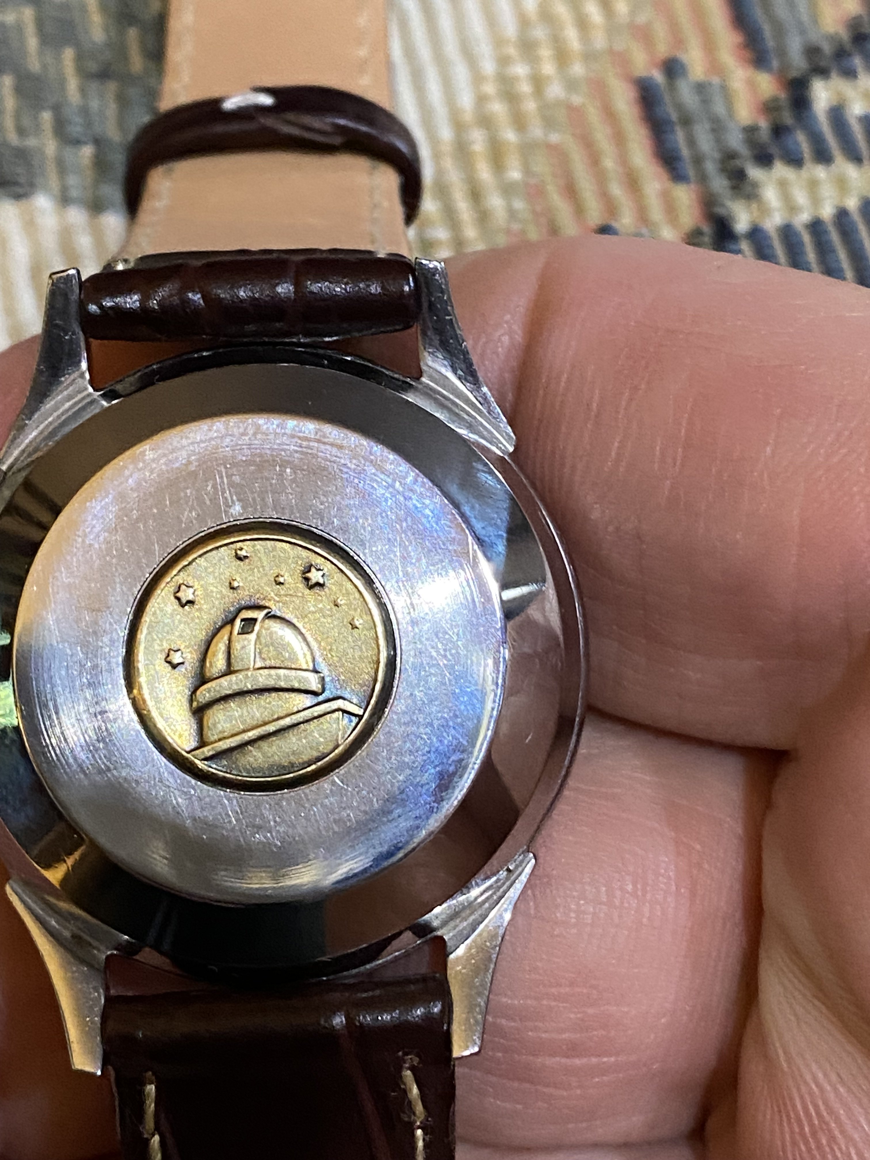

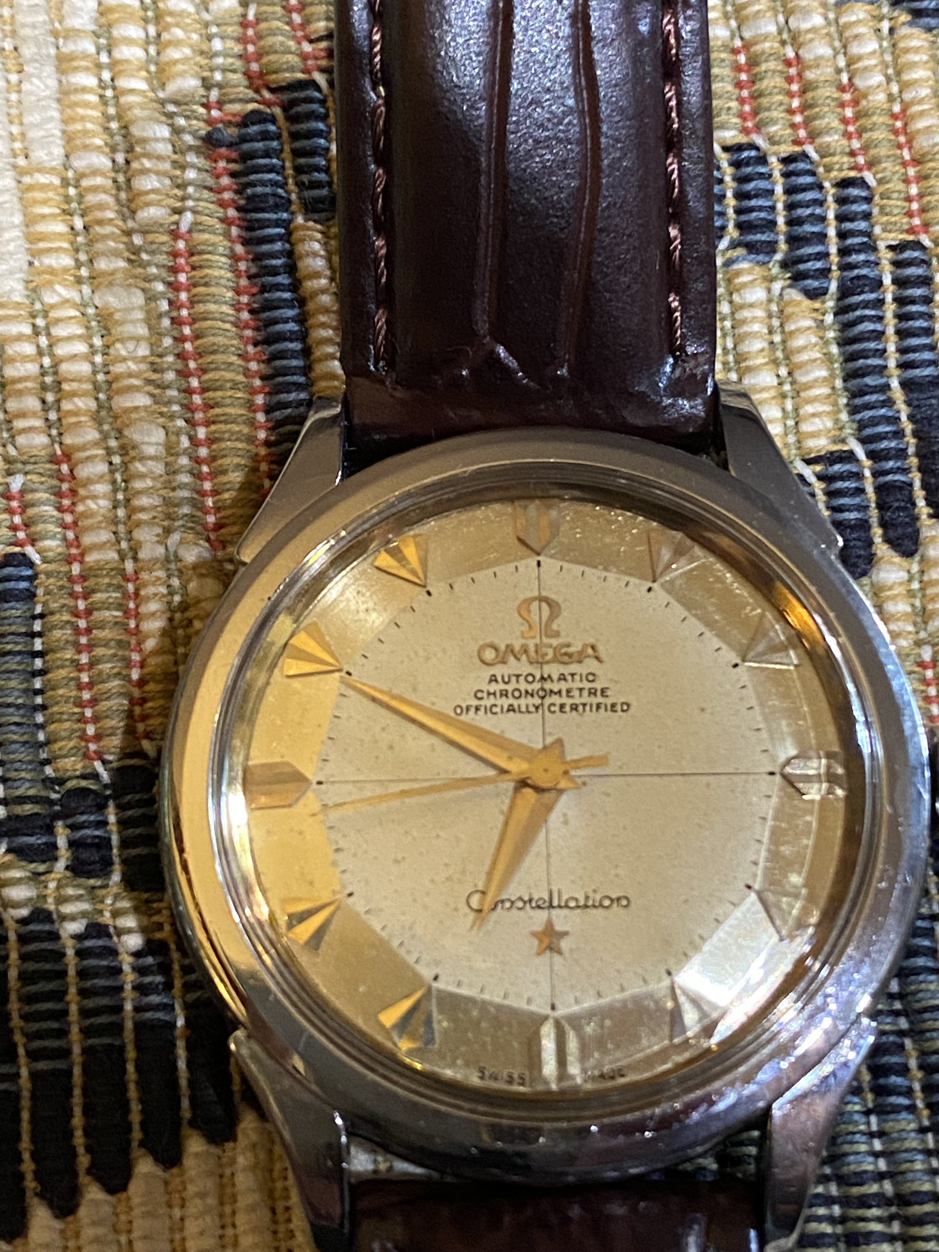

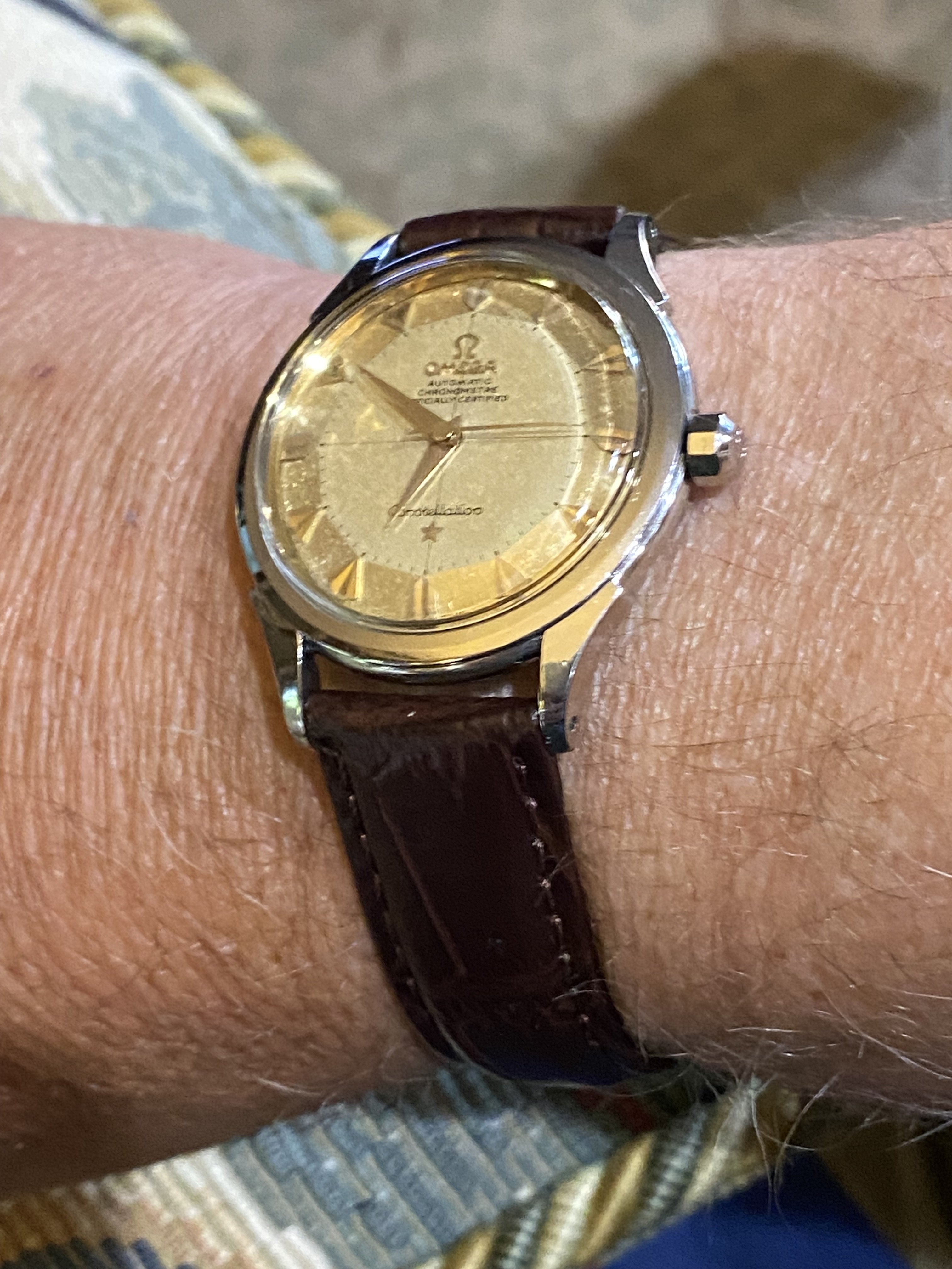

Seems like they did quite well! Looks fantastic with the correct crown (period correct or repro?) and a dressy strap. Would be great to see an in-focus photo of the dial head on. Try getting one in natural light, I think a good photo will really do justice to your before/after comparison
3,596
13,553
Period correct would have been a flat foot logo. These were discontinued a long time ago.
Anyway, @stonemd glad it all worked out and you ended up paying what, a quarter of the first service quote you got? Enjoy!
384
2,906
I would’ve left the case alone… the bezel is pretty much soft on the bezel now.
Still nice, enjoy.
