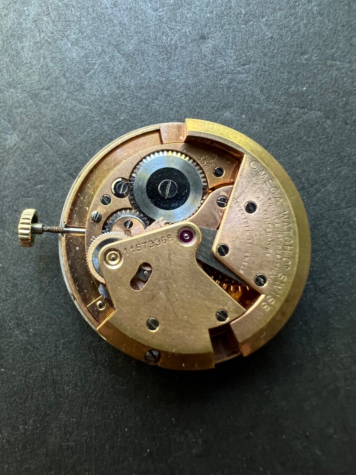

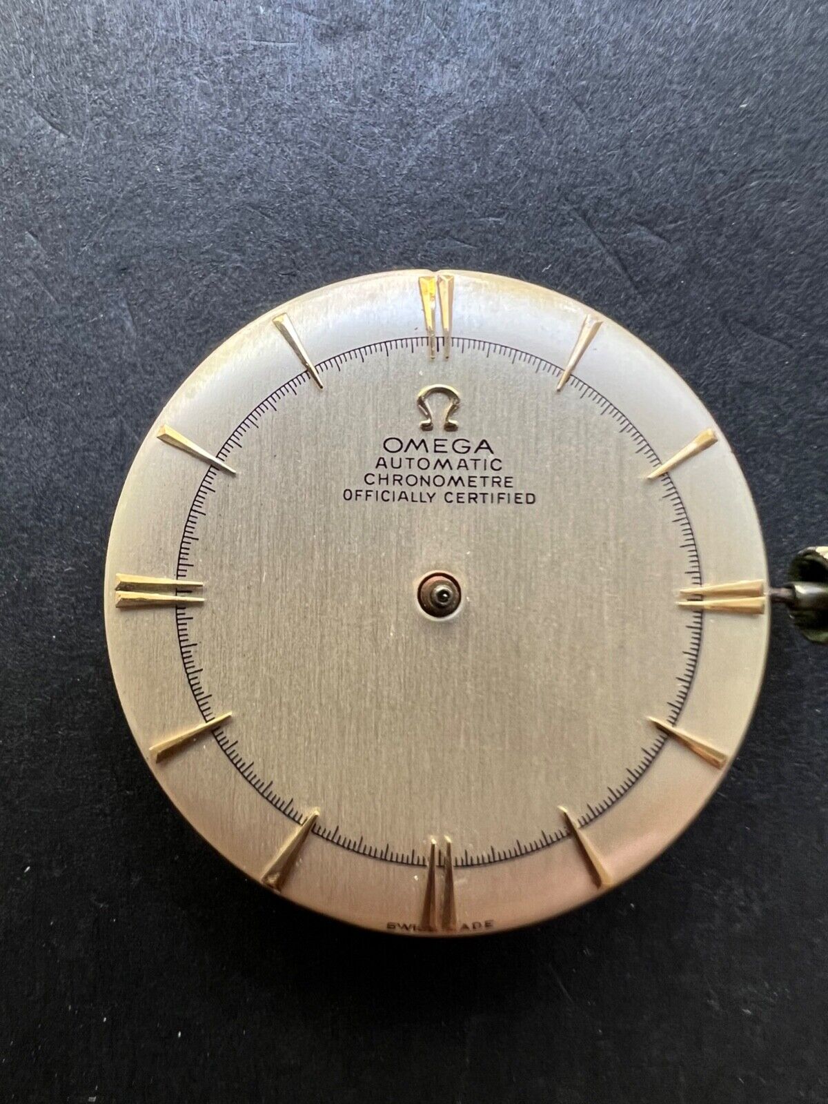

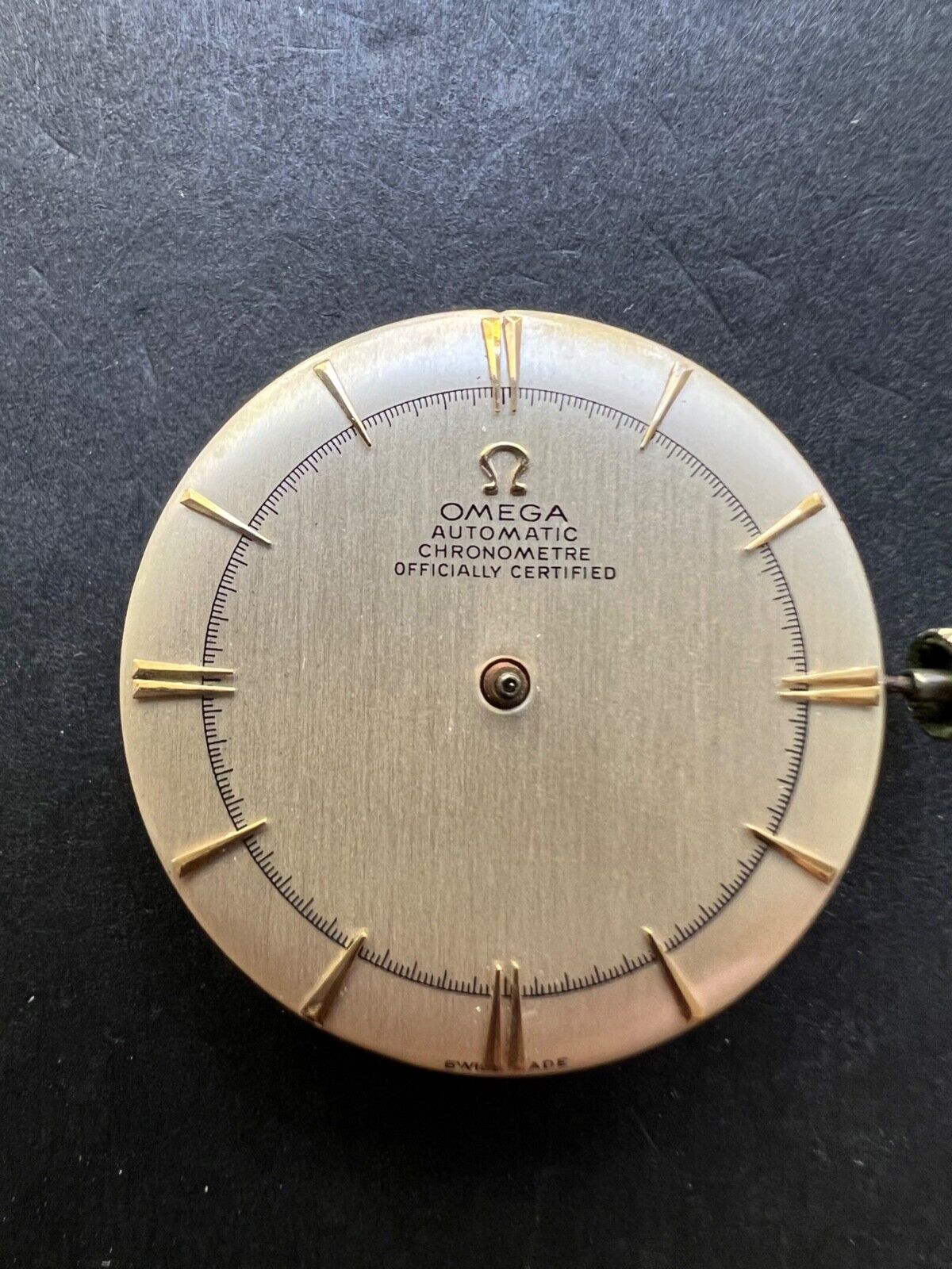

Picked this dial and 352rg movement up from EBay....
542
859
hoping it would fit in a 2577 case, but it will not. Appears to me to need a "jumbo", probably a 2517 ( I have started an eBay search for one), but are there others that would be appropriate? Other ideas on sourcing ? Attn: Don and Bill Sohne. Either of you hoarding one?😀

Is it the movement that is not fitting or the dial?

The movement should fit really, cal 352 2577s are a thing.
The 2517s are also 34mm though, are they not?
I’m yet to see a cal. 352 2577 without Seamaster on the dial, so far I’m only aware of cal. 351 examples in that configuration.
Other center second jumbo bumper Seamasters would be 2765, 2771 (not sure, those might only exist in tripple-stamped cases with 2765/2764), 2494 and 2521 I believe. Can’t comment on no-Seamaster-dials in those though.
Either way - it’s a cool find indeed.

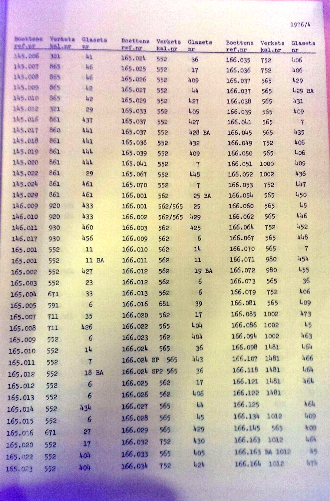

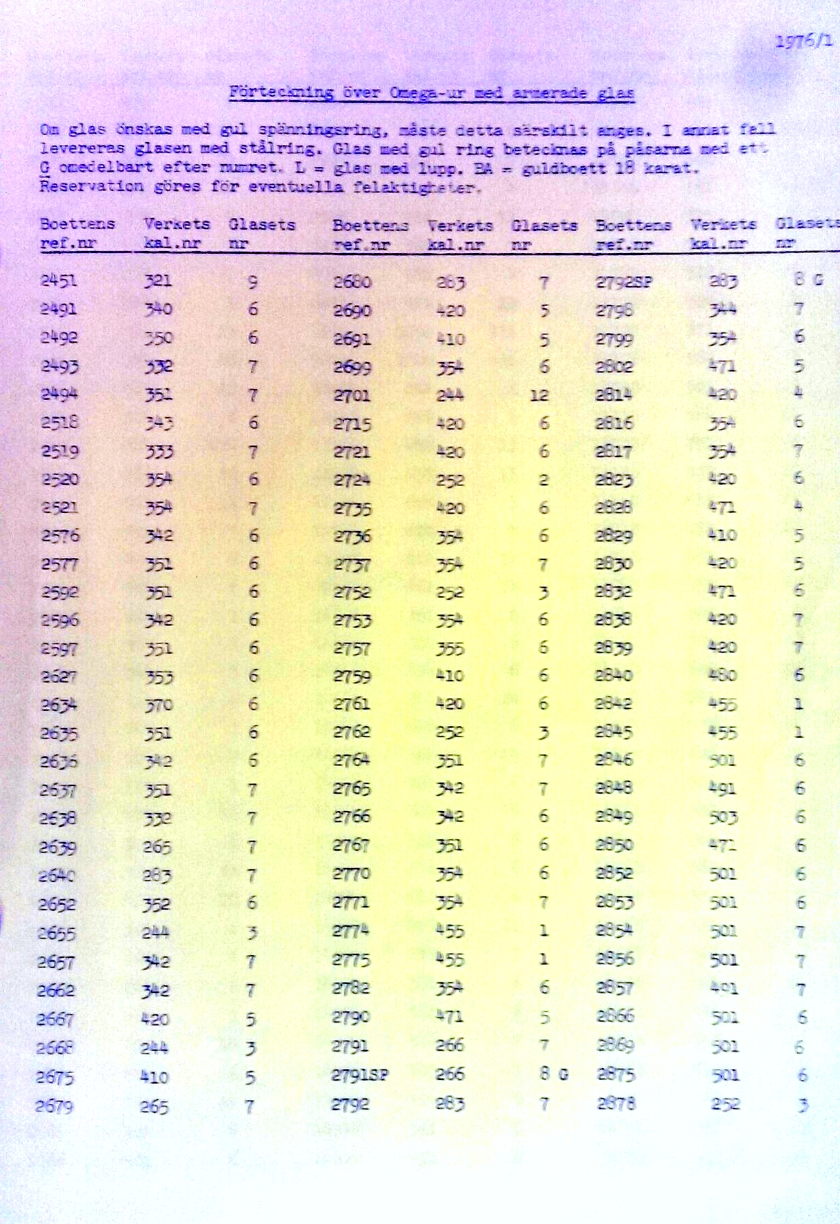

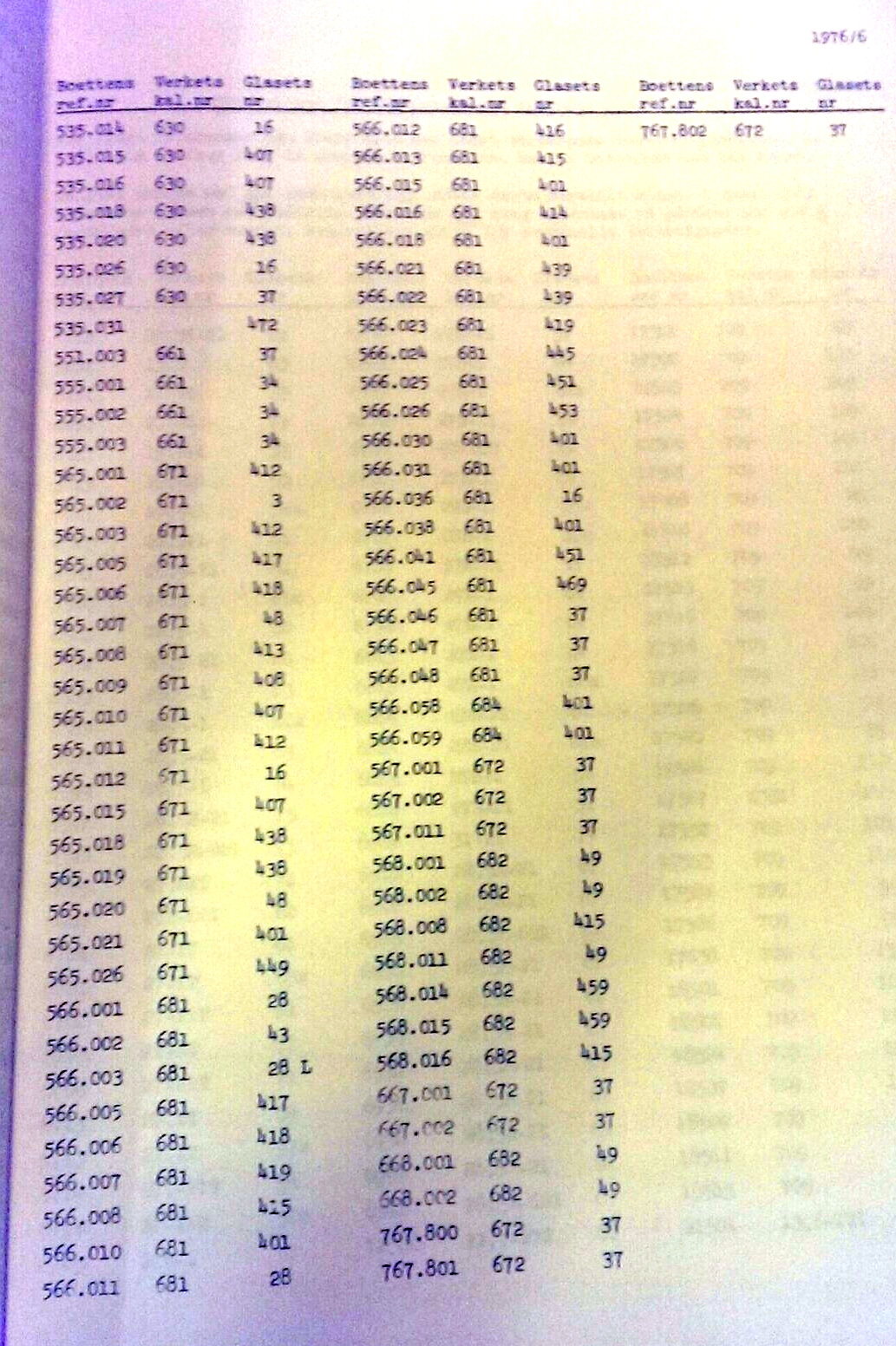

What is useful is the crystal size chart which gets uploaded here from time to time. That thread probably should be a sticky.
Here it is again. I refer to these a lot when searching for empty cases.
gatorcpa
The dial. Which is why I am assuming it needs a "jumbo" case. As other have noted, the movement should fit in a 2577

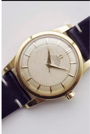

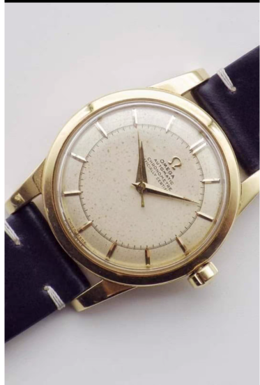

Hi Gator,
You have posted your own sweet 2517 chronometre. What is the case size?
13,671
19,041
Hi Gator,
35mm. But that’s not the measurement that matters. You want the dial diameter. That I do not have.
However, I think my 2517 dial is slightly larger than my 2577 dial.
gatorcpa
542
859
Badda Bing. I think the 2517 case, and the dial, is ~ 1mm larger than the same for the 2577.
13,671
19,041

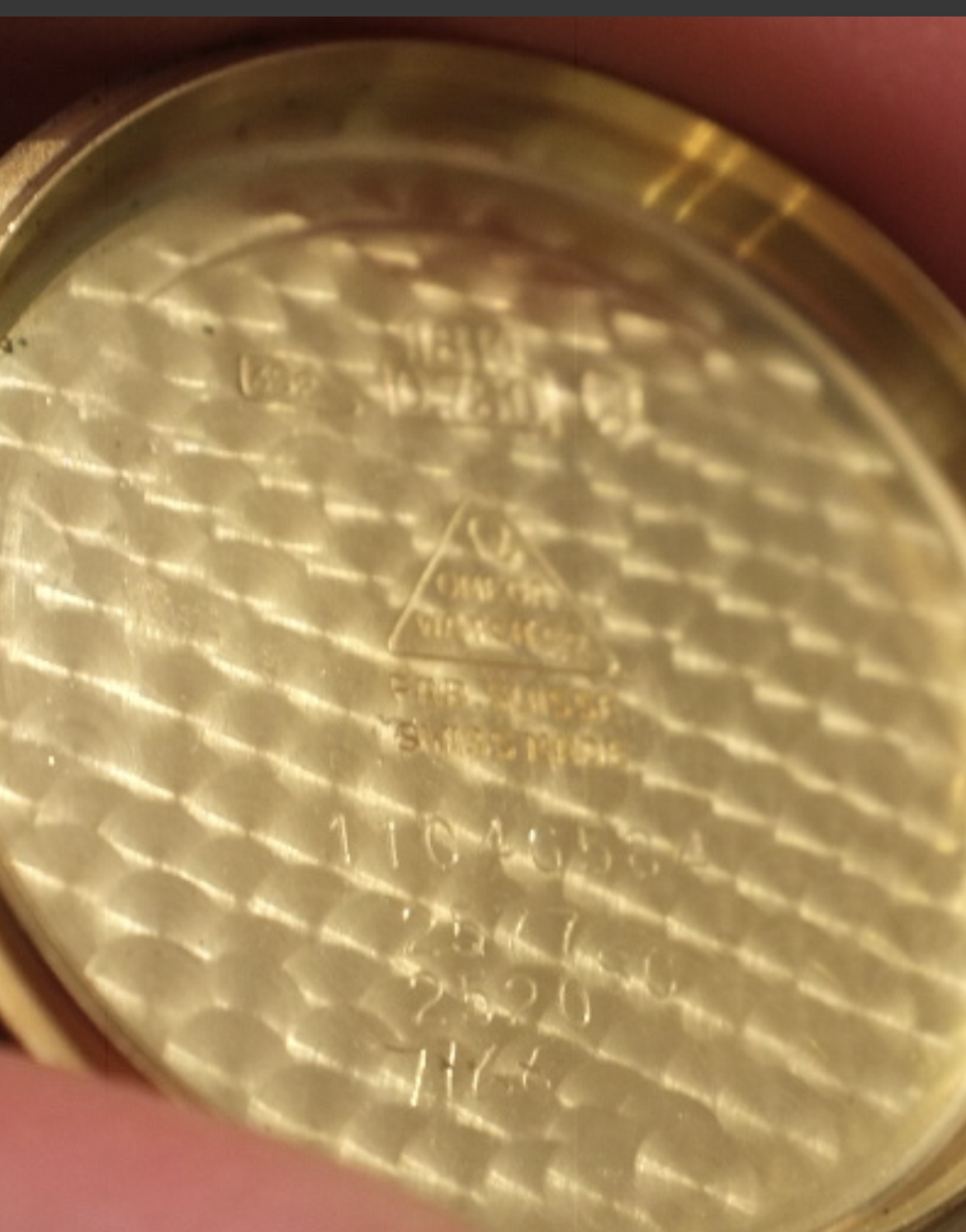

Very nice. Please confirm it is a 2517, and give case diameter.
I think it’s a Ref. 2520 if it’s solid gold.
https://www.omegawatches.com/en-us/watch-omega-seamaster-omega-ot-2520
These had “Officially Certified” on the dial if made in 1951 or later.
If the case is not gold, then it’s likely to be a 2577. These models are often confused, since some gold casebacks have both references.
https://omegaforums.net/threads/fs-18k-omega-chronometre-2577-2520-c-352-1950.32978/
Ref. 2517 had lyre lugs similar to early Constellations.

Looks like that came from a 2517. There is about a 2mm difference in the dial diameter between 2577 and 2517. 27 vs 29mm if I recall.

yes its 2520
