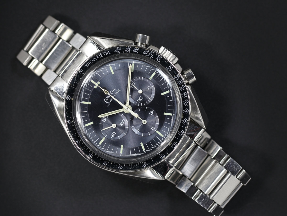

not all, if any, blue soleil dials are service dials. Thinking has changed in light of new evidence.
One metalic bluish dial surfaced recently in the WOK auction but that was a dial manufacturers sample and offered as such.
It used to be the thinking until recently that these blues were service dials - but then Omega started confirming some blue dials as original from factory.
The one I show has an extract of the archives confirming it.
in fact all the blue dials I know of have extracts now. Apart from the sample dials.
