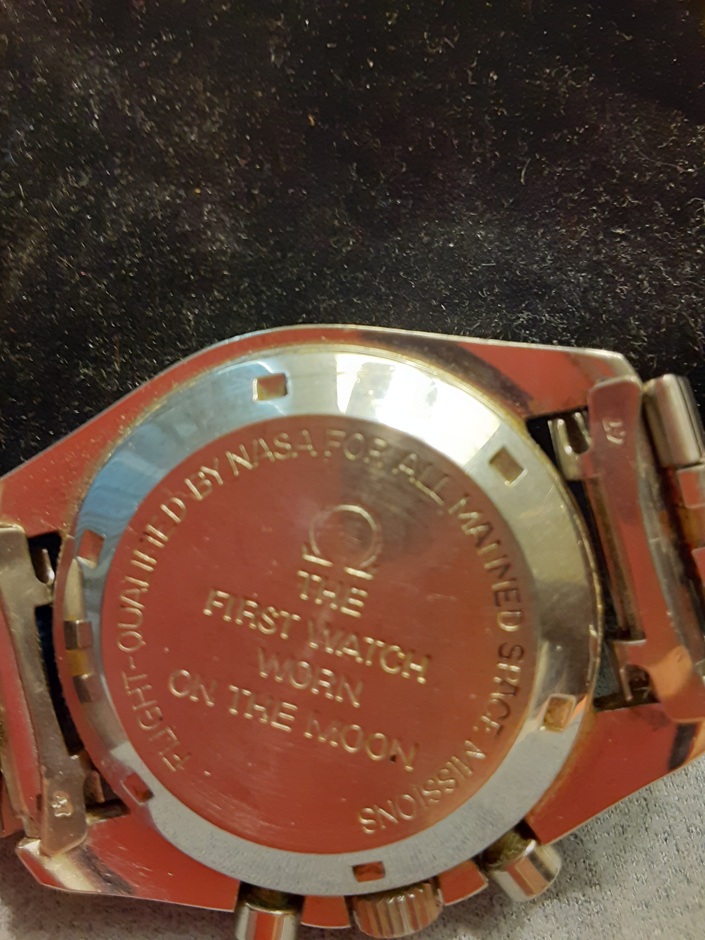

My ex-husband passed and I now have his watch.
I gave it to him in I think 1971 or 1972 for graduation from the U if Washinton. His degree was in Aeronautics and Astronautics. He was also a private pilot. I thought It was the perfect gift. He was living in Mexico and died 3 years ago. Don't know the value. Anyone know what I have here?

Your dates are probably correct. It is what's called a straight writing version of the Omega Speedmaster moonwatch. Its the second version as the first also contained the words Apollo XI on the back.

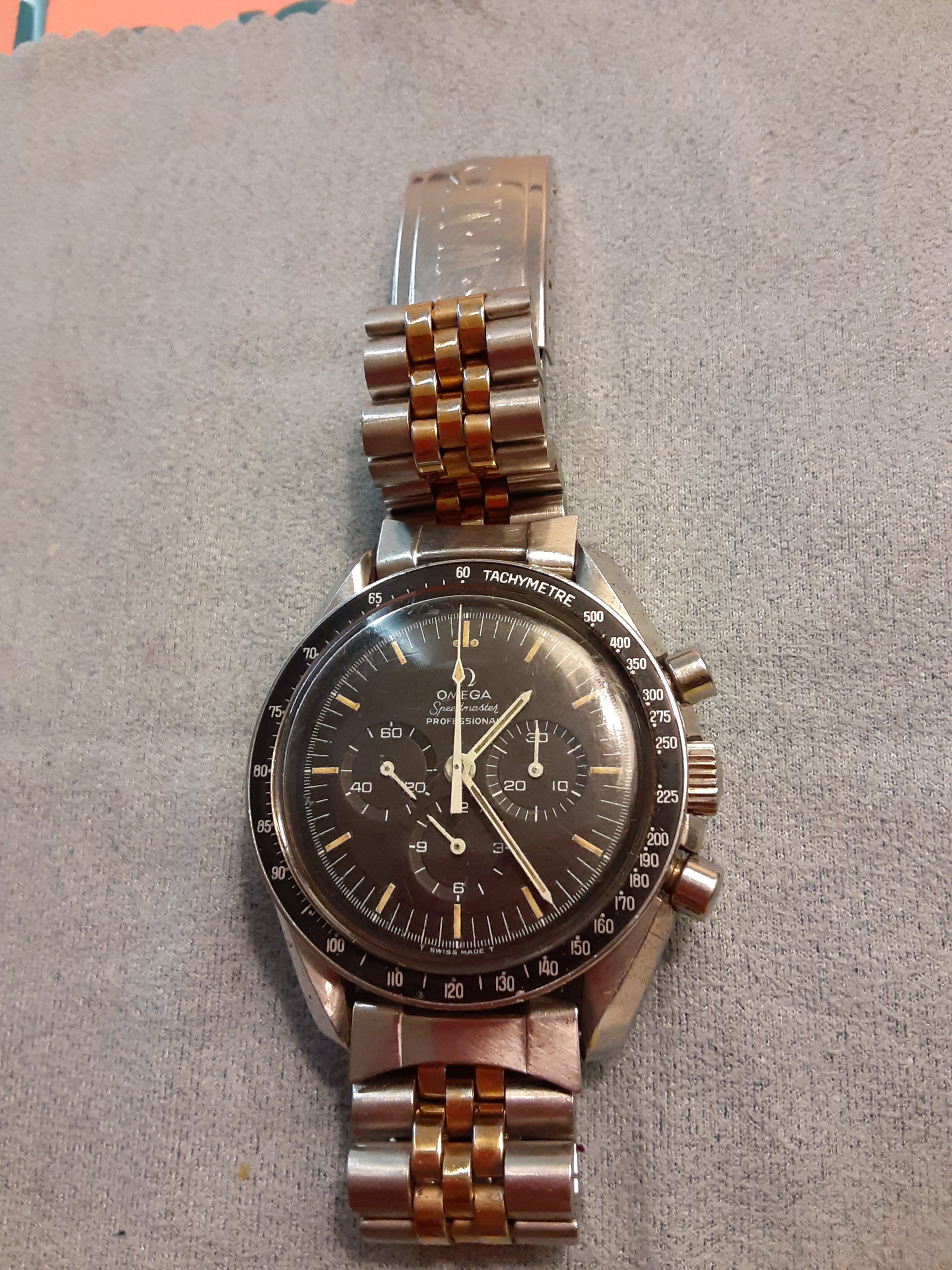

The band and end links are unusual but the markings seem to indicate that they could be original.
It looks to be in good original condition.

Hi - you bought your ex-husband a beautiful ‘69 Speedmaster with Straight Writing caseback.

Yes, it's known as the "straight writing" variation of the Speedmaster Professional reference 145.022-69. The bracelet is not original. Since your husband was the original owner, maybe take a look around and see if you can find the original bracelet or any of the original documents and packaging.

I think what you have here is a Speedmaster reference 145.022 with the movement Caliber 861 inside. That would be in keeping with the caseback design and the date when you purchased the watch and gifted it to him. Caliber 861 replaced Caliber 321 in the Speedmaster around 1968. If any info I have given you is incorrect I'm more than happy for the more learned members of this forum to correct me.

Bracelet is not original, but the #47 endlinks are and go with an 1175 bracelet. Notice the endlinks are installed backwards. The endlinks are quite rare and there's many folks who own 1175s with no endlinks. Many hundreds of times more likely to have a bracelet with no endlinks than it's to have the other way around.

Clasp looks to be original Omega, but engraving detracts from value. I suspect the main part of the bracelet wore out or broke and an aftermarket one was adapted in a creative way.

Thank you for your response. No, the band and clasp are all original. I had his initials engraved before I gave it to him.

I agree the clasp and endlinks are original, but I am almost certain the two tone part of the bracelet is not made by Omega, and am 100% certain it does not go with the endlinks.

This thread shows all the Speedmaster bracelets the last photo in the first post shows an 1175 with #47 endlinks.
https://omegaforums.net/threads/fro...ge-seamaster-and-speedmaster-bracelets.45883/
The 1175 is correct for a 1971 Speedmaster, see the chart here.
https://omegaforums.net/threads/vintage-speedmaster-bracelet-chart.29051/
There are some original 1175 bracelets for sale in the parts forum. You could reattach your original endlinks and clasp to a correct main part of the bracelet if you wished to restore it.

I purchased it at Ben Bridge Jewelry in Seattle in 1971 or 72. I remember now that I ordered the two tone band special because I liked the look of it. Didn't realize it wasn't an Omega. Thank you for your help. Kinda want it to be original.
I thought the end links looked a bit weird. Why didn't I notice that? Doh!
