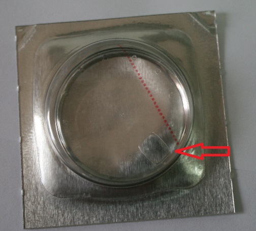

    Here's what my parts source has for the 'crystal replacement' with 'date'.
    Notice the 'L' in the part number. (I assume this means 'lens'??
    it's THIS correct? Dis the 'Calendar' variants of the SeaMaster 300 originally SOLD with the DATE lens crystal?
    I've 'never' seen (on this forum, ebay or anywhere else) a picture or advertisement of a SeaMaster (with Calendar)
    had a date lens. can any one corroborate this?
    the mystery widens.
