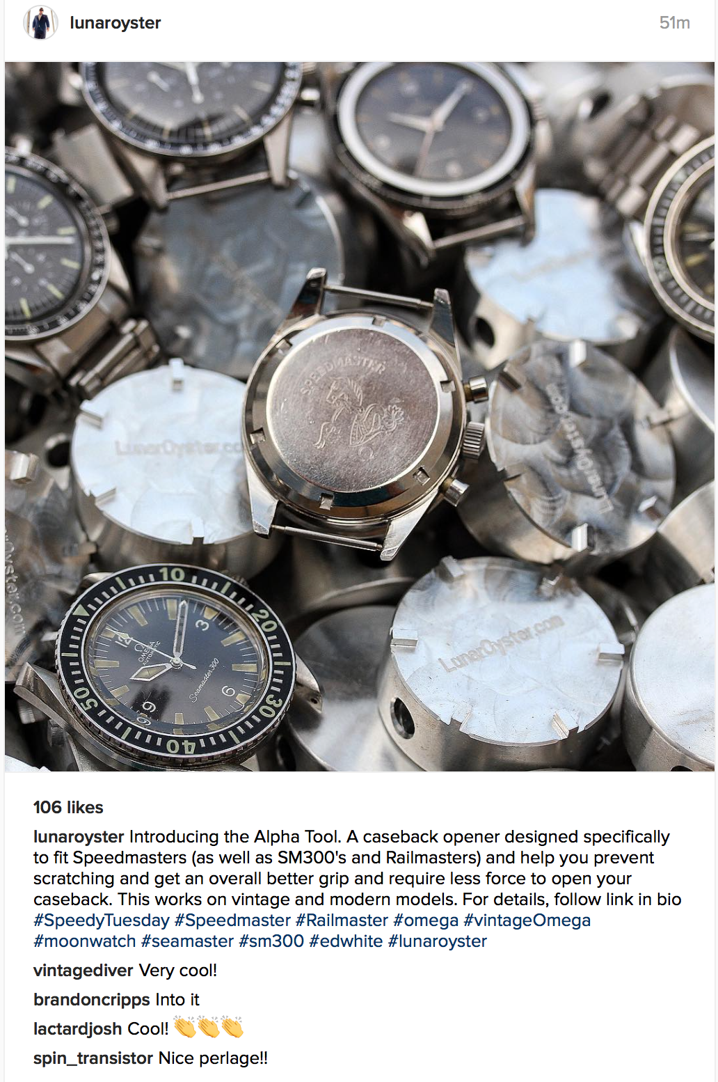

I came here to post the same thing...here is a screen shot
18,837
39,174
I know Paul's item hasn't got world wide patents, but maybe @KRLYUZH can shed some light?
2,293
4,582
Let's not jump to any conclusions. This could be an OEM arrangement that works to everyone's advantage. Have to admit I'm curious.
1,206
3,646
I have nothing to do with them. An exact copy, just in aluminum - how sweet. Some people.......馃が
Think I mentioned earlier in the thread that someone probably would steal the idea and mass produce them, so no big surprice, actually....
So much for our little father/son project, I guess..... It's been fun as long it lasted, and I had told him this might happen. Not the end of the world, just a bit annoying....
Thanks for all the support, guys - it's been fun 馃憤

Well, hang on a minute. I wasn't interested in opening my watch myself. Until now. I still may not open it, but a tool in my back pocket might be just the thing.
1,675
5,948
To make an exact copy and mass produce it is pretty crap 馃が
1,886
2,630
To be fair, I have one in nylon (hard plastic), made by an Irish chap, bought from TZ-UK a few years ago, so our own Pahari is not the first to make these.
