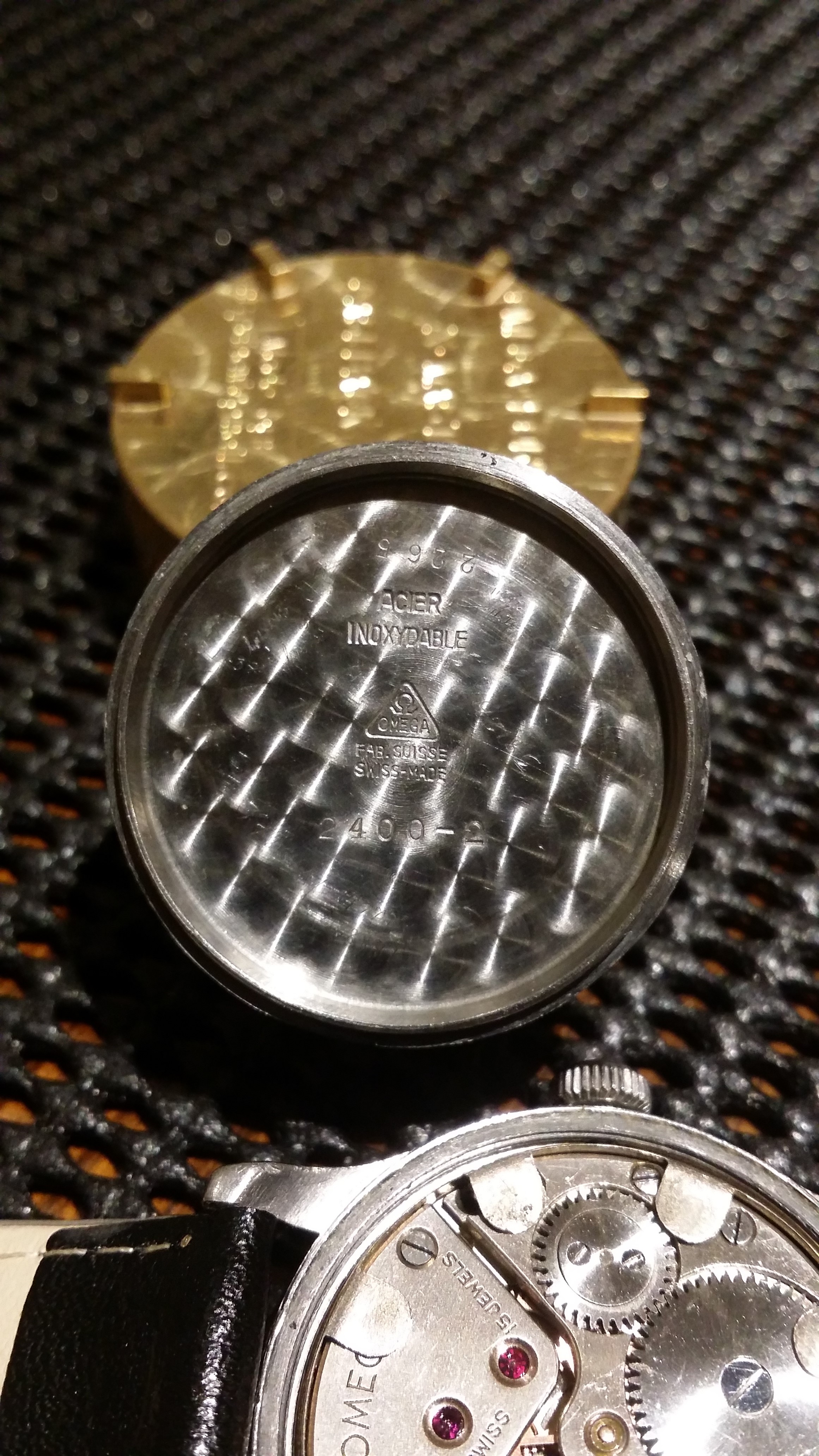

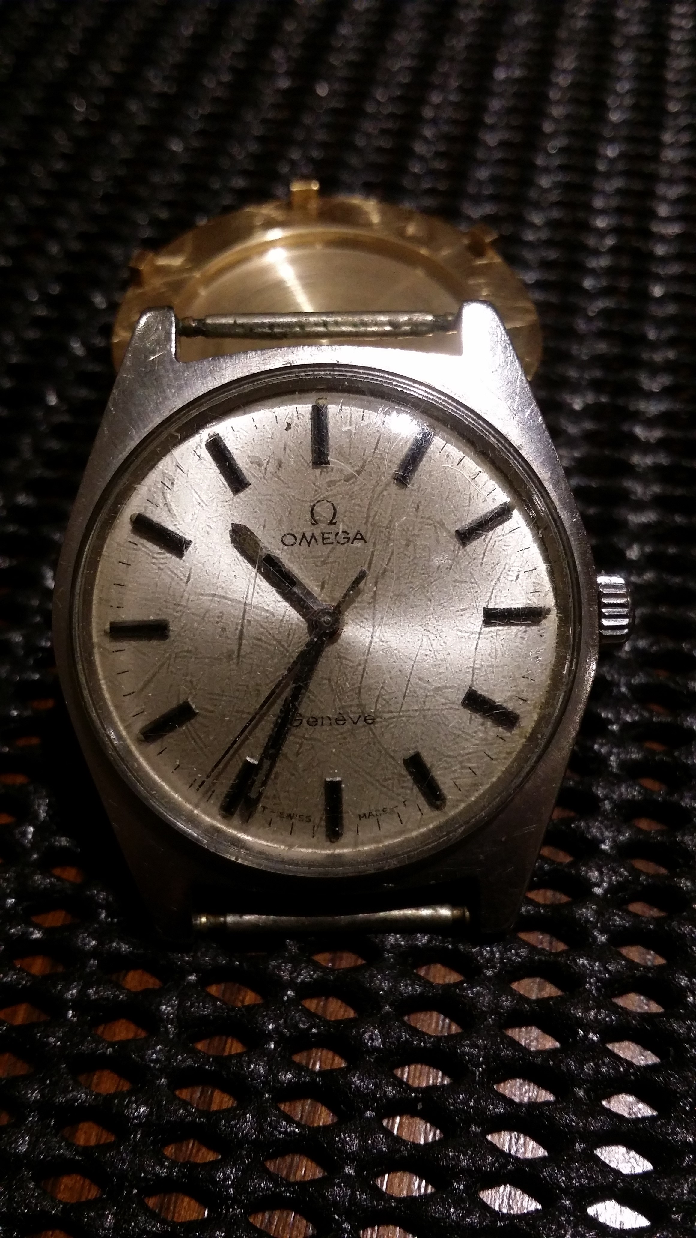

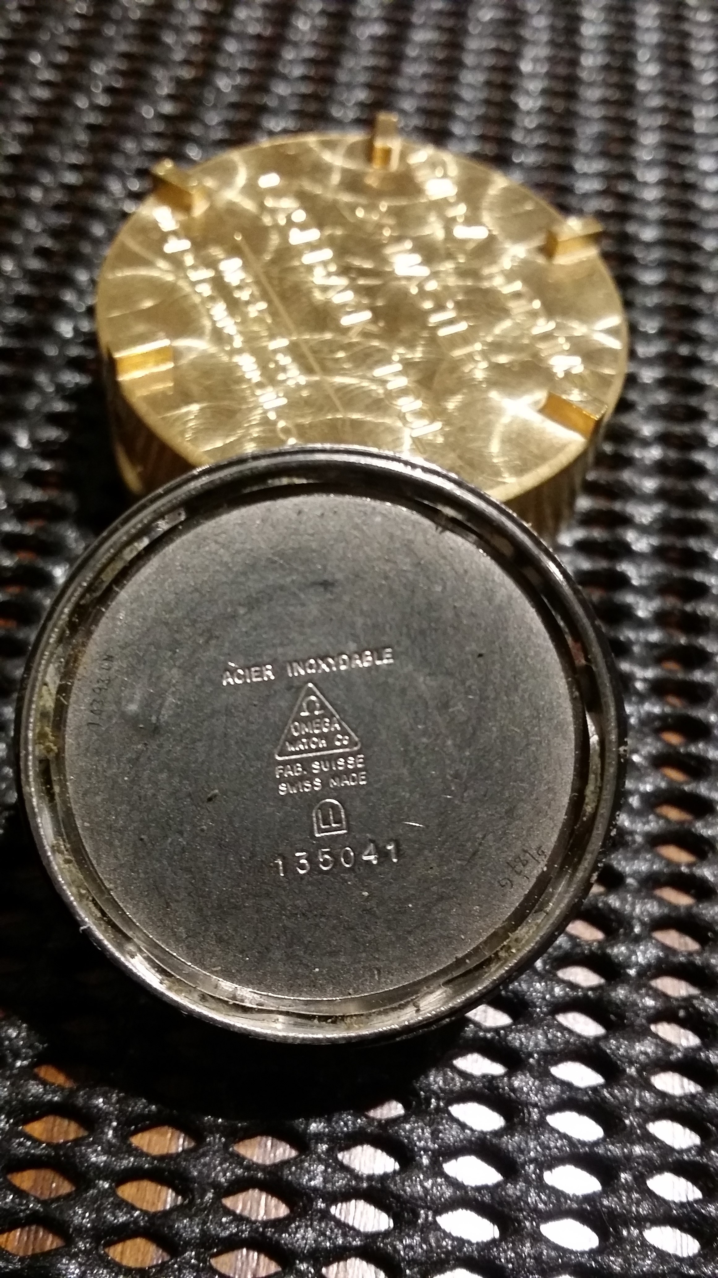

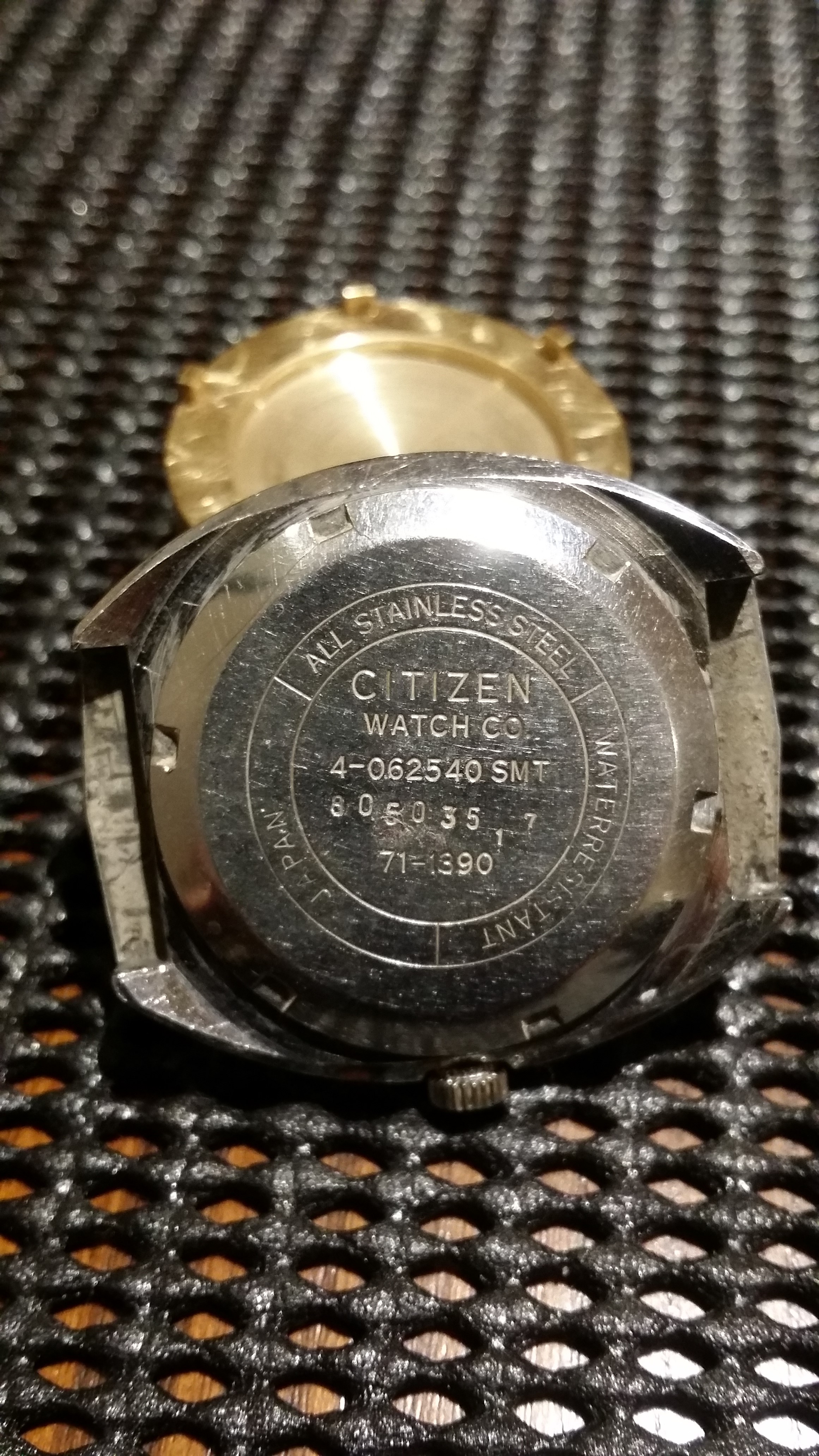

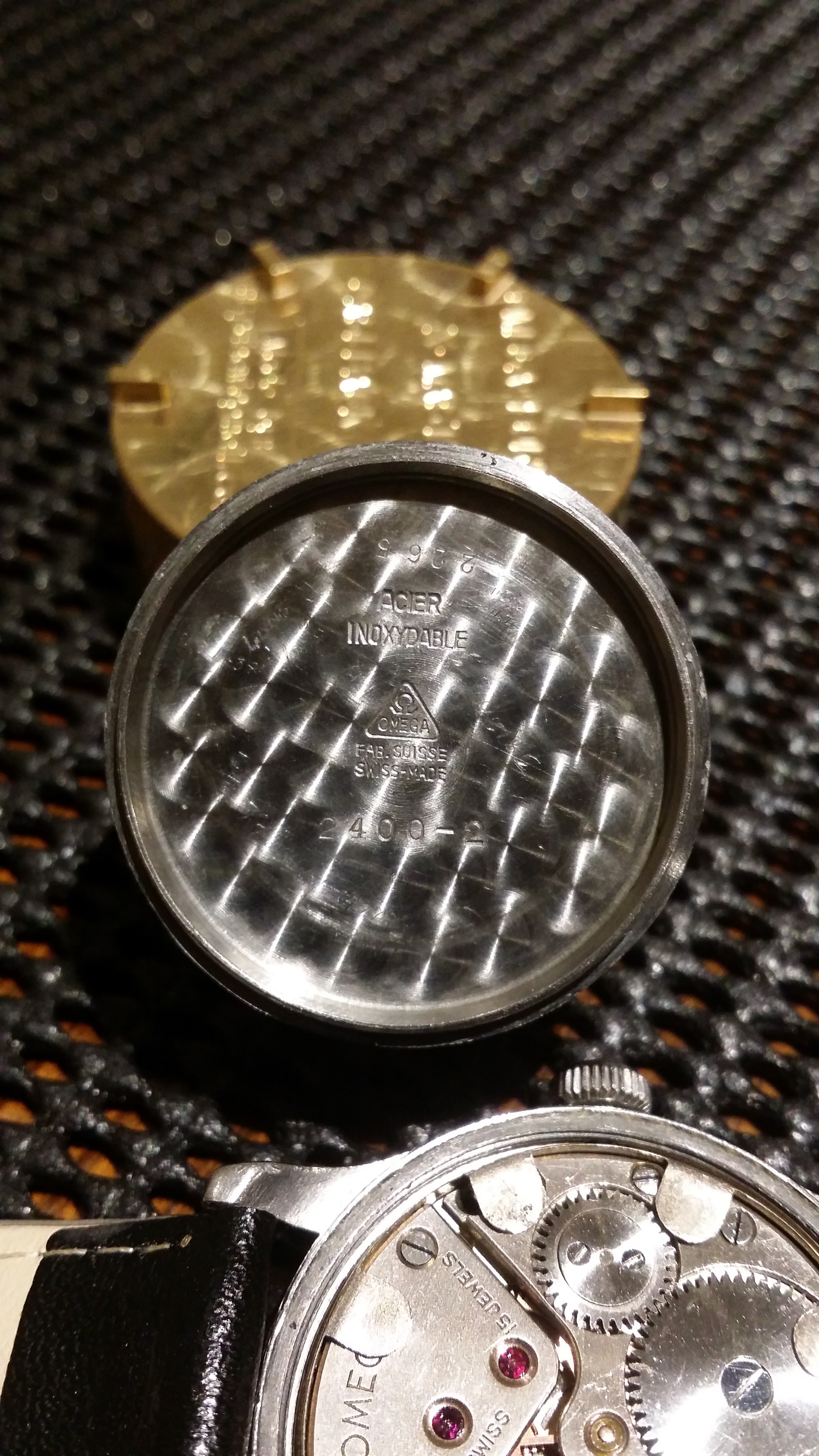

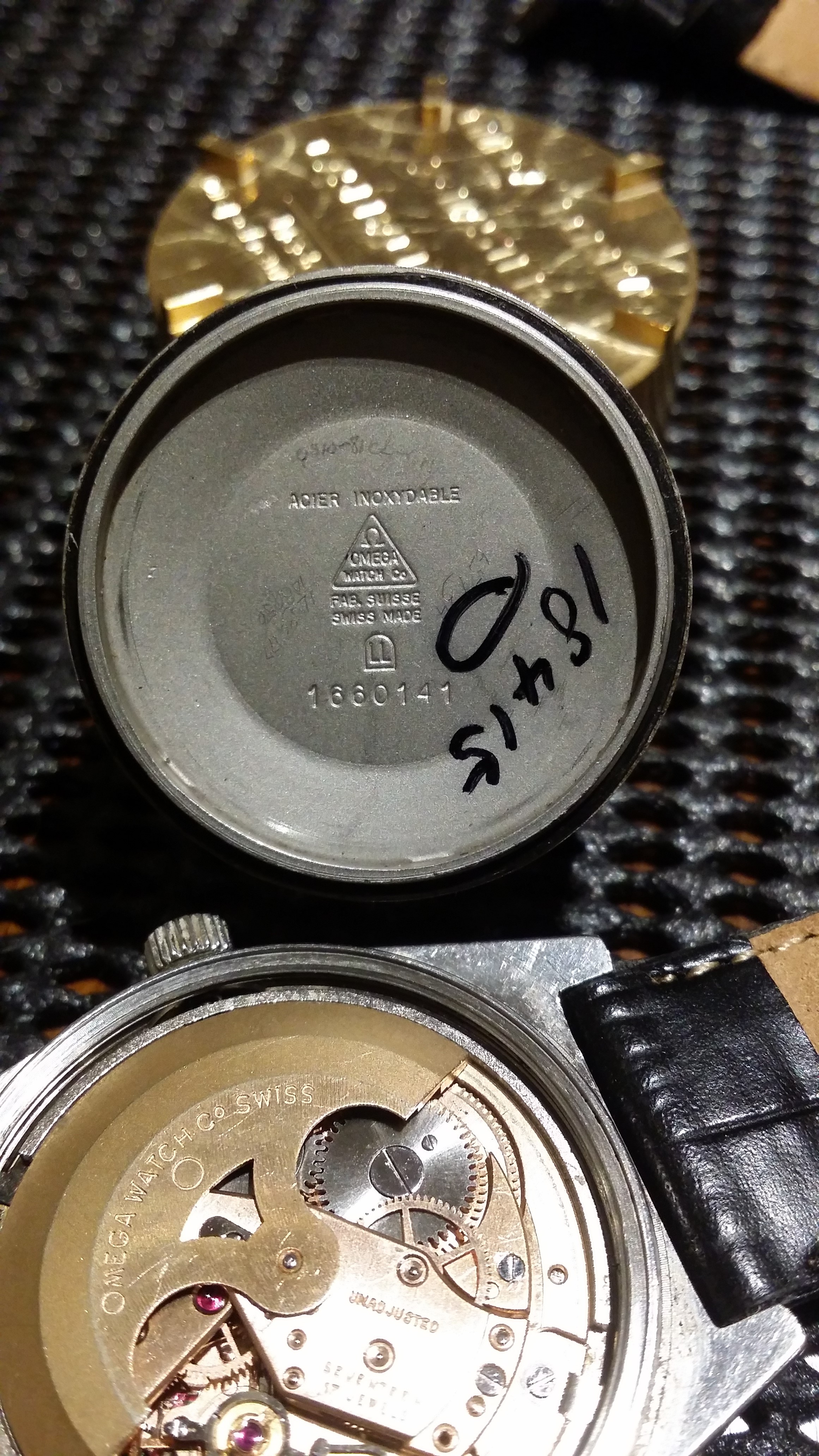

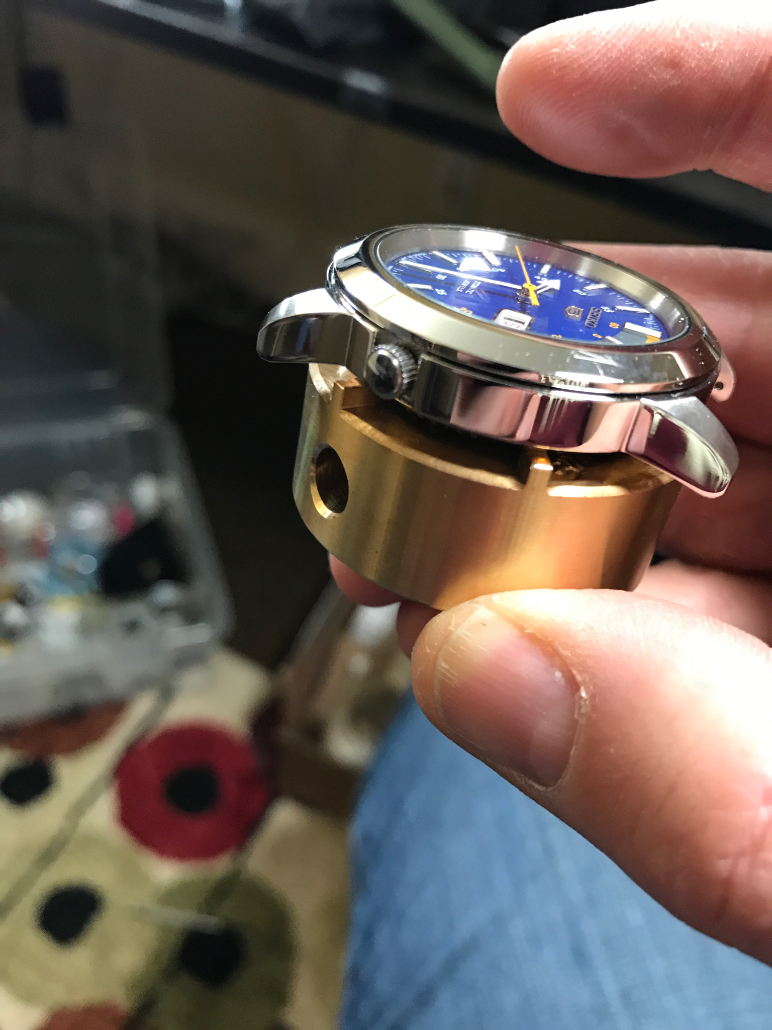

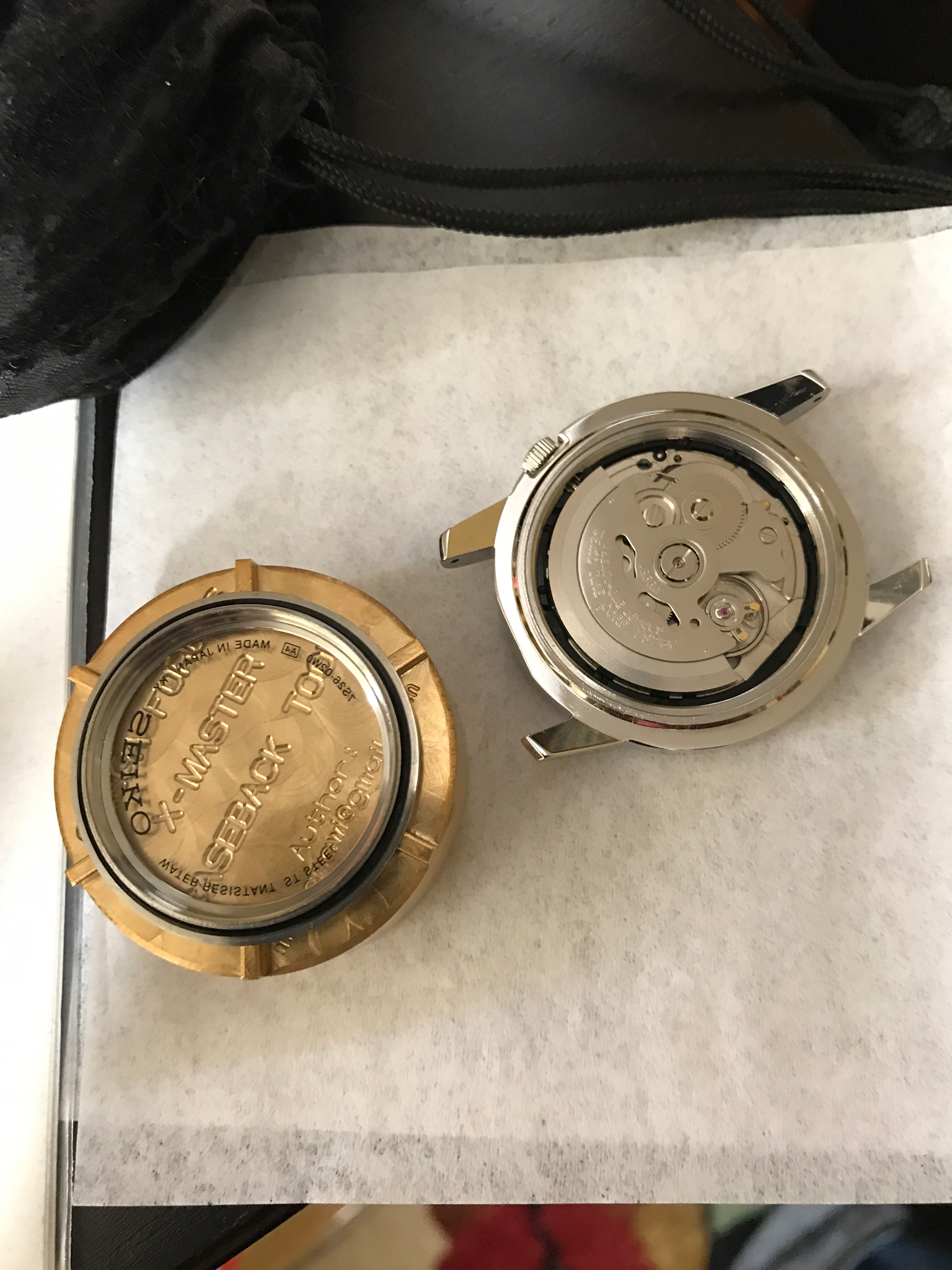

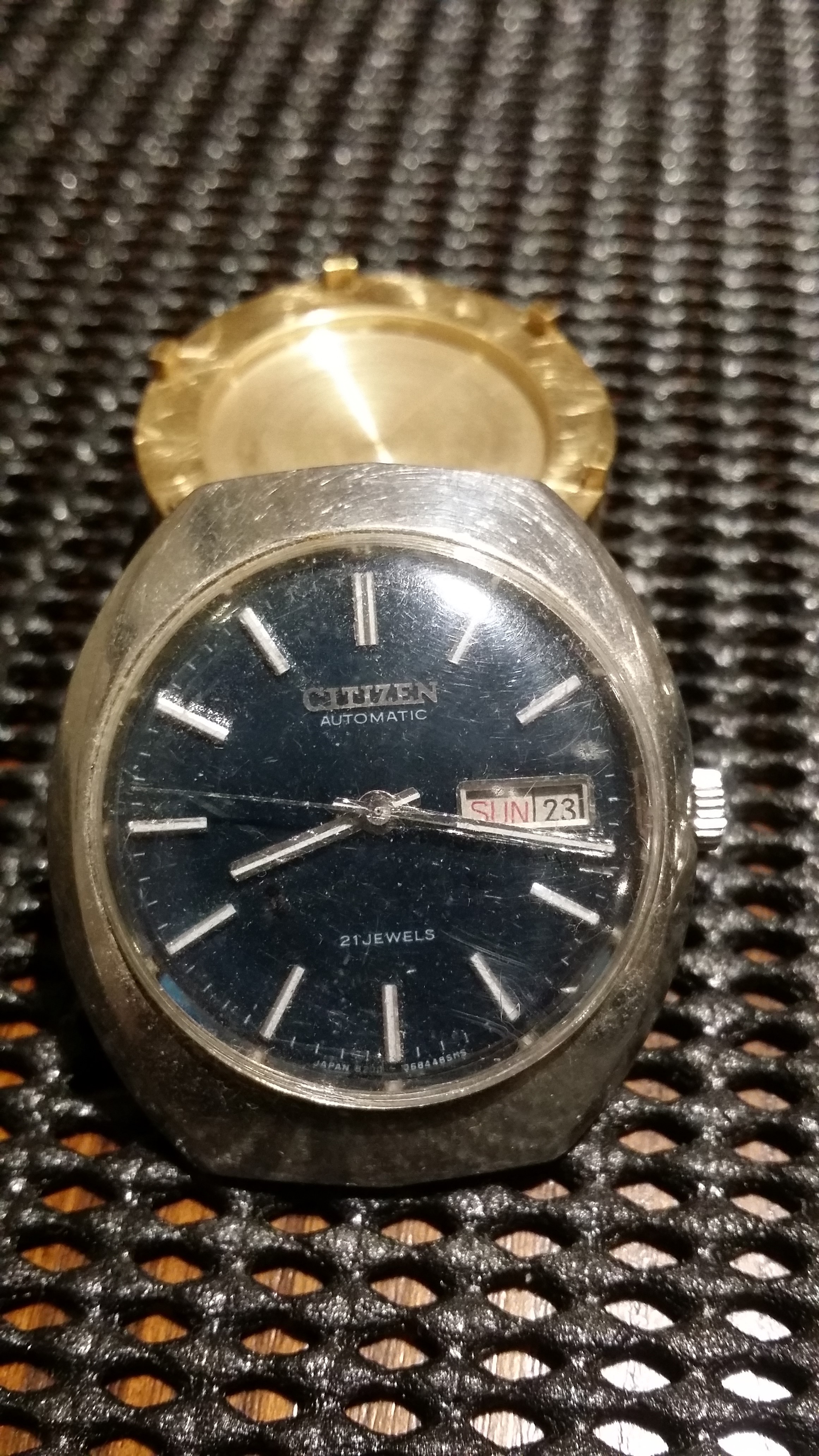

Mine arrived a couple of weeks ago, but i haven't had the time to try them out & take the pics till late last night.
This is for the 168.005 Connie case opener.

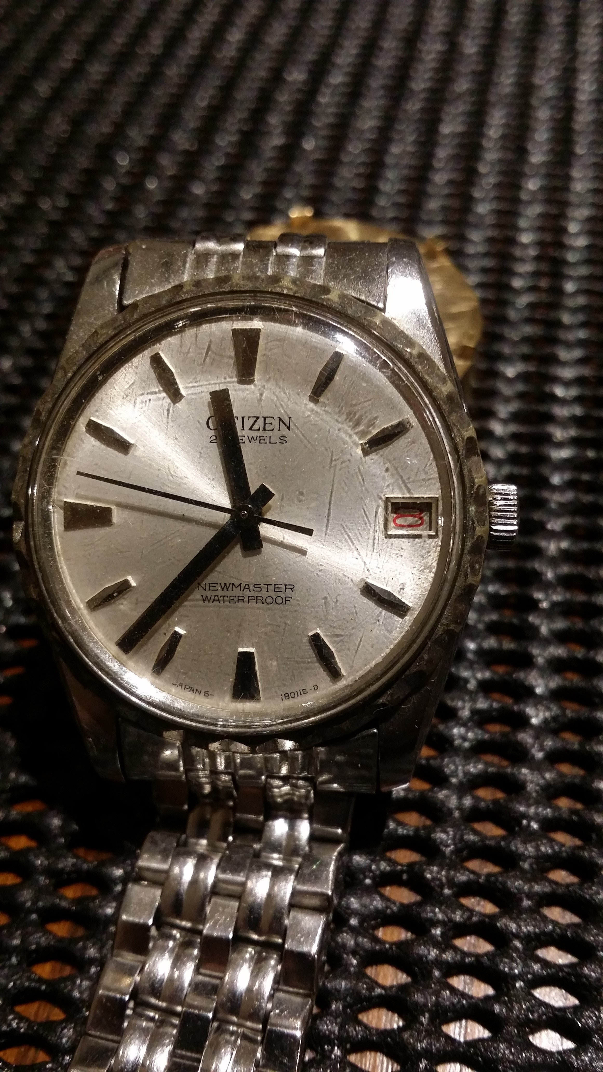

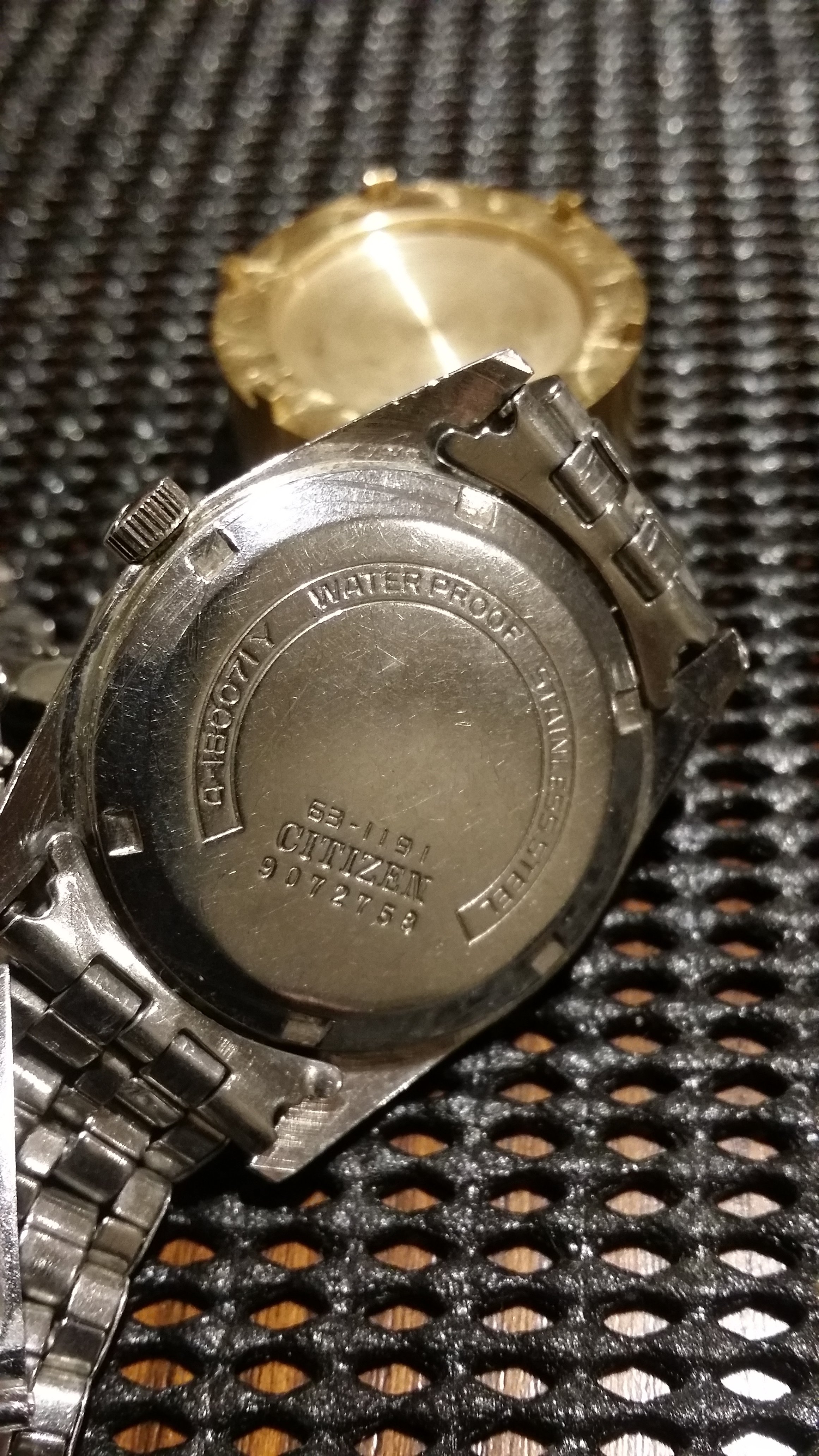

Also fits this Citizen parts watch
Citizen Newmaster

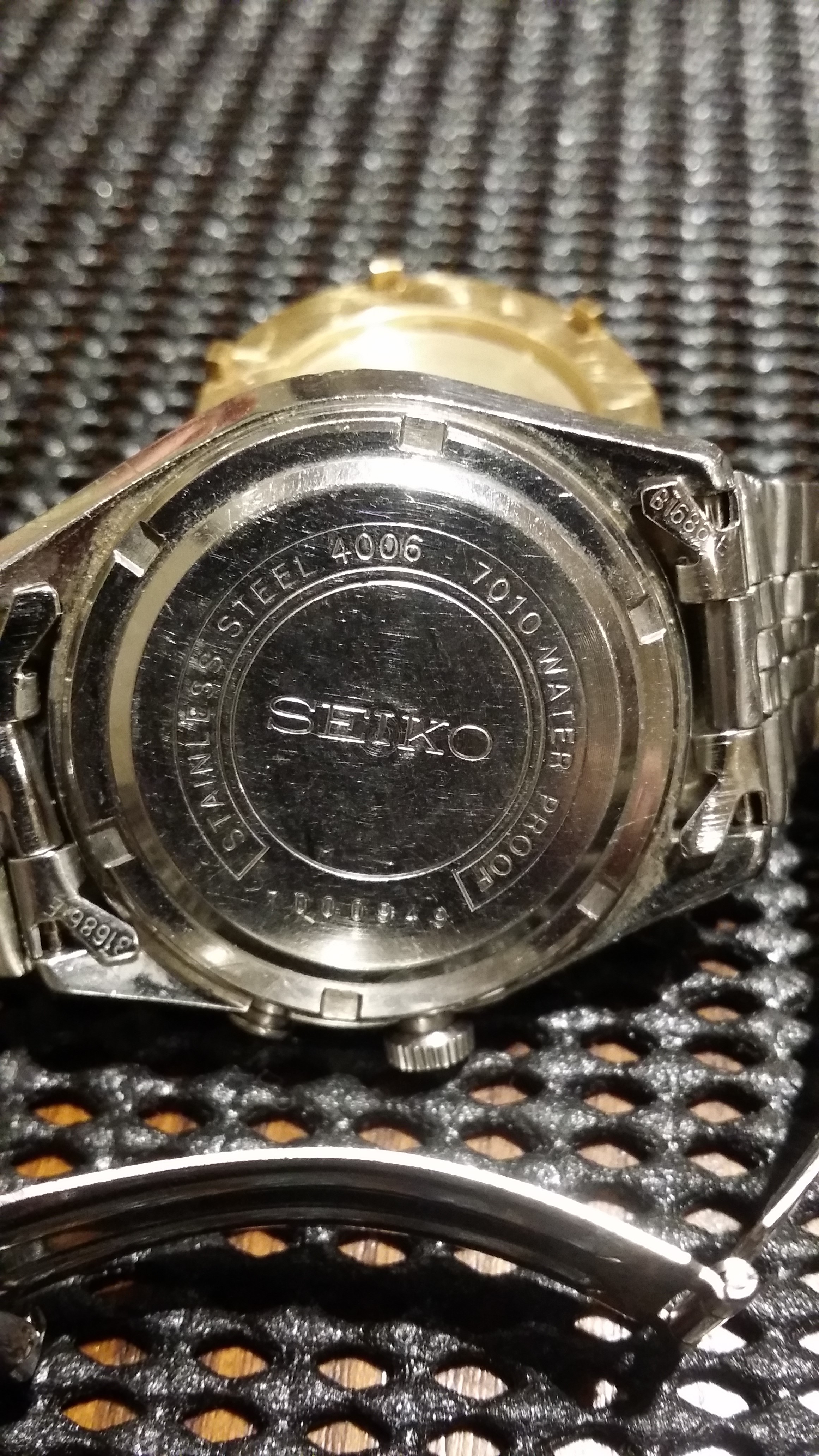

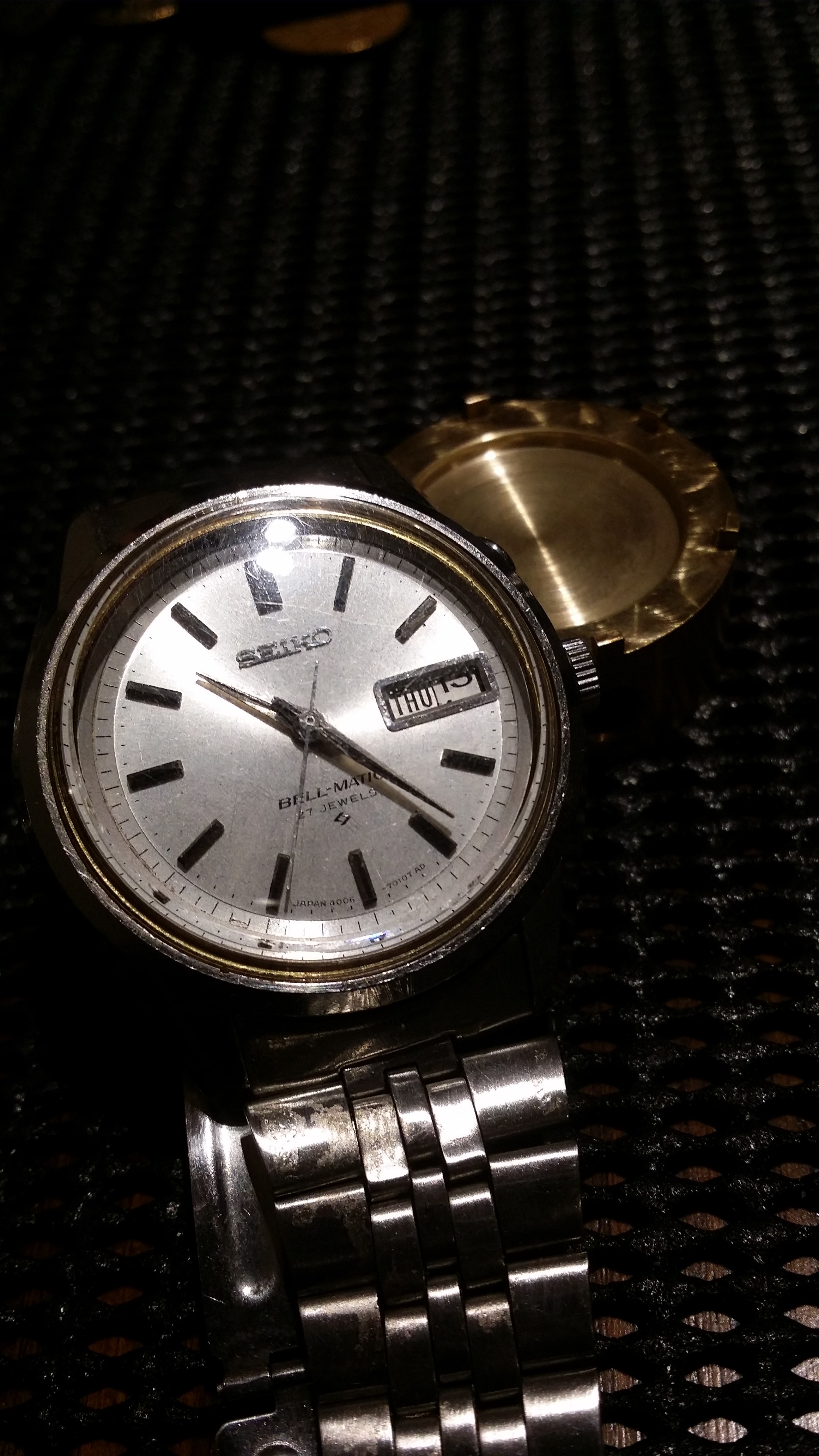

4006-7010 Bell matic

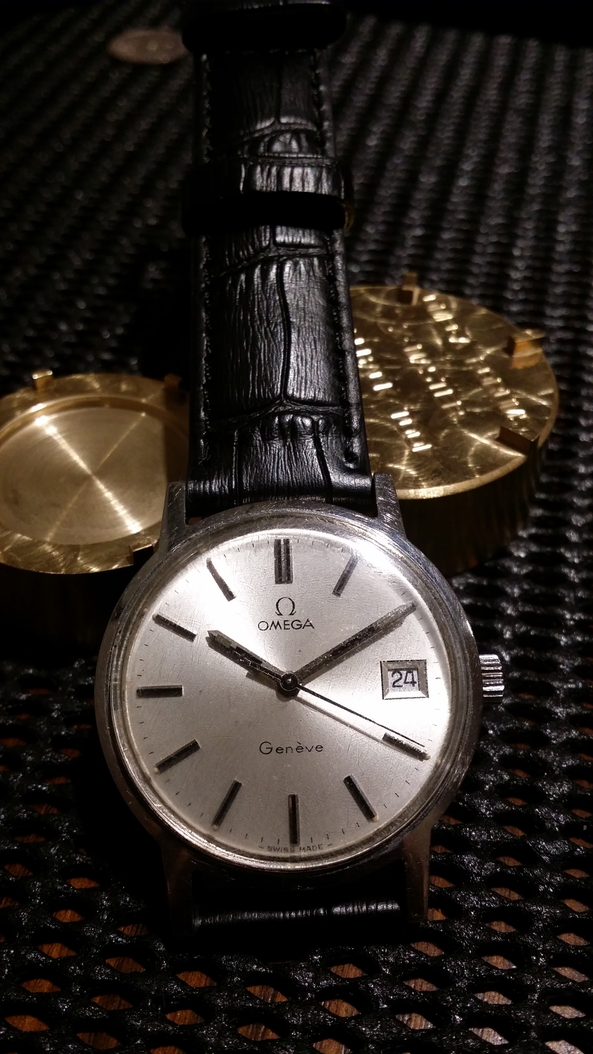

135.041 Cal 601 Geneve, this is a fresh arrival.
136.0098 Cal 613 Geneve

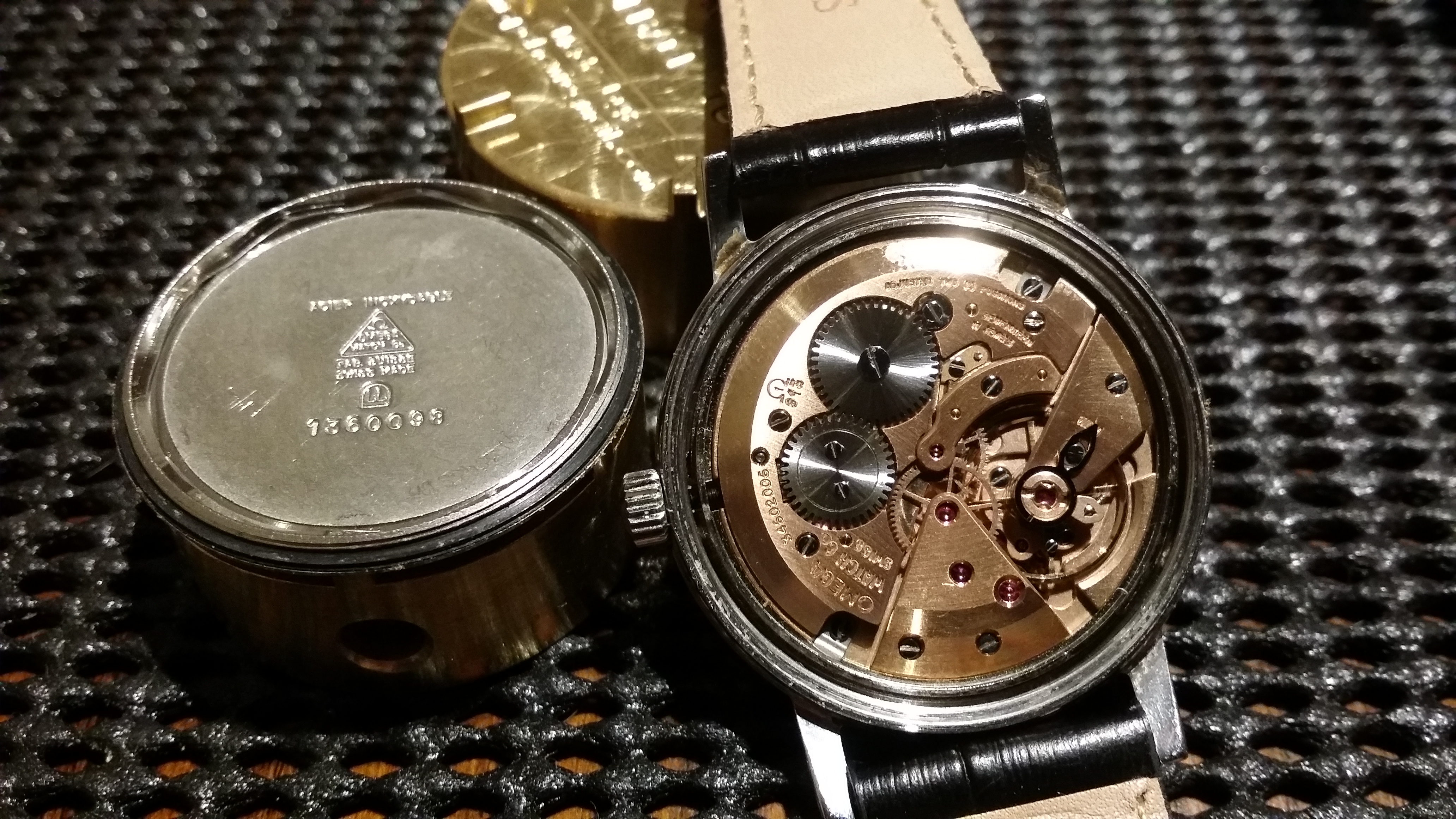

It fits this 2400-2 Suveran, but it doesn't fit the 2400-1 or 2400-5
166.0141 cal 750 Geneve
It also fits these 4 reference numbers, but they were a little tight & it was too late to start looking for some tools... I was given "the look" just then. "The look" means its time to cease all (my ) activities...
168.005 Constellation
145.010 Chronostop
2676 Bumper
167.070 Seamaster

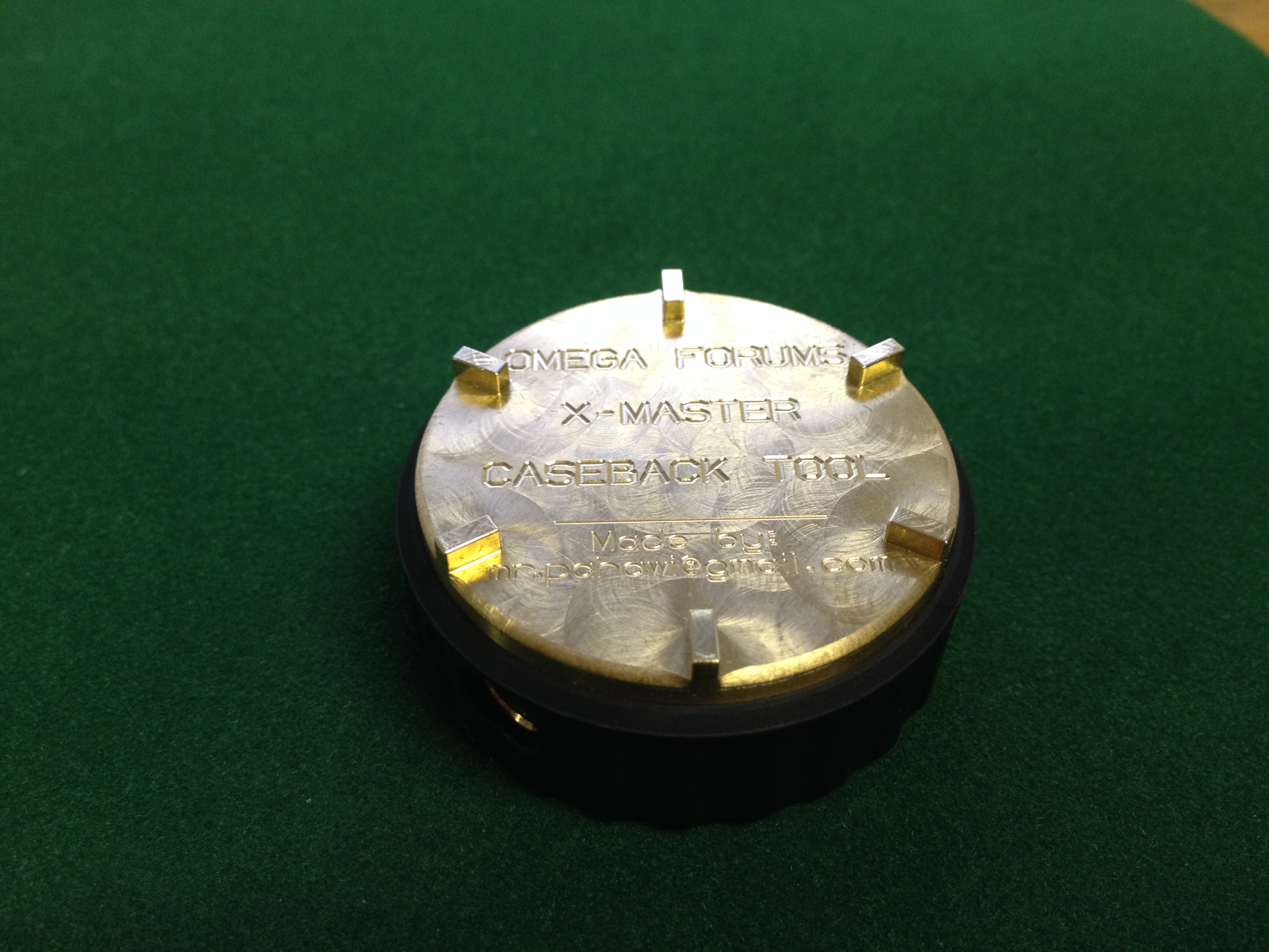

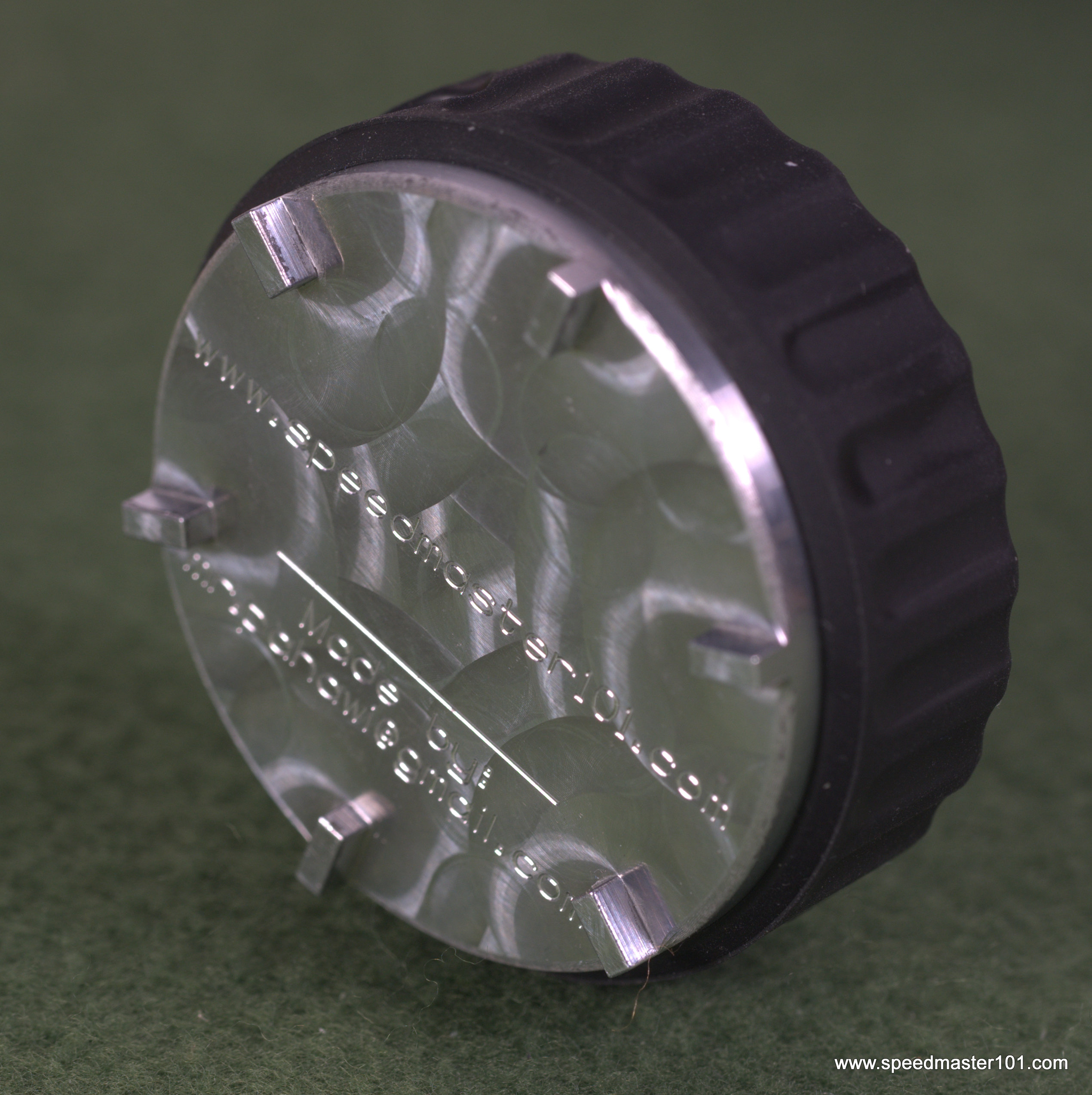

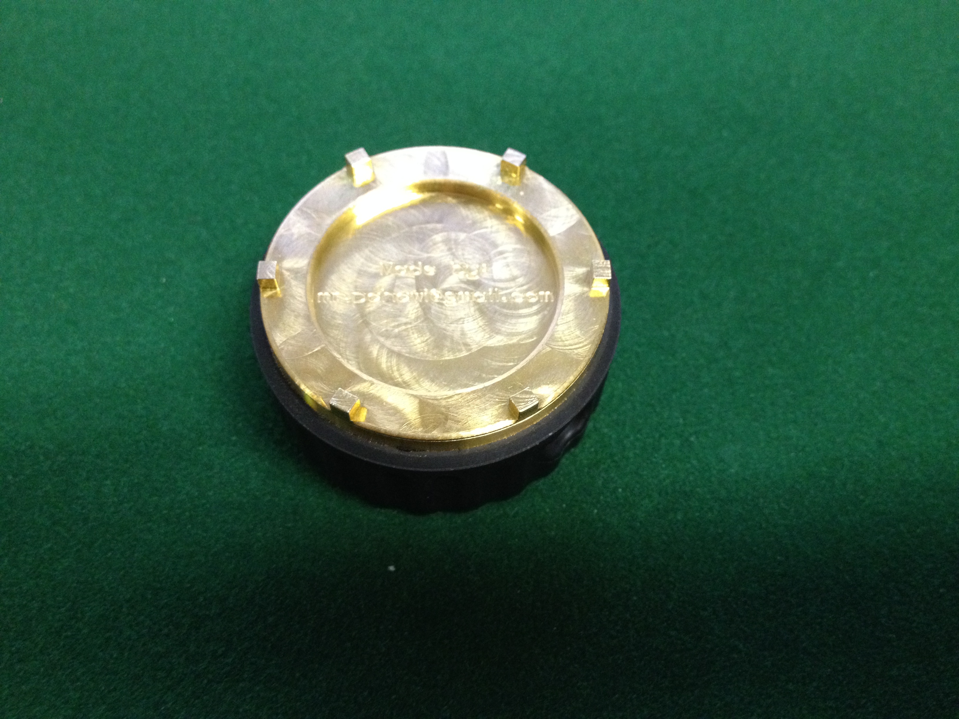

Now available with rubber grip (pic from speedmaster101)
1,206
3,646
Thanks guys 👍

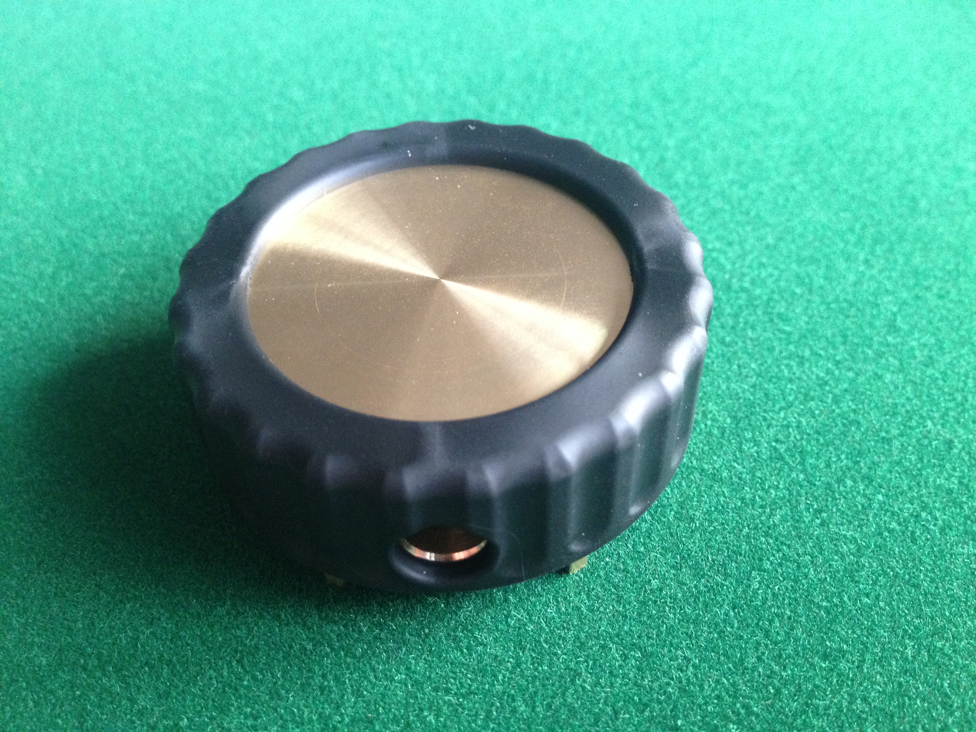

As Oddboy shows they now come with a glued on rubber grip:
The rubber fits the “old” openers too, but the holes in the rubber (for the bar) and the tunnel through the opener probably won’t line up perfectly. The rubber itself will be free, but with untracked shipping, envelope, a drive to the P.O. etc., you’ll probably still be facing $15-20 😟. PM me if you want me to ship you the rubber thingy.

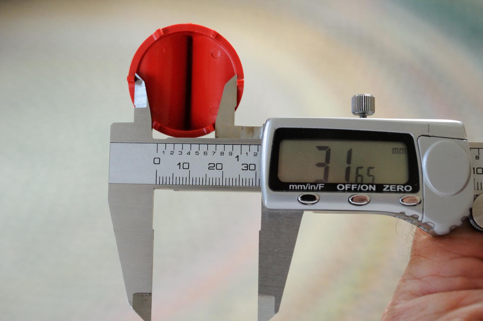

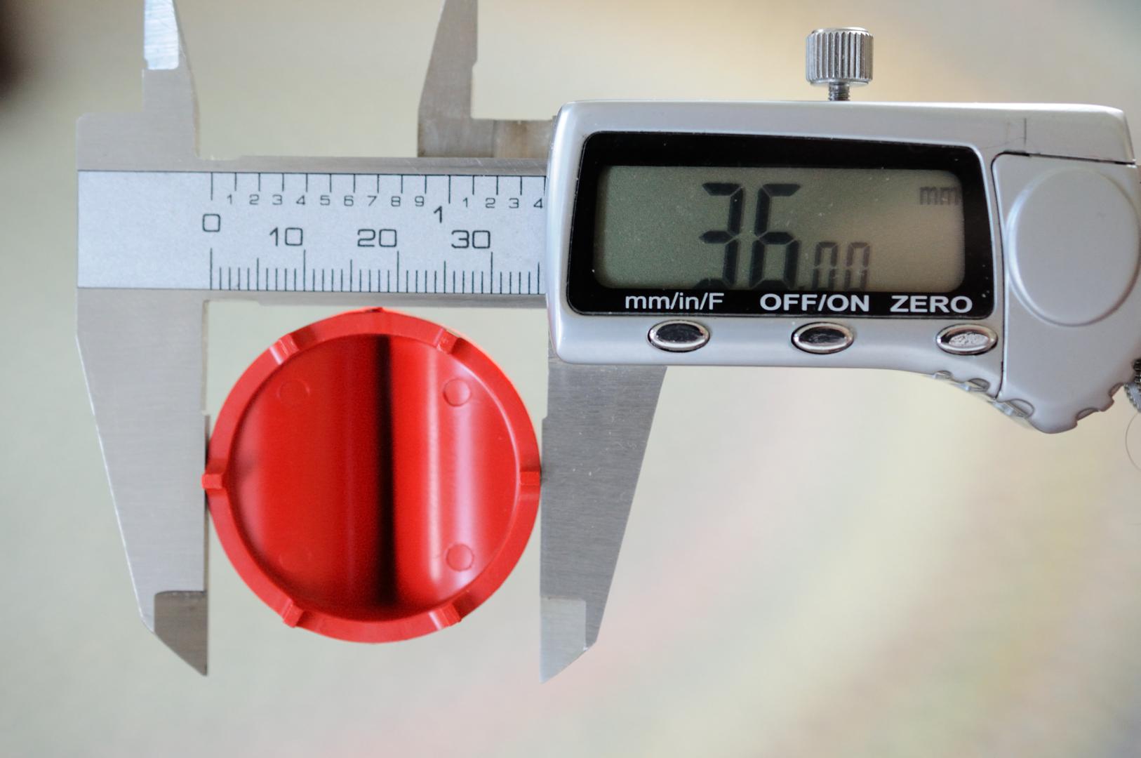

Here are some measurements pictures of the Tool 206:
