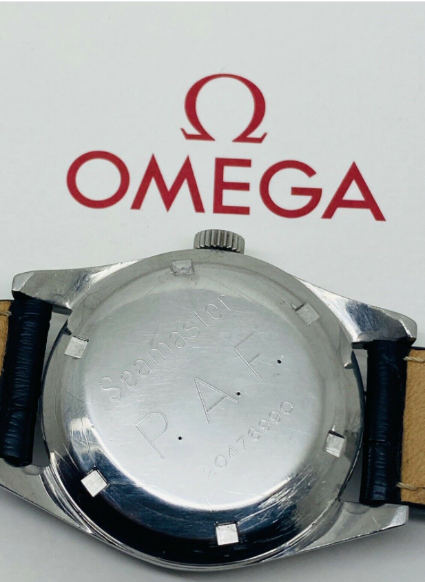

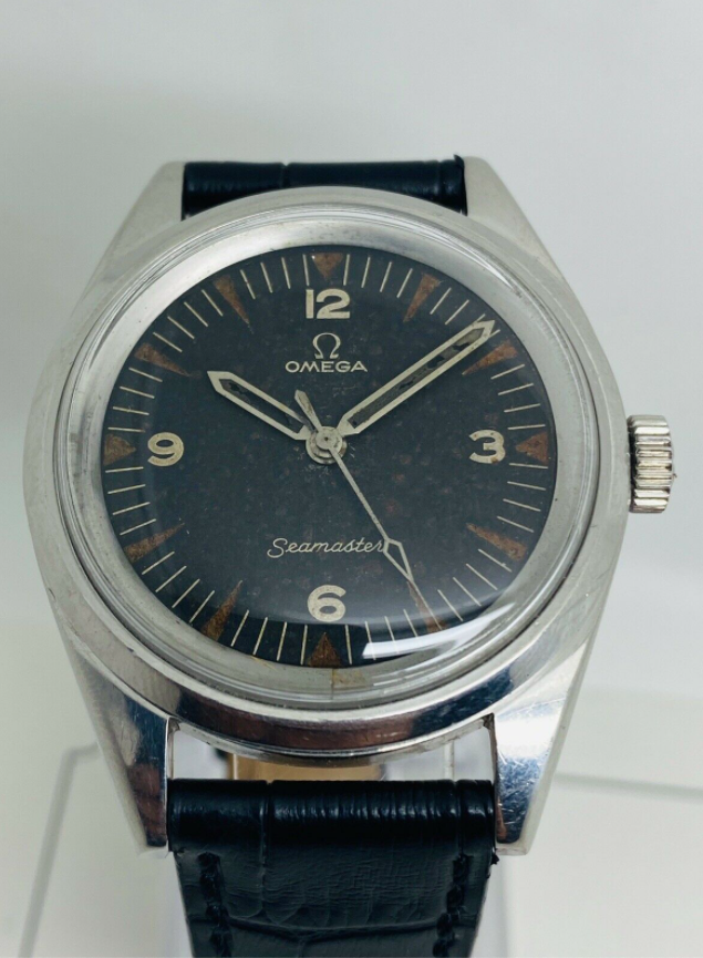

...but it doesn't match up to what I'd expect.
Leaving aside the condition, the 135.004 variant should have a seahorse on the back, shouldn't it? This one doesn't. So is the extract a fake and the watch a crock, or is there something I'm not understanding about these pieces?
Also, the "Seamaster" engraving doesn't look very 1964.

The dial is reminiscent of one in Christie's current (Oct. 15-29) watch auction. Generally speaking, the 'S' you mentioned looks okay to my eyes as far as font, although others will have more experience with these. Lume is of course missing.
Casebacks I have seen with both the usual Omega engraving, or the plain P.A.F. and accompanying issue info, as here, but I have no idea whether these casebacks were shipped from factory like this or were an added part - I'm sure someone here knows this info off the top of their head.
If I came into a legitimate and documented P.A.F. and needed to sell it, for whatever reason, I can't imagine why I would use ebay - they may be trying to cross promote the listing in hopes of a bidding war to drive it over high street prices, is the only thing I can think of.

I agree the Seamaster on the front looks OK - I meant the engraved Seamaster on the back.
I also agree that eBay is a strange place to sell a watch like this so maybe you're right - it's about generate awareness and interest.

Also, do PAF watches have the movement number stamped on the caseback? I don't see the logic of a military adopting the serial number from a watch company to keep track of their ordnance, but what do I know.

Maybe a typo. That calibers is Center second. And many have the mvmt number engraved outside the back.
