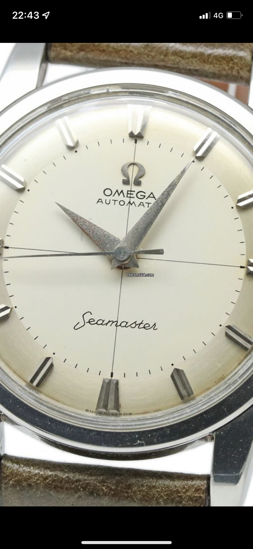

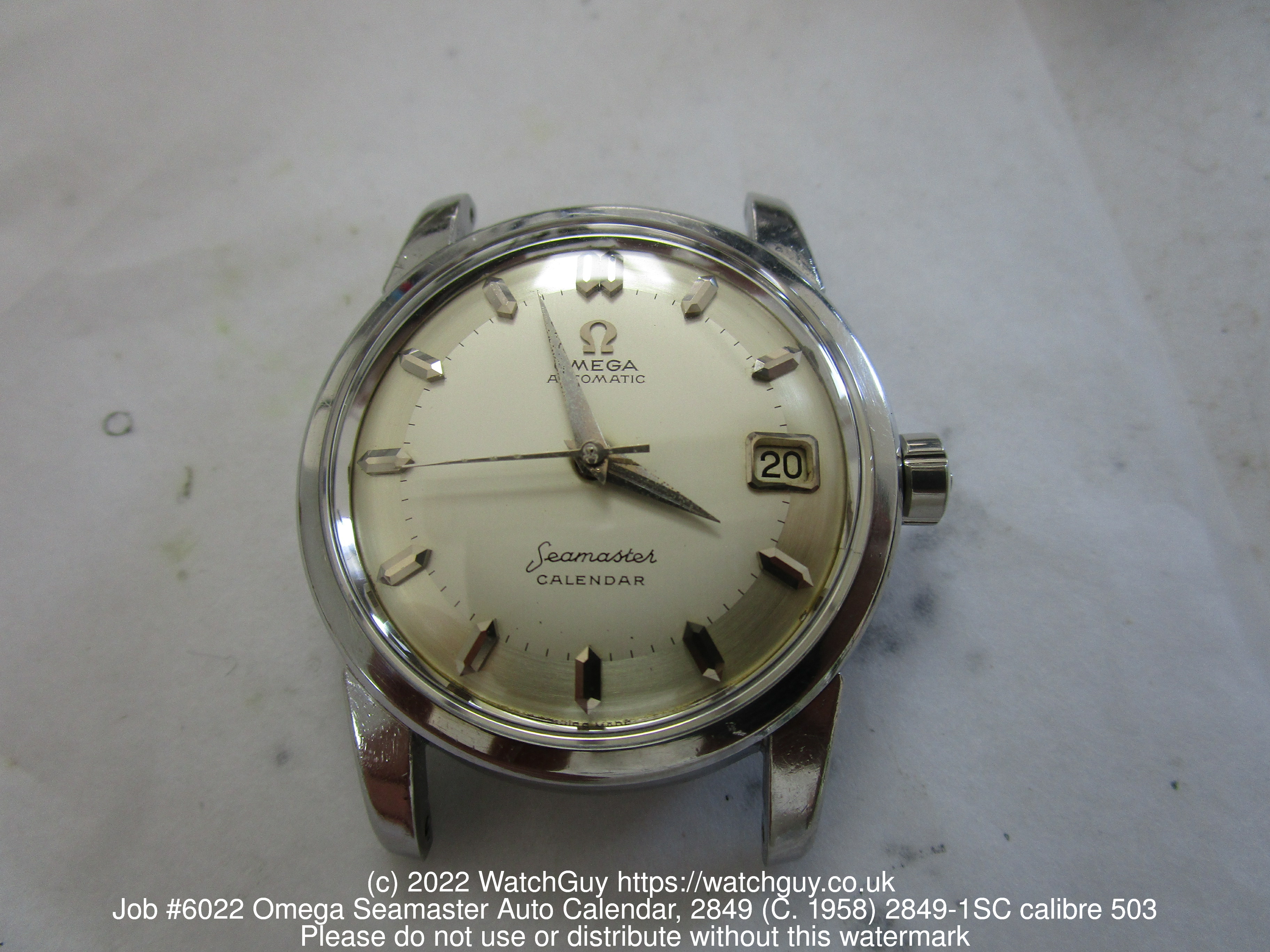

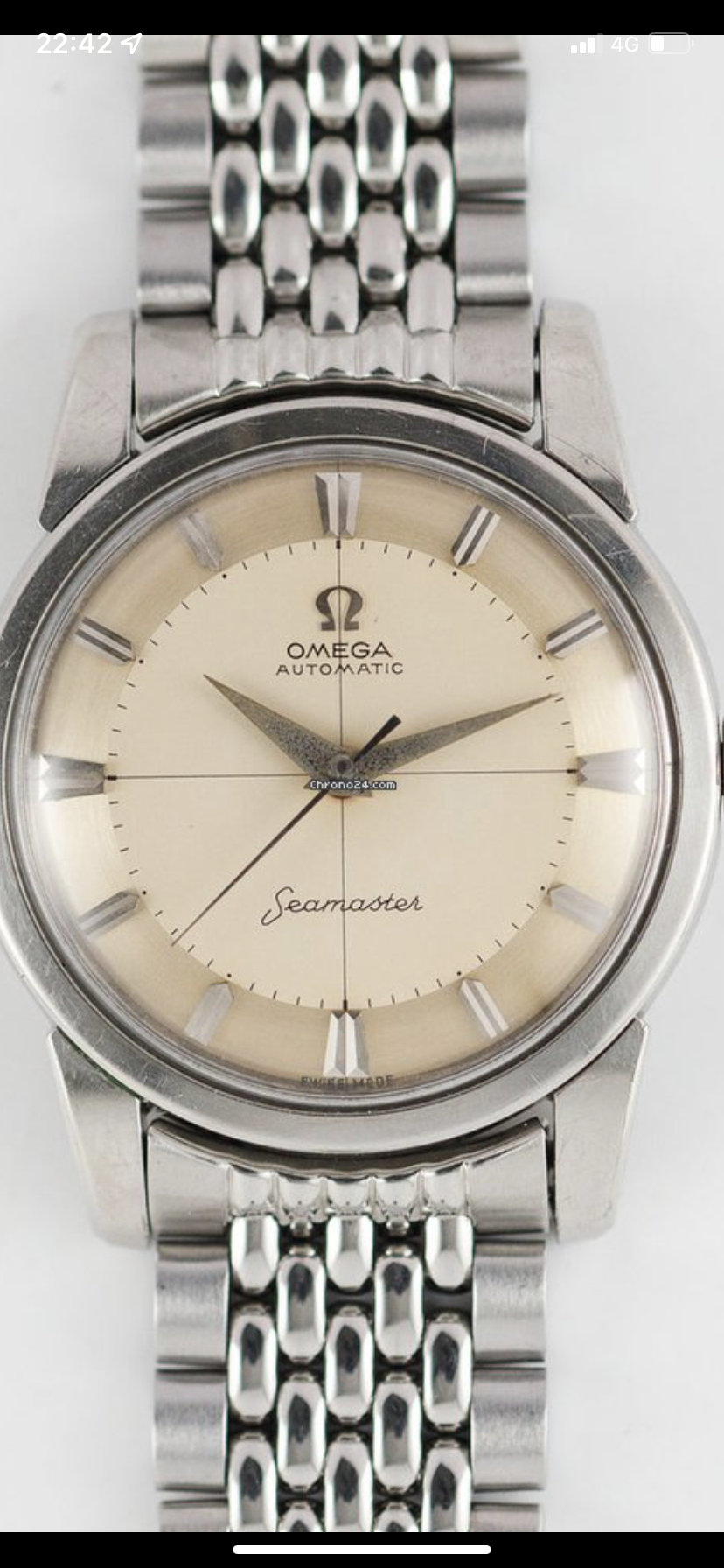

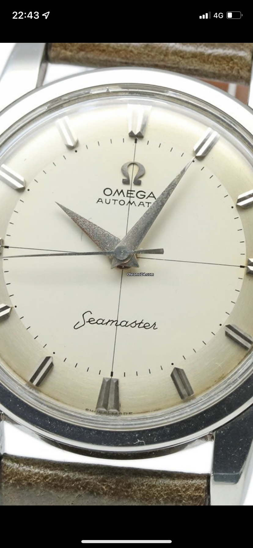

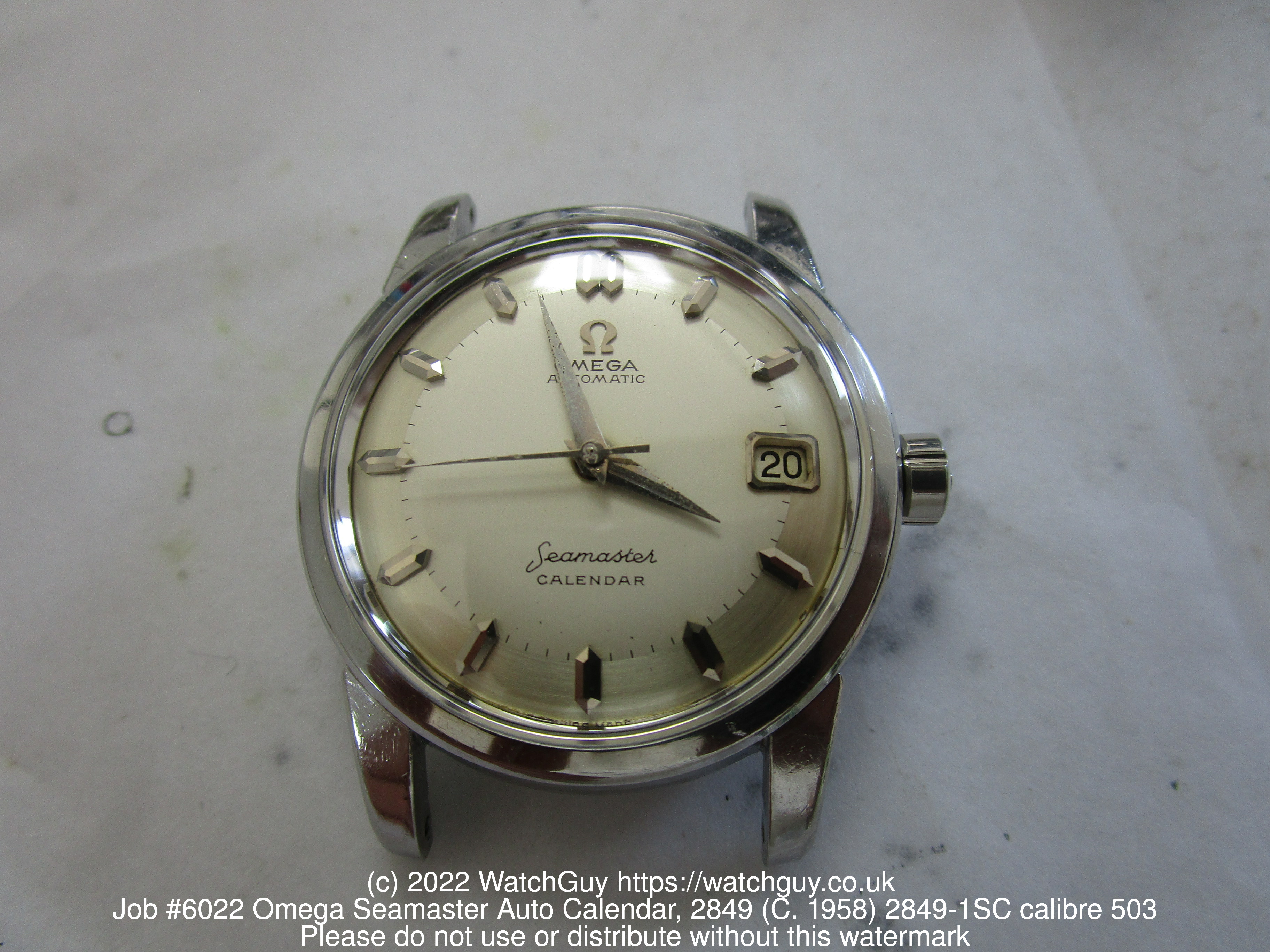

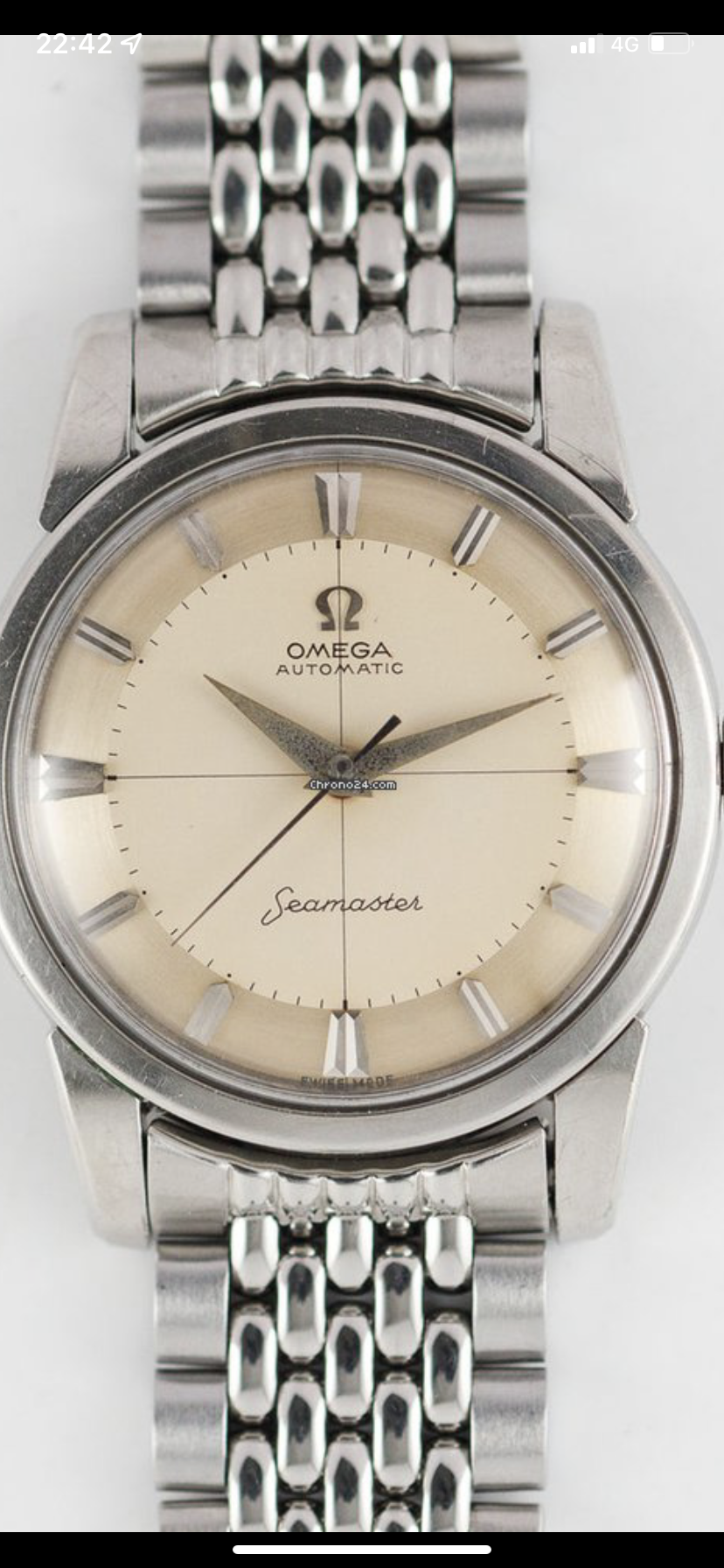

Hello all,

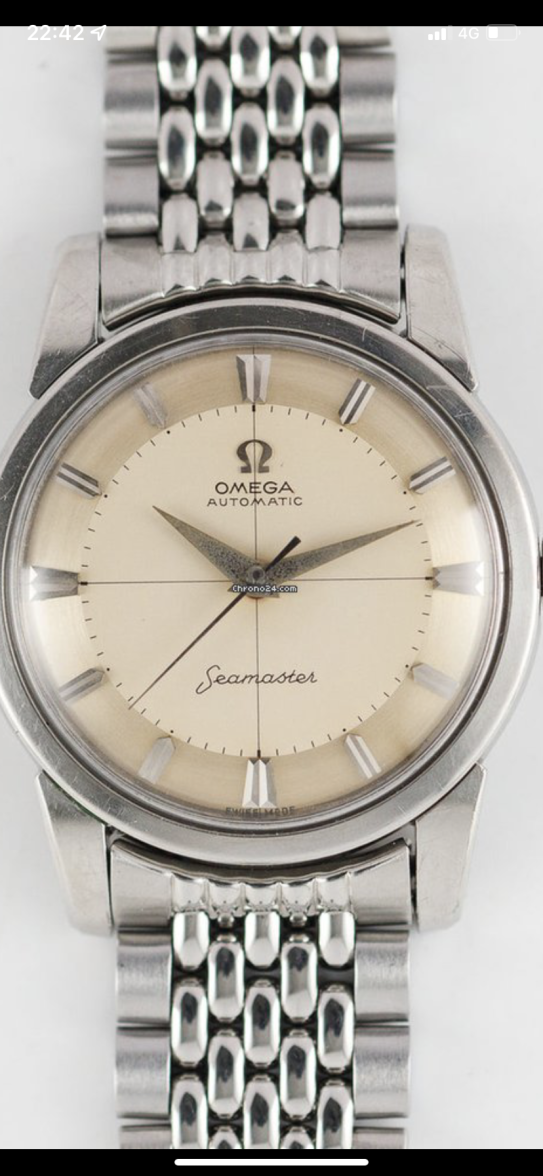

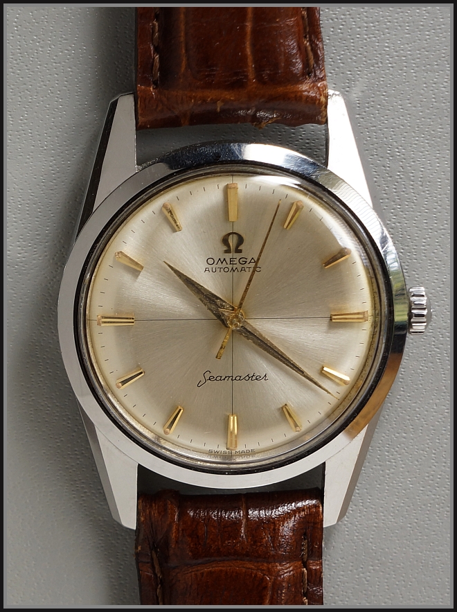

Just wondering what the cause of oxidation on the hands of these watches is - anyone know what the plating is? Especially on examples which clearly have original and very clean dials, but on which the hands have clearly got some spotting.
A few examples below. Two nice 2846s for sale in Japan, taken off Chrono24, and then a pic of a really nice Calendar I’ve just bought (ignore the specs below the Seamaster text, these were specs of dust which were removed as the watch is currently being serviced - and the dial is immaculate).
Is there anything that can be done to restore hands, or is the only ‘fix’ a new set?
Thanks!
Edit - I want to note a couple of things. Firstly in all three cases, where there are silver dial markers, they are not oxidised like the hands. I wonder why?
Secondly I’d like to clarify that if I did get a new set (suggestions please!) I would obviously keep the originals.

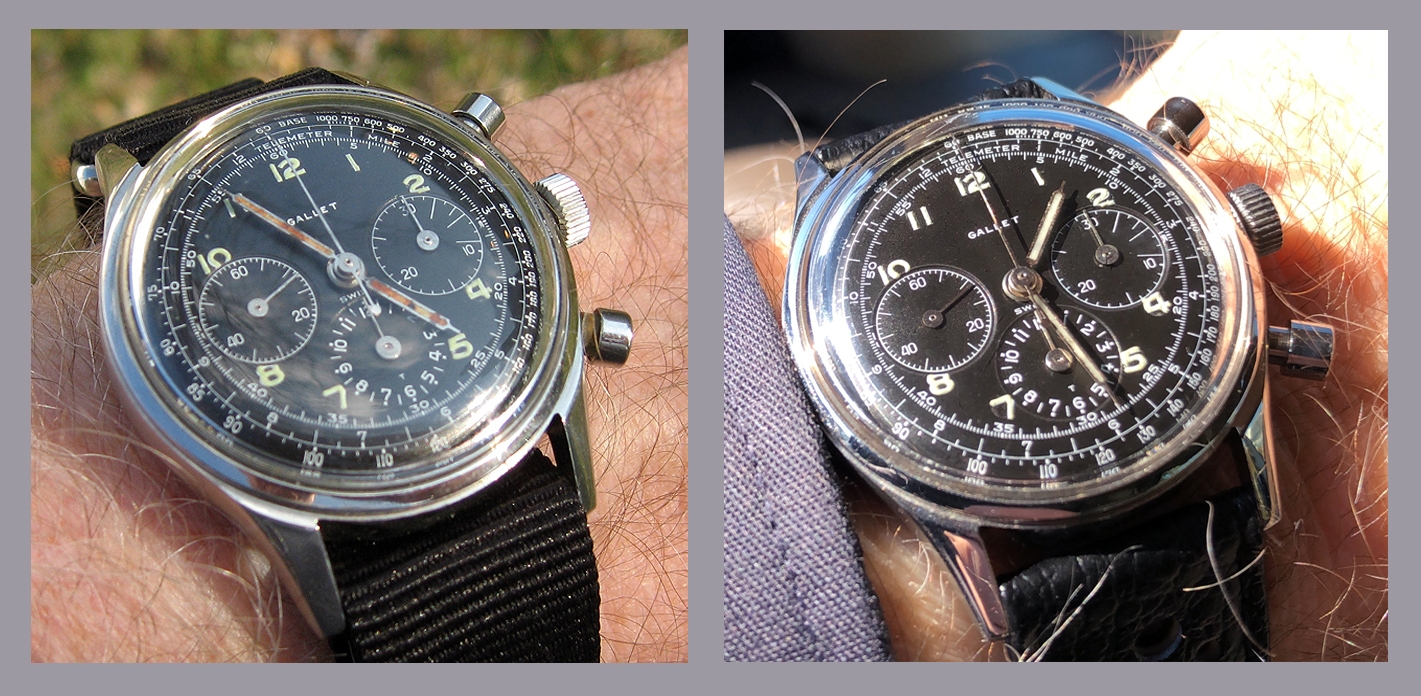

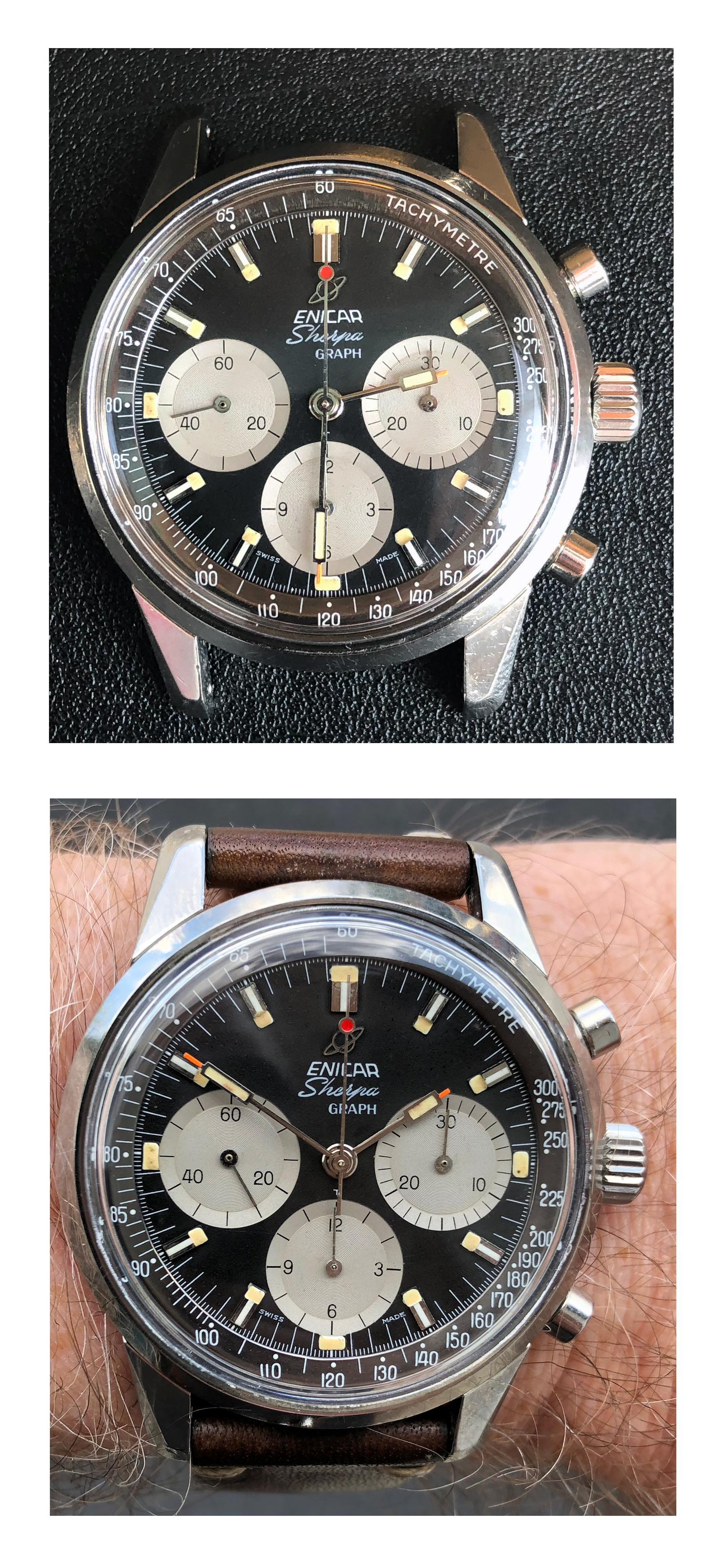

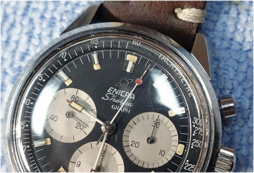

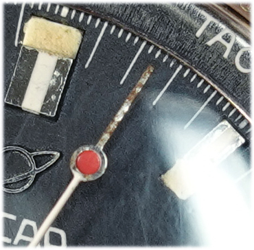

I know of one sure explanation because I have witnessed it happening twice with two watches in my collection.
It's next to impossible to keep non-condensing (and therefore generally invisible) moisture out of a vintage watch.
Under certain conditions, a watch will fog up and when it does so, depending upon the composition of the hands, just one such occasion can cause oxidation on the hands while leaving the dial pristine.
I've trotted out this example a couple of times now:

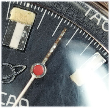

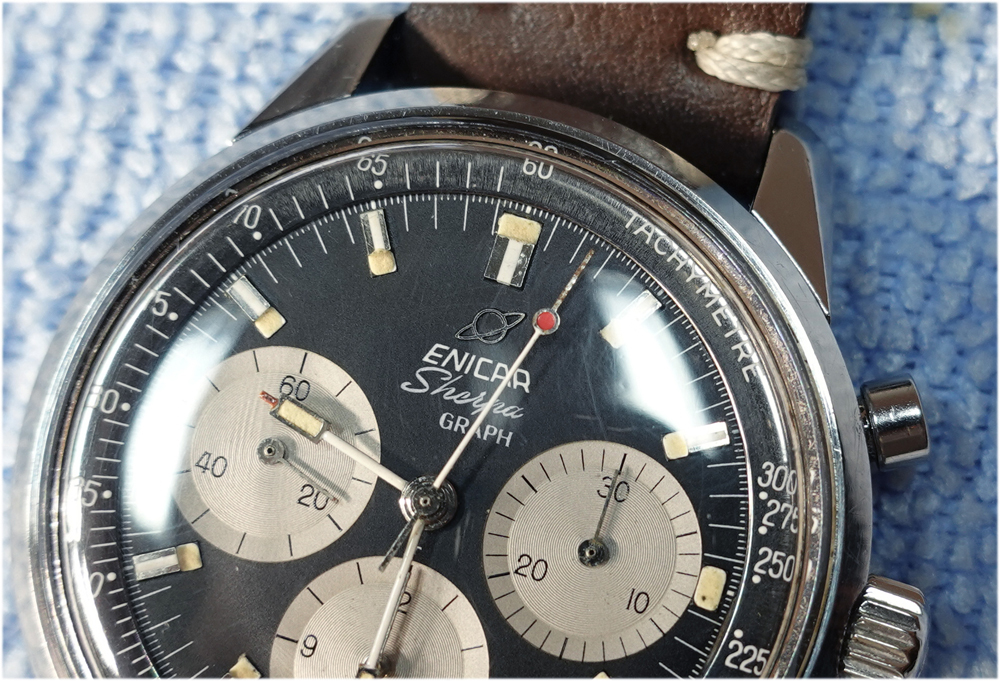

Above is my Sherpa graph as it appeared years ago when I first purchased it. The previous owner apparently had the hands painted white in an attempt to cover the oxidation.
Closeup of central seconds:
Years later I obtained a NOS hand set and here we have a photo of the watch before just one instance of condensation, a week after full service and a hand swap, and just a day after fogging up:
In the upper photo there is no bleed of iron oxide into the luminous material.
After just one instance of condensation, there was enough oxidation to stain the luminous material.
There are many examples of vintage watches where the dial is in excellent condition and the hands are "rusted." It would have been great if the hands of most vintage watches were made of a stainless alloy, but apparently such is not the case.
The photo below shows a watch that I purchased with damaged hands and a great dial. I subsequently had the hands relumed.
Some people would think: "Hey, that must be a replacement dial," but in many cases they'd be incorrect.

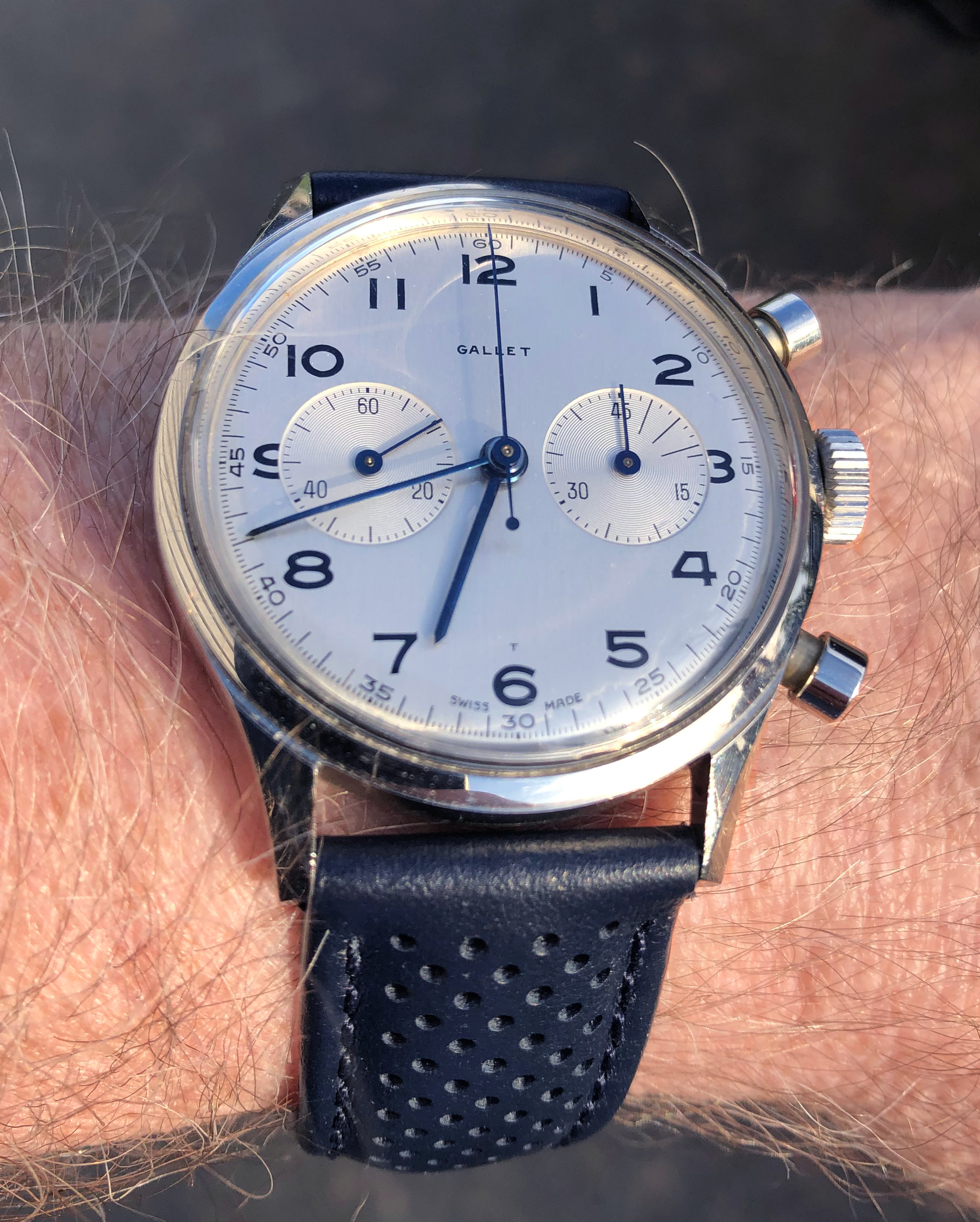

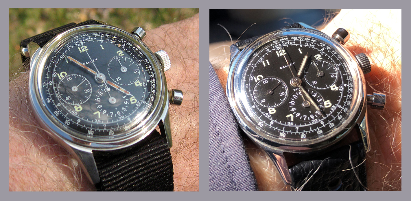

The second watch that fogged up was Gallet MC-45M which had blued hands. Fortunately, there was no damage afterward. Perhaps blued hands are more resistant to oxidation.

I know of one explanation because I have witnessed it happening twice with two watches in my small collection.
It's next to impossible to keep any non-condensing (and therefore generally invisible) moisture out of a vintage watch.
Above is my Sherpa graph as it appeared years ago when I first purchased it. The previous owner apparently had the hands painted white so as to cover the oxidation somewhat.
Years later I obtained an NOS hand set and here we have it before just one instance of condensation a week after full service and just a day after fogging up:
There are many example of vintage watches where the dial is in excellent condition and the hands are "rusted." It would have been great of the hands of mist vintage watches were made of a stainless alloy, but apparently such is not the case.
Thanks for a well informed and detailed reply! I’m struck by how quickly oxidation shows up on even NOS hands. I guess due to the age of the lume, the surface isn’t as well sealed and that would potentially allow for the quick ingress of any moisture.

Here is what happened in my case . . .
I was having a house rebuilt with an extension put on. The contractors working inside had the Central air cranked up so that the place was a bit like a refrigerator. The day itself was a hot and humid summer day. I went from my AC car to the great outdoors, then into the house and back out again.
That was with the Sherpa Graph. I did not see the watch completely fogged up until I stepped outside.
A week later, I repeated the process while wearing this watch:
Fortunately, no damage.
I will not be building any additional homes and I will not be going in an out of places with huge temperature and humidity changes in future if I can prevent doing so. 😎

Re the hands. When I sent a similar example off for service a while ago and asked if the hands could be polished, I was advised many 60’s Omega hands are plated, not solid steel and so cannot really be polished to clean them up.
No idea if this is true as I always assumed solid stainless (unless gold plate etc) but this is what I was told.
498
410
Interesting. What would hands on a SS watch be plated with?
