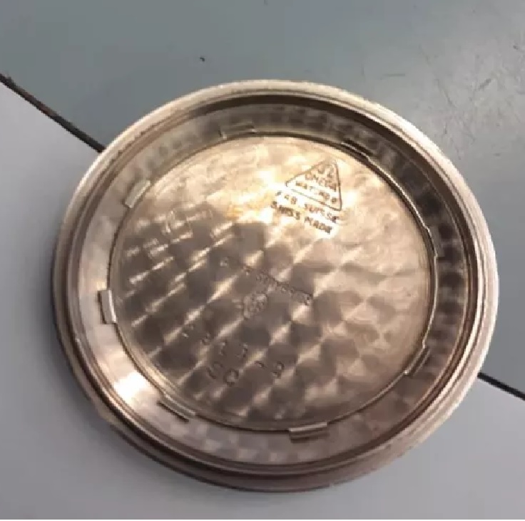

Some observations for your sale: You missed the best time ( Christmas auctions ) for big Auction houses . Private sales do not get you the best prices in the moment
; The Economic outlook is too uncertain. You need an Omega factory certificate of Originality( movement number check ) , which takes time. If the movement is original and unmolested, it should have some oxydation on the copper/ red movement plating. And maybe the biggest problem could be the blank caseback. Ref. 2914-2 would be engraved. My guess is, that it is an factory replacement back, stamped on the inside and not yet engraved . I have a similar one for the Omega military 1953, who will fit your case , Btw..... Which would reduce the possible value quite a bit. And forget that "box and tag".... Has absolutely nothing to do with the watch. These questions should be addressed, if you look to maximise your value. Good luck !

Movement serial number indicates about 1957- which is right for a 2914 Railmaster. Yje bracelet is a correct 7077 (valuable) with endlinks n.6 (very valuable). Keep it until next summer and then give it to one of the big international action houses. In the while get it serviced by an independent, asking to have some fixative on the back of the hands (old luminous tents to brittle away) - and DO NOT touch the dial. Case only gets an ultrasonic bath. Get an Omega extract, get the bracelet serviced by a specialist. Throw away the box. Great find.
Could you take an on-focus image f the inside back?
But it is engraved isn't it?

OP: " ...the case in the back is completely bare....." ......
Think this was about the outside
5,729
9,515
Sure ; outside case back. 2914-2 has the Railmaster engraving. Which this example has not, if the OP is correct.
Actually, Ref 2914-2 Railmaster was produced both with, and without, the outer Railmaster engraving.
Oh really?! That鈥檚 a relief! Everyone鈥檚 knowledge on this forum is very impressive!

Your 2914-2 Railmaster is a very impressive example. Circa 1957-58. Appears to have the original 7077 bracelet and the first generation, single notch, end links. Is there a date on the bracelet? A pic of the crown as well? Quite a find. Congrats.
Really? 2914-1 , I've seen. 2914-2 : I know only with engraving . Something new every day.....
