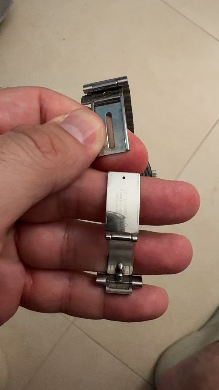

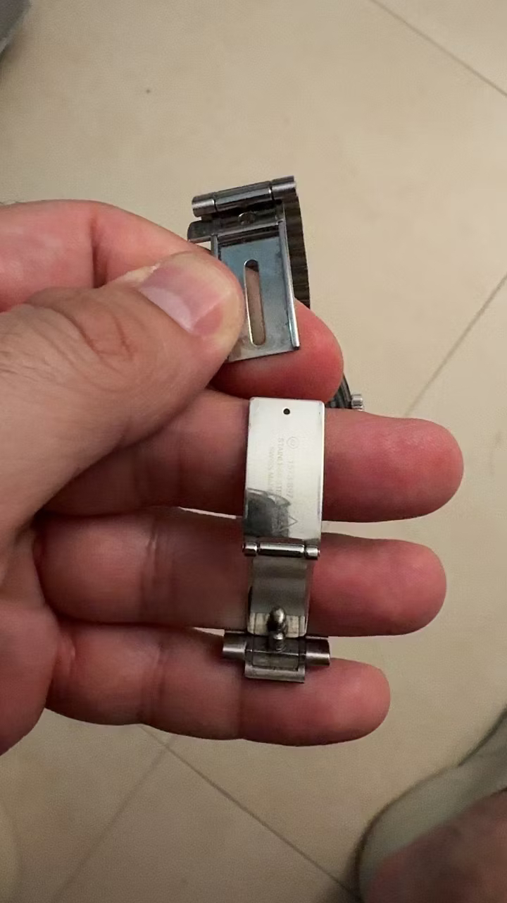

Hello everyone from Singapore,
I lost small steel pin in the bracelet. Watchman here could not repair it. Is it an easy piece to find or shall I get the full strap?

That should be an SCREW, not an “pin”. Anyone who has an assortment of replacement stainless steel case back screws would have a screw that would serve the purpose. Possibly would be necessary to shorten the screw a bit. These screws regularly go missing during slap-dash sloppy battery replacement jobs. Replace the buckle is an option, but not the best choice. Check a few watchmakers. Battery change counters in big box stores or most retail jewellers won’t be able to help you.
Thank you both! I will order one from the shops you mentioned… definitely better than paying for full strap…
