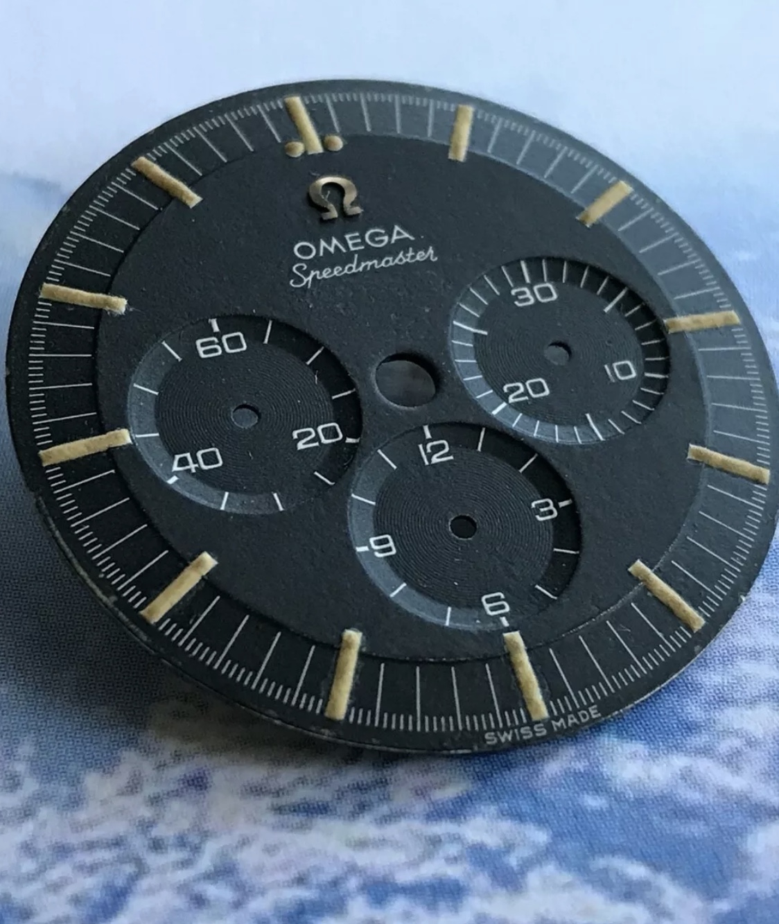

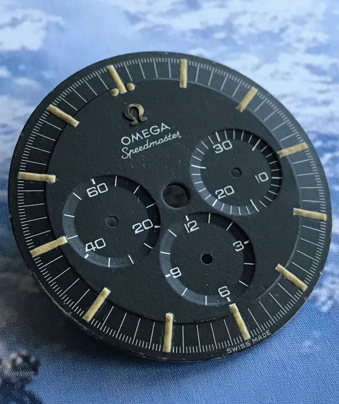

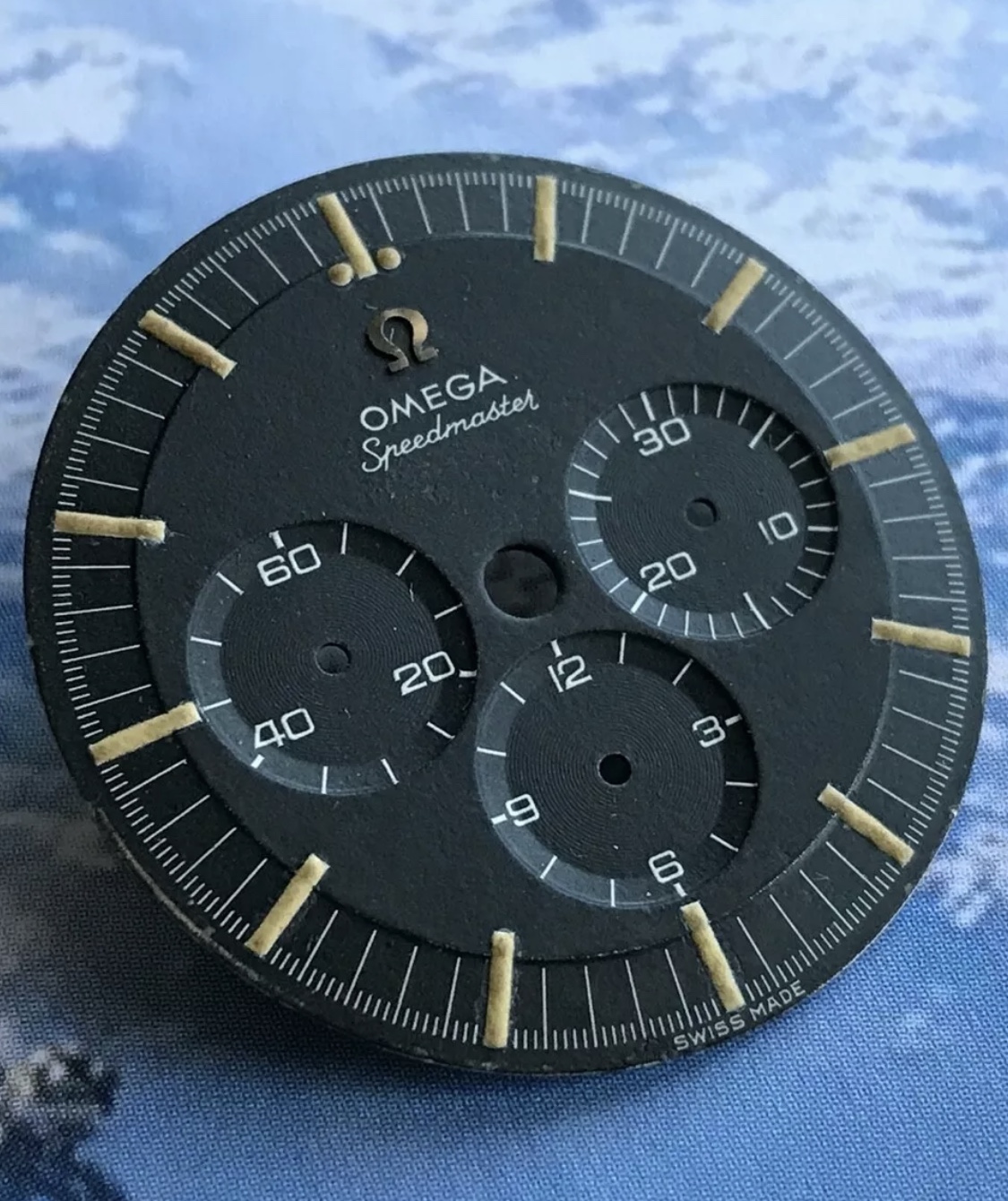

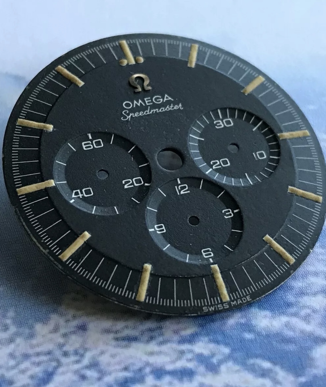

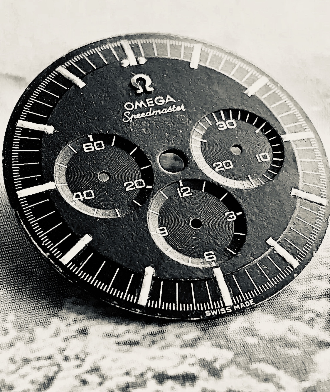

Hello OF,
Been staring at this dial for a awhile and wanted to share with you to get some extra eyes on it. It does feel like a relume too me. Main reason, I’m use to clearly seeing a step in the lume plot through the tritium. These feel a bit puffy. But I’ve also heard that this is sometimes accepted for trit dials as well.
Let me know your thoughts

From the even shade, texture and 'vanish' looking stains around the plots, I'd say relume.

There are a few other things I would be looking at before the lume... 😉

What is the reaction to UV light? and what does the dosimeter say?

Not relevant in this particular case... 😗

It’s derived from a 105.002? or 003?

Ah I see, it's probably a Service dial. Didn't even look for the Swiss Made.

Besides this dial has been manipulated (I think removed "PROFESSIONAL" and "T"s) and relumed, the diameter of the minute track isn't matching, it is too large.

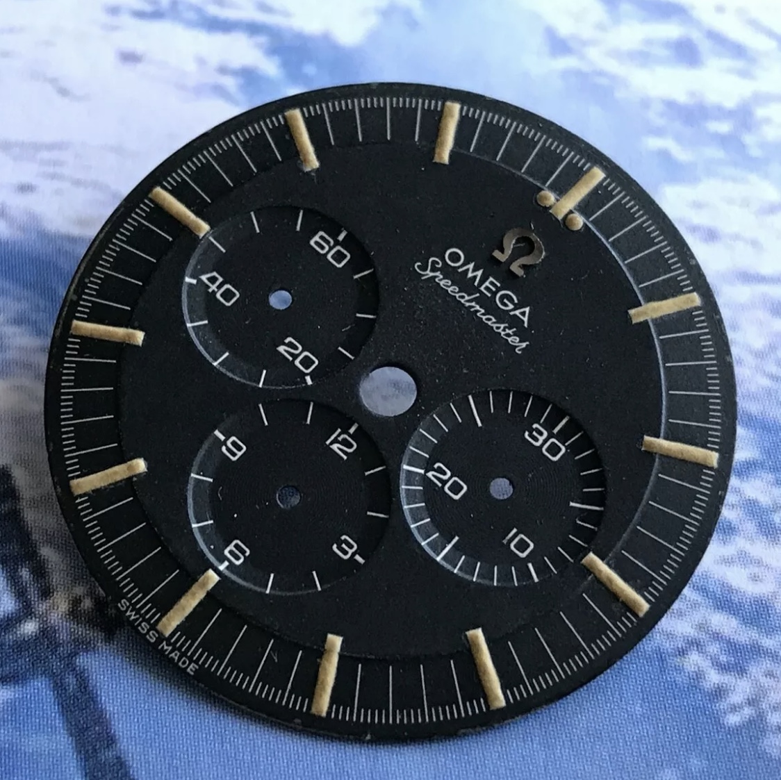

This one is a correct 2998 dial:

Minute markers don’t quite reach the step so not a 2998 dial. I believe there are 105.002 dials like this though as I’ve seen a few but haven’t seen any discussion on that point, also I can’t see any sign of removed T’s although they could still be there on closer inspection. The clear marks around the lume plots do suggest a relume.

I checked the font and position of the "SWISS MADE" and the font of "Speedmaster" to see it was most likely a tritium Professional dial.

I stand corrected, have a look at the E on OMEGA. It’s short, so should suggest to be from a 145.012? But no clear signs of covered T’s or Professional to what i can see. But the letter E is a tell tale to me now when having a closer look. What does the jury think?

You’re right. Also light marks on the dial where the ‘Professional’ has likely been removed.

Yes I think you’re correct 145.012

This dial obviously started its life as a wide T 145.012 dial that had the T’s and PROFESSIONAL removed. Badly.
It’s also relumed. (But as I stated above, at this point not important anymore...).

Very educational thread. When I first looked at the dial I noticed the strange texture of the paint under "Speedmaster", which made me suspicious, but I wouldn't have picked up on the "E". 👍
