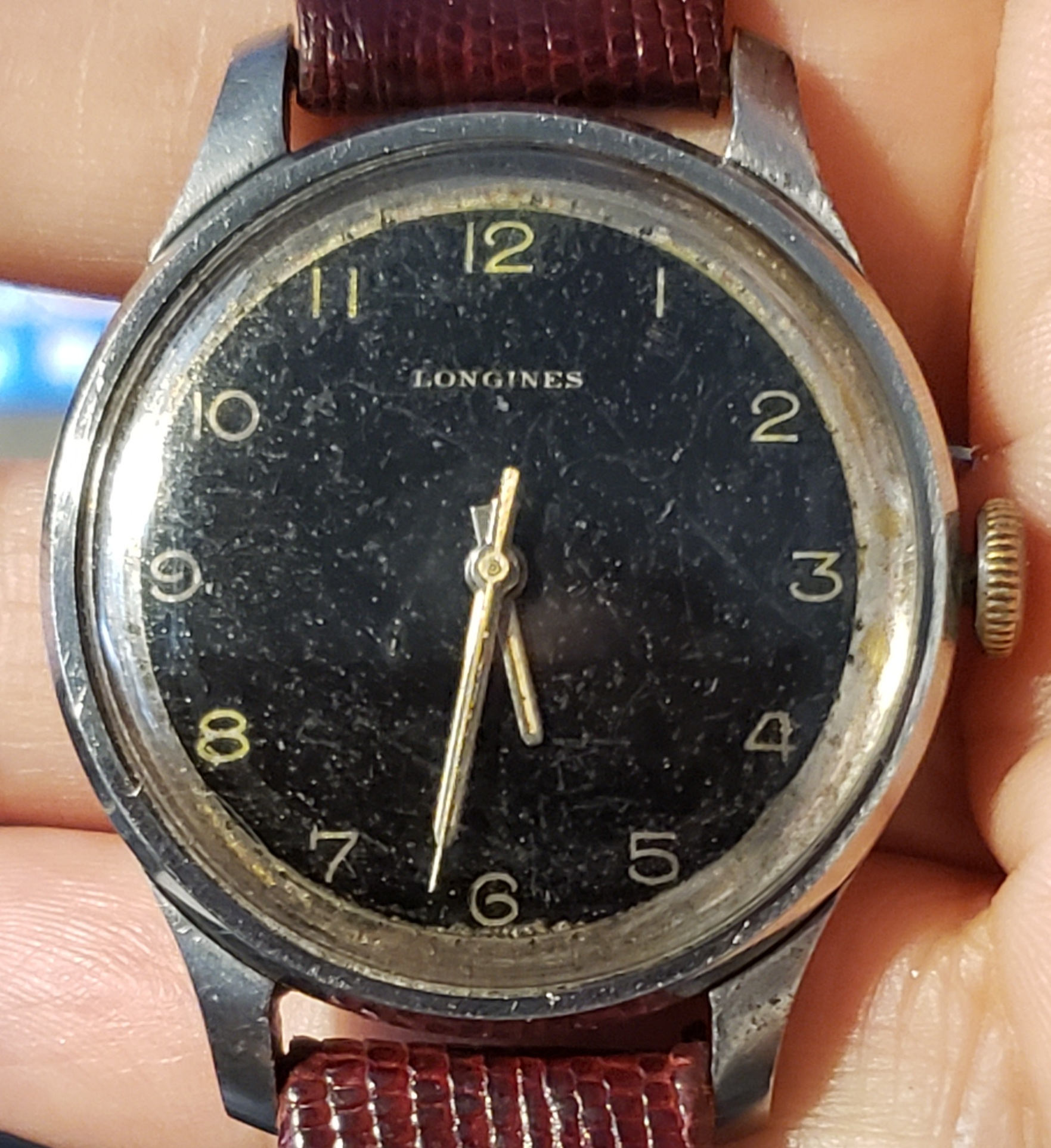

My opinion, below black dial doesn't look like it matches the style or design of other watches.
Also, typically there is no SWISS or SWISS MADE on these calatrava dials like the below has. It maybe
an incorrect dial.
Possibly was original dial (removed from a smaller donor watch in the past?), but clearly has been altered. Hands are incorrect.
The black dial is a bit of a unicorn. Very hard to find. The below ref 4528 with a 37.5mm case and 12.68N may give an indication of what a black dial should resemble since it is very similar to the white and copper dials with correctly identified references.
