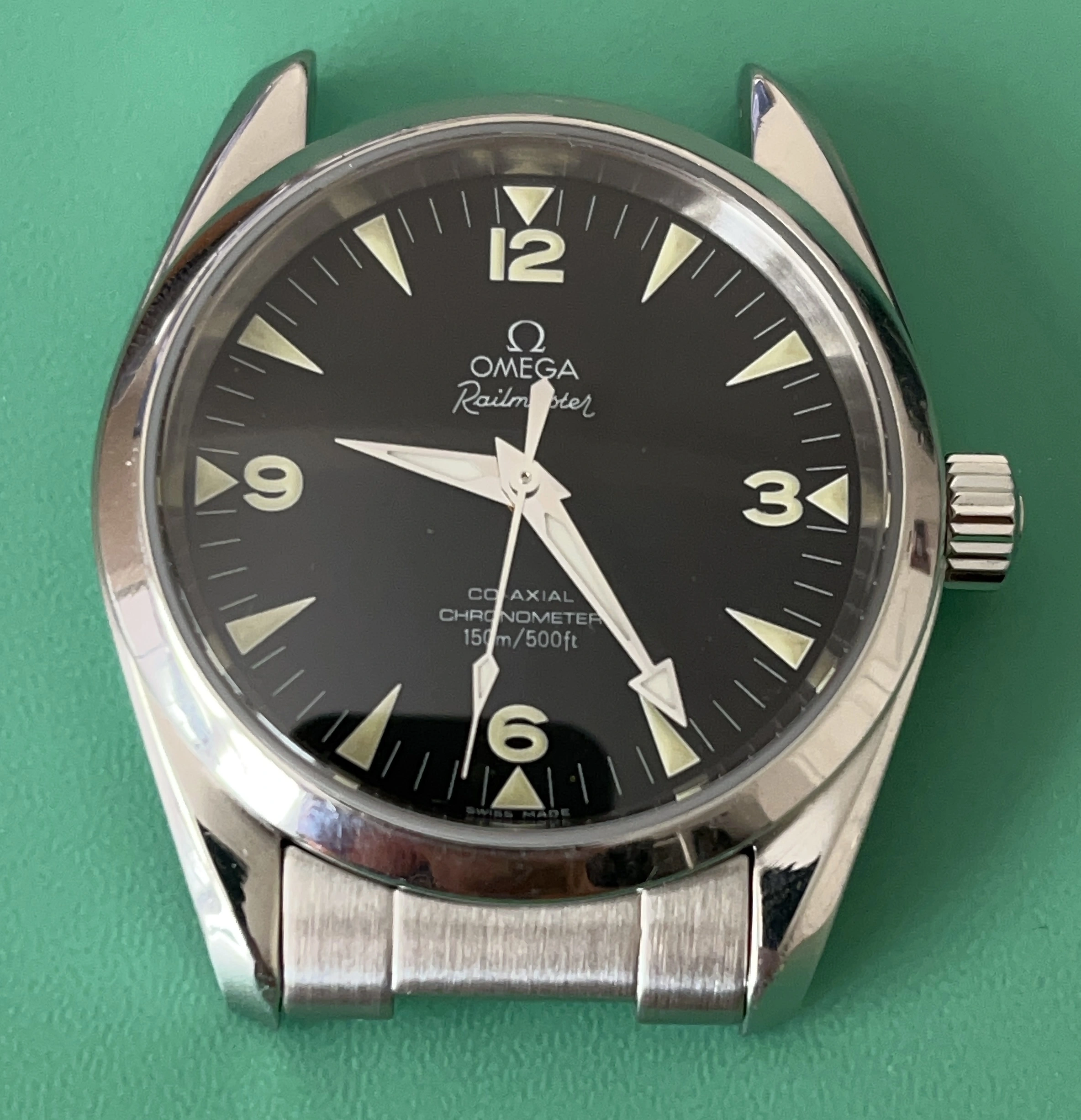

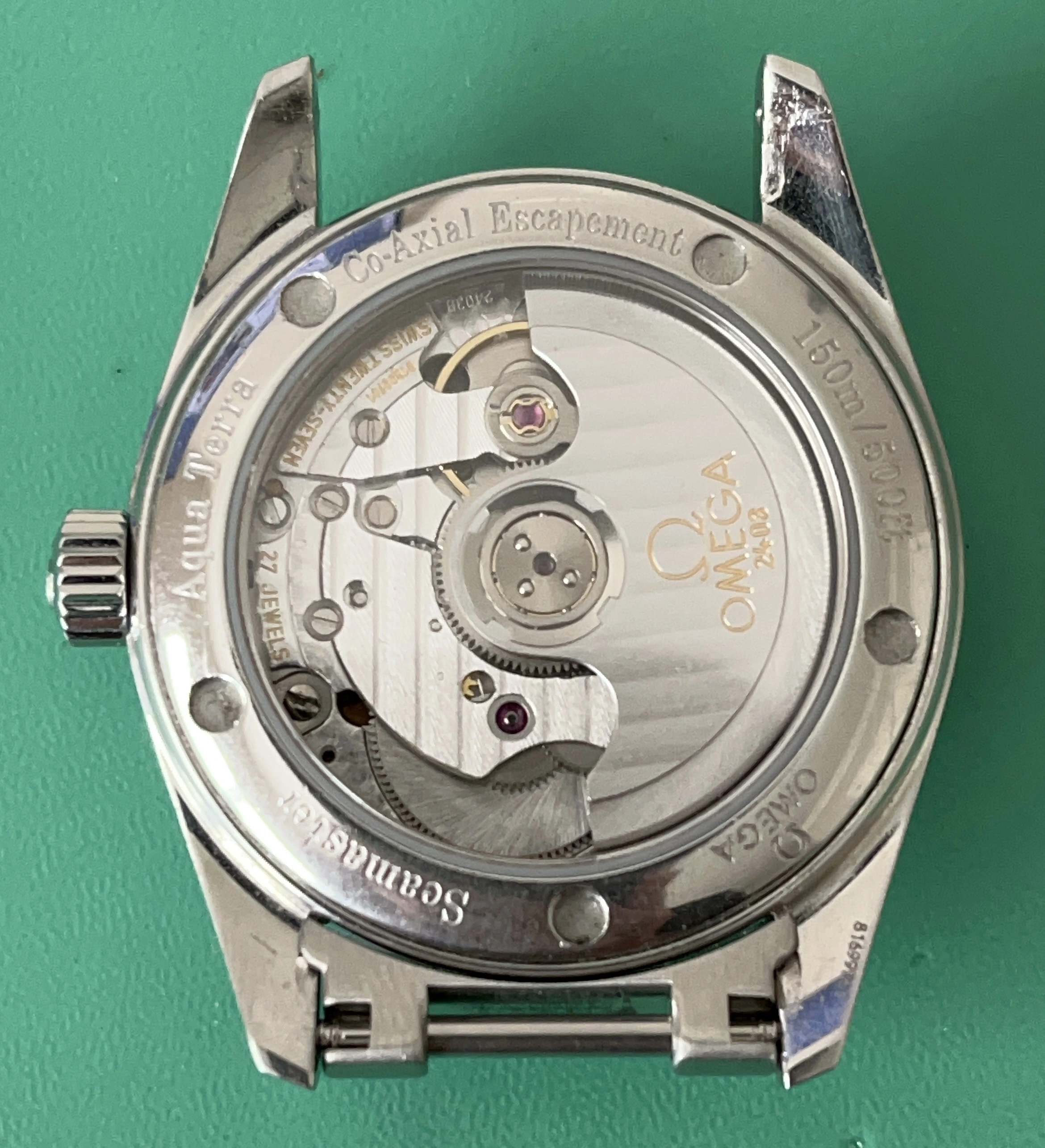

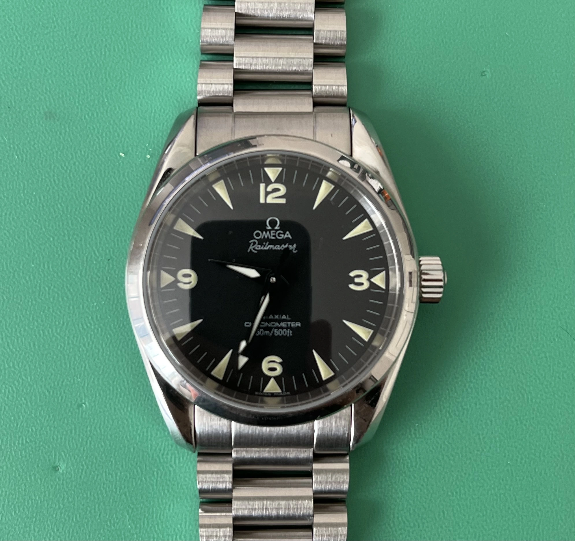

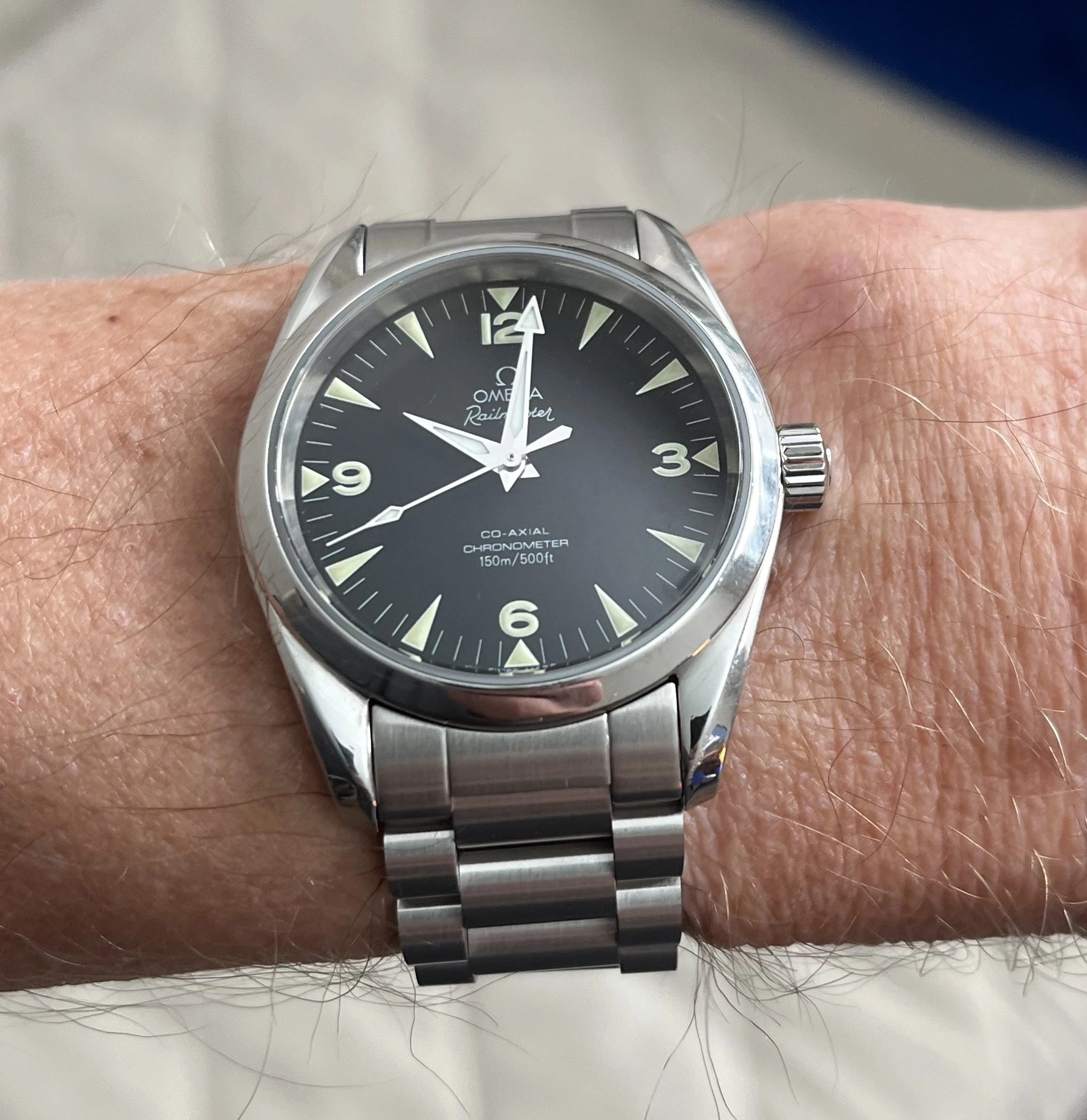

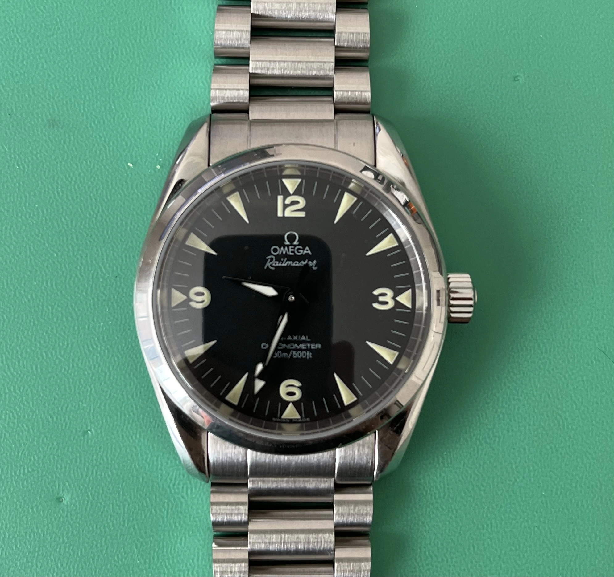

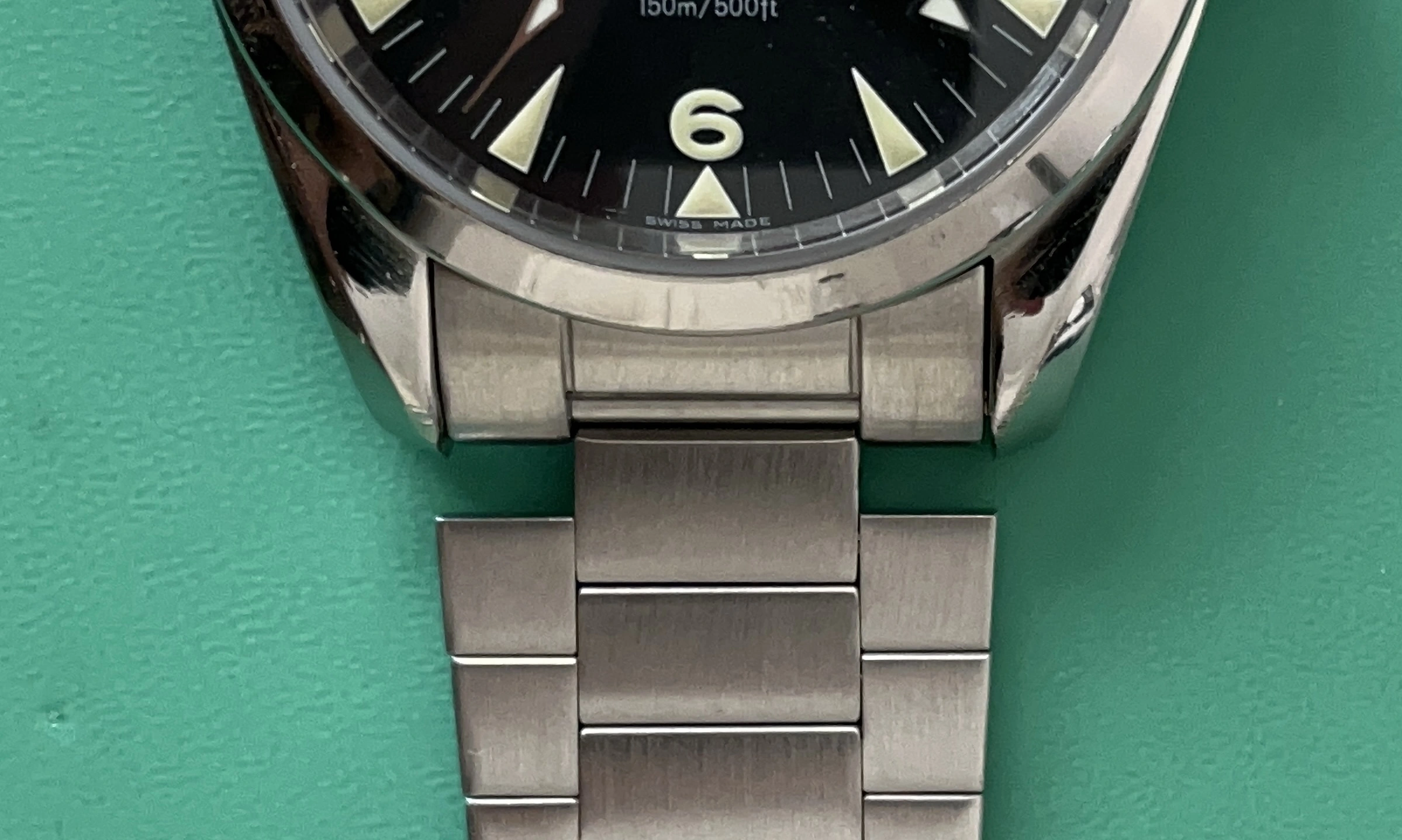

I think this question has come up a few times—if not here then on other forums—so perhaps it might be worth documenting my experience.
TLDR: Uncle Straps bracelets for the Speedmaster FOIS work well; Forstner bracelets for the FOIS do not work.

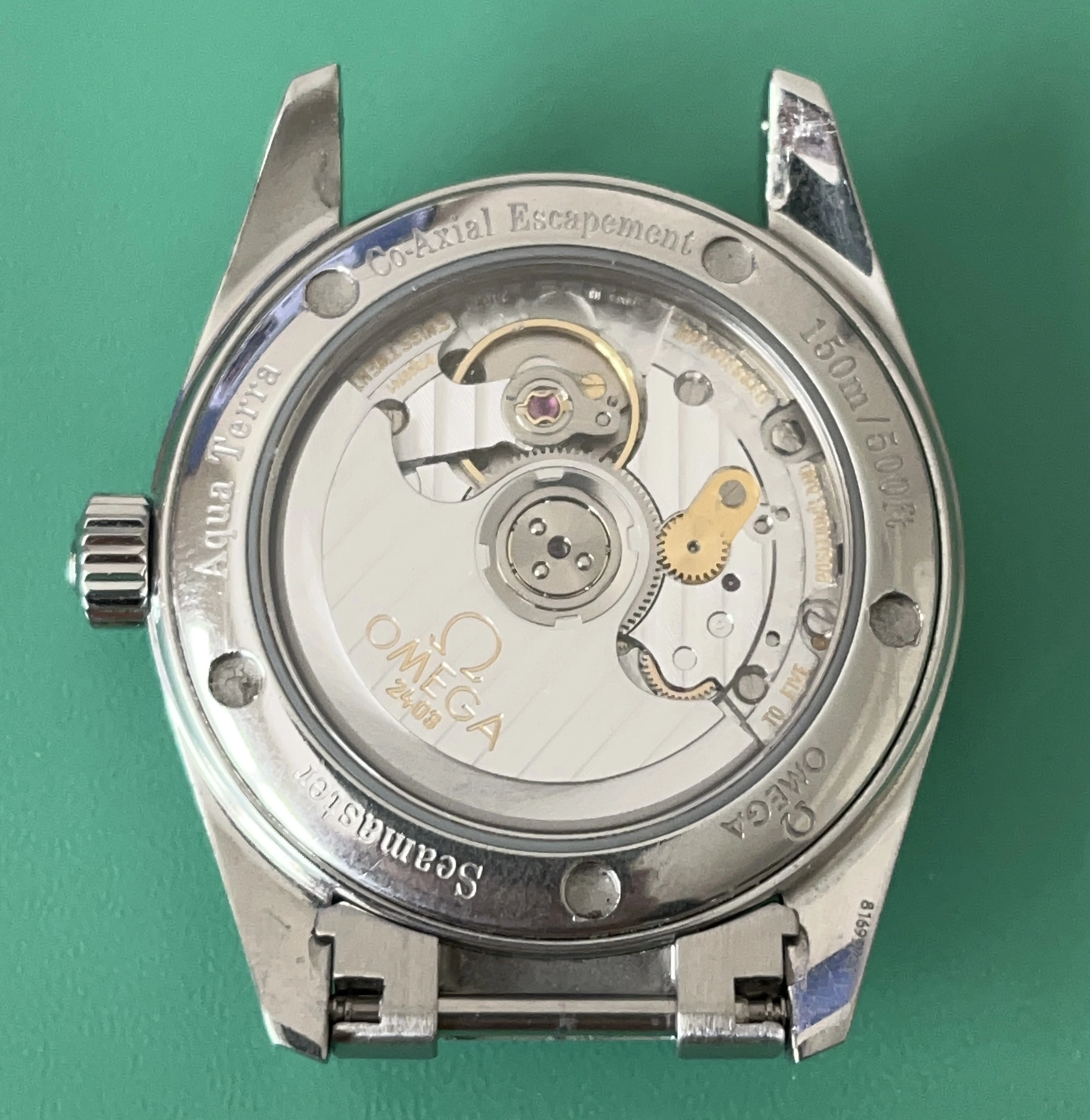

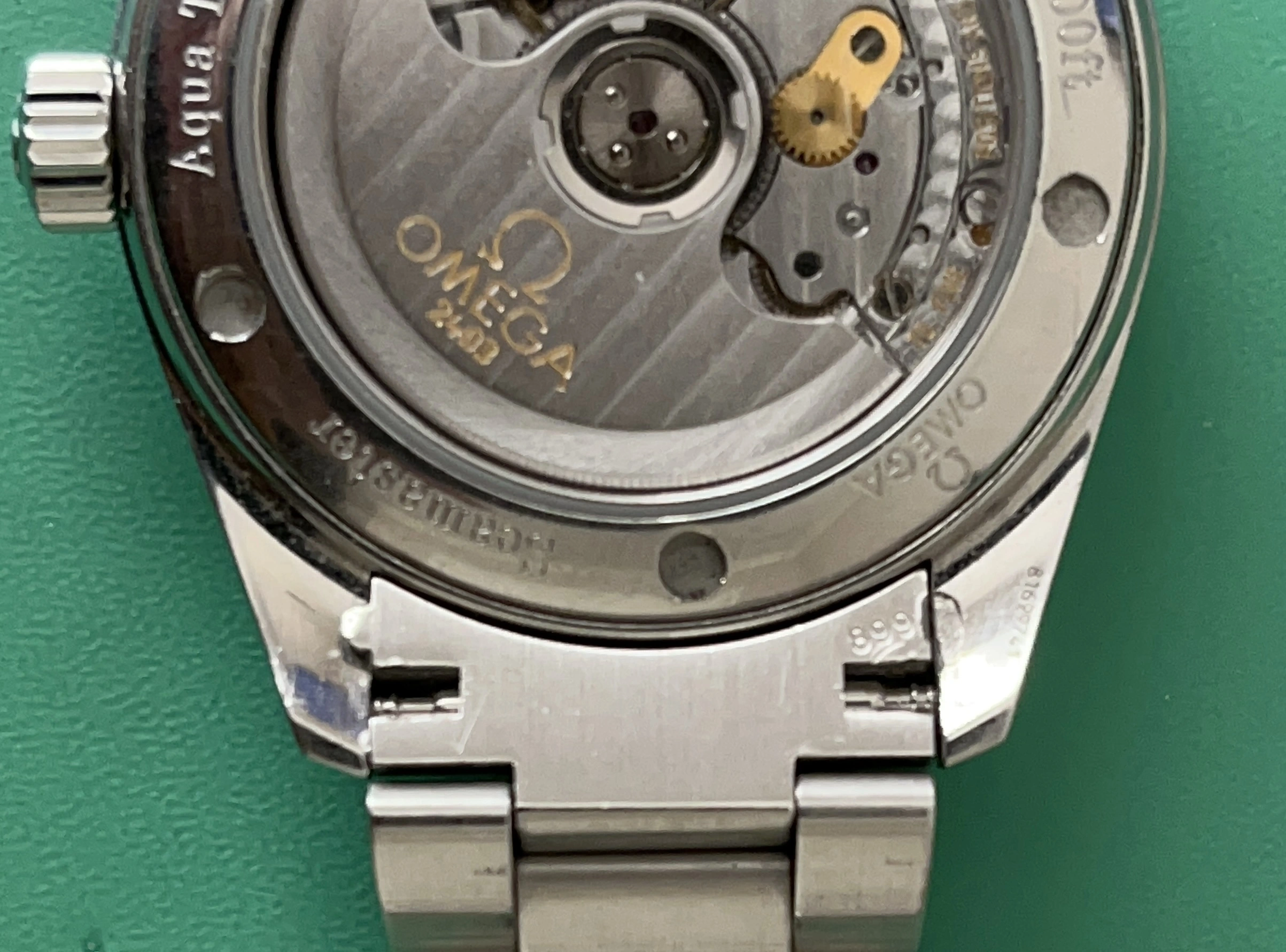

As a baseline, here is the OEM Omega bracelet:

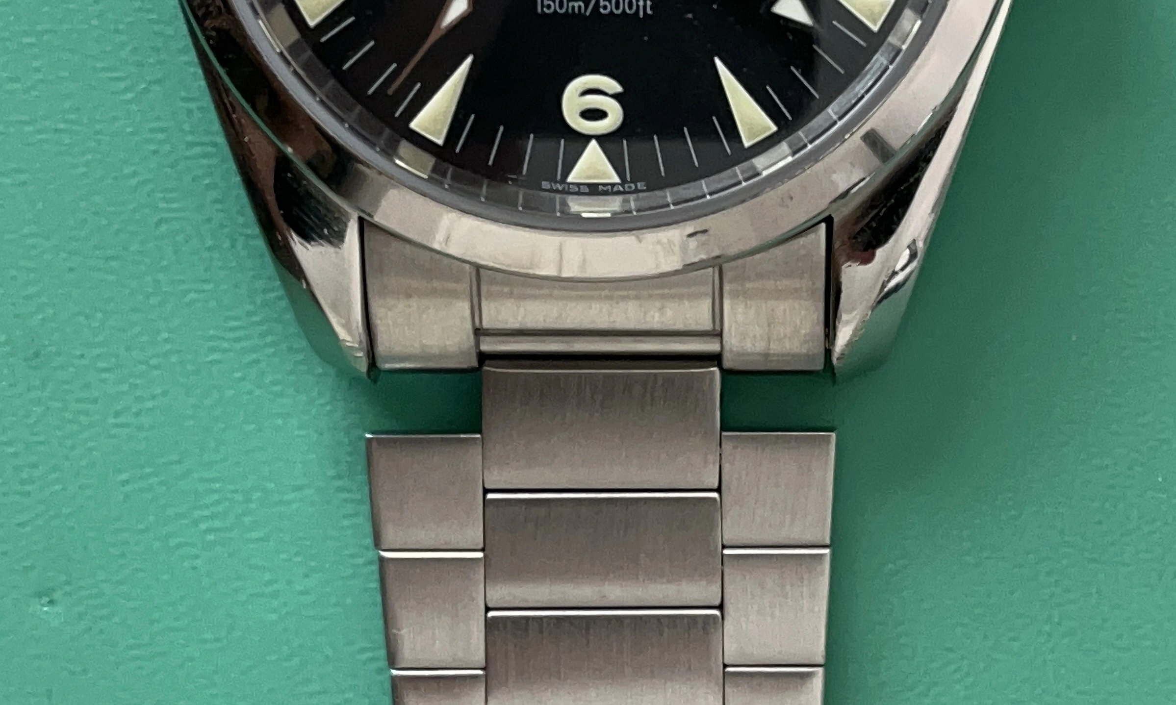

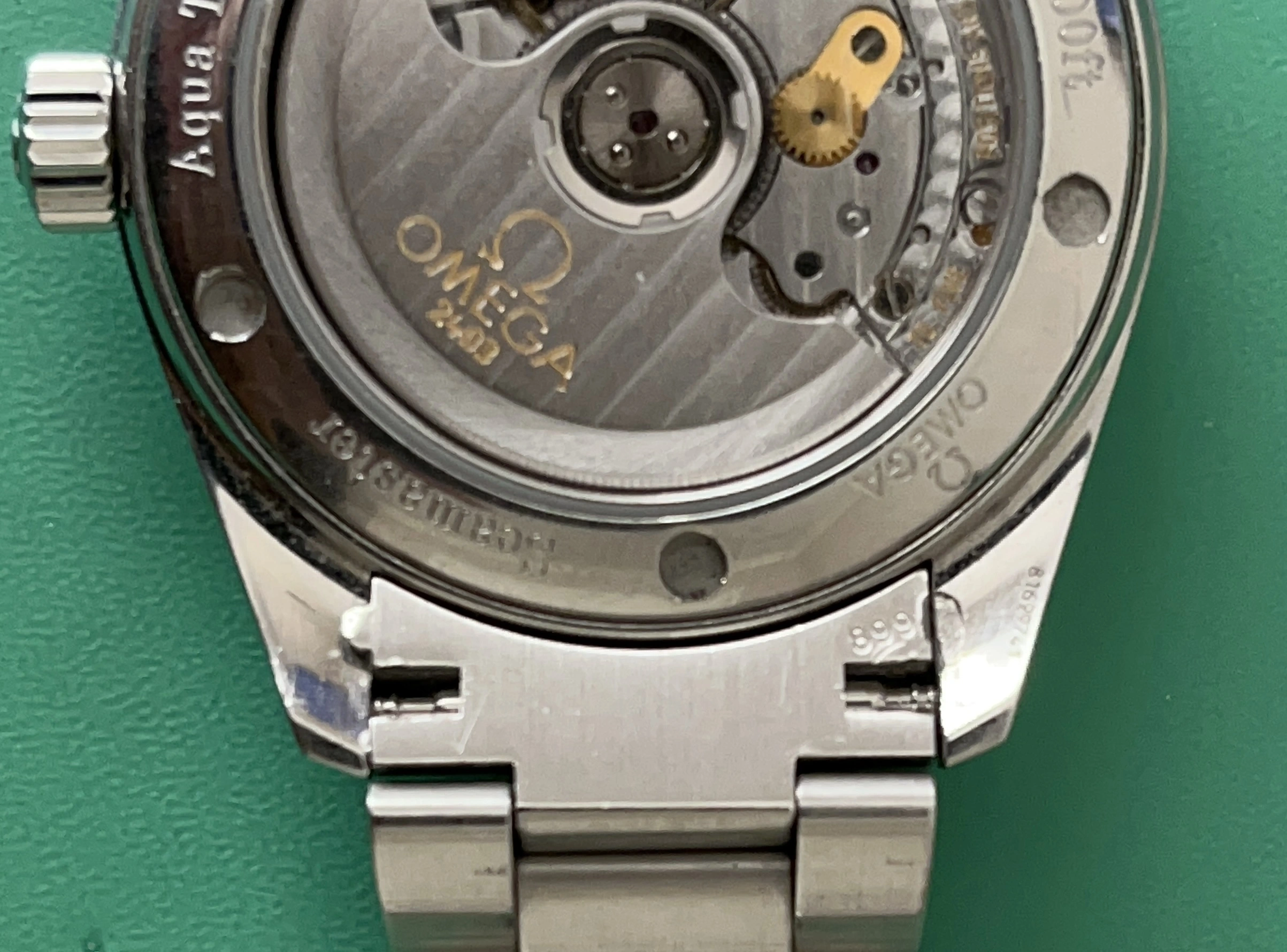

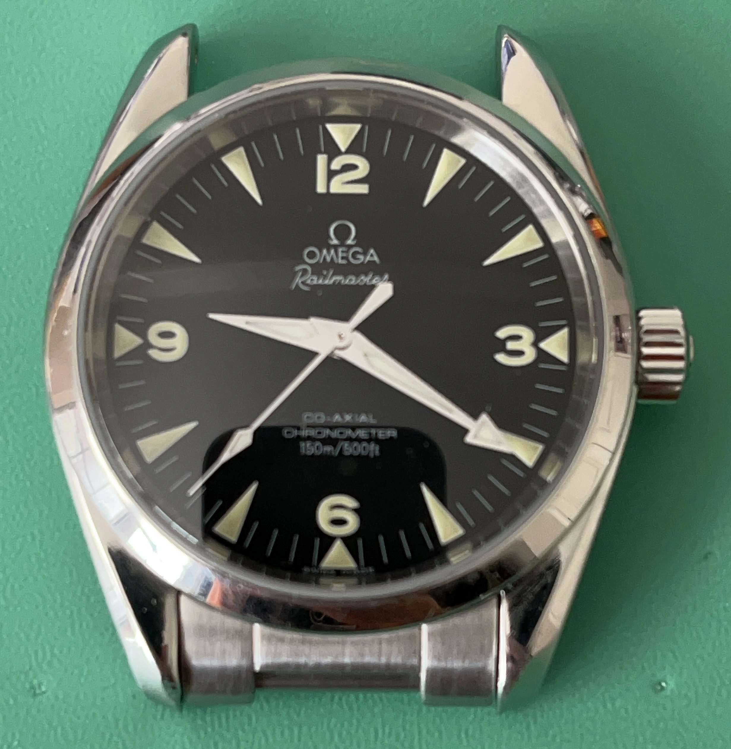

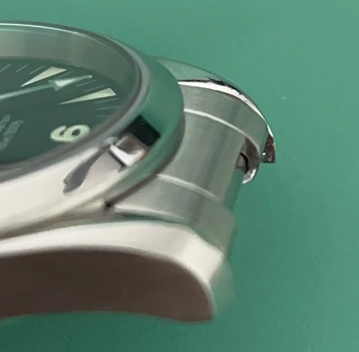

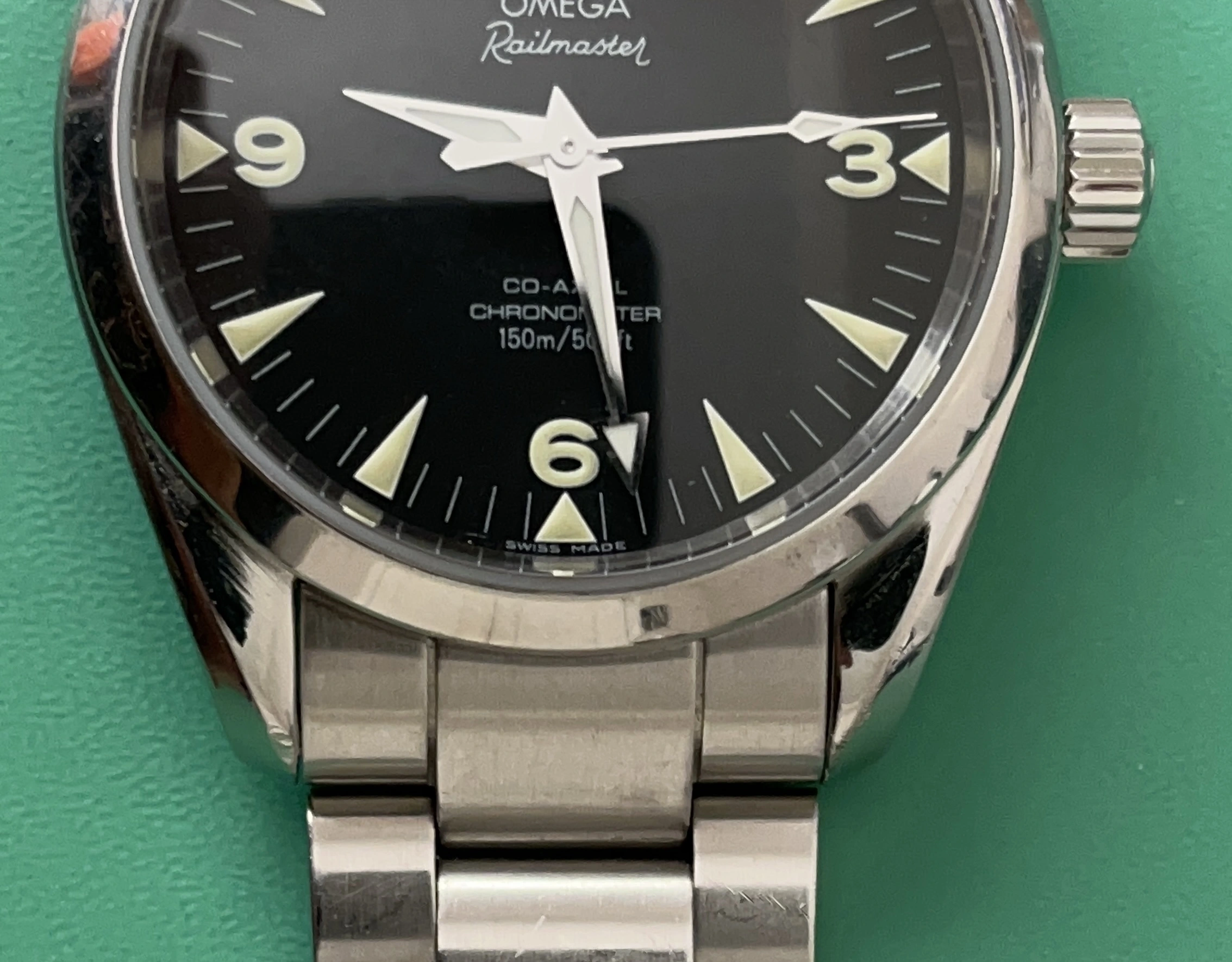

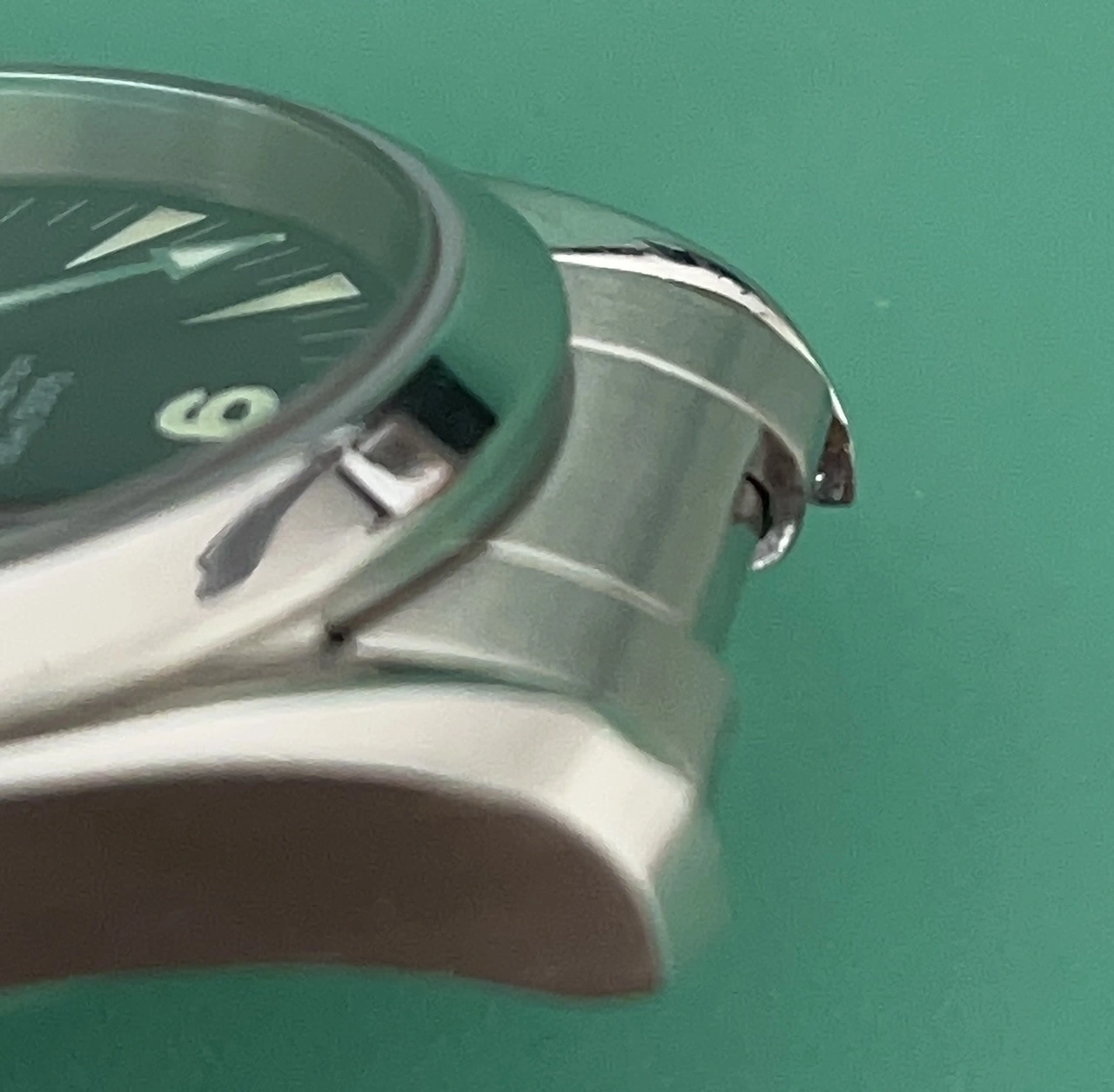

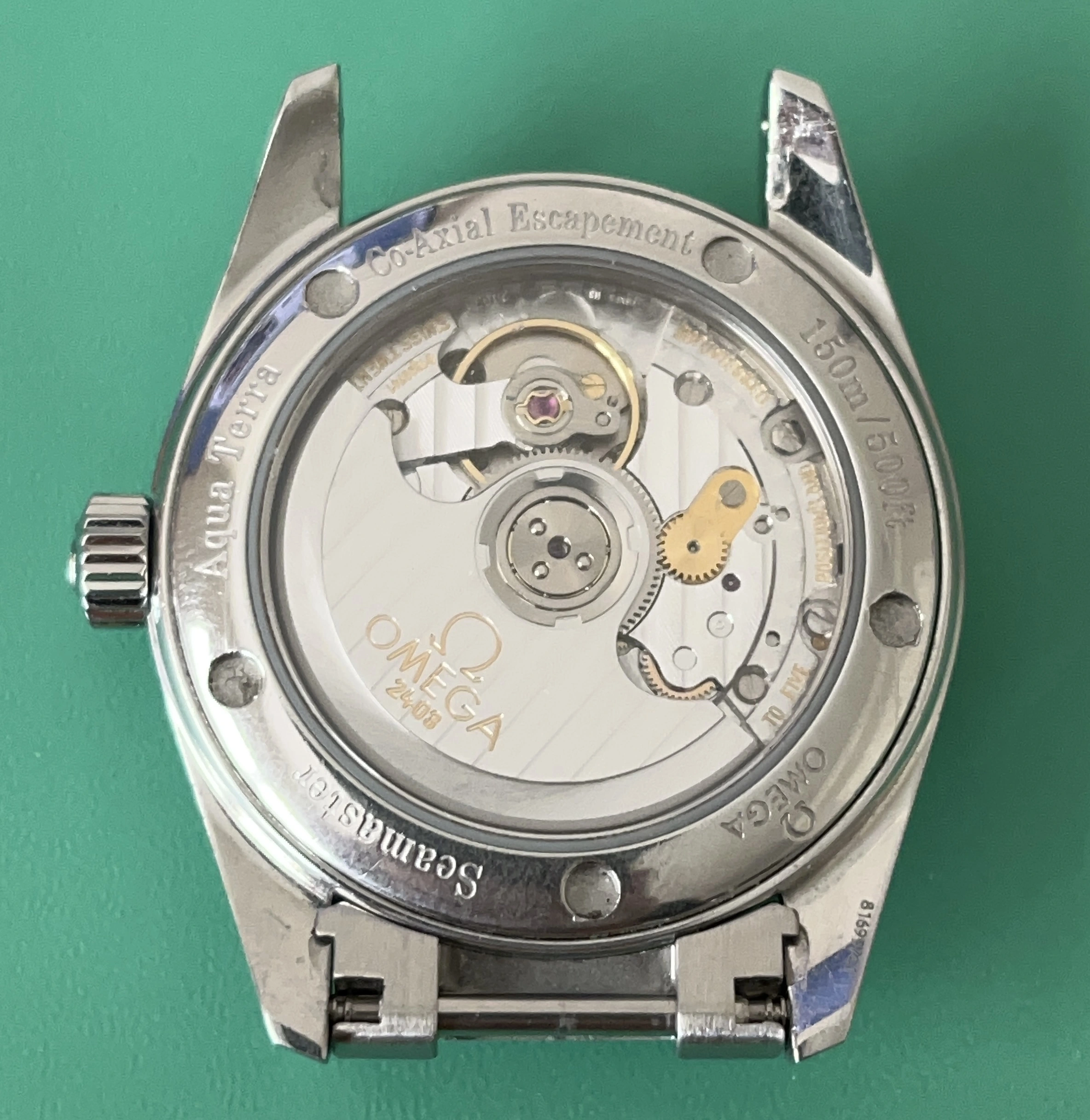

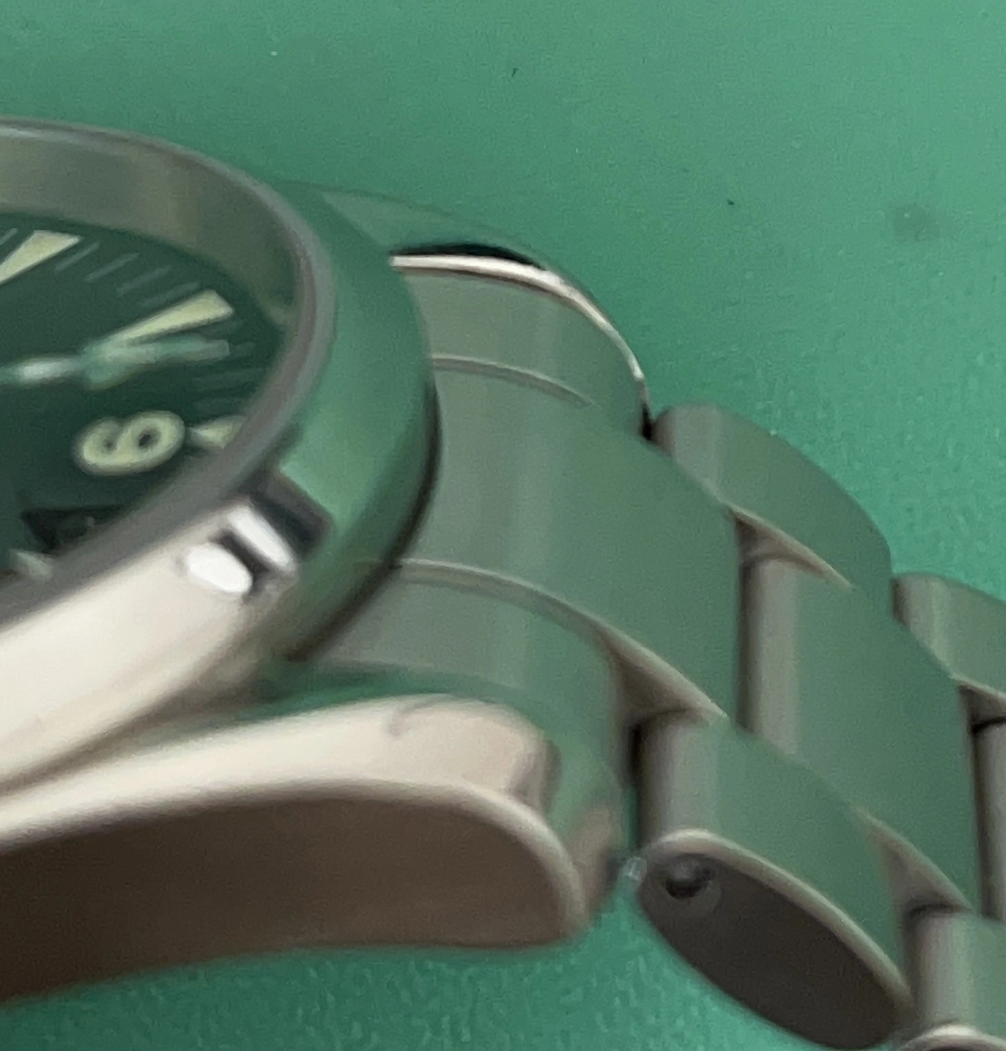

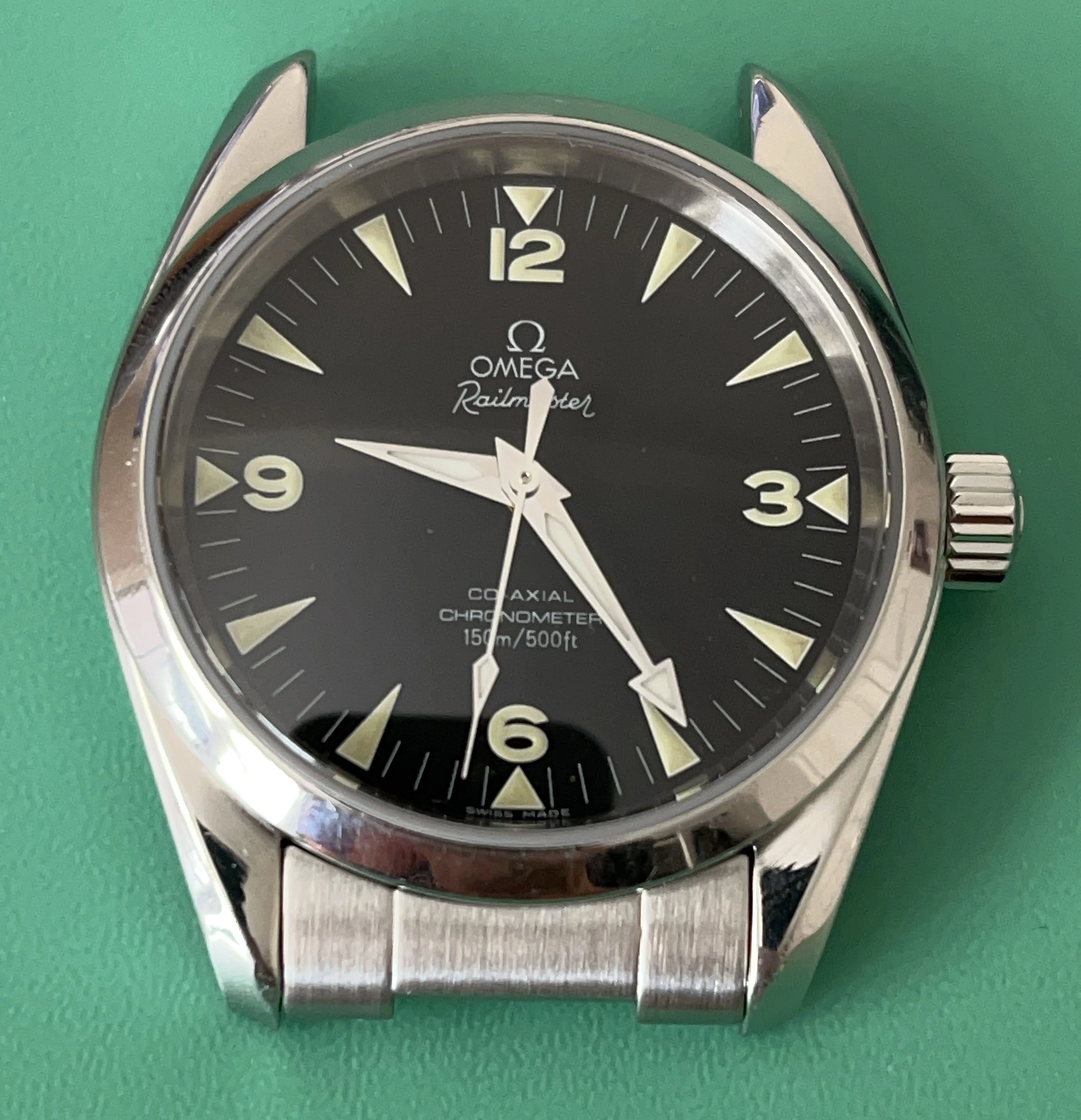

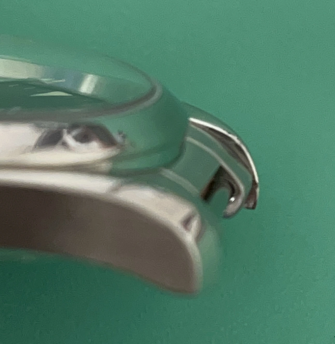

The Forstner end links (in this case for the Flat Link Bracelet, do fit within the lugs without a gap, though their curvature isn't a great match for the Railmaster's lugs.

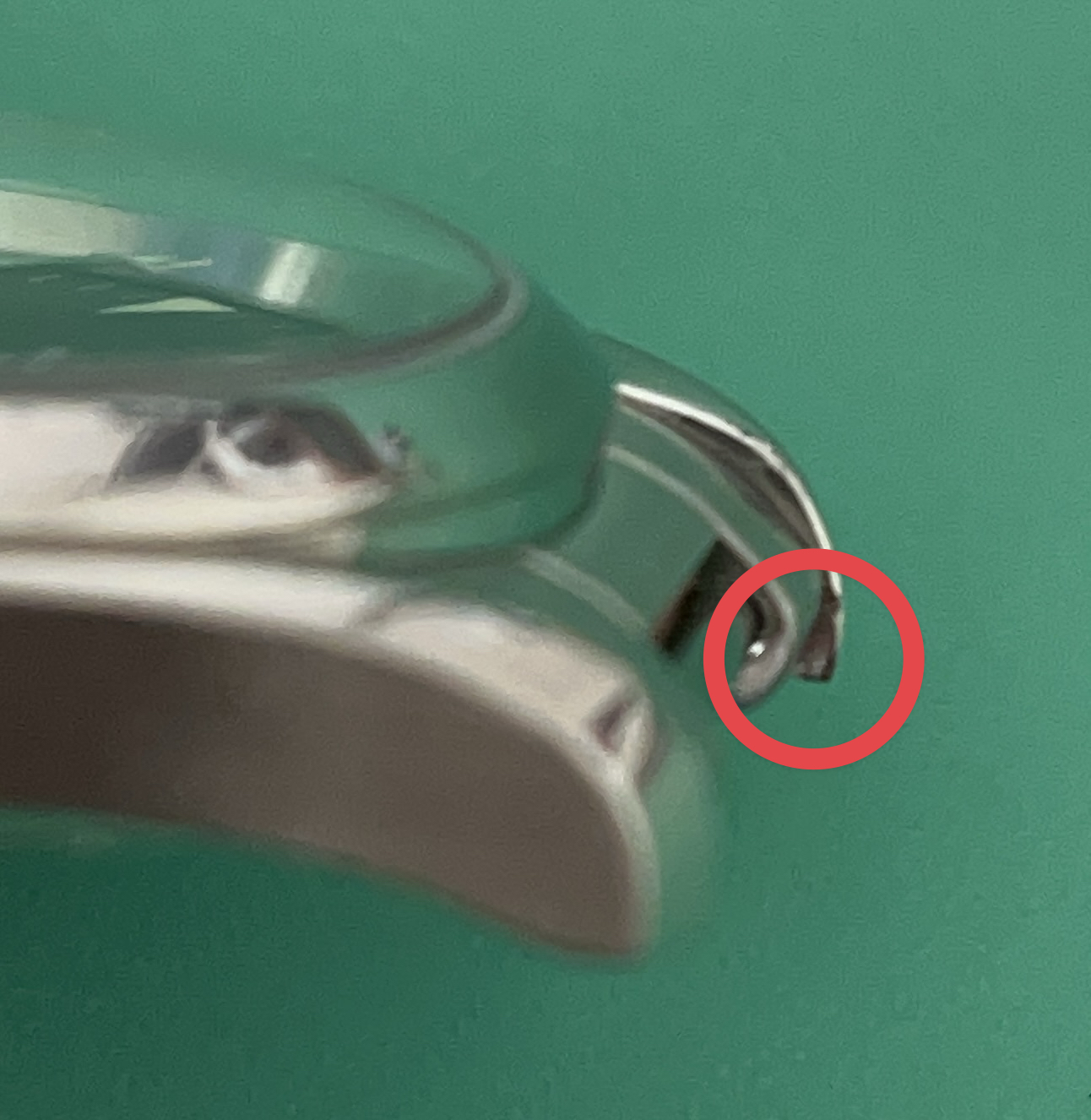

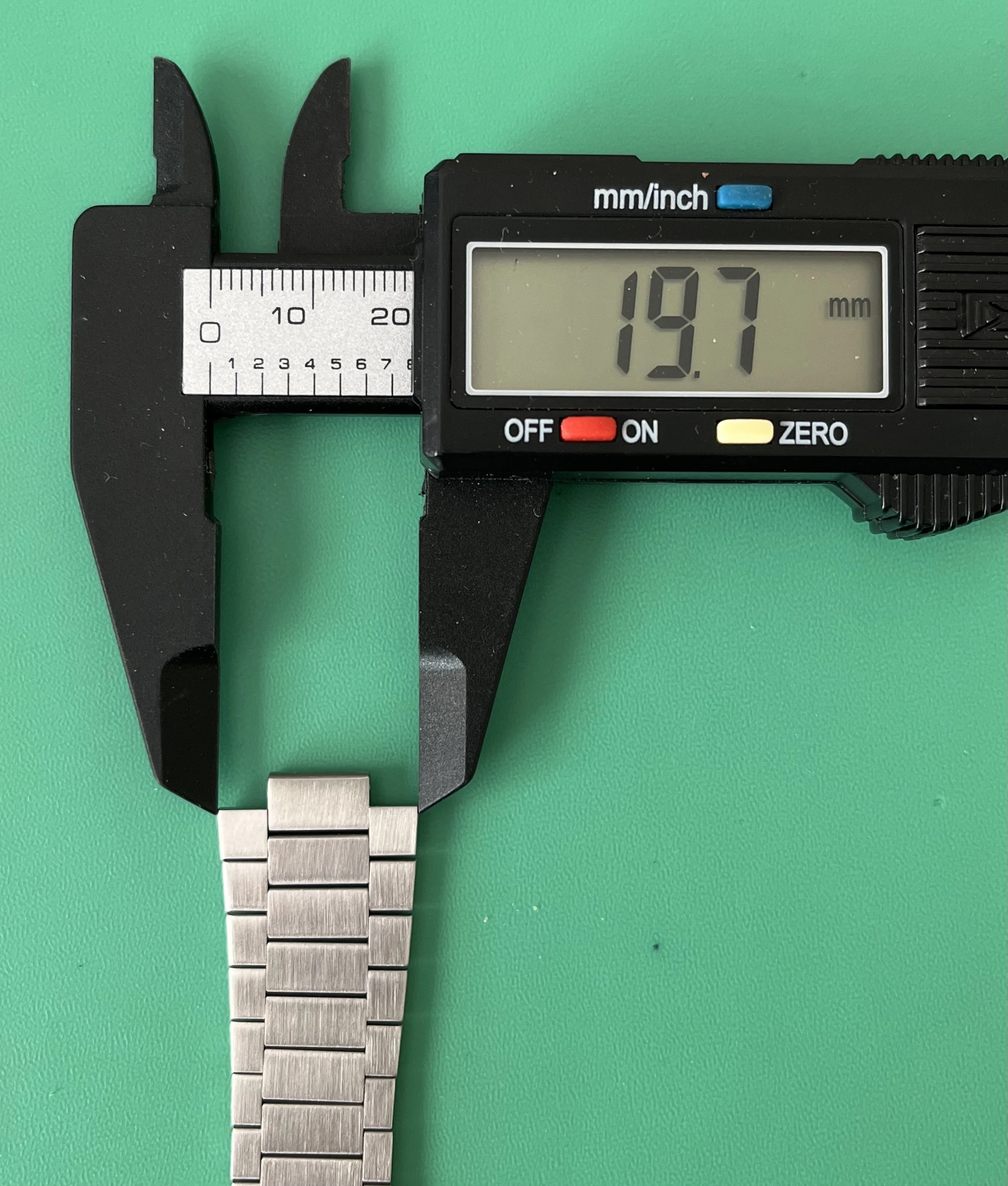

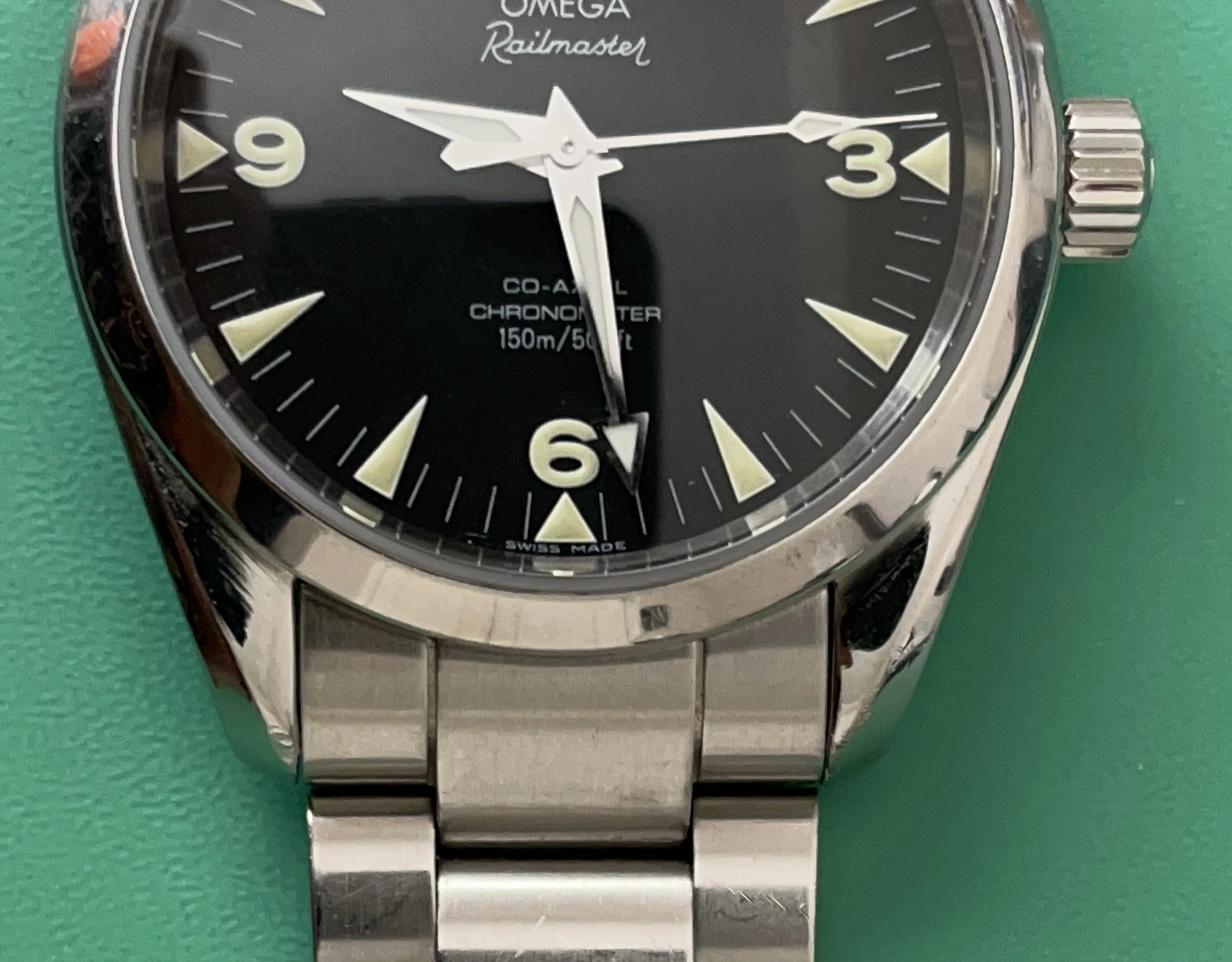

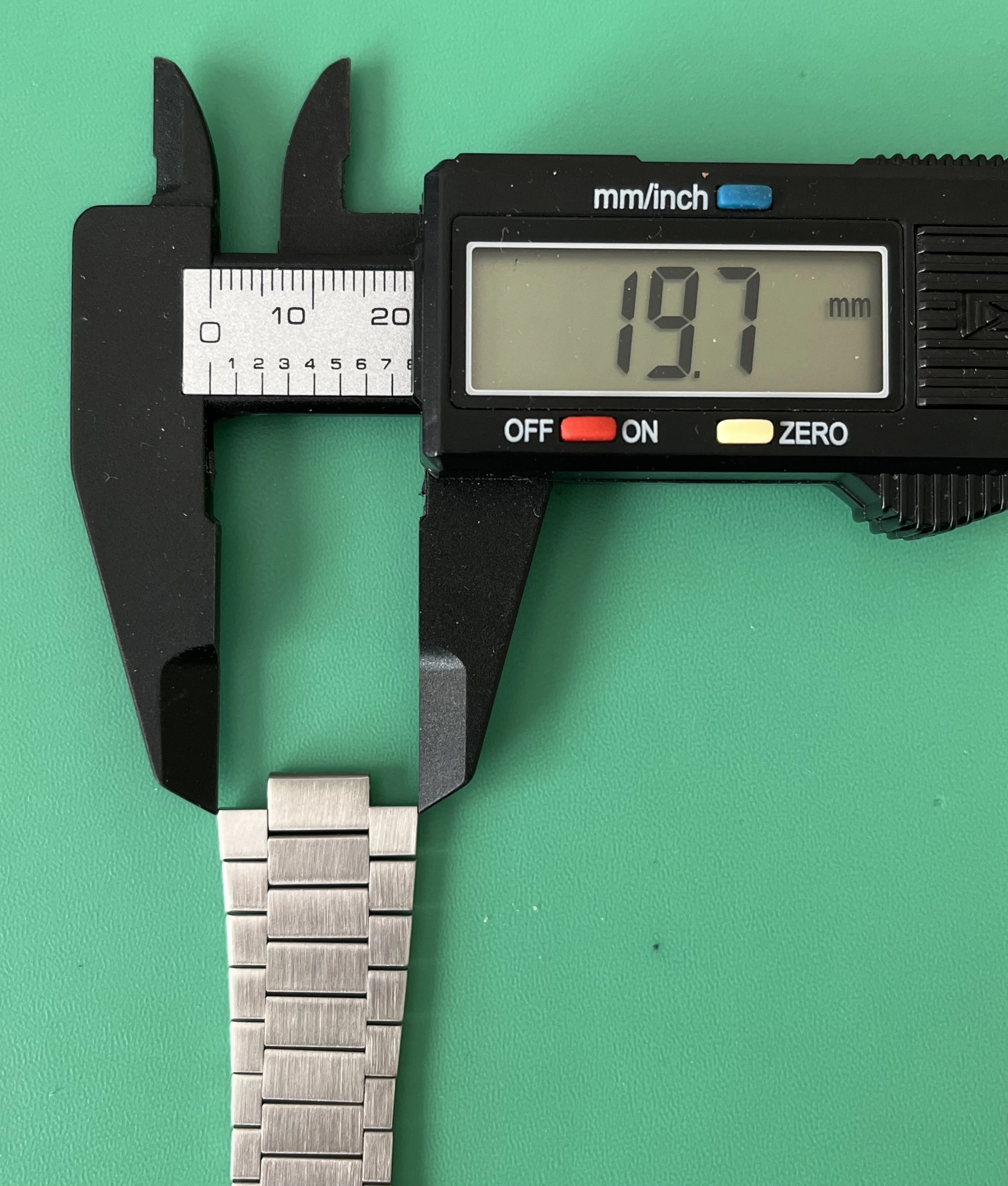

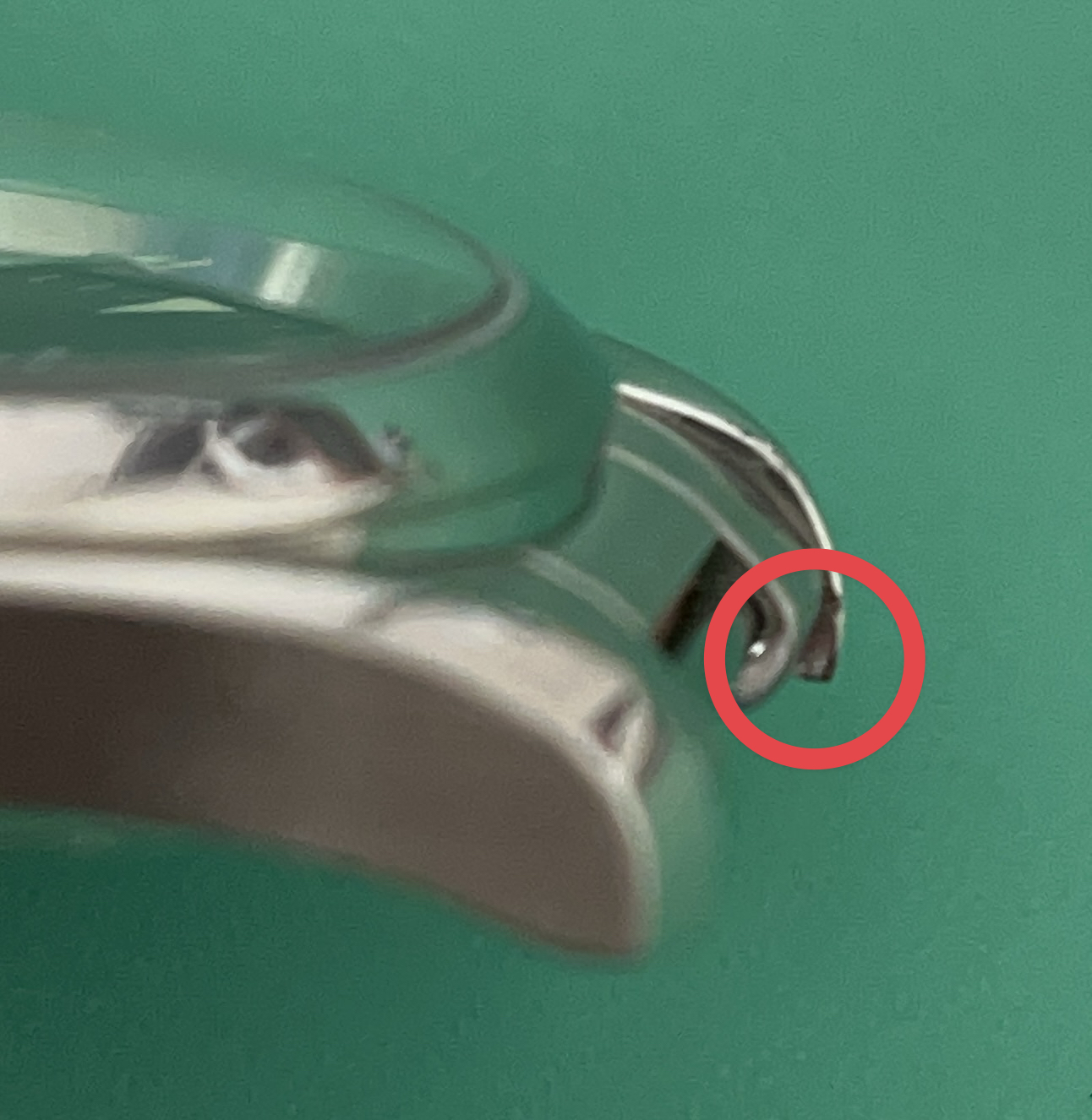

The problem with the Forstner bracelet is the first proper link. It's 20mm wide instead of 19mm. Since the Railmaster's lugs extend just a tiny bit past the end links, the bracelet link needs to fit between the lugs. It won't.

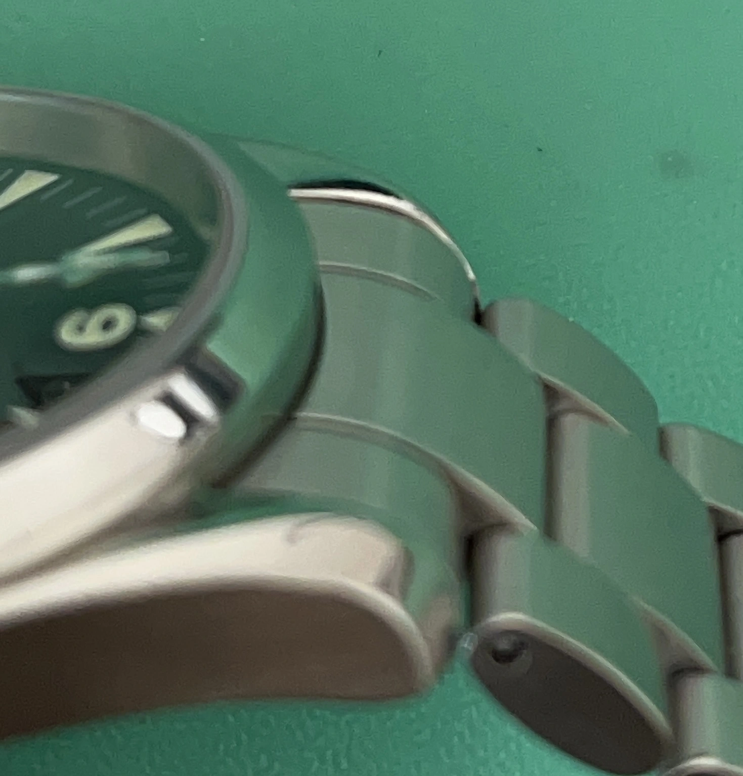

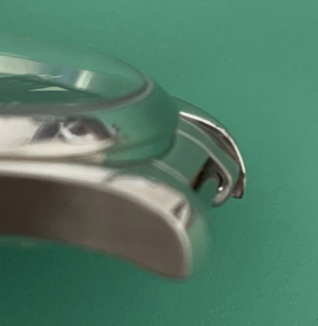

The Uncle Straps end links (in this case for the US1450 model) also fit the lugs without a gap. Their curvature, though not perfect, is a better match for the lugs than Forstners'.
Crucially, the Uncle Straps' proper links are 19mm rather than 20mm, so there is no problem fitting them to the watch.

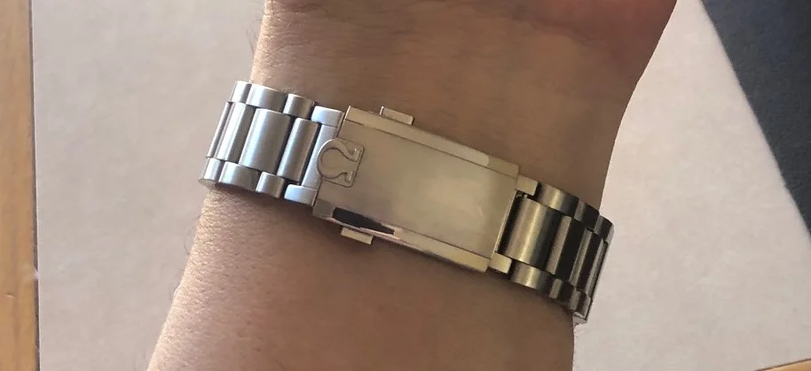

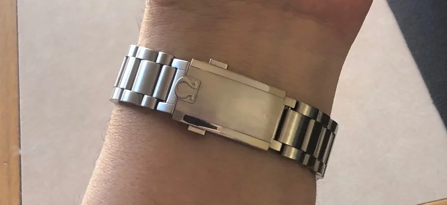

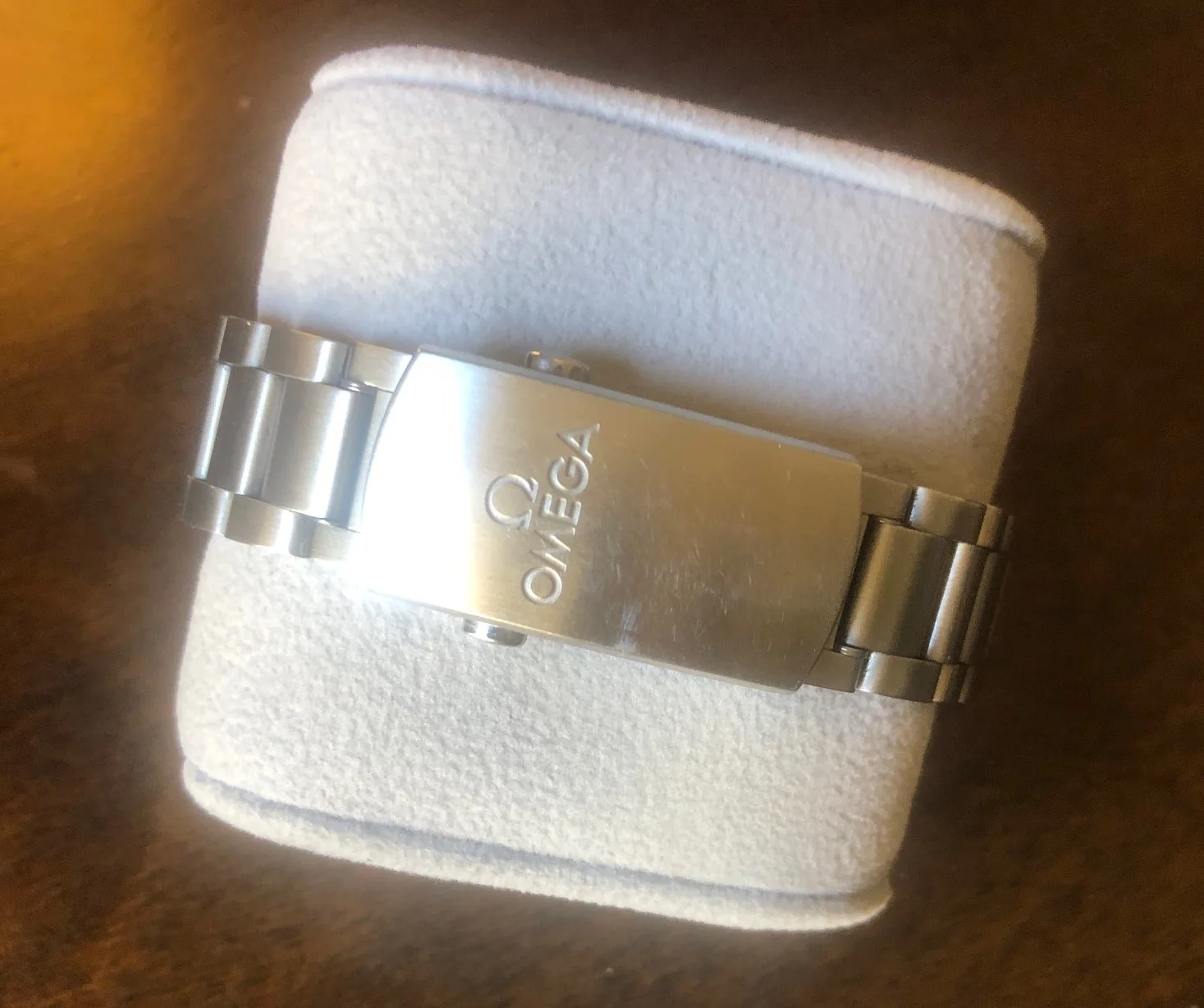

The clasp to the Apollo 11 50th anniversary bracelet can be fitted to this bracelet. The only real downside is that connecting links to the clasp have a 10mm spacing and the AT bracelet has a 9.5mm spacing. So there is a gap of 0.5mm you can see. It doesn't bother me though because it's on the underside of my wrist 99% of the time.
Also, the Apollo 11 50th clasp only has 2 micro adjust spots. Better than the OEM AT bracelet, but I'd love to have one more. There's room to drill out a third hole though. I just need to find a jeweler or watchmaker who has the proper tools to do it. My regular watchmaker said he does not have the drill to it, but said most jewelers (that make jewelry) would commonly have the proper set up.
I will also say the connecting links to the clasp are 15mm wide and the AT links are 16mm wide. But in my eyes it looks normal since links taper smaller toward the clasp. And I fully brushed the connecting links to match the AT bracelet but left the clasp as is.

The one linked in my post. It's 19mm.

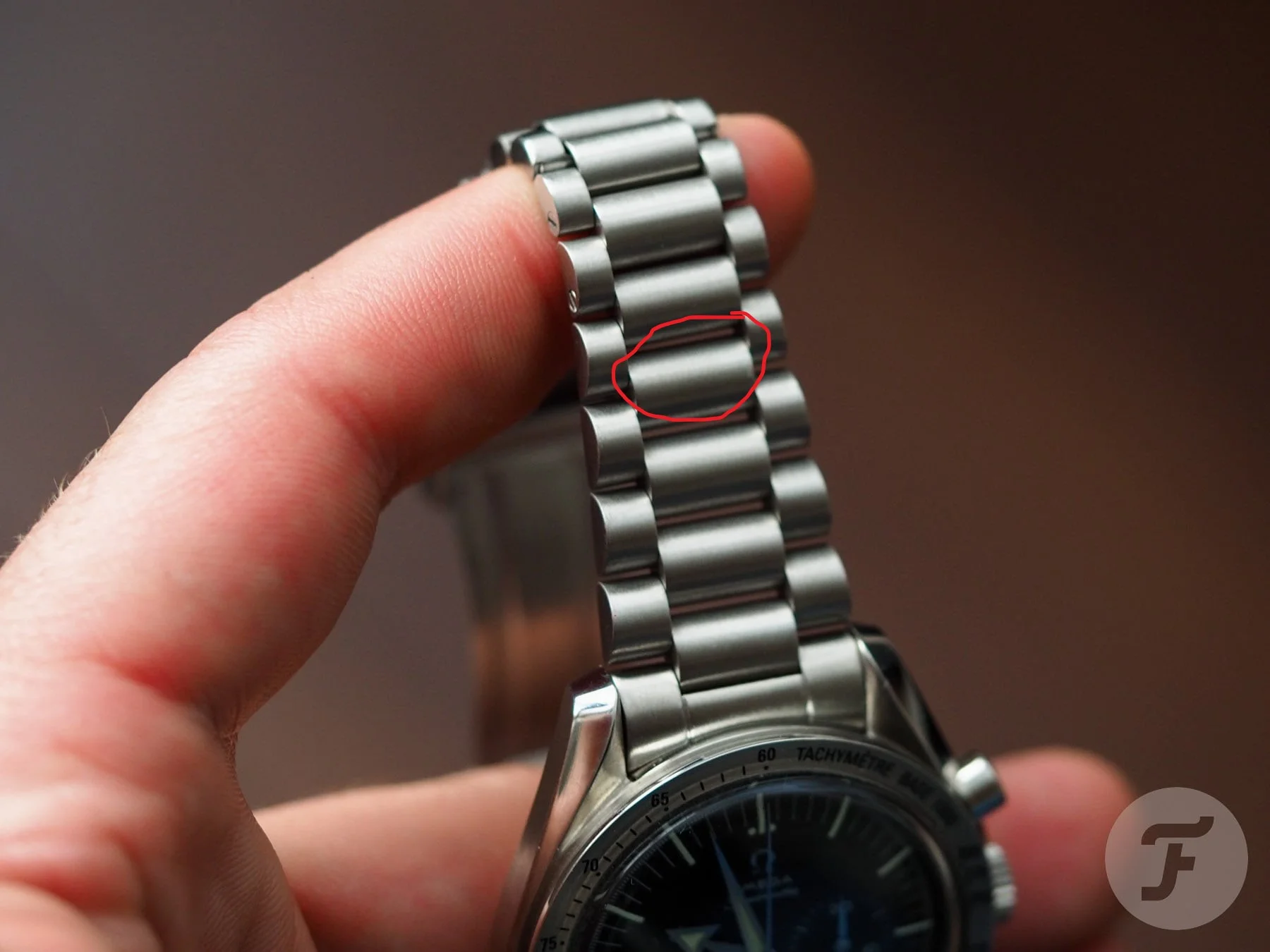

When I say middle link width, circled in red is what I mean.
Photo by the good people at Fratello.

Current gen Heritage 300 clasp is what I use.
The Apollo 11 50th clasp will connect with the 1450 from Forstner and US. Both have 10mm wide middle links. No spacers are needed. The Apollo 11 50th connecting links are 15mm total, and the Forstner and US bracelet links are 16mm total, which is fine because the look steps down toward the clasp.

The Apollo 11 50th clasp is a bit dainty. It seems more suited for a dressier watch like the AT. While it is well built, it seems a bit lightweight for the Speedmaster or Seamaster. It also only has two micro-adjustment holes. That said, there is more room in the clasp for a third and perhaps fourth hole. I've heard of people on the forums who have had their clasp drilled to add another hole. I have no idea why Omega would choose only 2 holes when there's more than enough room for third or even a fourth. More micro-adjustment choice is more better. 🙂
The Heritage 300 clasp has more presence and is well constructed. I really like it. And it has 3 micro-adjust holes with the press of a button. It doesn't get much better than that. I have two of these clasps and I use one on my AT and one on an SMP bracelet. If you're choosing between the two I would definitely choose this one for a Speedmaster or Seamaster.
