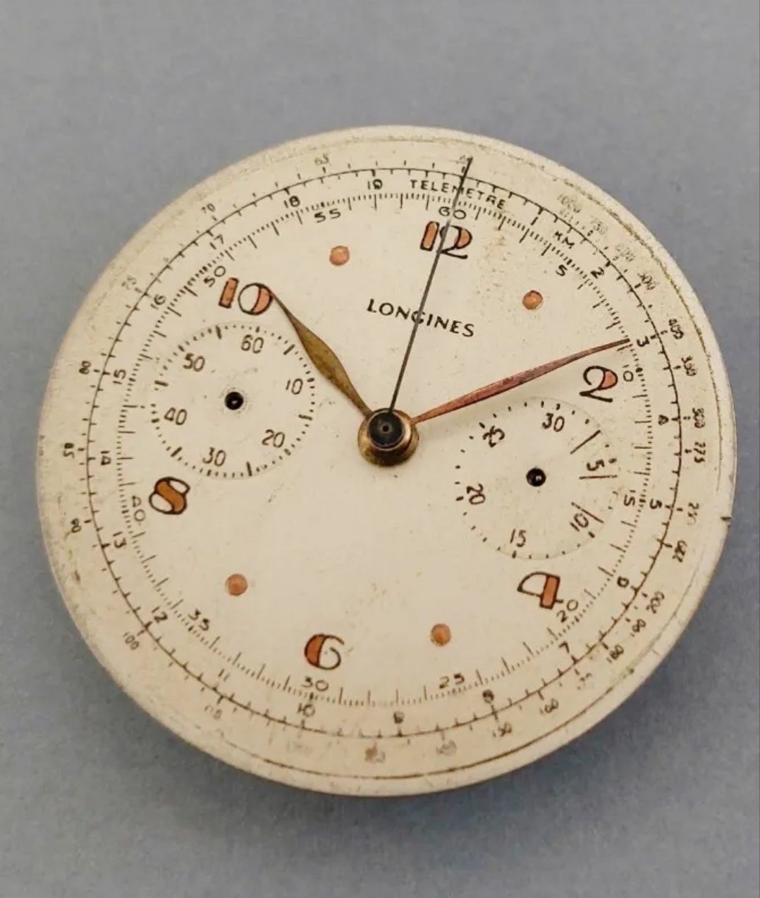

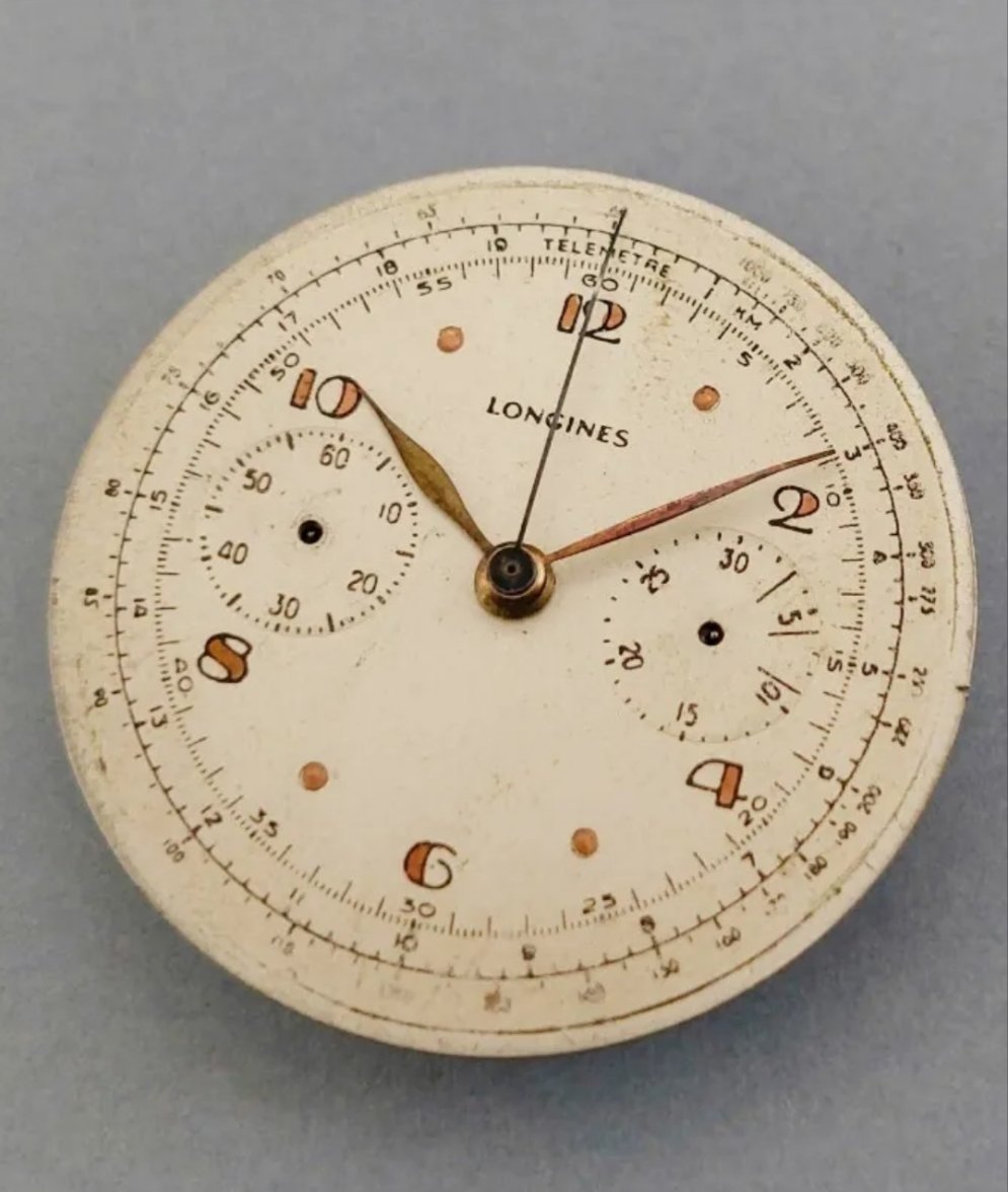

It Is originale dual Longines in your opinion? Thanks to all

It’s a no from me.

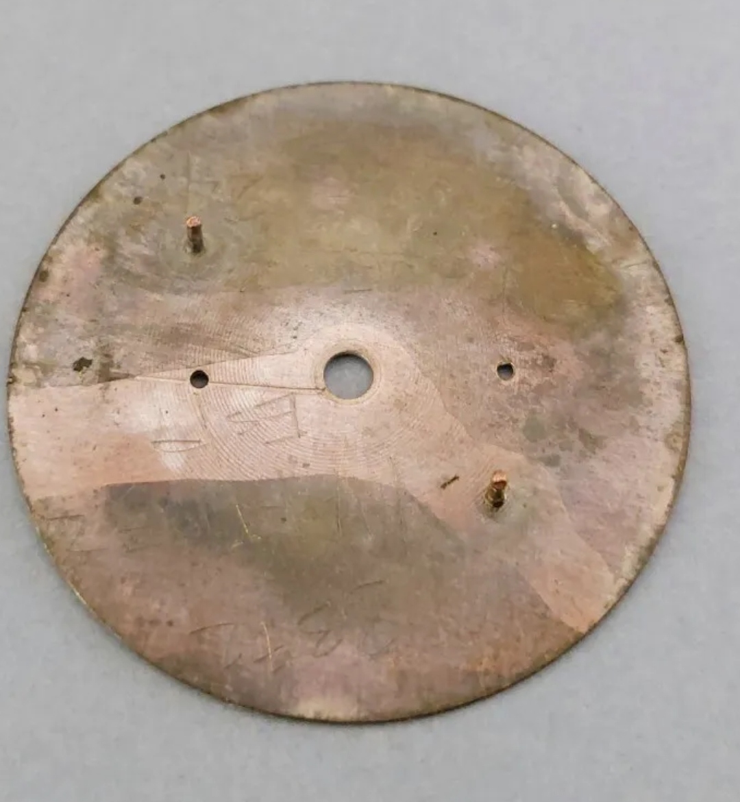

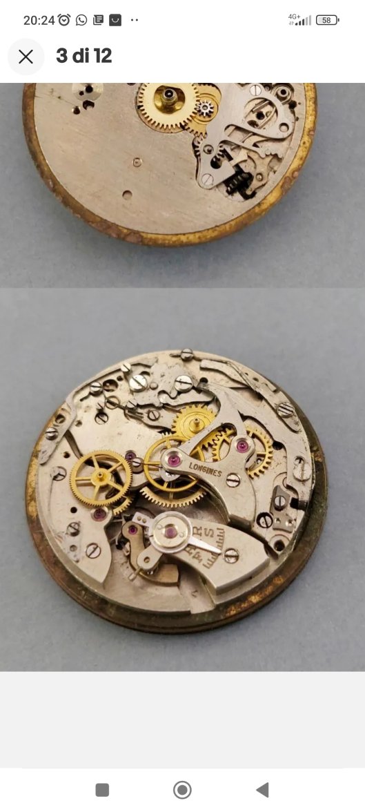

You left out the second most important photo the back of the dial.
4,015
45,131
IMO, not original.
I'm with you... Dial looks like my "cheap" Dulux
Mind you, I really like it... But it is probably one of these with the redial Longines which seems a bit sloppy to my amateurish eyes. I don't like too much the "S", the font in general... Now, happy to learn if somebody says the contrary!

Those random marks scratched on the back are typical of what is often found on refinished dials.

So It Is fake?
2,829
4,945

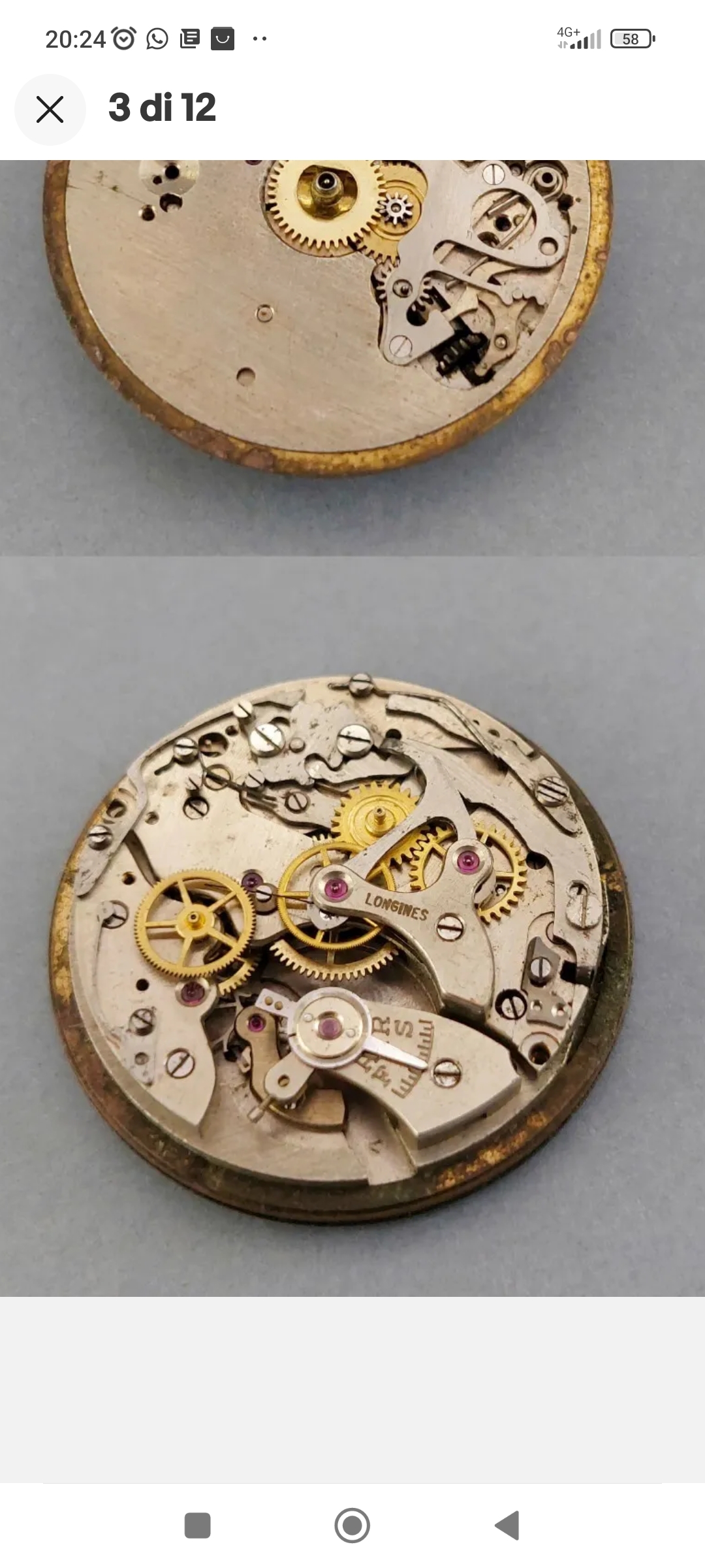

Definitely not an original Longines dial. Furthermore, I do not think that Longines used this Landeron movement in any of their watches. So in a way, yes, it is fake.
