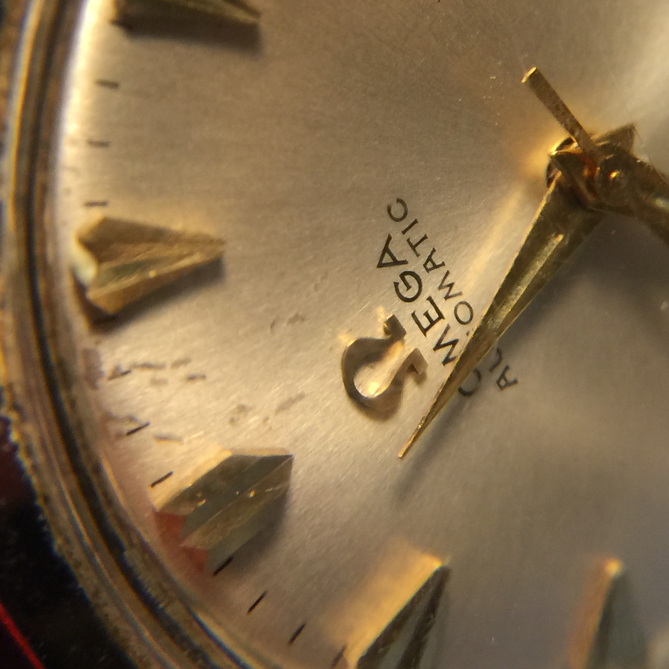

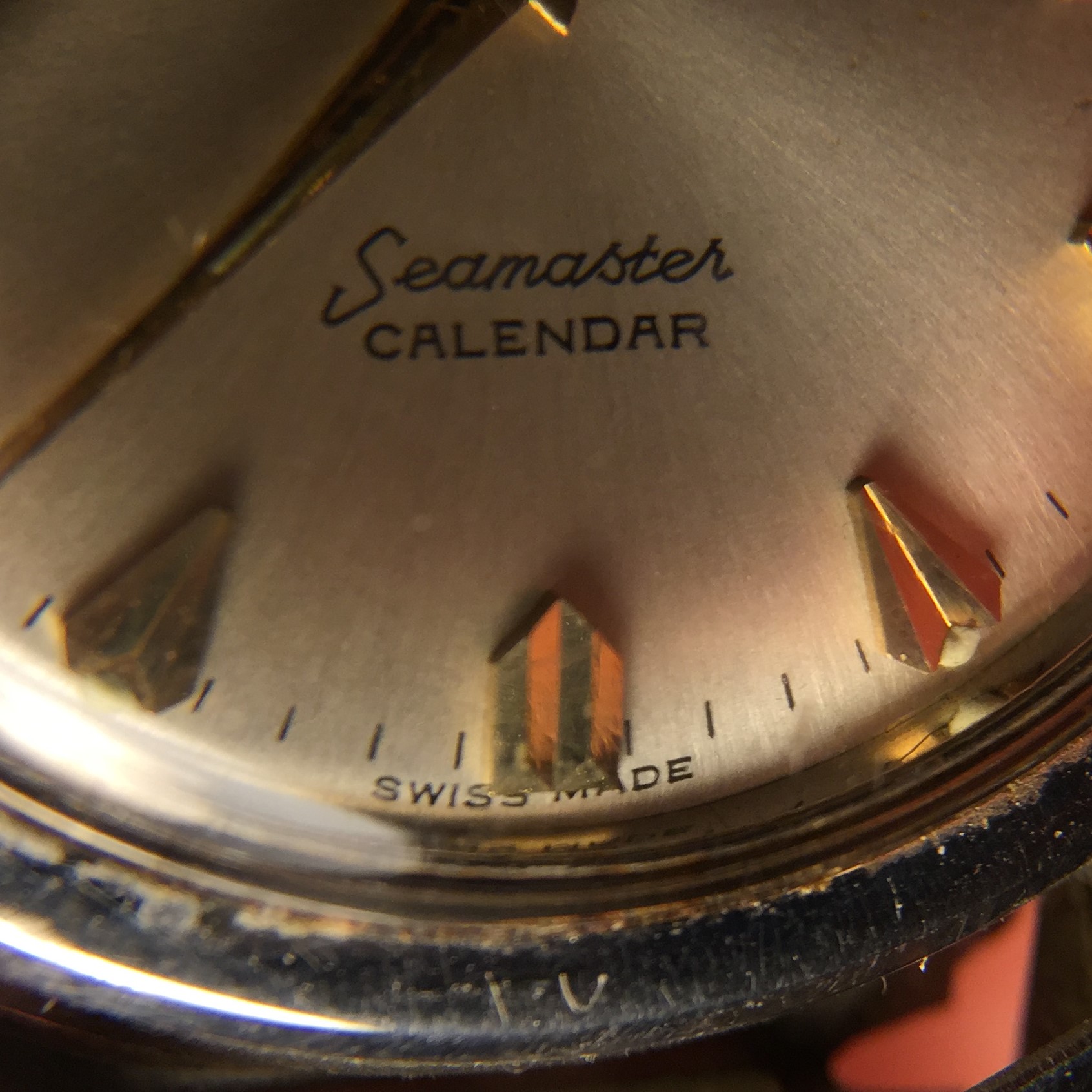

For various reasons, I believe this to be an original dial, but it's an interesting one.
Easier to see under the loupe, but the printing for "Omega", "Automatic" and "Calendar" is one weight and color and "Seamaster" is another. It looks as though "Seamaster" was printed after "Omega", "Automatic", and "Calendar". I can well believe this.
The minute track vs the shields and arrows are not perfect. I suspect that the first printing was off a bit, because the minute track is off and "Seamaster" seems to align with the shields and arrows better.
The printing is just too good to be a redial, in my opinion, outside of the minute track.
Here's some speculation: this is a US Collection piece, with 11/16" between the lugs. I've seen a few other dials nearly identical to this one. Perhaps Omega sent the rejects out to be used in different countries?
We'll never know. But it makes me wonder.

I doubt it. Some of it is shifted clockwise and some counter-clockwise. I also think it's strange that the "Seamaster" printing gets bolder from left to right, and is angled with respect to "CALENDAR". The 12 o'clock applied marker is misoriented with respect to the Omega logo. It's super messy overall. The only thing I like is the radium burn.

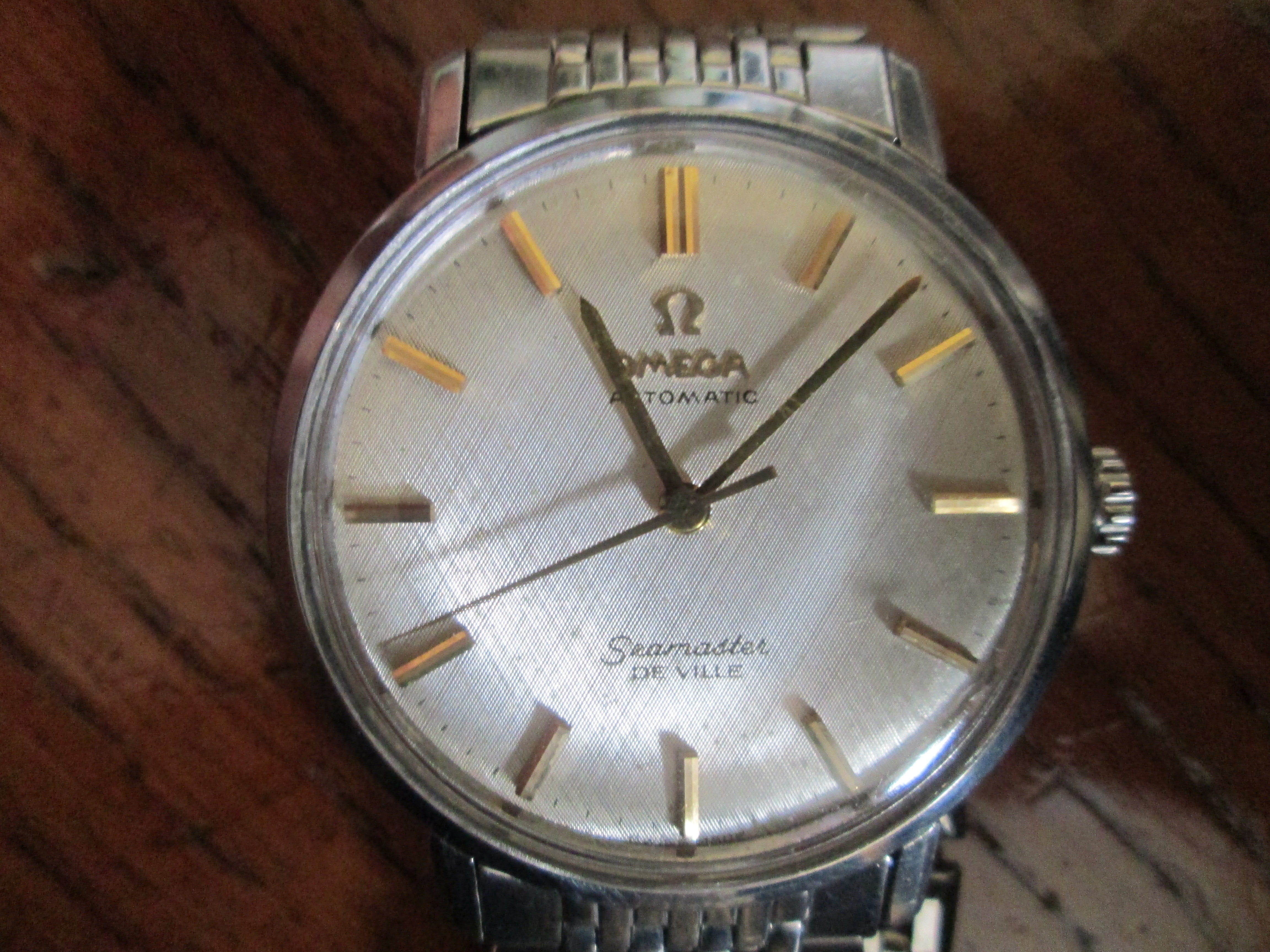

That's my opinion too. These things could and did happen. - note the misalignment around 11 and 12 on this Seamaster de Ville. The linen dial is unrefinished.

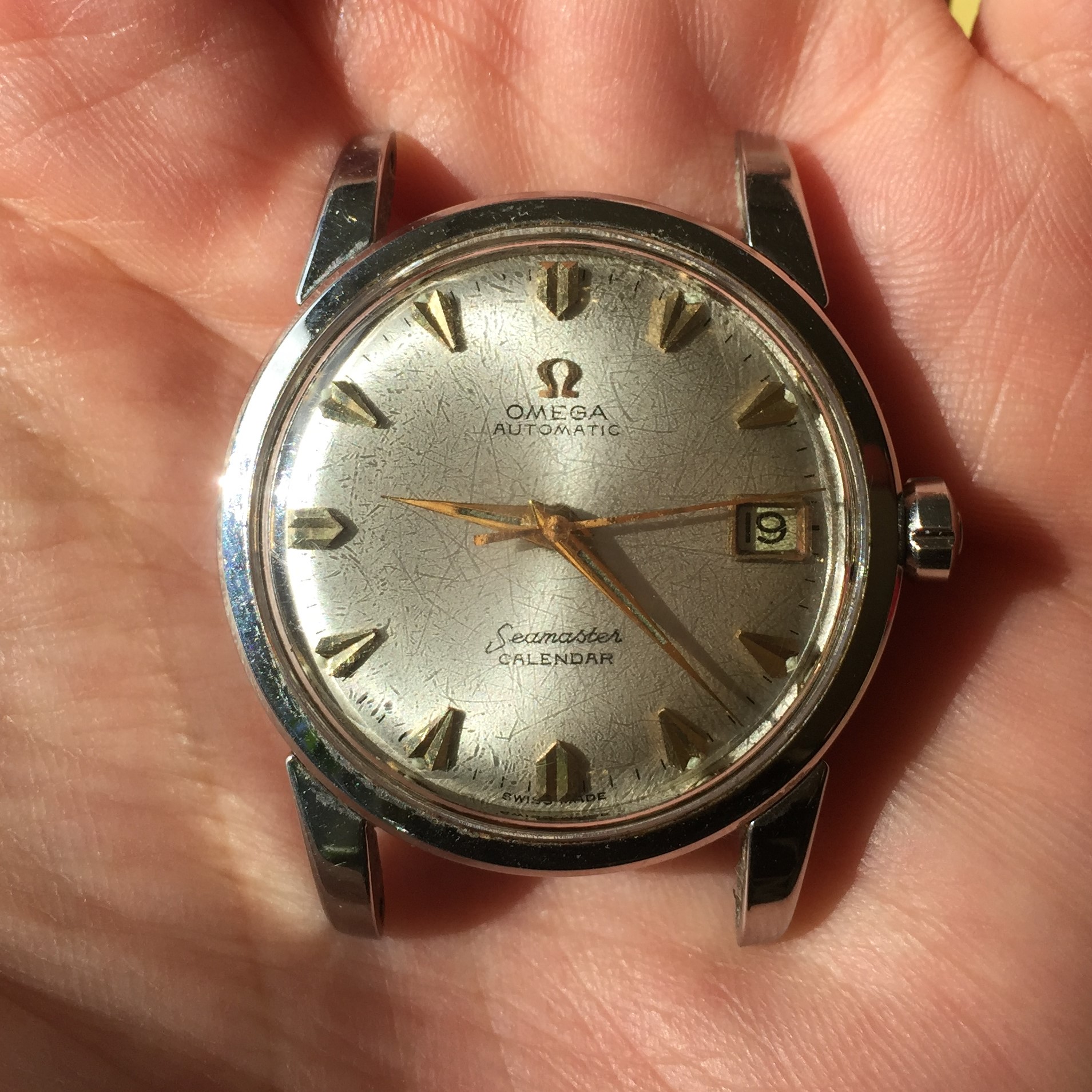

Yes. Some things are wrong. As upside down as the plane on your stamp. 😉

I don’t know if you can see it all zoomed up but the ink is different for “Seamaster”. I think it was added later.

The words Omega, Automatic and Calendar have clearly been applied separately from the word Seamaster. 99% they have been printed, given the accuracy of the lettering and the way the ink stands proud of the surface - the other 1% allowing for a redialler of staggering talent. AFAIK redials are usually done by hand and I've never come across redialled text so obviously printed, which is why I think this one is original, but if someone can point to similar printed redials then I and (some at least of) the rest of us will have learned something interesting and useful.

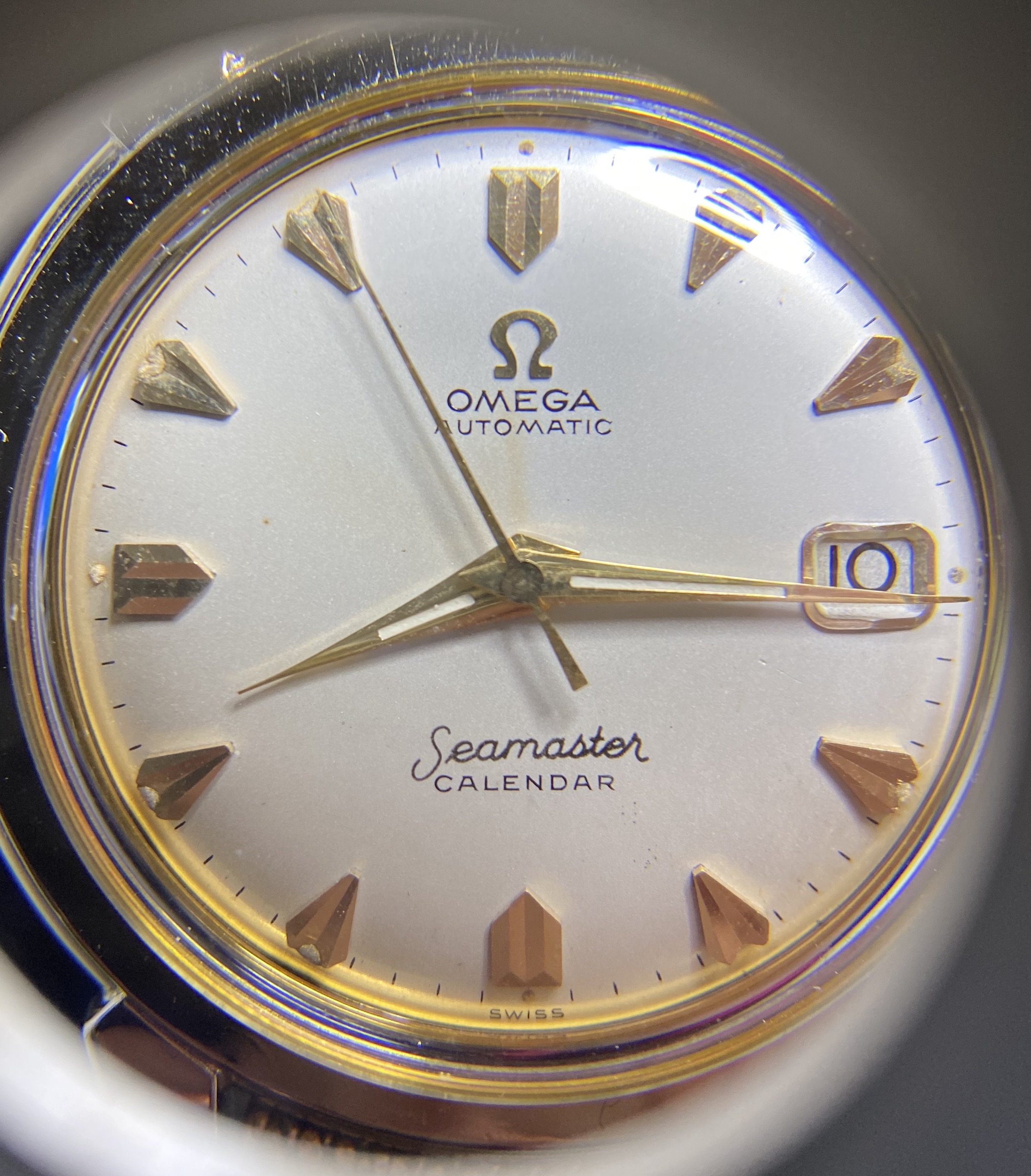

My call: redial, but, a good one. You asked for opinions and I base mine on the nasty 'ster' printing, awful minute track alignment near 9-11 and also the supporting evidence of the irregular lume which suggests prior intervention. I have never seen anything leave Bienne (or Geneve or wherever) with such a dial, yes there will be variation, but not that bad IMO. The otherwise cleanliness of the dial is also suggestive of dial intervention.
