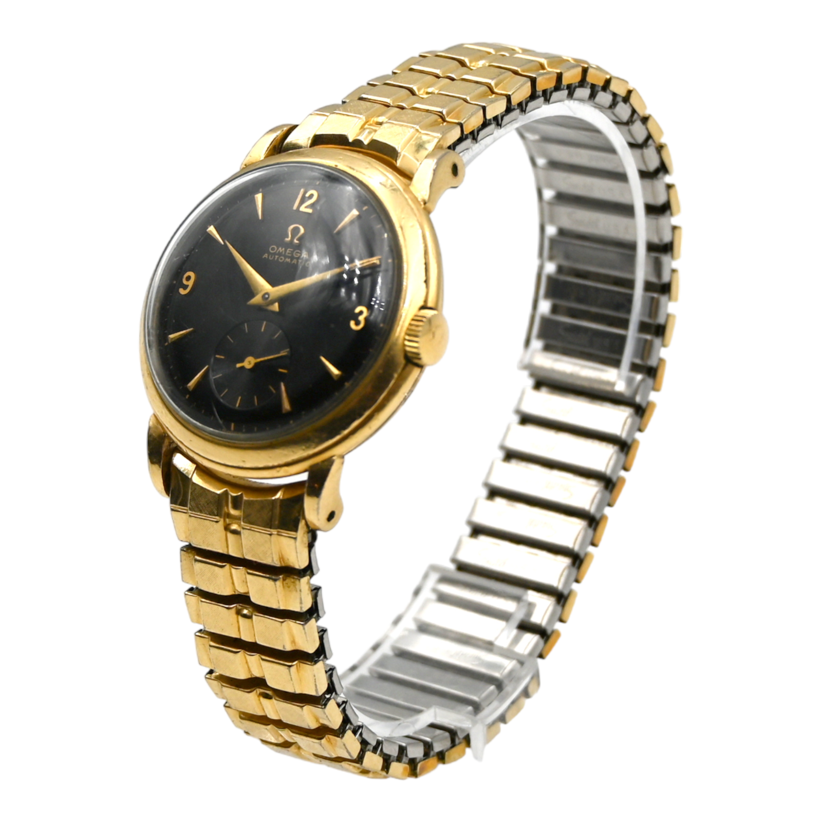

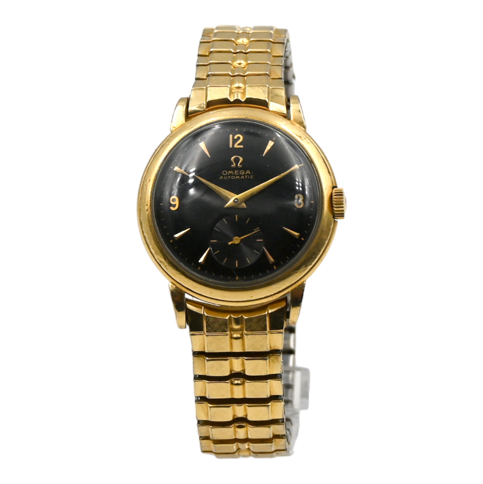

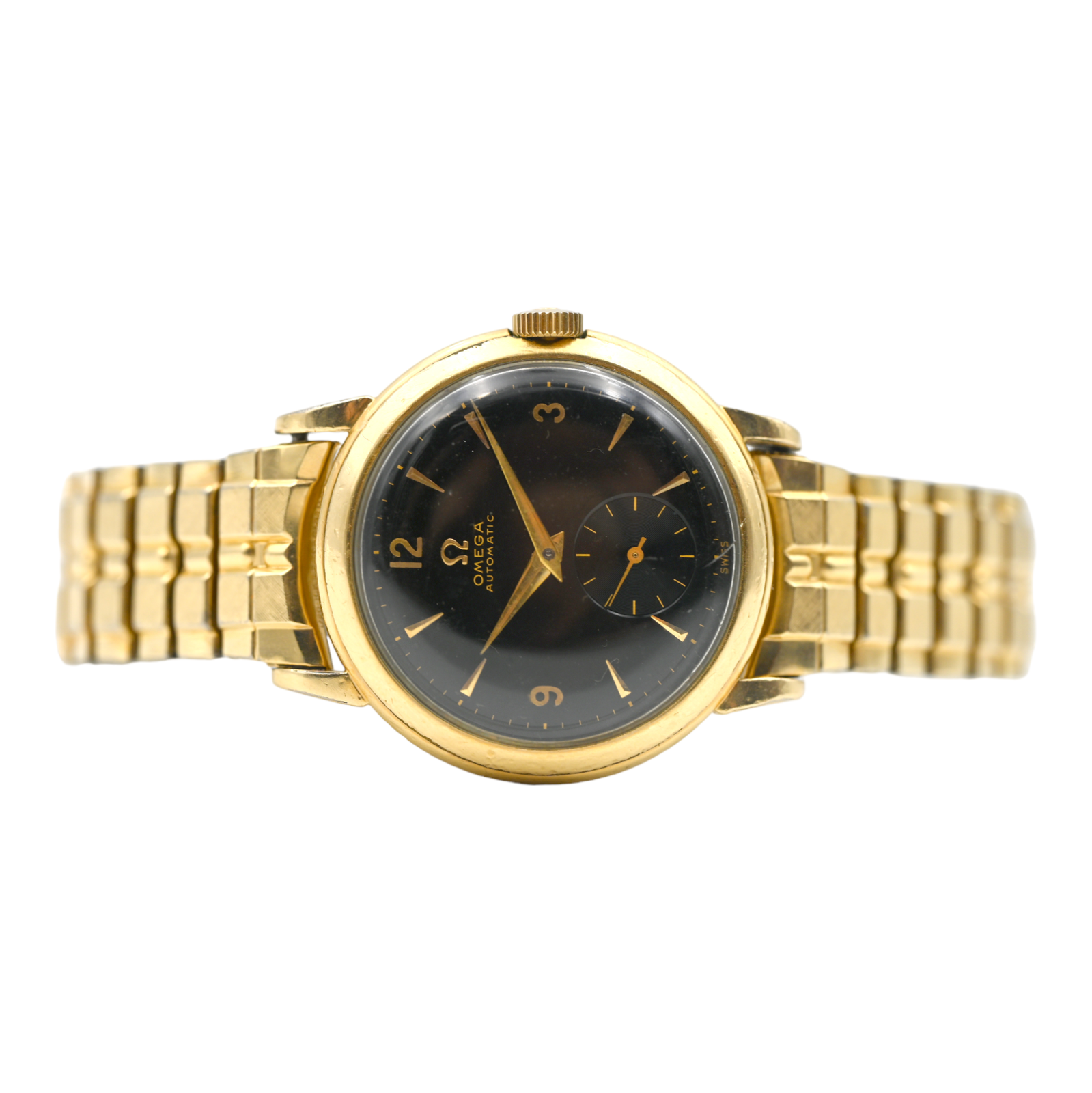

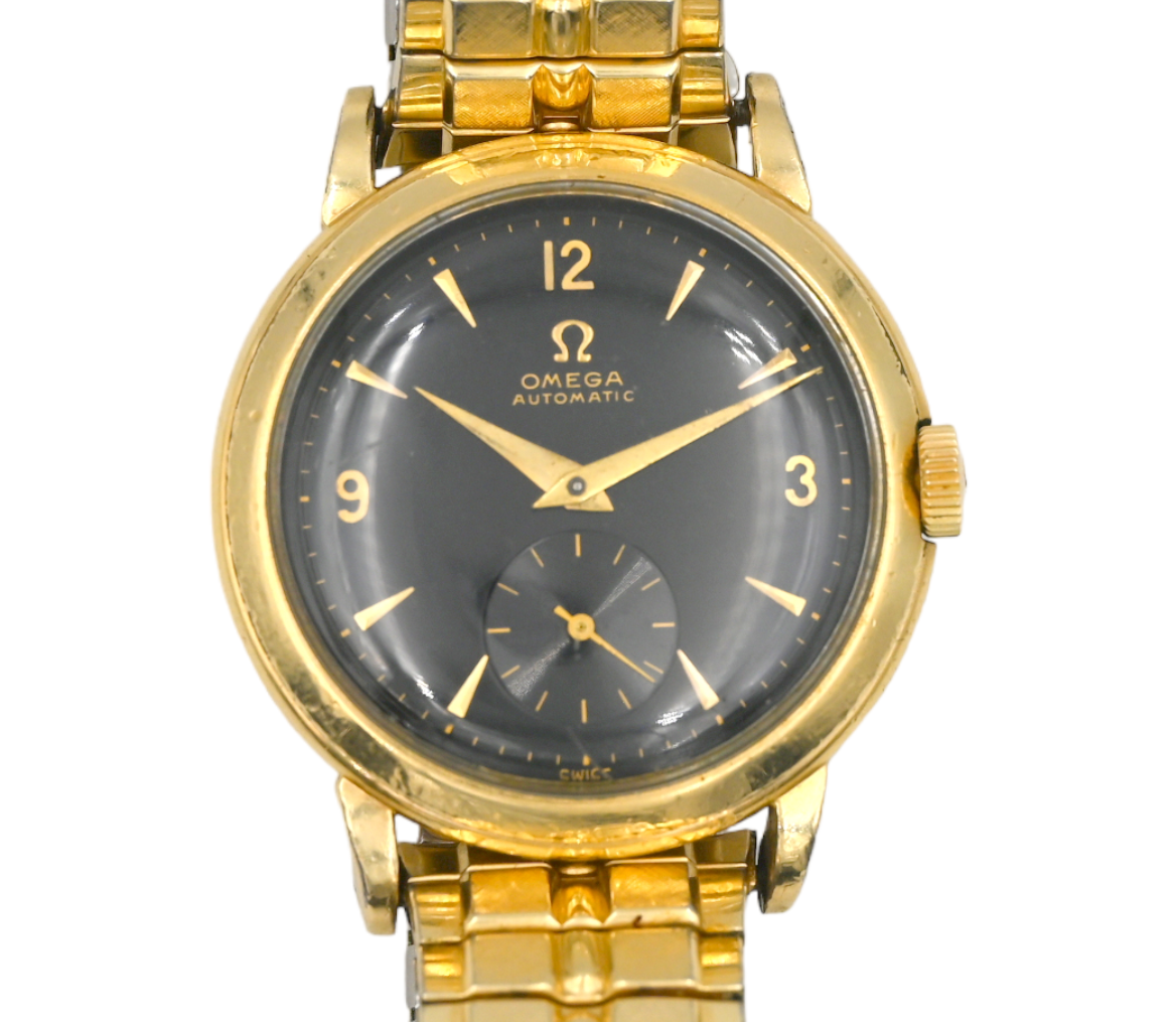

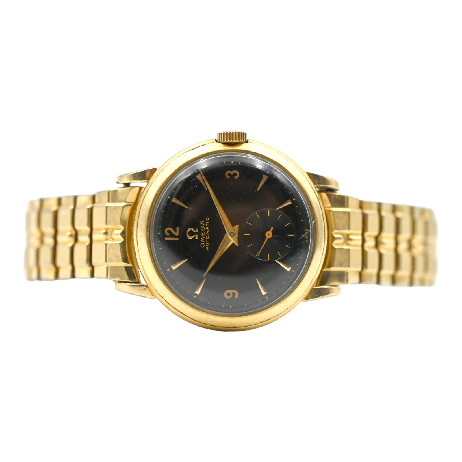

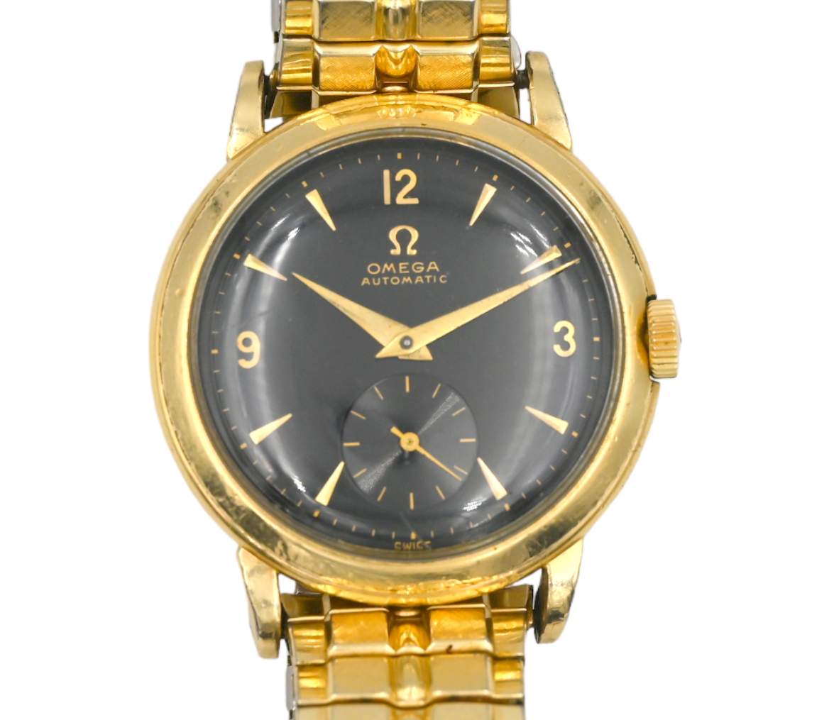

This is another suspicious black dial vintage Omega that I purchased on eBay. I'm trying to train my eyes to see better. Does the c at the end of "automatic" look a little off, spacing-wise?
Any thoughts on this presentation watch from 1955, with the bumper action? I think this watch looks good on either men or women. The price was not bad at $465 if it's working well and keeping time, I figured, as the seller claims.

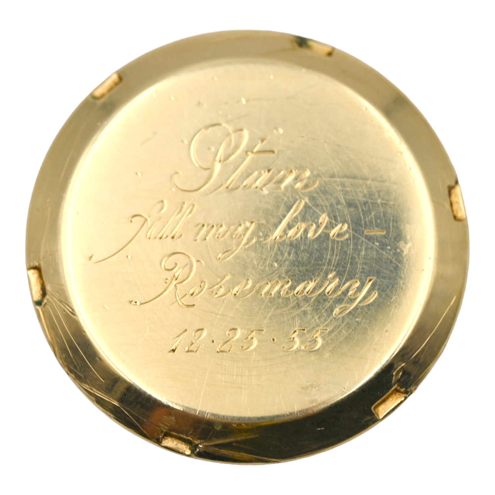

Condition: Fine estate condition. Metal has various light scratches and scuffs. Dial is clean and clear and crystal has only light scratches and scuffs. The case has moderate scratches and scuffs with an engraving on the caseback. Watch is running strong and keeping good time. Please see photos for details.

Good chance that it is a redial. The automatic font looks weak, especially the first A, I don't see serifs, the black is too good at that price.
On the other hand the minute marks look good and so do the hands.
Try posting a more detailed dial pic once you have it.

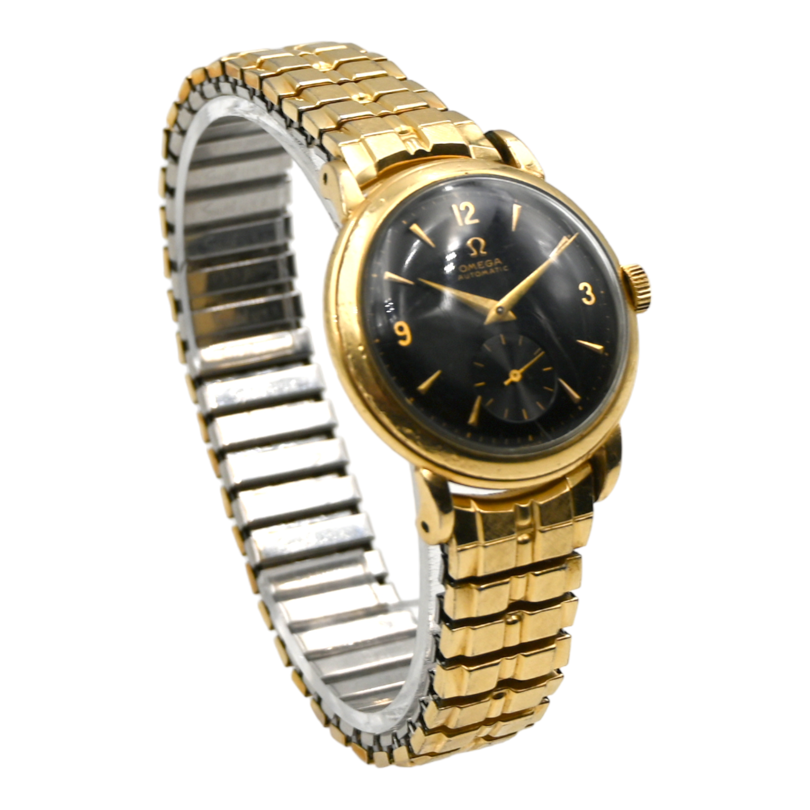

Looks like there is wear through the gold on the sides of the lugs and on the sides of some bracelet links, but the photos are so overexposed (on purpose?) it is hard to notice.

The sub-dial snailing looks pretty good. The case looks like it might be pretty rough.

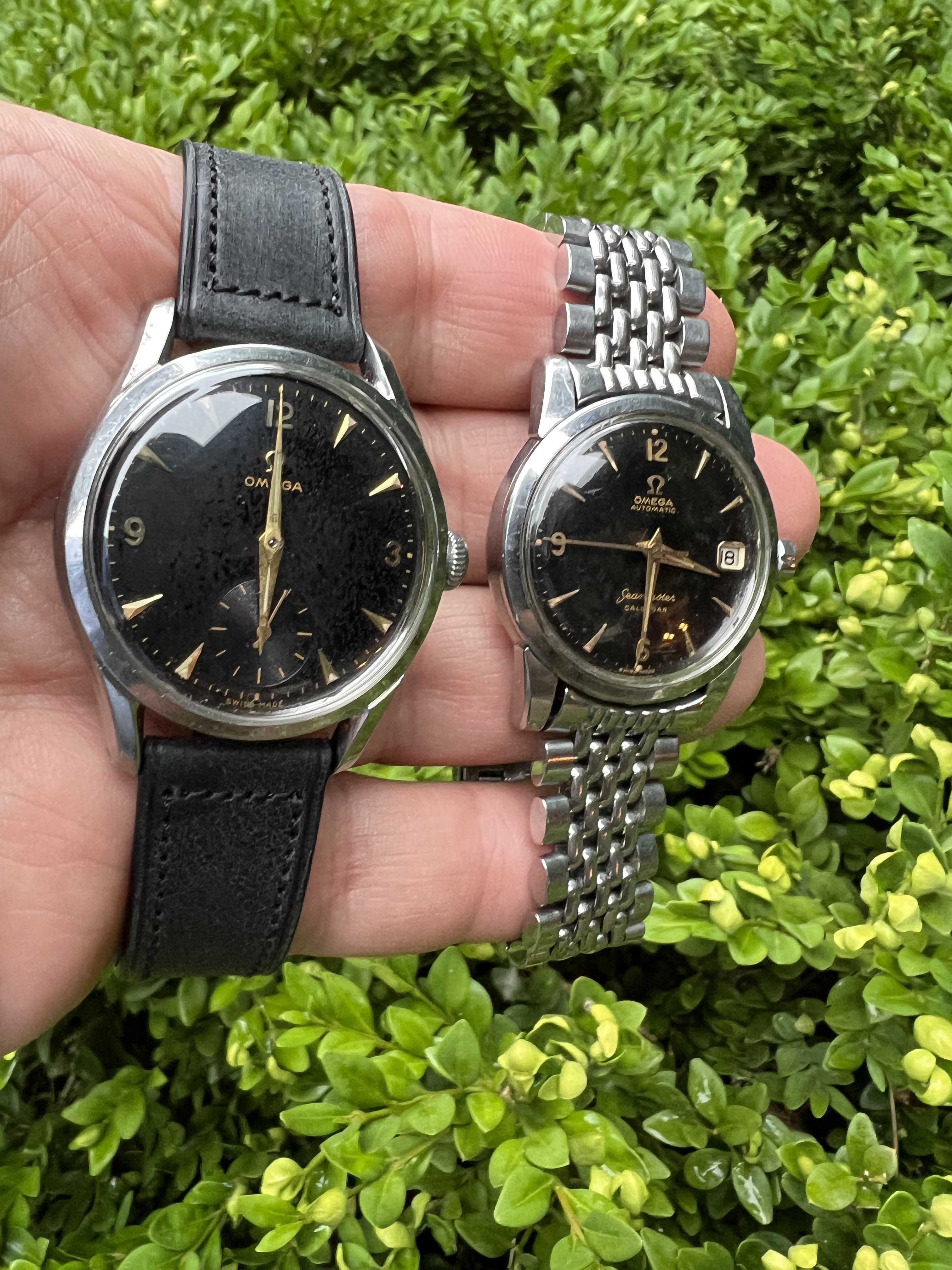

I see an original black/gilt dial.
The case on the other hand is clearly well worn from years of use.
3,678
8,008
You can tell if its original gilt dial with magnification, the script is the absence of black coating, showing the underlying dial metal.
here is a thread on gilt dials with photos.
https://omegaforums.net/threads/gilt-dial-omegas.45730/
If its original gilt dial ( and I would trust X350 XJR on this) I'd say it is a great purchase I think it will look great on a nice black period box stitch leather strap from Torre

Does anyone know the correct size strap for this watch? The ad says 20mm, but I'm not sure that is correct. Maybe it 18mm? I'll probably wait until I get the watch in hand to measure myself unless someone else knows.

Should be between 17 and 18mm. Originally probably 11/16" or ca 17.5.mm.
