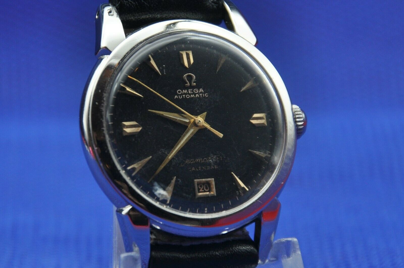

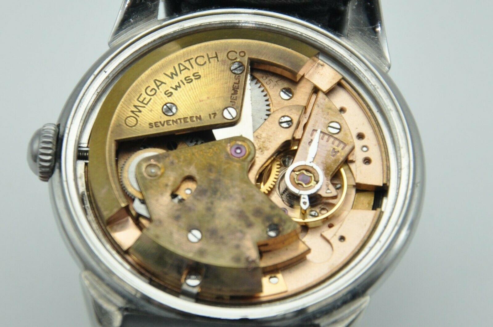

Hello all,
I have been wanting a Seamaster Date at Six for a long while, and this seems like a decent example. To my eye the dial looks original, and the case, although a little soft in the lugs looks pretty good. They claim it is serviced, but the movement shot looks dirty to me. I would appreciate any thoughts. I have been holding out for a dimple dial, but black would work. I understand the frequency of black dial redials and would really like a second opinion. I do see it is in Turkey and an not adverse to thatThanks in advance for any advice. https://www.ebay.com/itm/385106333156?mkevt=1&mkpid=0&emsid=e11021.m43.l1120&mkcid=7&ch=osgood&euid=82da6d2a0522411dbac368f0c5df00e6&bu=43099717661&ut=RU&exe=0&ext=0&osub=-1~1&crd=20220909054327&segname=11021

I suspect redial, but these photos are not great. In particular, the missing lume is not a good sign. Can you get a clear straight on photo of the dial?

Aside from the possible dial issues, which I agree with the case and movement are really tired. I think you're trying too hard to make yourself like this watch. Buckle looks fake as well.

I agree. I'll keep looking. Thanks all.

Please don’t buy it!
Despite the sellers assurances, it hasn’t been serviced. No reputable repair would let a watch leave in that condition. And look where the regulator points. You can’t believe a word of the ‘description’.
