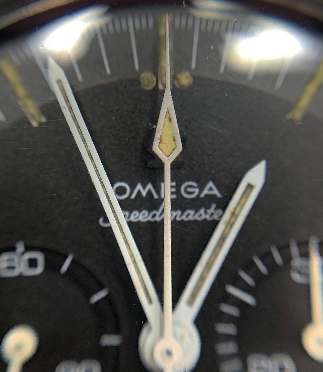

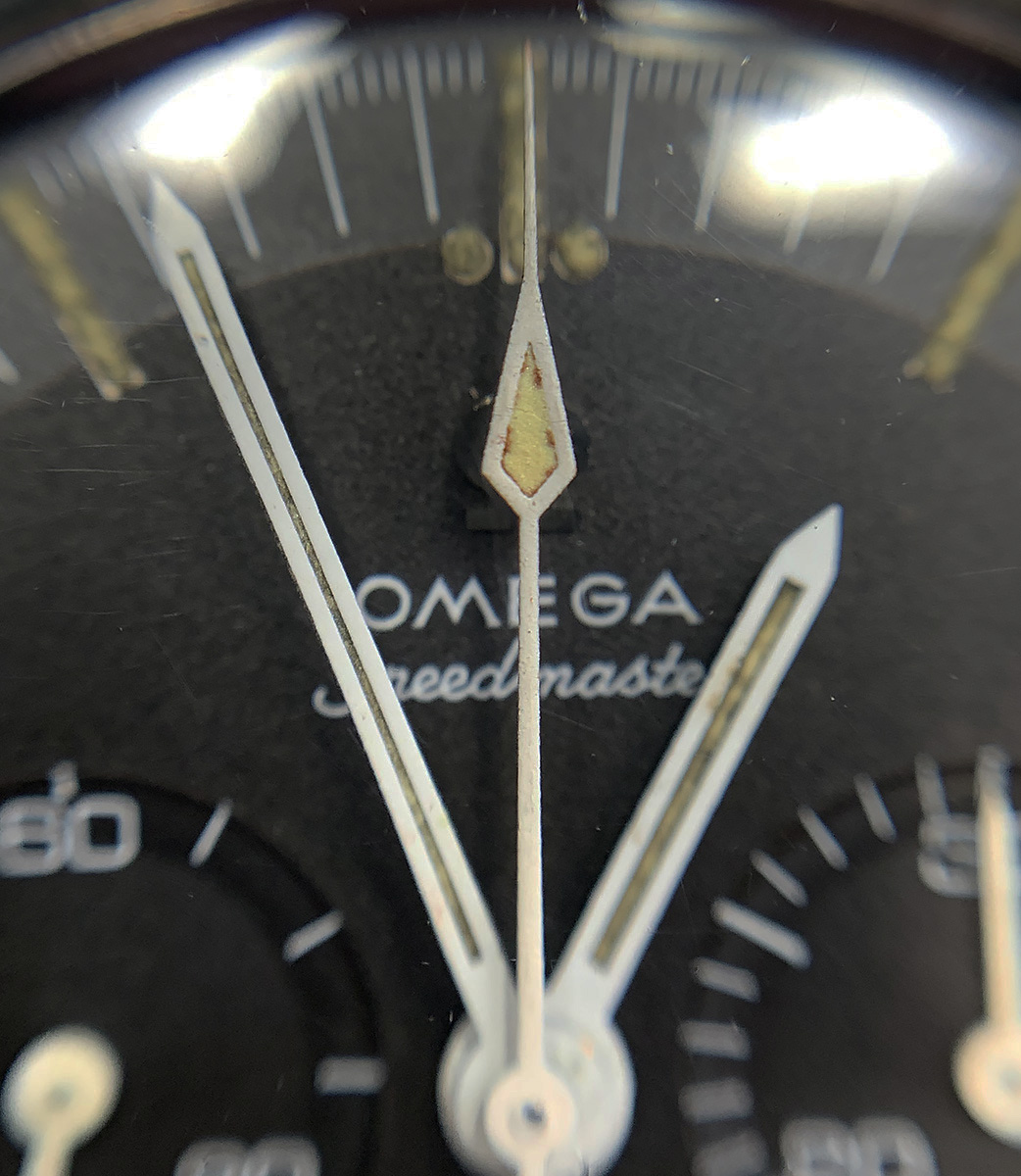

Lume on the dial could be a bit cleaner but the watch looks very good otherwise, congrats!
Been looking at the lume, is there much success in trying to get the original lume cleaned by a specialist or just leave as is for fear of it crumbling?

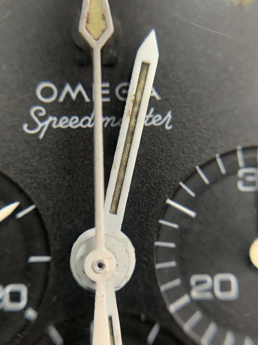

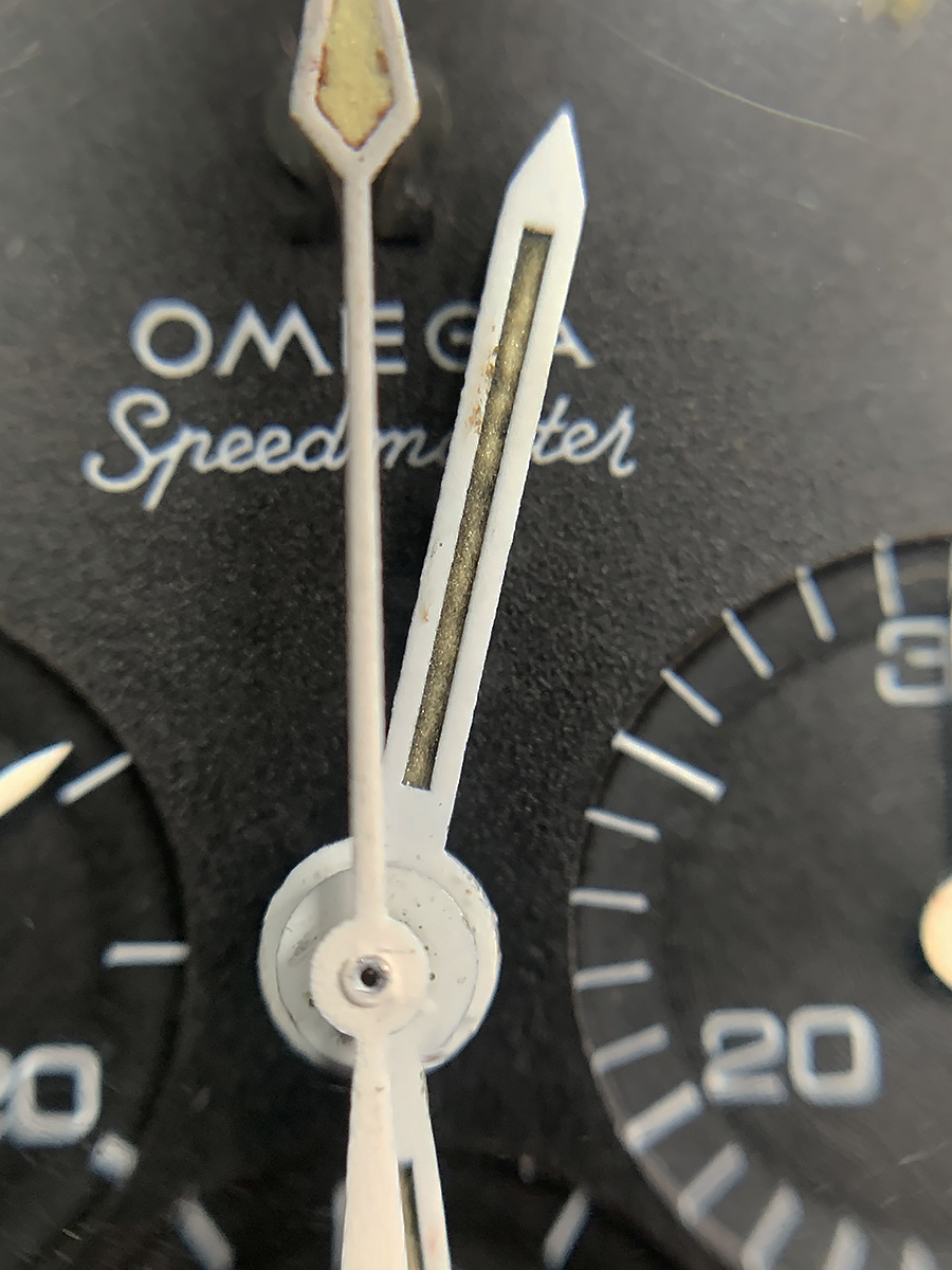

First is the lume in the central seconds hand is a different colour to the rest of the lume, suggesting it could be a service part or a re-lume? Second is that it has a modern service crown.
IMO we see a 24 teeth flat foot crown which is correct for that reference
Lume on the hands looks the same to me, I see no differences between the hands.
Another question would be that the hands -as pointed out by @321Only - look unusal white
I took some close ups today of the hands, yes they look white but under magnification the lume is similar to the hour indices and there is age/corrosion on the hands.

It might have just aged differently or an old tritium relume. who knows

I'd be more vary of a watch with perfectly matching lume on the dial and hands. Most one owner watches I've seen have hands that have aged slightly differently to the dial.
