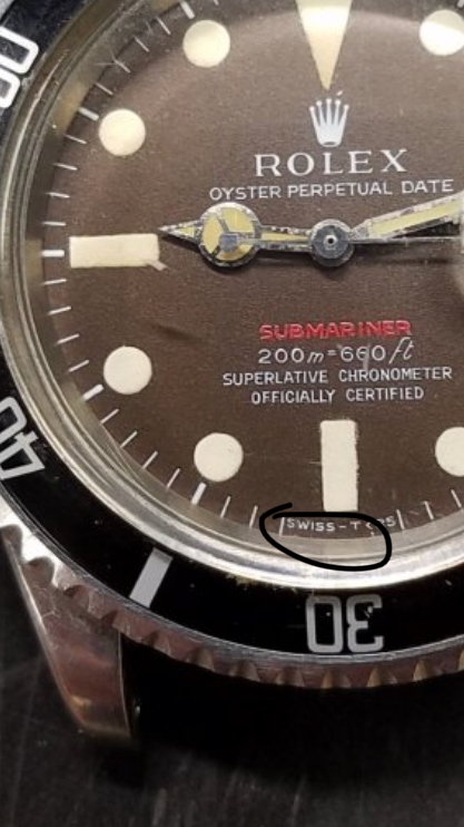

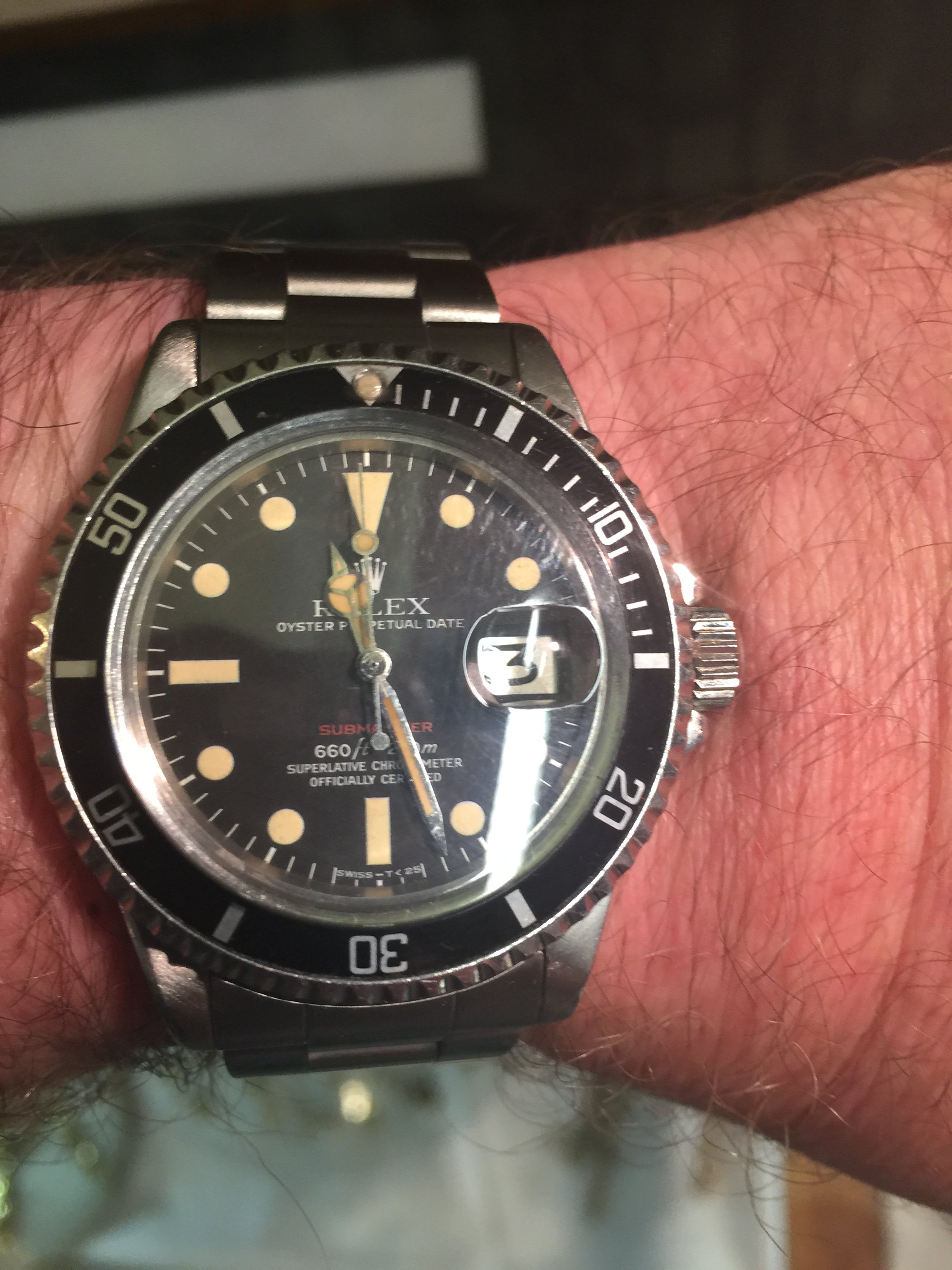

Very much depends on the price. Some of the hash marks are chipped, showing the dial has previously been removed from the case..for service? To change out hands? Who knows.
The “never been serviced” verbiage are buzzwords often used by a seller to make a watch more “virgin”. This watch (asmentioned) has clearly had some work done to it over the decades...most watches have.
The dial alone (if original and untouched”) is worth a small fortune. The case is nice enough, others mentioned the service insert can be replaced for about $2,000usd. Crown is correct twin lock. Pics of bracelet would be useful, and what does dive extension say?

Upon closer examination, I notice the hash marks under Swiss are completely gone...that’s odd. Also, I assume that “crease” on dial face directly offsetting 8 is just a shadow from a crystal scratch?

I don't believe I ever mentioned an asking price in this thread. He gave me somewhat of a price based on some internet searches, which are the market prices for original ones. After my findings, thanks to the help on here, he is not going to get near that kind of offer from me.
Good catch. I don't know if it is the angle or not. I will have to check it out on my next visit. Yes that shadow is a scratch on the crystal. I believe
it is just on the right of the 9 o'clock marker.
