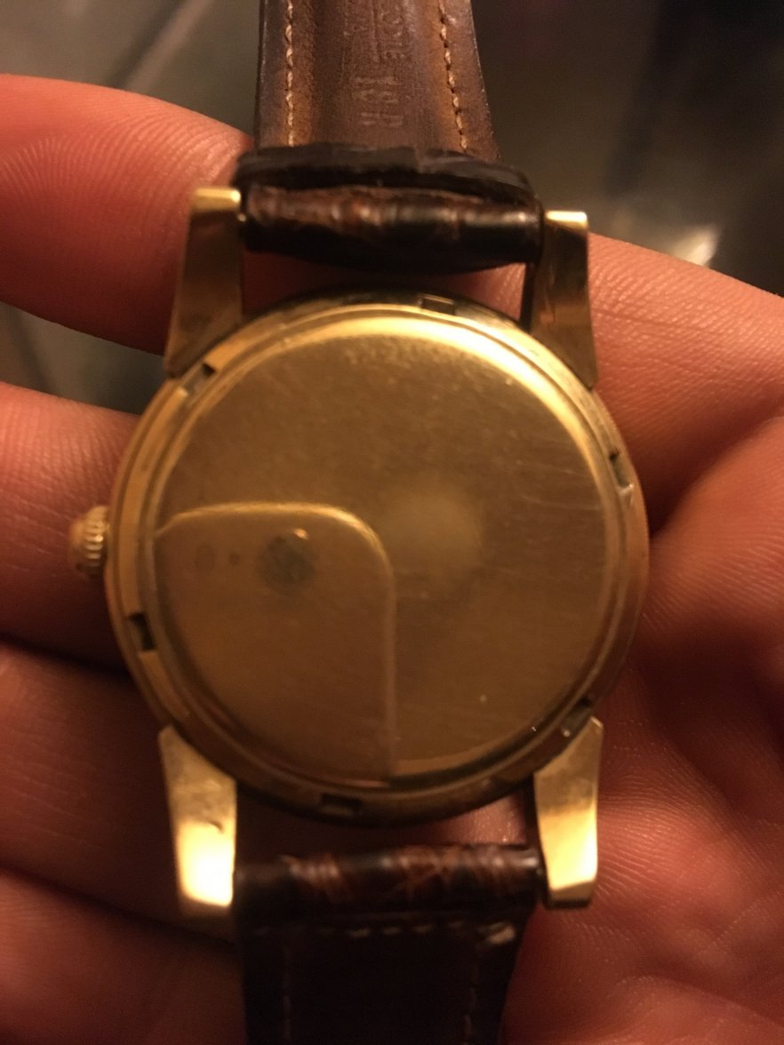

Does this look like an easy back to open? And should I.......someone untrained lol.....attempt it? Is it a normal screw back ? Lol sorry for all the questions and thanks for all the help!!!!! 😀
Yes, but proper tools and techniques are necessary to prevent this:

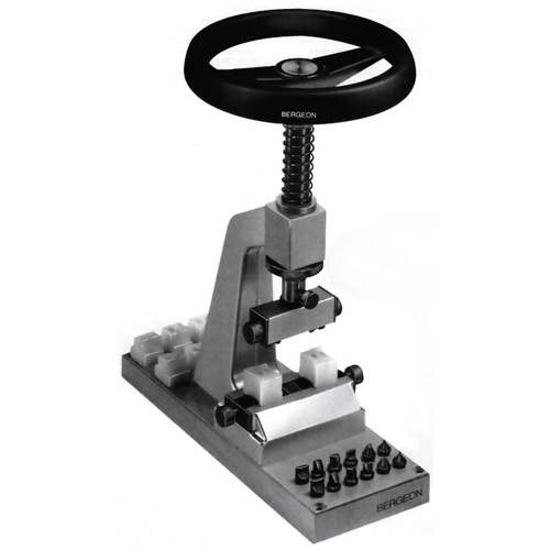

Then you might need one of these to hold the case in place safely.
Do not use one of these

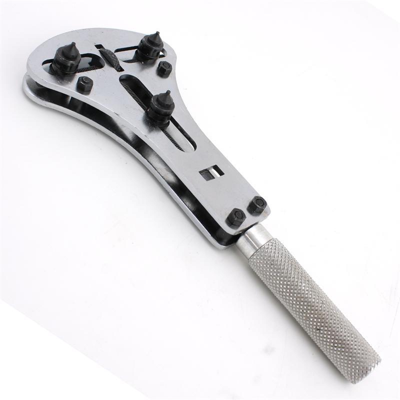

If you have to use a case wrench, use one of these
In the end, you really should use one of these

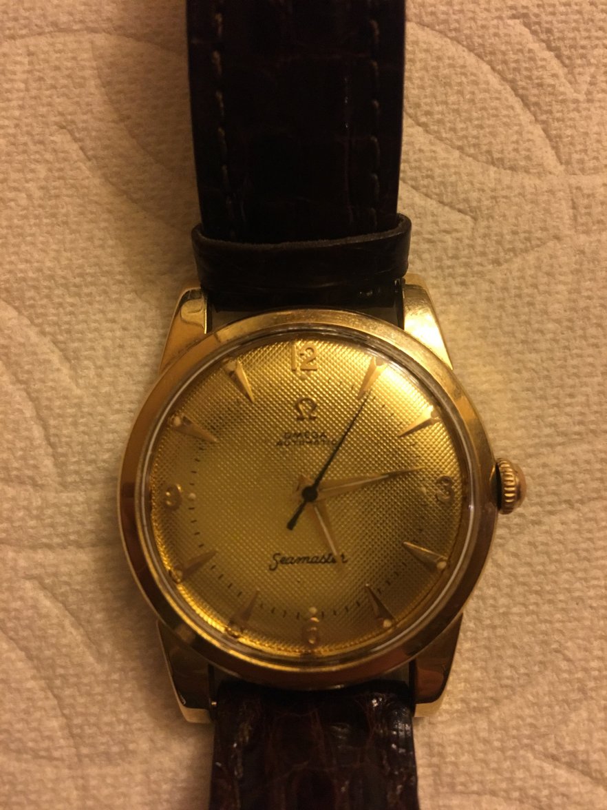

Thanks to all you guys lol!!!!! I never knew opening a watch could be so complicated . I’m a very diy person but with this watch I’ll put my pride aside and go to a watch maker. Thanks you guys! And one more question, any way of knowing what model or year this watch was made in without opening the back case? Thanks I’ve searched for months and haven’t found out...thanks agian to all

You'll be pushin shit uphill trying to use a Kong toy or a rubber ball to unscrew that caseback.
The retaining ring needs to be unscrewed with a Jaxa or similar. Balls and toys won't have enough purchase on the outer part of the ring and may only spin the caseback cap.
Of course it could work, but I'd use the correct tool.

I worry even when using the "Jaxa" style tool.
I wish I had the type you do, Jim! Looks more like this:

Bigger problem is the gold/gold plate. Very soft. When you lean on it, you make a permanent mark.
I believe it is a 1 piece case back. Did Omega make a 2 piece back in this era?
I hate this tool, I much prefer the small one with 2 claws, and once it's open, I only use the rubber ball.
