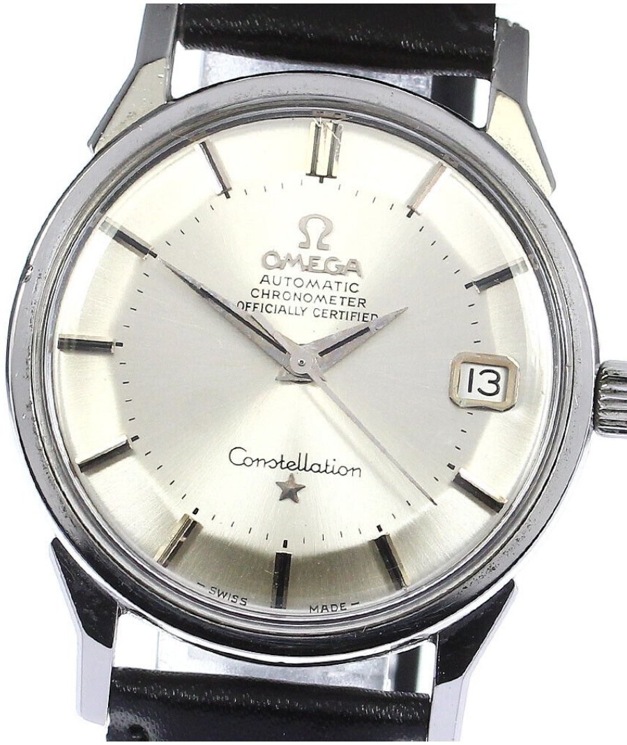

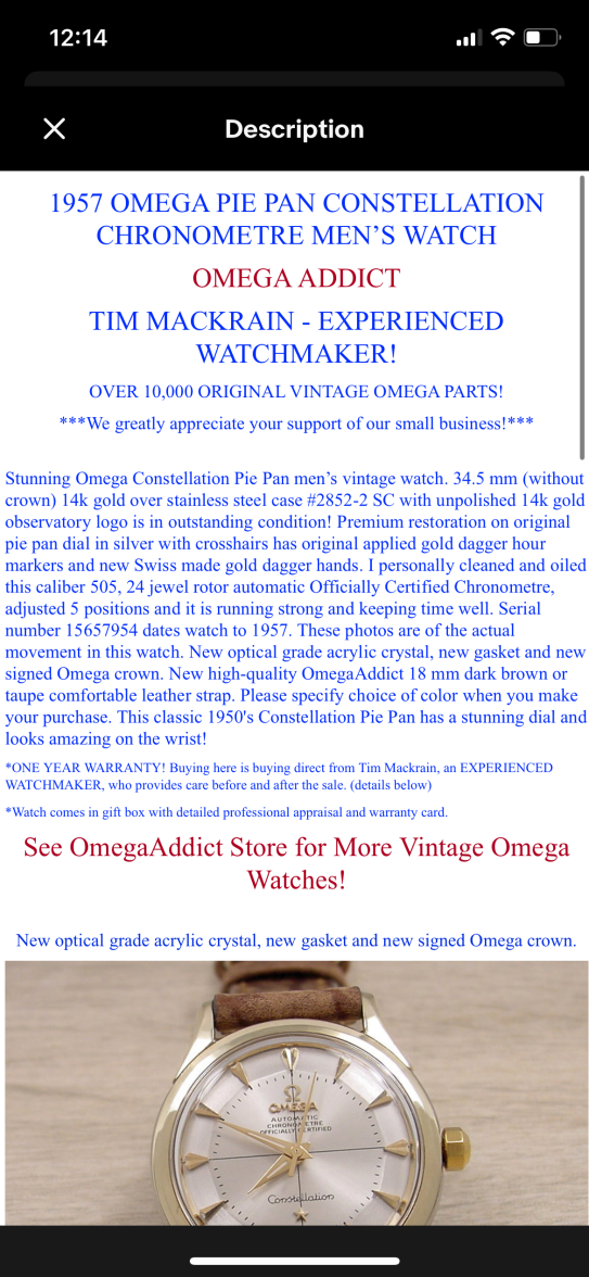

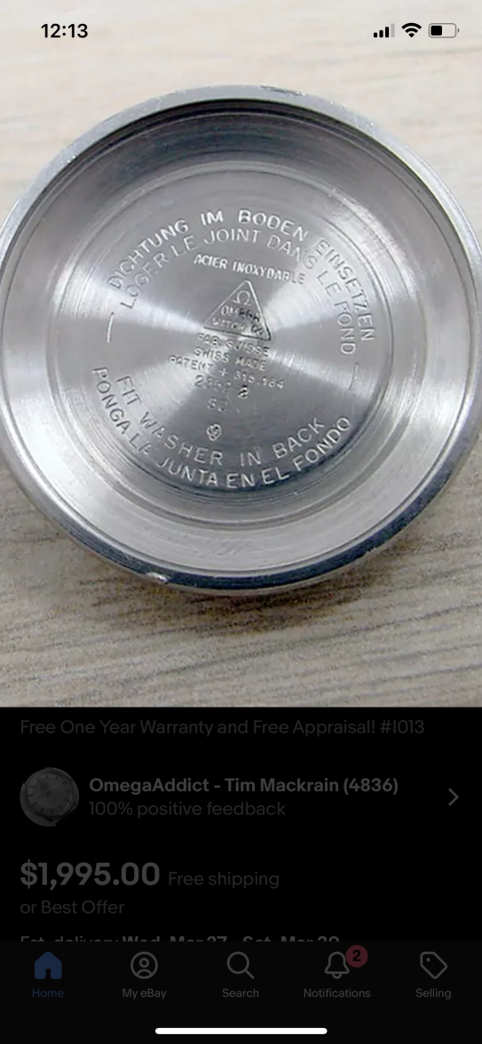

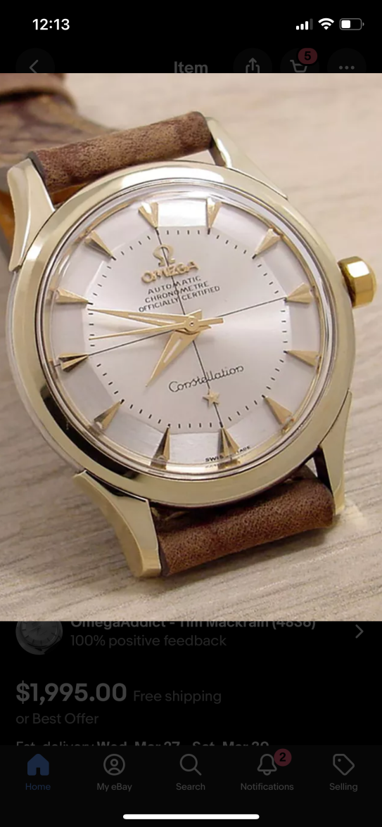

Anyone want to tear this one apart? The seller/watchmaker is up front about some “restoration”. Seen very few examples of the dagger hour markers like this but based on some of the comments of the other Closer piece, this too looks like another example of the markers coming out too far and it looks like some are not perfectly placed…
Tim has always been up front when dials on his watches have been redone.
He also has a good reputation for quality repair and service.

How would you feel about knowing a watch had a redial?
If originality isn’t your only concern, it would open up so many more options and most competitive pricing. But for me you can’t beat originality.

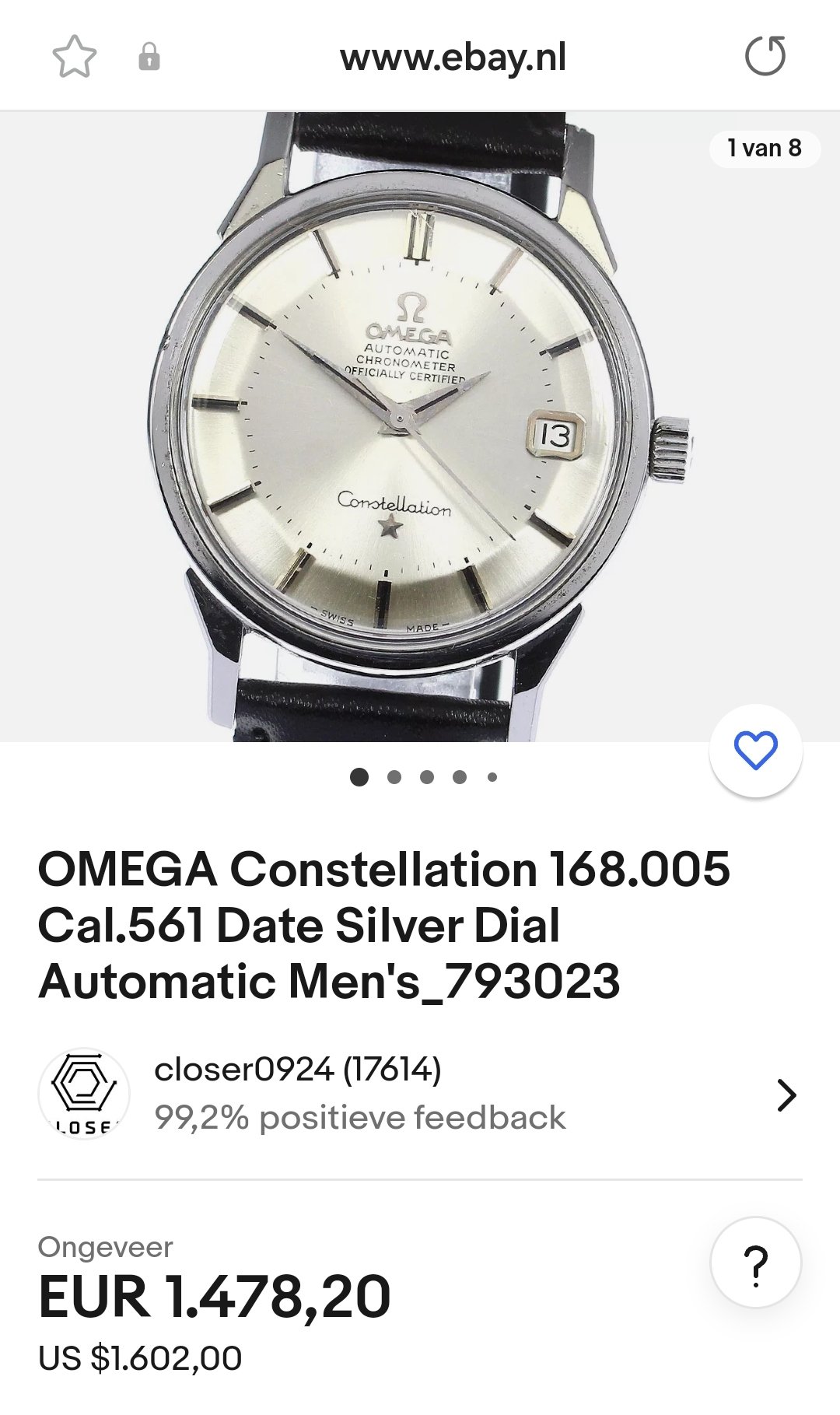

I agree the minute marks are too much towards centre. The cross hairs are too heavy and malaligned, cutting through the e. Swiss made looks heavy too. There maybe more wrong but I say redial.
1,079
2,250
The issue is not the center, but where it goes through the Constellation printing, which will not be affected by the angle, because the three points are in the plane of the dial.
Oh, I see. Makes sense.
6,852
10,538

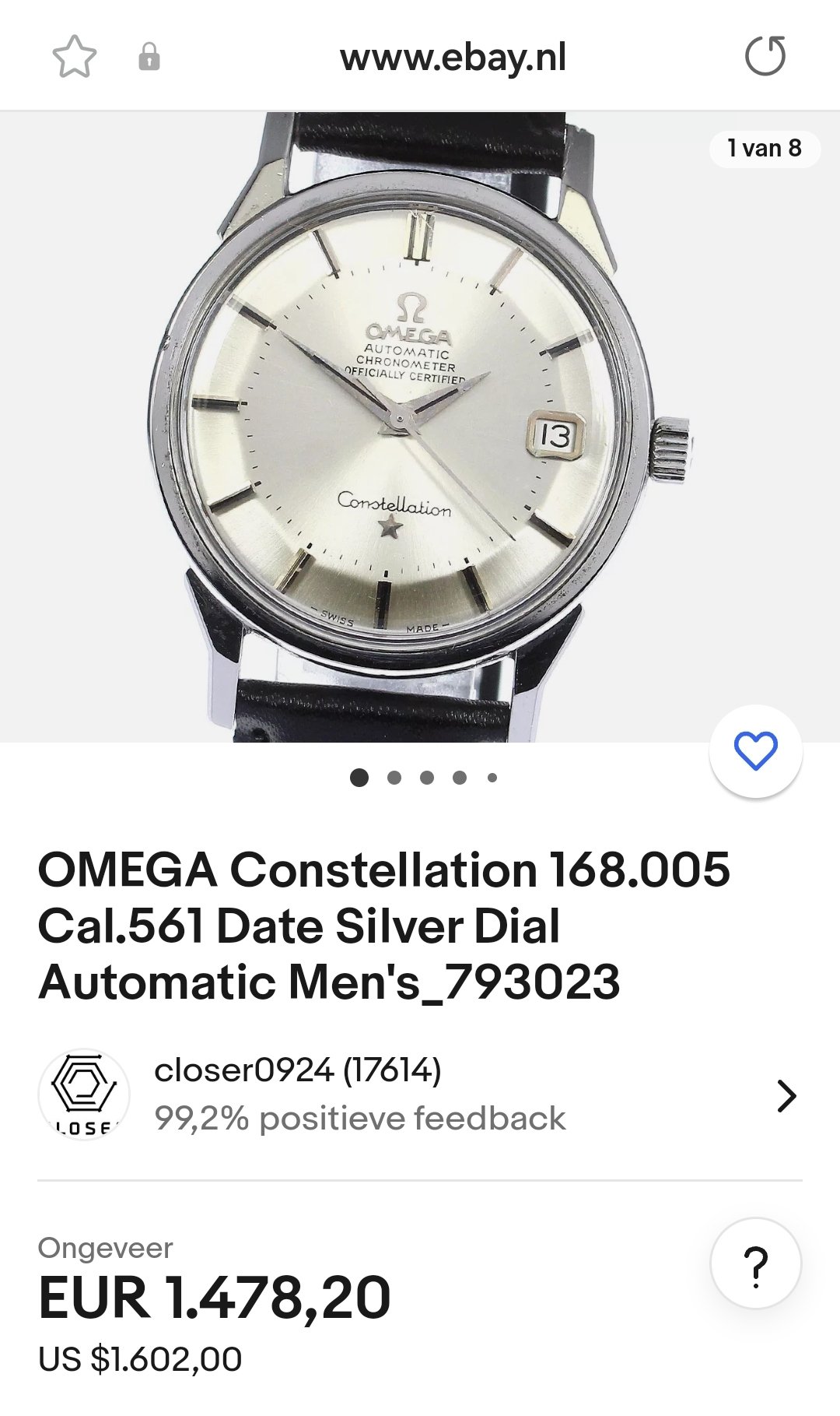

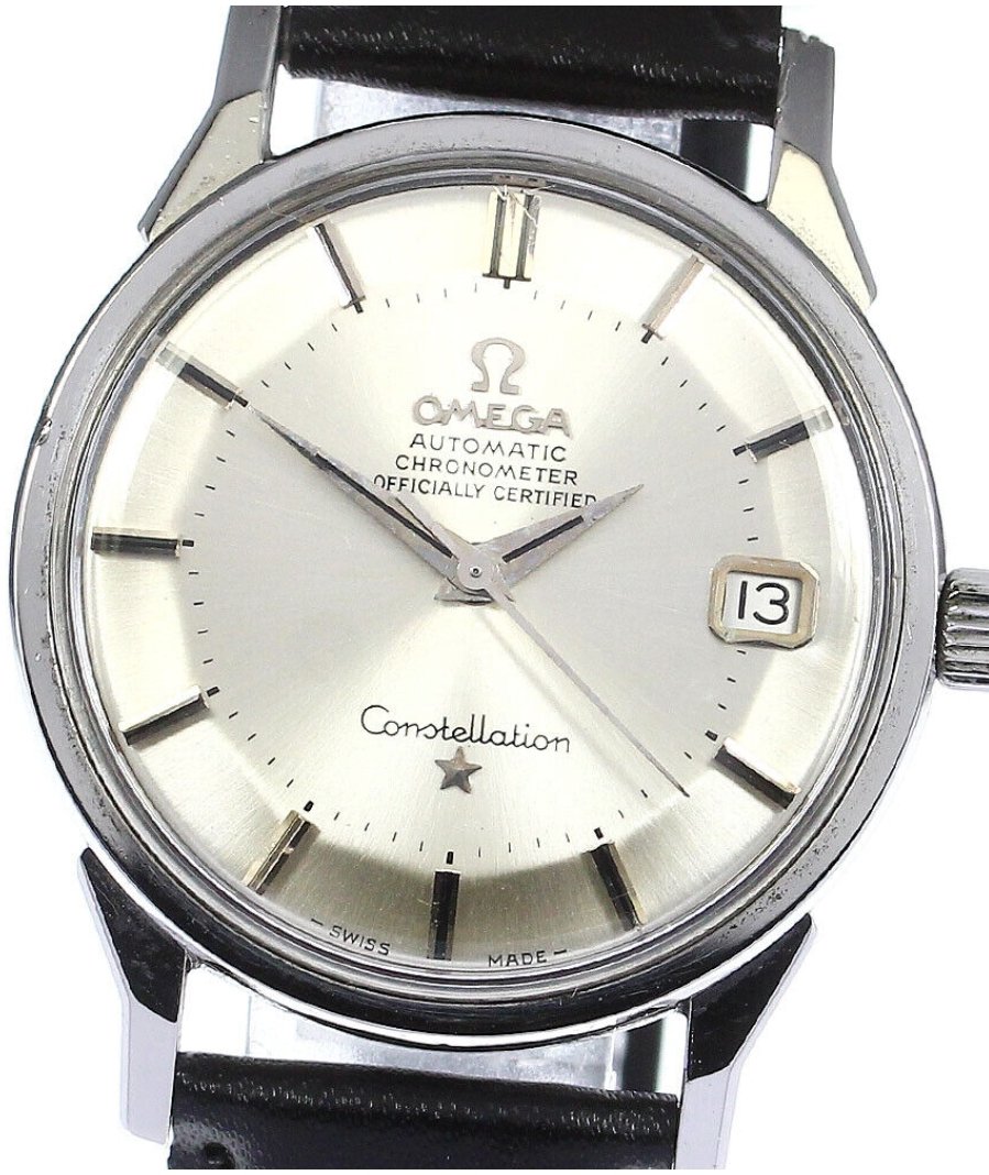

Today...
What do you mean? - Looks great!
Surely, the pissed as a fart minute hache alignment, incorrect lettering and the rounded edged pie-pan dial are just Omega quality control issues? - after all this was a long time ago and the Swiss aren't renowned for their fastidious adherence to rules and regulations.....
6,852
10,538
I contacted Closer and suggested that they look into this situation
I think you are trying to push water uphill....
This listed by Closer today. No mention of the dial being repainted.
They are a good seller if you’re an educated buyer.
this

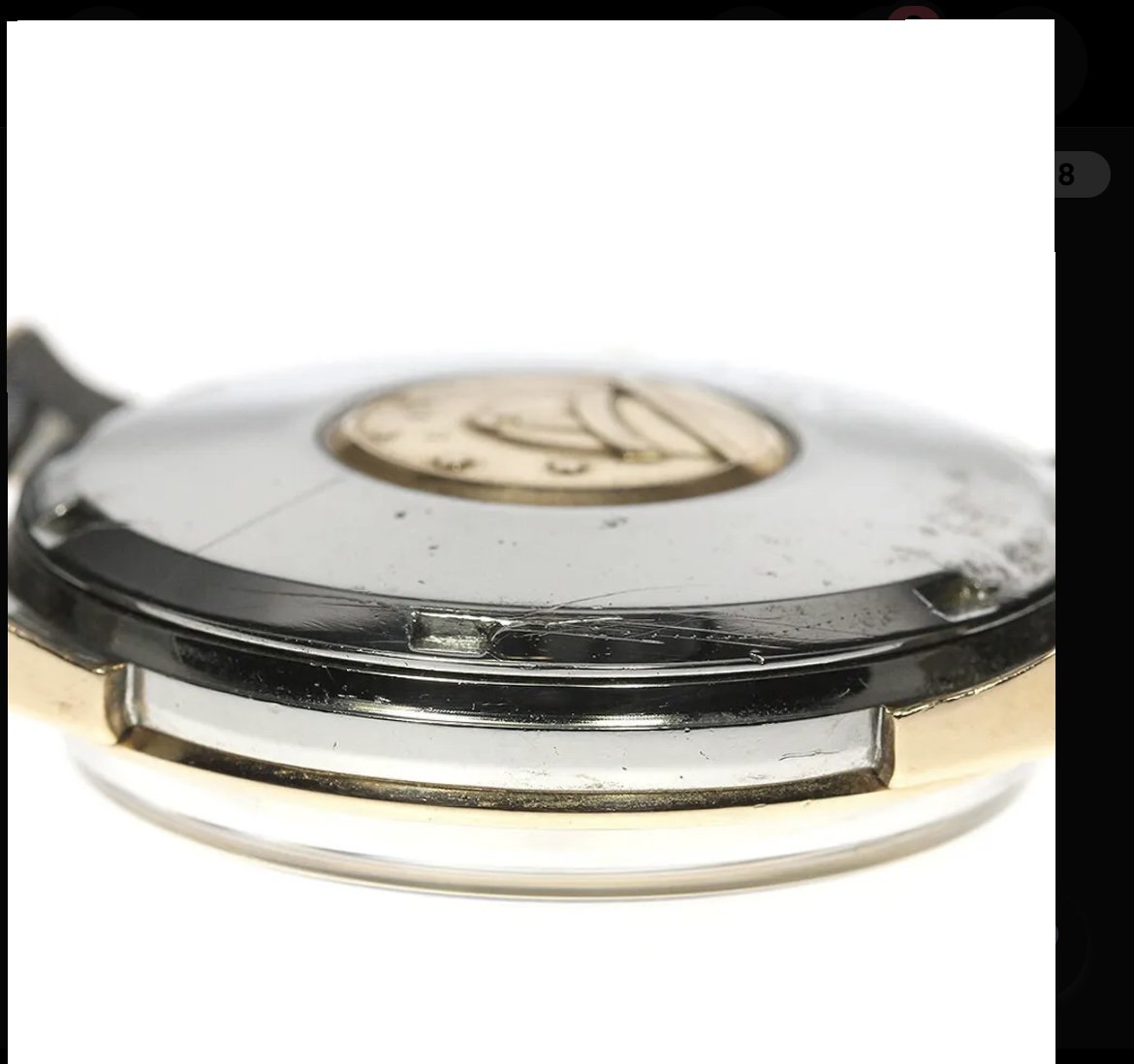

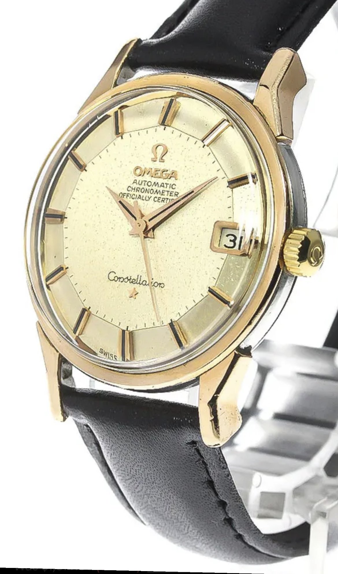

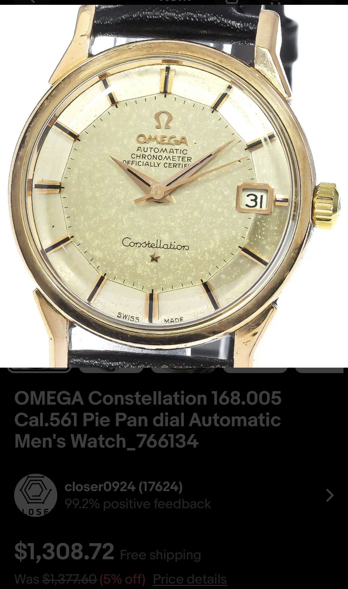

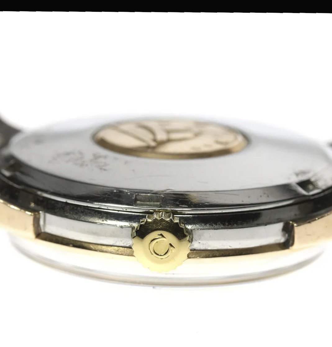

Any feedback on this one from Closer? Obviously some texture to the dial. Can someone provide insight on what that means besides some natural aging/“patina”. Water damage? Seller sights +48s/day so running a bit rough. Heavier scratches for sure than some of his other offerings and priced at $1300
13,685
19,062
That watch was ridden hard and hung up wet. The crown is modern and doesn’t seem to match the case. Lugs are very heavily polished and full of nicks and scratches. It likely spent many years on a one-size-fits-all Twist-O-Flex type bracelet.
I wouldn’t touch that one.
