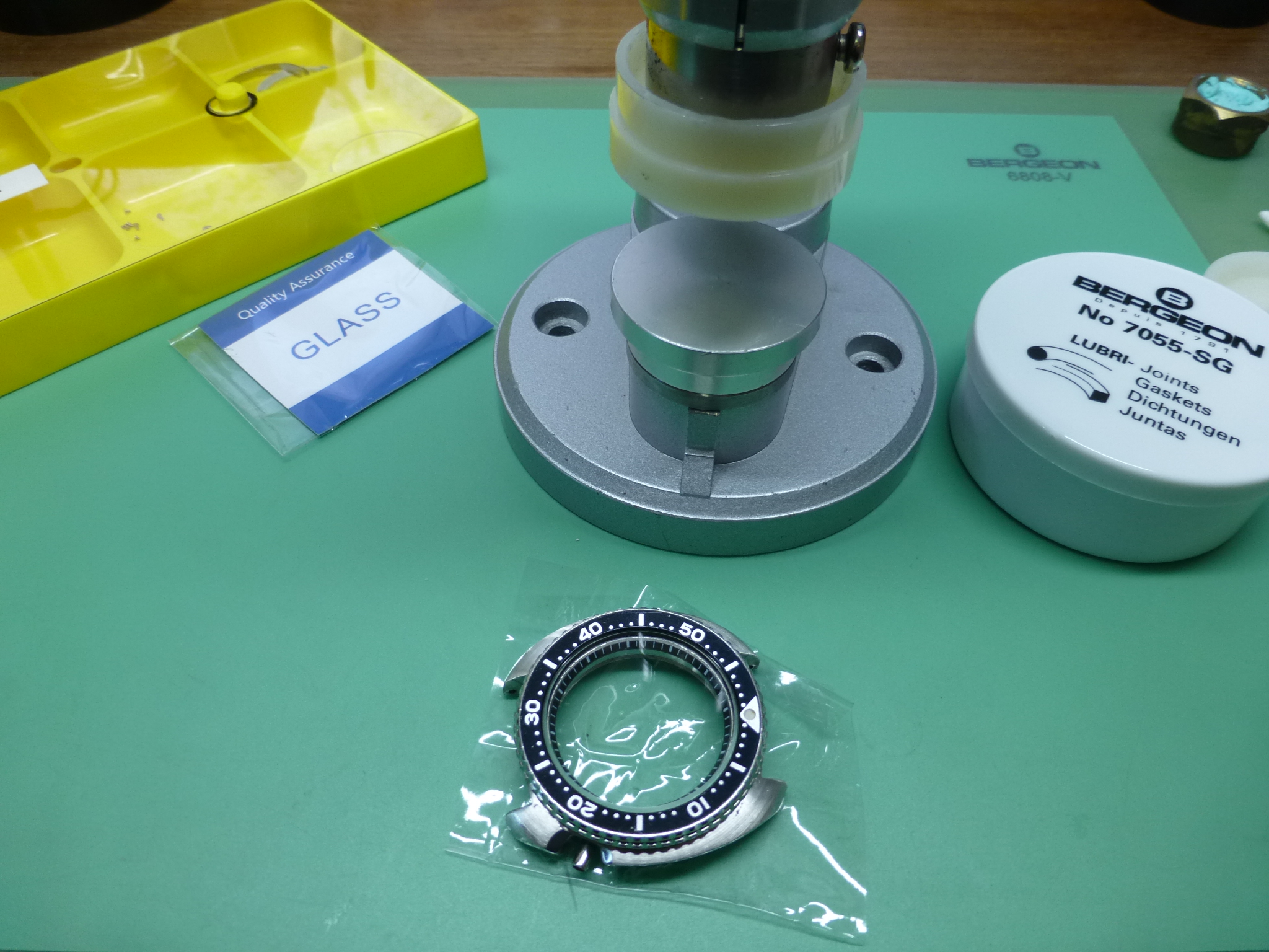

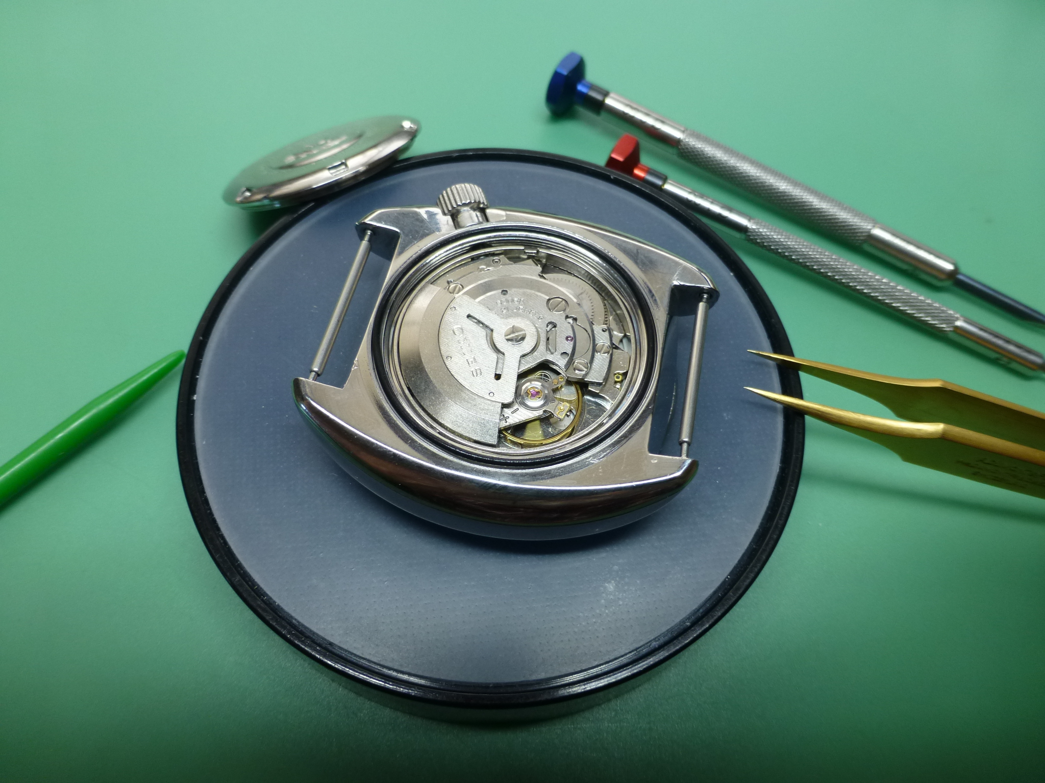

Case all cleaned and finish restored.

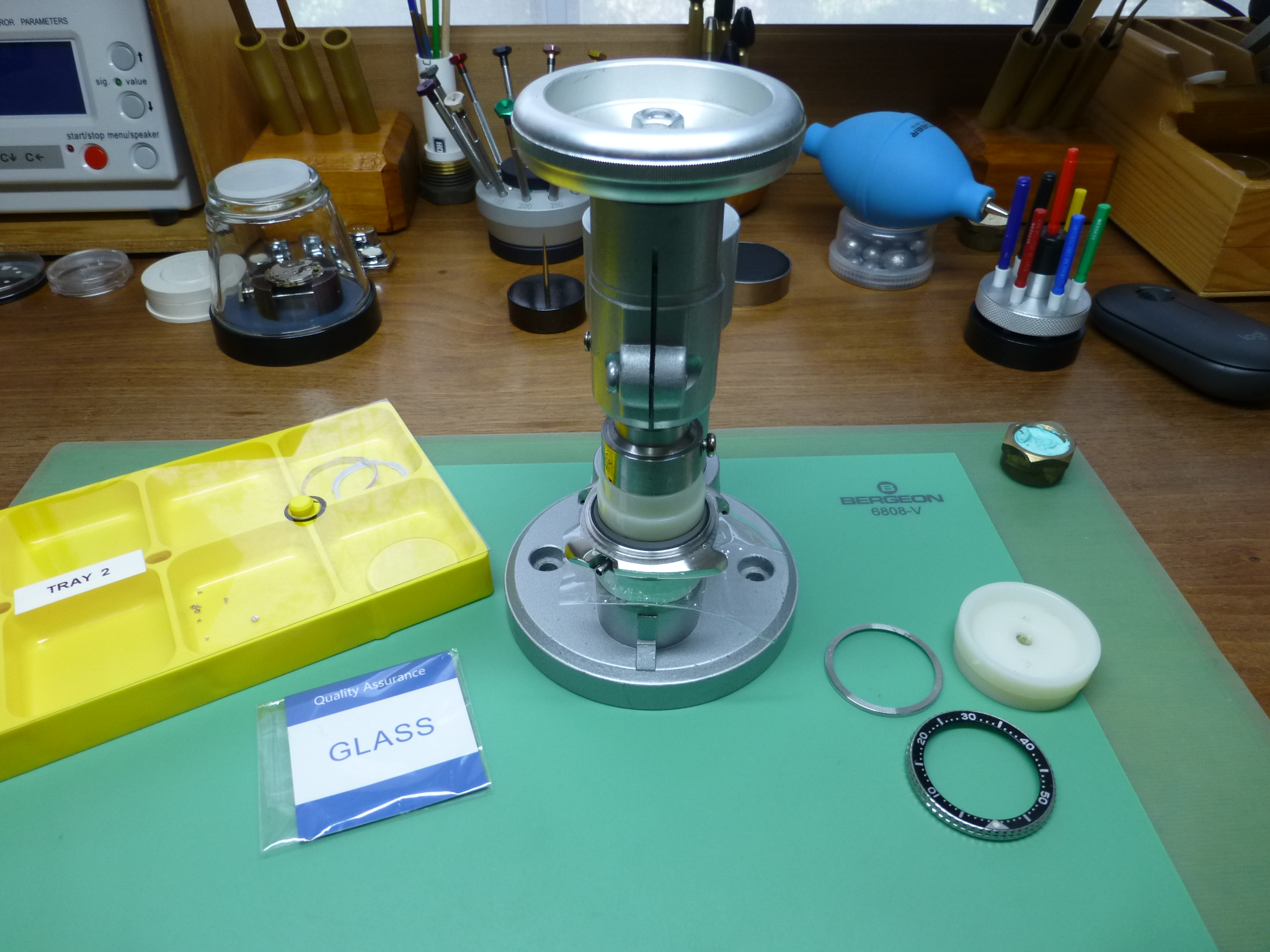

Pressed in the new crystal.
And then crystal bezel and top bezel.
All done, now to case it up.

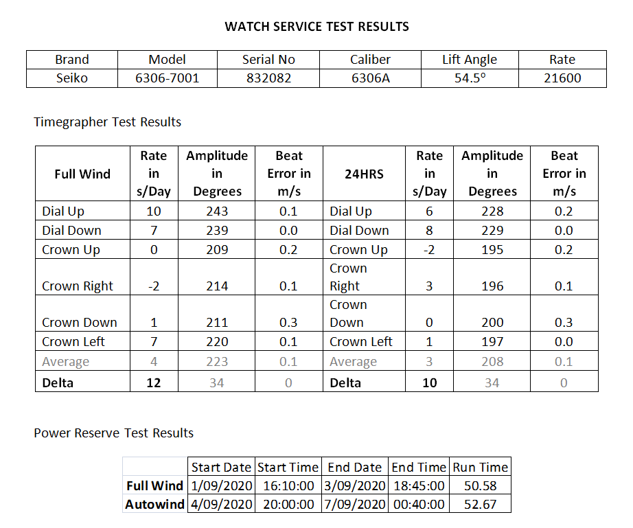

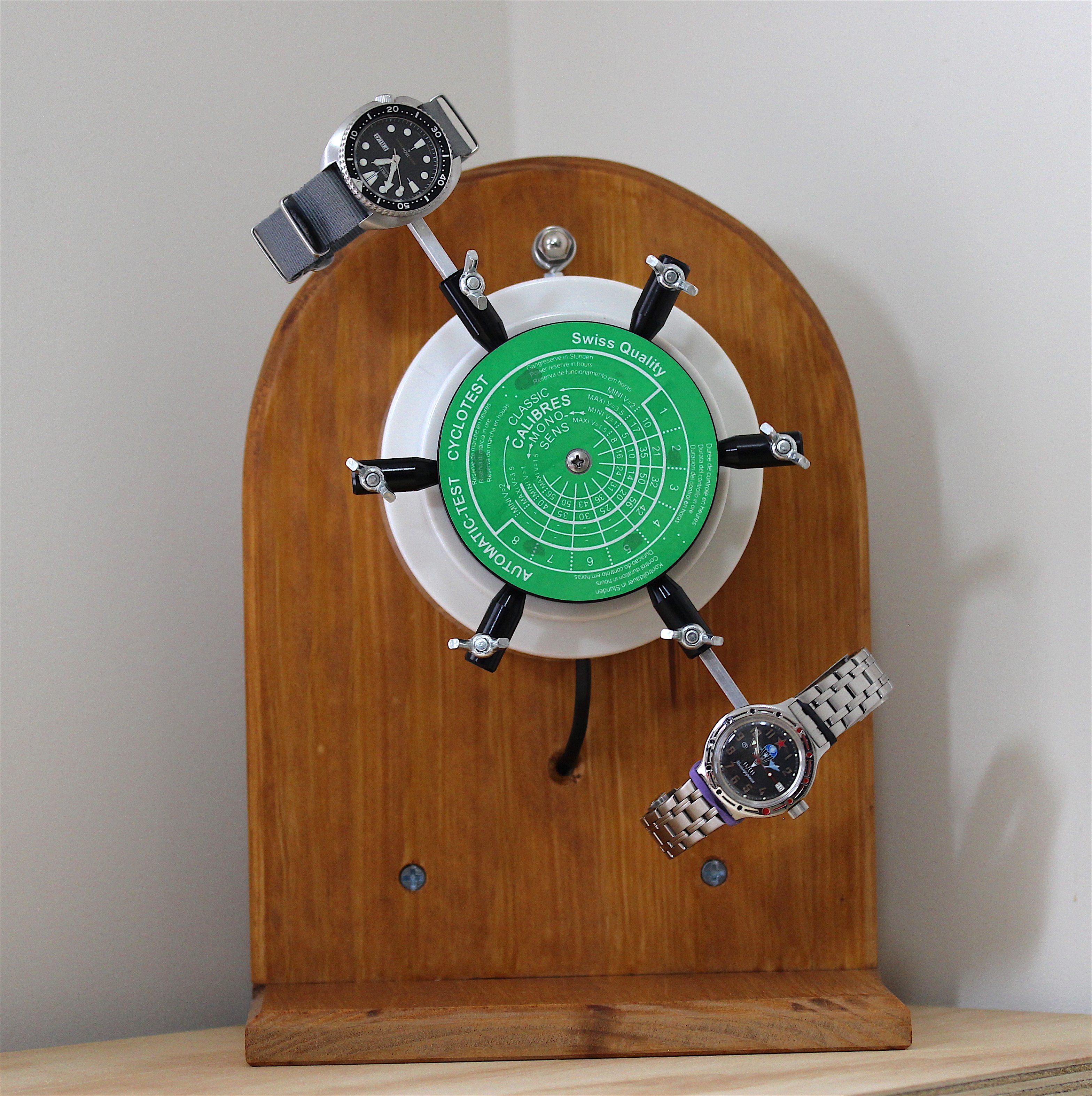

It took a while to finish the power reserve test after a manual wind.
I got 7½ turns from flat until the bridle slipped which is about right for this caliber.
The auto wind assembly was then fitted ready for a final test.
And here we are, doing the rounds for a few hours.

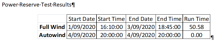

18,026
37,650
Whoops!
Forgot to close off on this one.
Here is a snap from the results document.
And a little video so the owner can see his baby is doing just fine 😉.

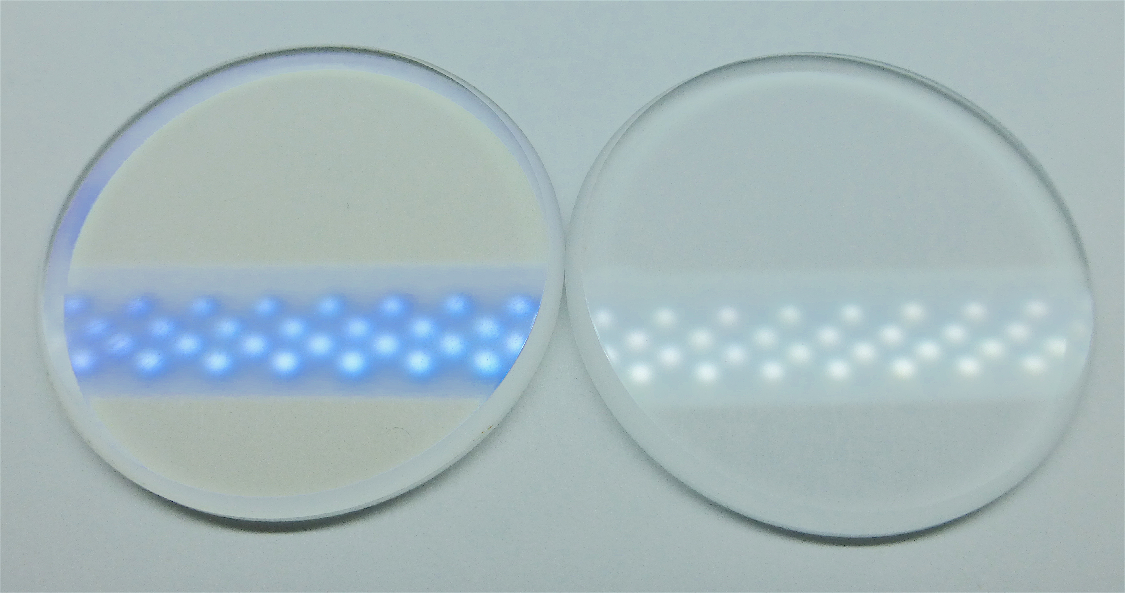

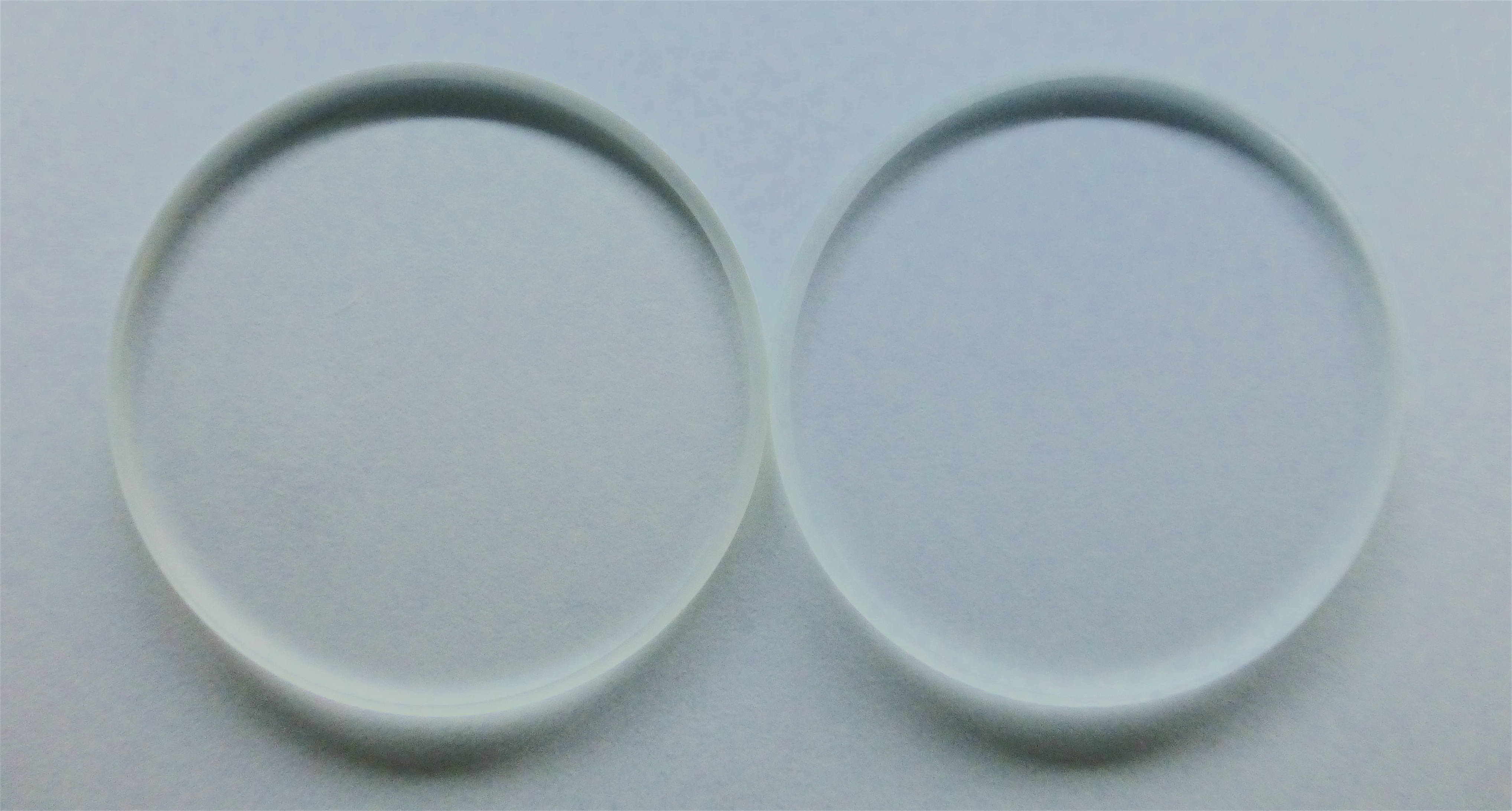

Quick question, I too have a 6306-7001 as well and the previous owner also swapped the original crystal for a domed sapphire.
You mentioned removing the AR coating, what do you recommend I use to remove coating or is it best to replace sapphire crystal with original?

I polished both sides of the crystal with diamond paste (0.5µ) but the crystal still had a tinge to it, so it was replaced with a standard flat crystal.
Here side by side after polishing.
And at an angle with the reflection of my worklamp showing the bluish colour.
1,430
2,957
Thank you for your quick reply. Yes, I best source a standard flat crystal and replace the sapphire. It's funny, it didn't bother me initially, but then the hazy blue view just started driving me nuts. Beautiful work
