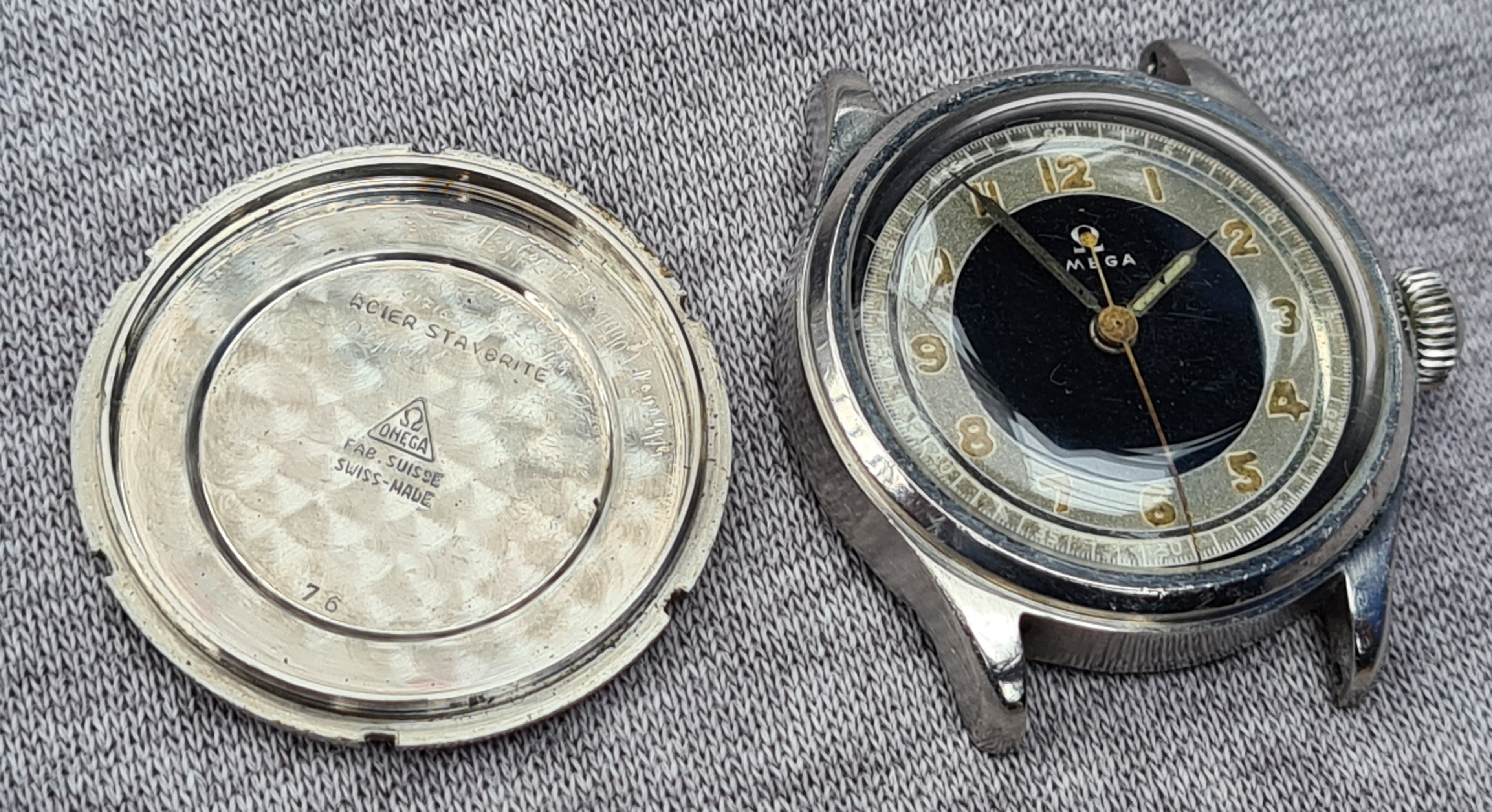

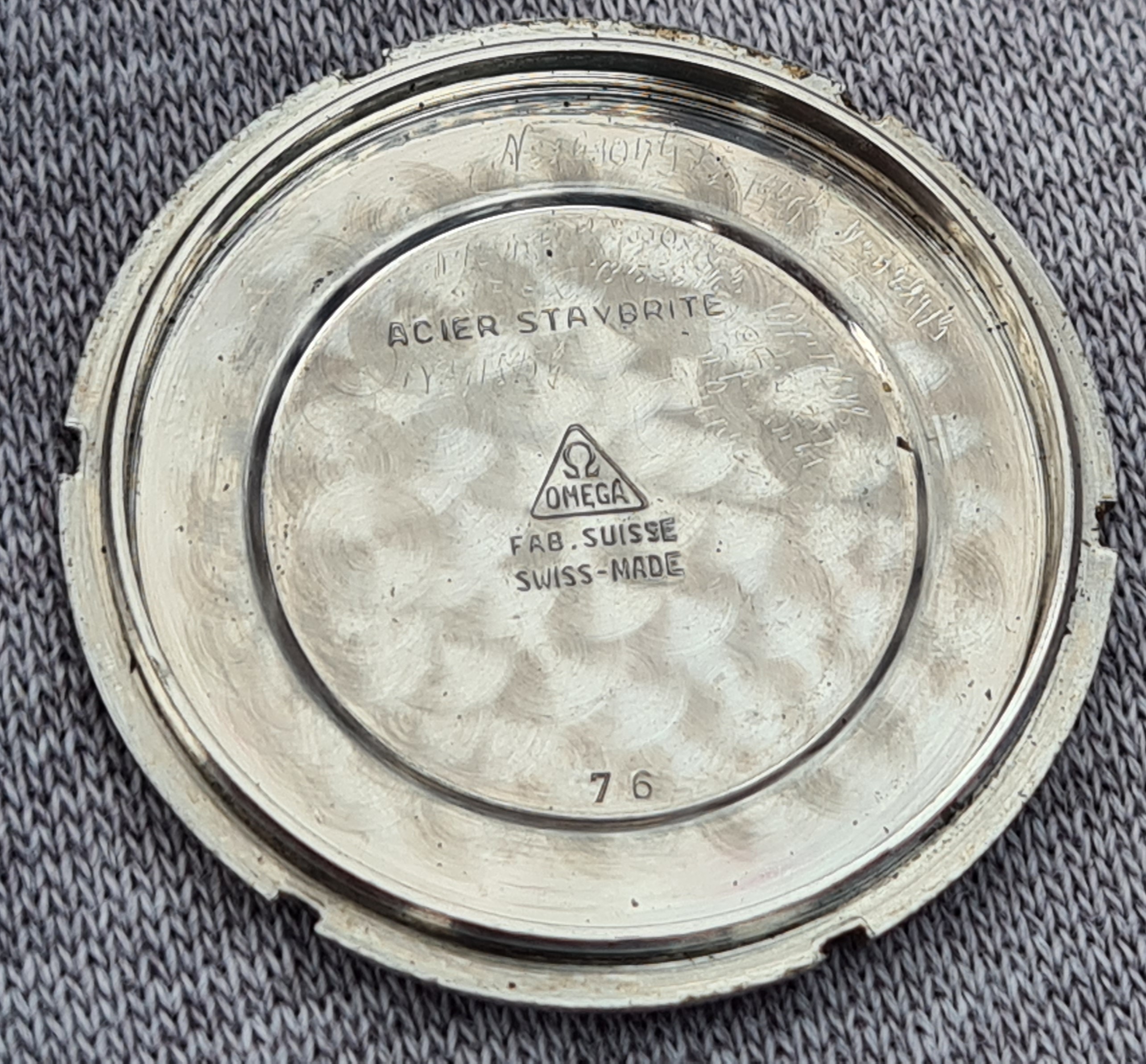

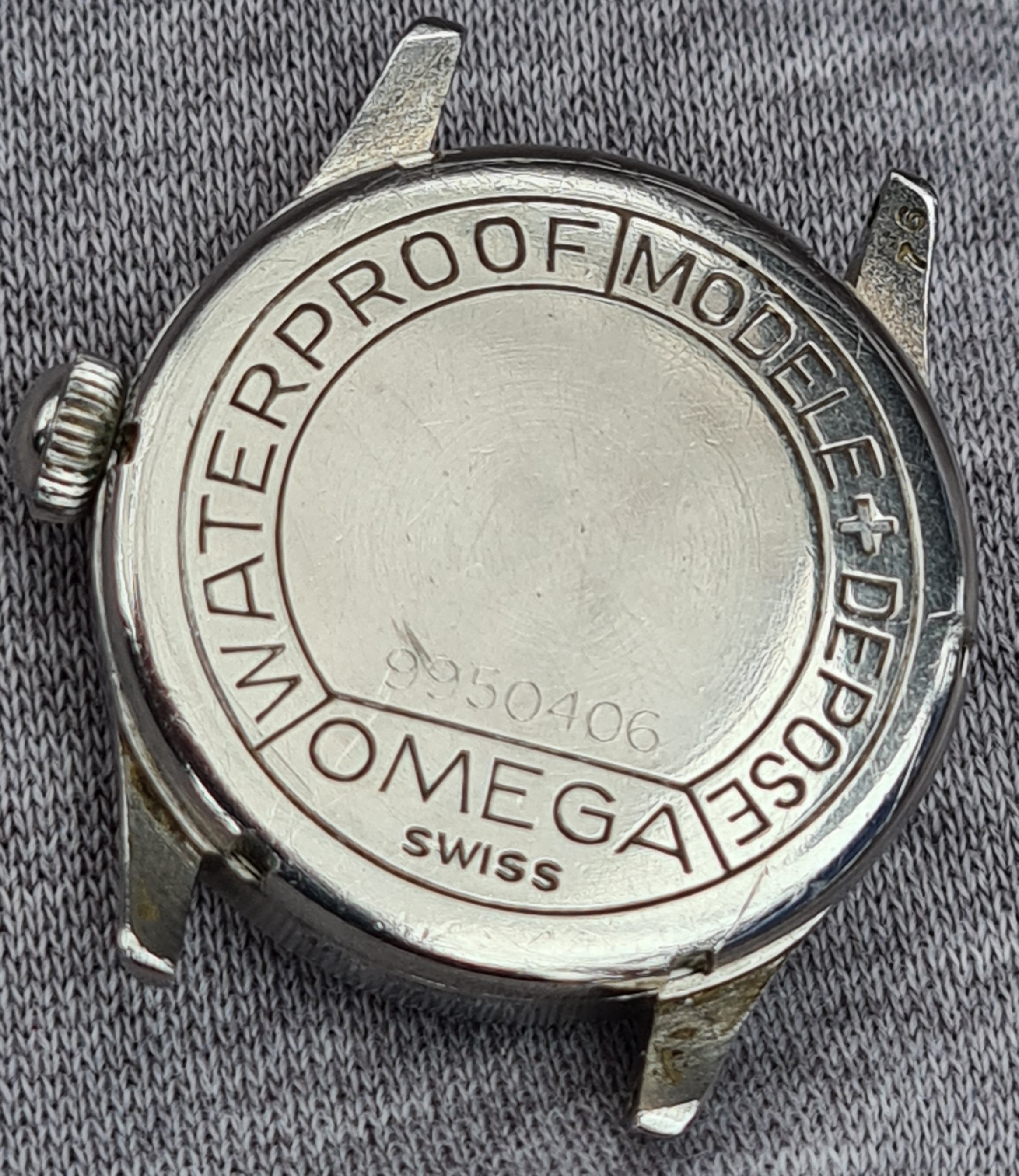

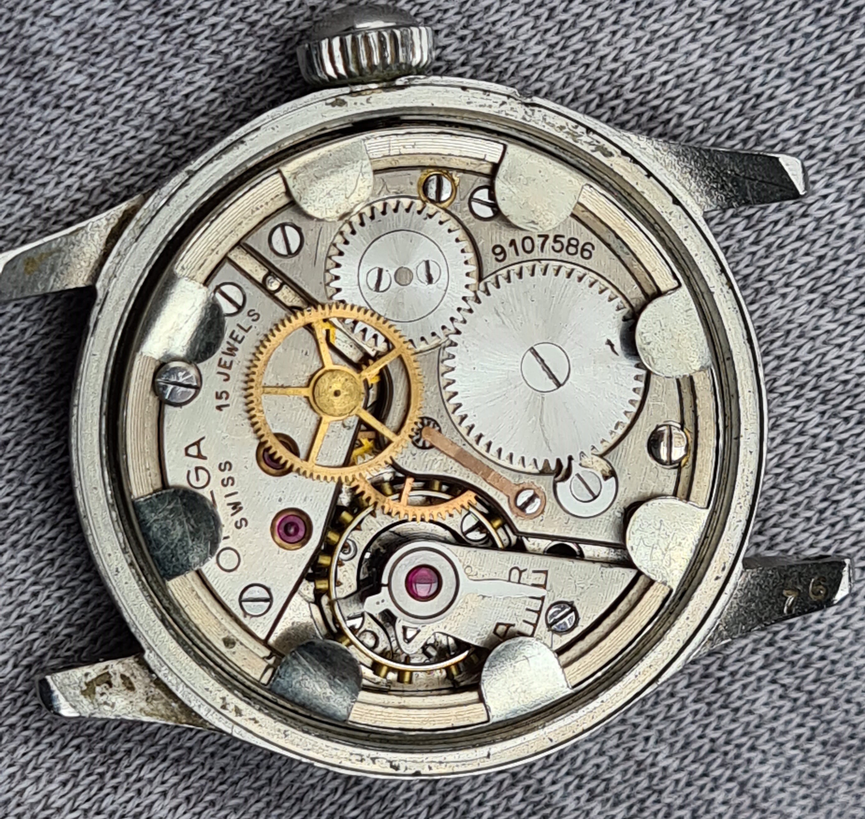

Hi,
Steel case.no: 9950406
Case no inside: 76
Movement no: 9107586
Any information is of great value
Regards Peter
1,884
9,610
The serial dates the watch around 1939/40 but I'm puzzled about the dial
1,349
3,738

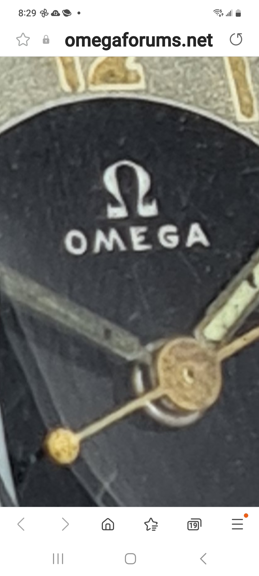

Ref CK 2120 (a later generation 'Naiad'). Cal 23.4SC inside. Serial dates it from around 1943.
3,653
7,770

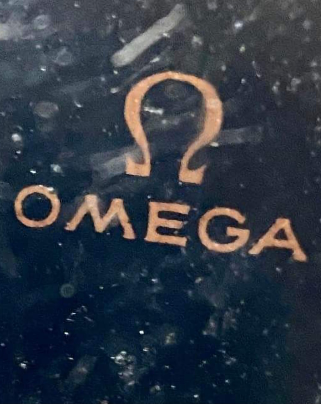

why are you puzzled? Don´t you like it? I love these multicoloured galvanic dials
1,884
9,610

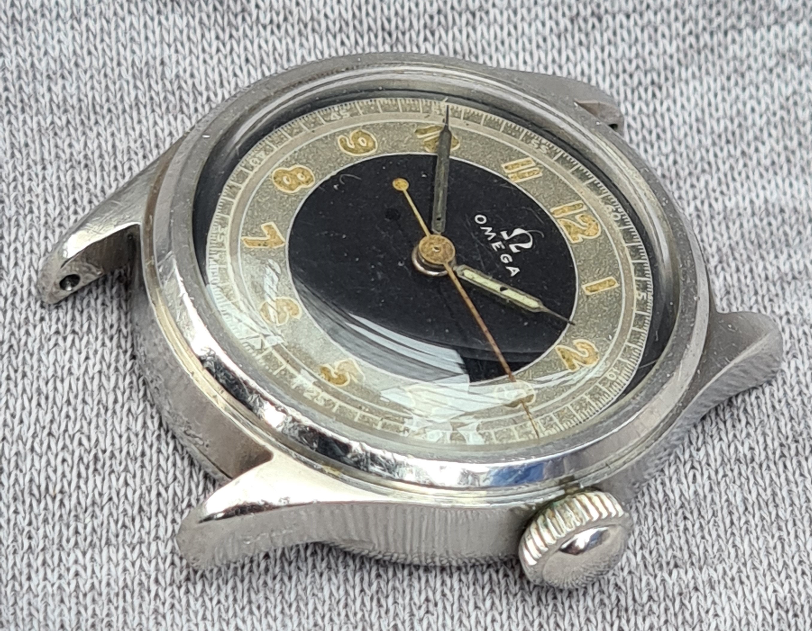

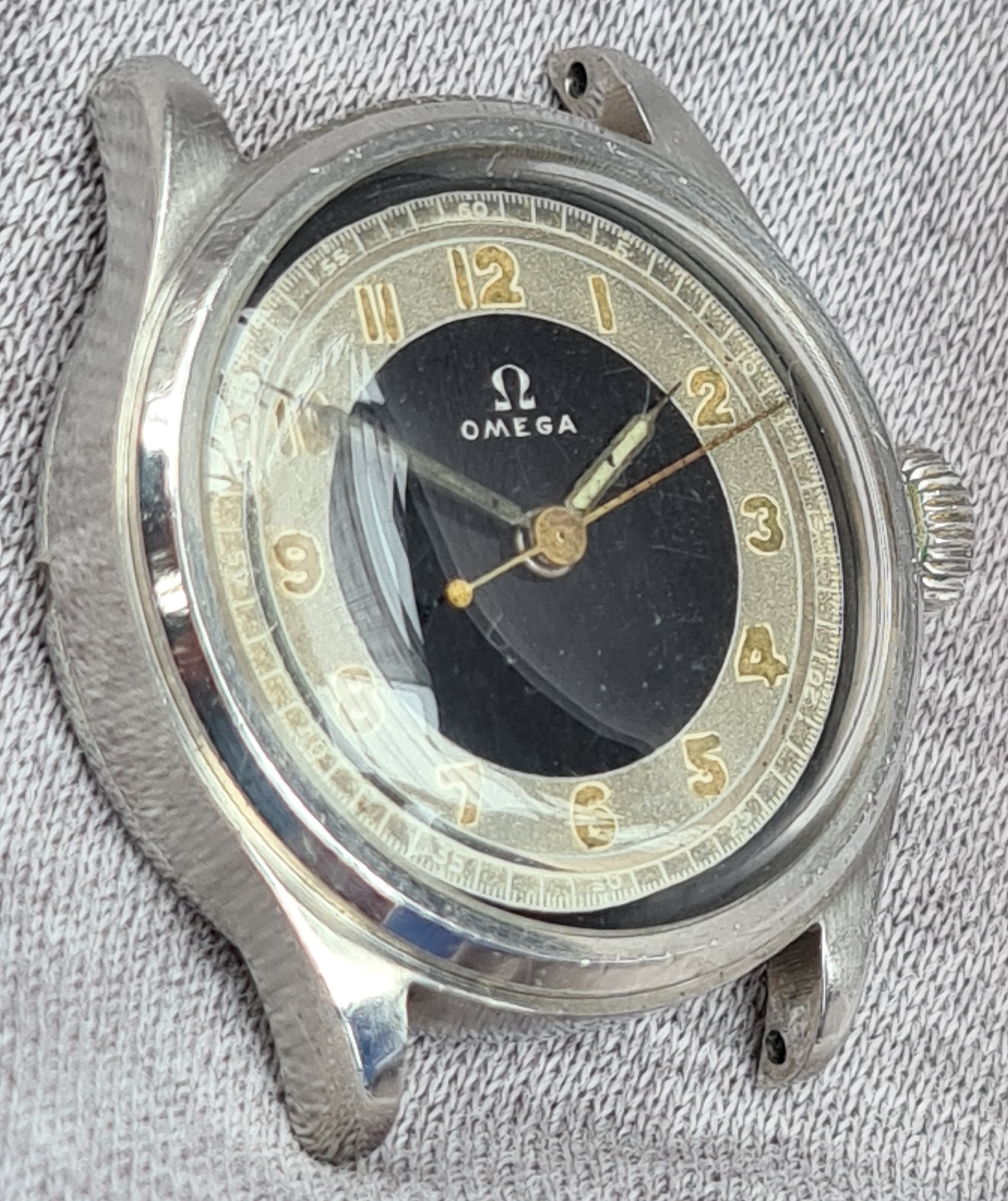

There is a lot (too much?) difference in conservation between the outer and the central part of the dial IMO.
Anyway I don't think it's a galvanic one.
149
239
How do you think it was made if not galvanized? Why do you think so?
I have seen already differences between darker and lighter colours in terms of patina. The reason i dont know.
It looks like a nice original watch in my humble opinion.
1,884
9,610
I didn't say that it is not original but that I am puzzled. May I?

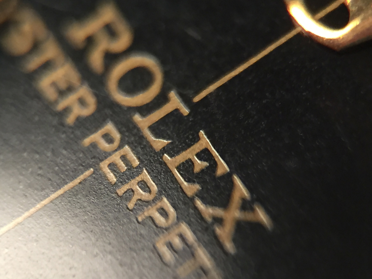

For mere example, this is how a galvanic dial looks like
24,837
55,258
Great photo.
