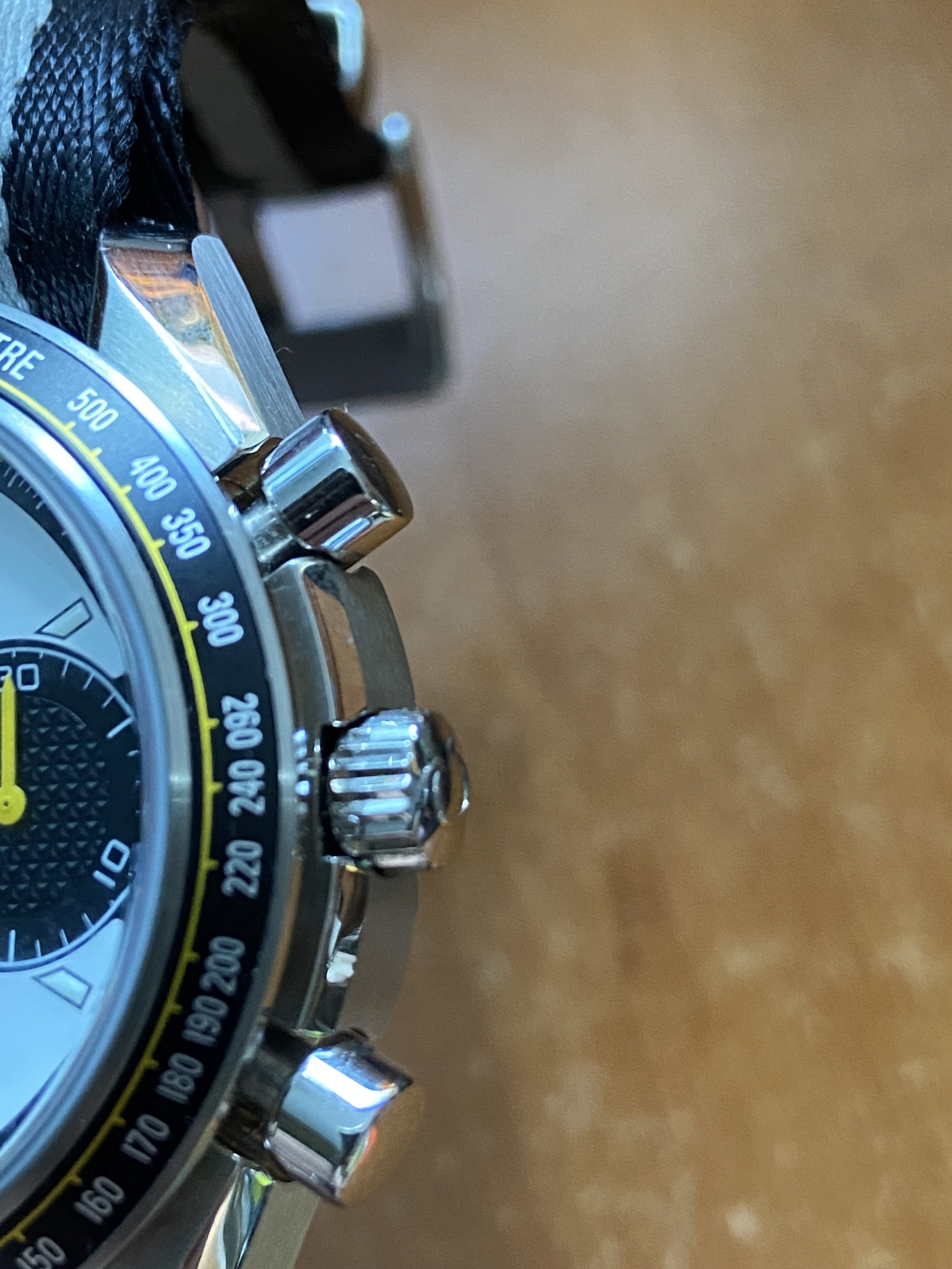

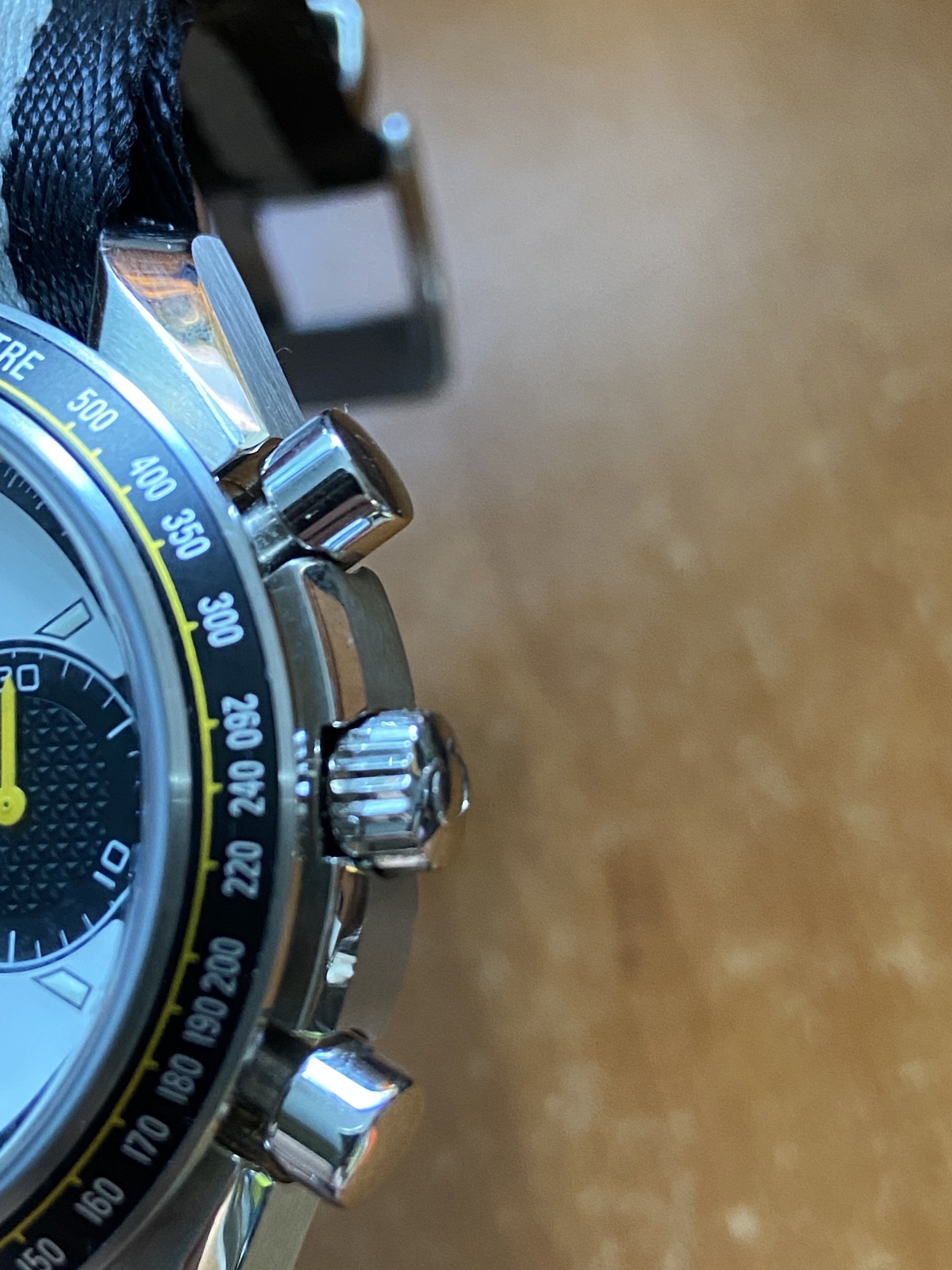

I also have a 3330. I know about auto-winders but I don't have one and I know the watch must be worn to keep power but I was wondering if it is normal for manual winding at the crown should be so stiff. I try to grab the crown with my thumb and finger but can only manage small turns because its so stiff. Is this normal?
2,816
3,747
yes, the winding on the co-axil movements is pretty stiff. Not sure if you are familiar with other movements, but it will feel stiffer than an ETA 2892 or a Rolex movement. Just part of the design, so nothing to worry about.
