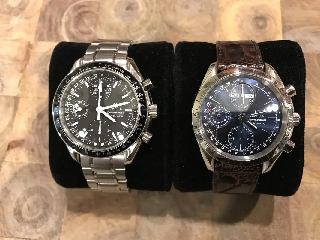

I have a couple of Triple Dates and have noticed they needs at least 8 hrs of wrist movement to keep the correct time too, it takes a lot of motion to keep them fully wound I've found.
Threads suck without pictures:
