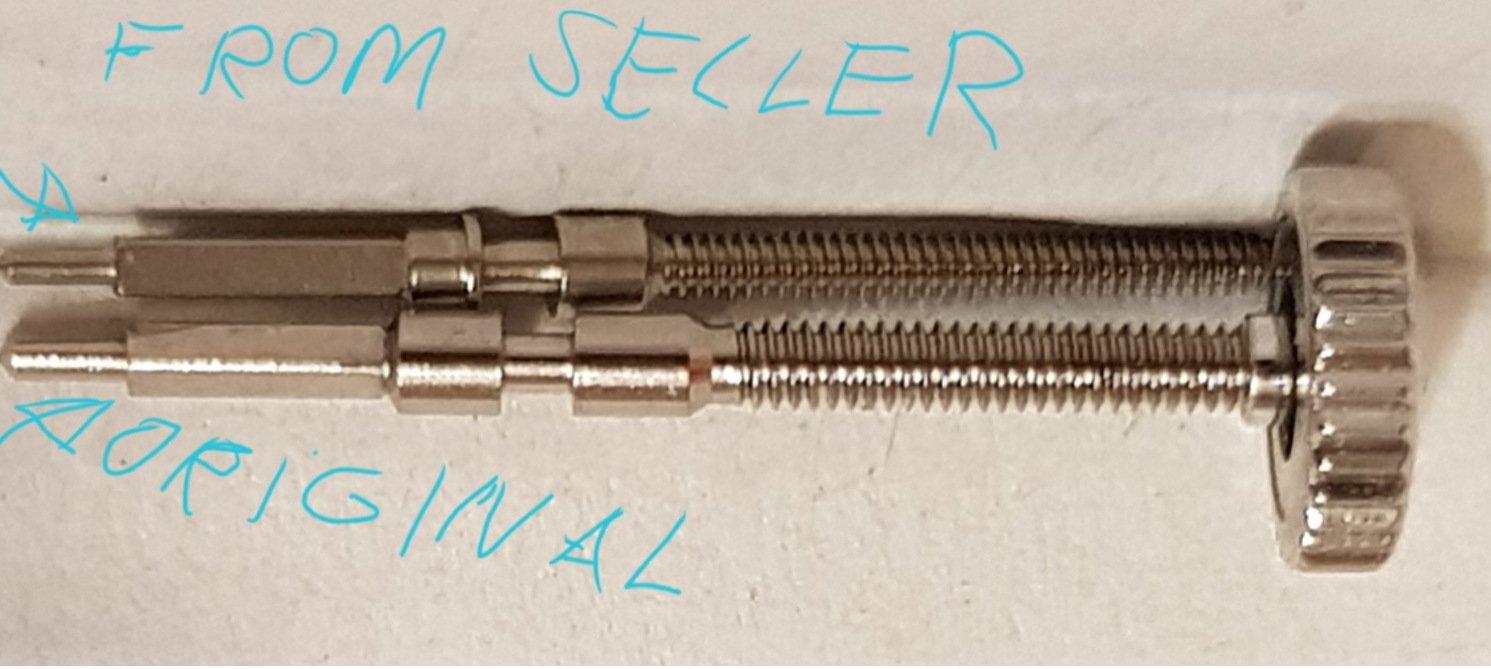

Hello everyone!
Can anyone identify the winding stem?
I ordered from a seller on Aliexpress, he was supposed to send a winding stem for omega 30t2.
In the photo you can see exactly what he sent. Perhaps this is the winding stem for another Omega model?
(The seller returned my money for this order and does not want to answer, of course))

Are you needing a new stem because your sample stem for the 30T2 is too short? If that is your only problem, a stem extender may be your answer. If you are needing a stem because you need a stem for a second 30T2, an extender is not the answer. I believe the Omega 286 stem might be the same stem.

No, I have 2 movements, one with a winding stem and the other without it. The one in the photo below, with the winding crown, is from my first movement, the one in the photo above is the one that was sent to me. Its configuration is different, it is inserted into the movement, but the width of the threaded part is smaller, and the configuration of the part that is inserted into the movement is different. It doesn't suit me, but it's a shame to just throw it away. Perhaps it fits another movement caliber. There are many highly qualified specialists here on the forum, and I assumed that at first glance they would be able to determine its affiliation.

I’ll check my stash. I’m certain I have that stem. But before I waste my time, please give me the metric measurement of the square, and the hub. Once you give me those numbers, I’ll check and get back to you.

It looks like an 861 stem they sent you. The Omega parts number you want is 72202601106.

I have stems for 330,470,500,550 etc.
They are all different. The setworks uses common parts. The plates are drilled different.
I have ordered Val-22 stems and recieved Val-23 stems. Sellers only go by what is written on the outside of the box.
I also seem to have a lot of 320 stems for some reason, As well as the ladies stuff.

This seller sold stems for various Swiss movements, but newer than 30T2. The stems themselves may be Chinese, but the main thing for me is that they fit. His reviews were good, he actually sent what we ordered. Maybe he really just made a mistake, but I wouldn't send stem back to China anyway. And Aliexpress returned the money to me.

I once ordered a winding shaft for an old FHF movement, and the Swiss seller sent me the wrong one. As it turned out, FHF had 2 calibers with the same names over the years - one for pocket watches, and the other for women's wristwatches.

I am confused! One stem in your opening post had a crown on it, and the other didn’t. I was under the impression that it was the one with the CROWN you were trying to duplicate. I’ll check my stash anyway.
Sorry, I just didn't explain it very clearly

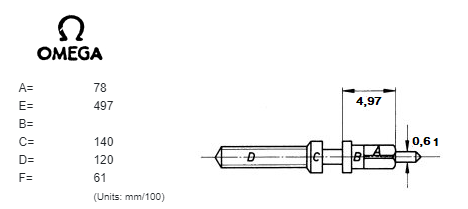

All I need is a picture of the stem you NEED, and metric measurement of the SQUARE, and the HUB! Don’t send a picture of the INCORRECT stem! If I have one, (I think I do), don’t worry about paying for it. It’ll be free.

Тhanks! I found these dimensions: (I think this will be more accurate than my own measurements)

I see that not all sizes may be here, I'll try to measure it later
