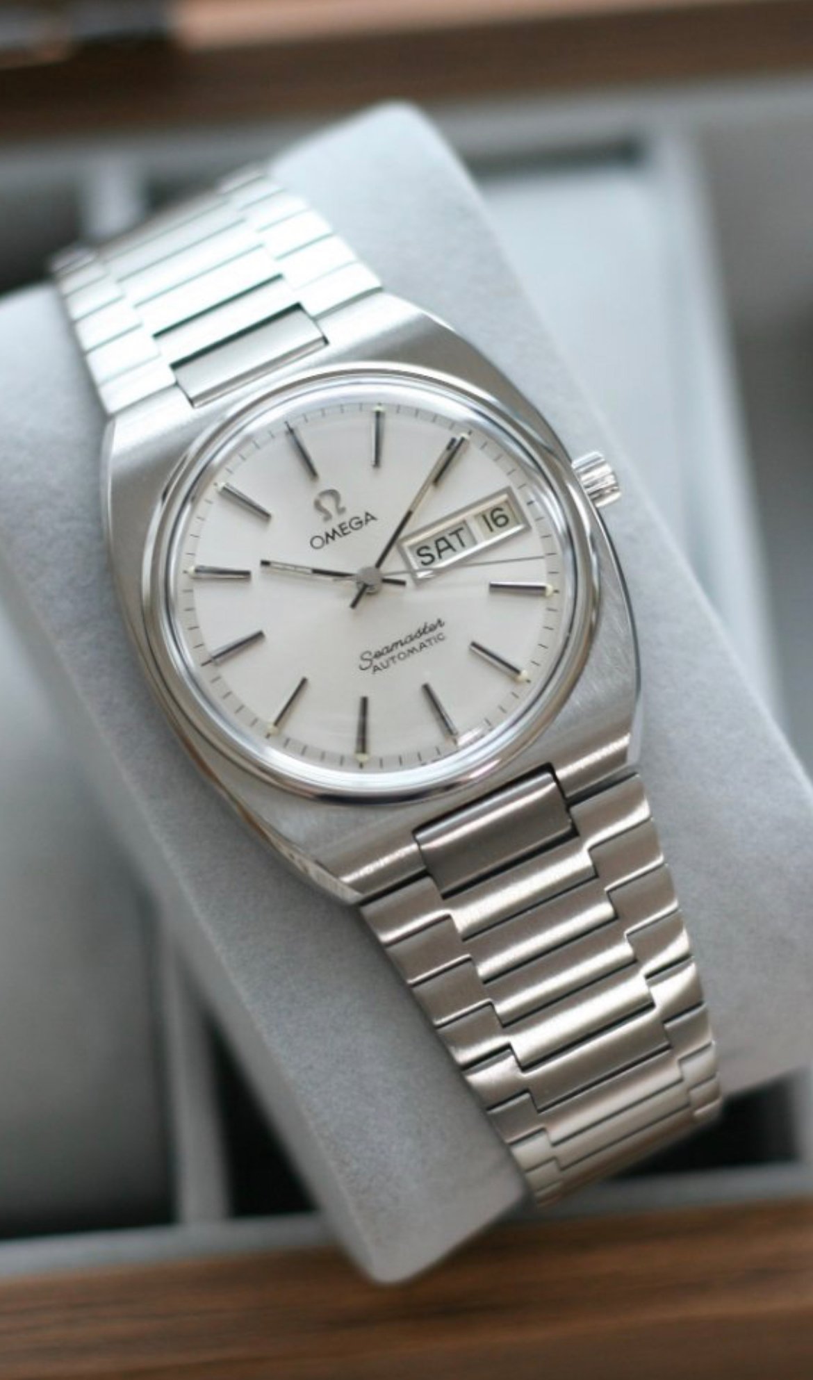

I just bought a supposedly serviced vintage Seamaster from Chrono24 via a Korean seller and low and behold it wasn't serviced as the listing had stated. Its very crunchy when wound and as the seller knows he's in the wrong he's offering me a $100 refund. I know that's too low, but just wondering what the a good ball park refund might be ?
Im aware Im taking a risk as who knows what's wrong with it, but I think Im happy to do that for the right refund as the condition of the watch is outstanding.
Picture of the watch attached - I think its Ref 166.0216 - Any help is greatly appreciated

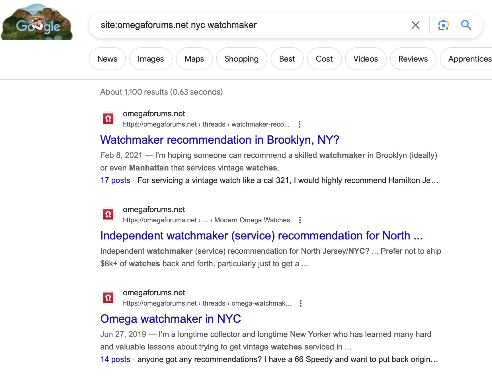

In your place, I'd just send it to one of the frequently recommended US watchmakers by searching the many previous threads on this topic. I don't recall any NYC watchmakers that really get particularly strong reviews; they generally seem to be mediocre and overpriced. Fortunately, there's no need to limit yourself to a local, or to recommendations from the small subset of members who might contribute to this particular thread. It's not a particularly valuable watch, so not difficult to ship.

I'd return it if possible. Not sure on the movement, but crunching could be the reversing wheels for the automatic which could need lubrication or replacement
Called winding gears
Just a wild guess. Had similar problem in some movements
After what you paid and to add a further cost on top. Might be cheaper to return or ask for more money to offset the service cost

Thanks Don - obviously $100 is no where near enough and Im suspicious that the seller doesn't already know the problem as any watch maker would know that it wasn't right within 2 seconds of winding.
Im going to call Chrono24 today and see what my options are, but I paid for a fully serviced watch in top condition, so to then have to go and spend $300-600 extra is clearly crazy.

Ive only had one reply from Chronotekinc, keep in mind the watch is worth $1150-1550 new in the condition its in. I paid $1350 with tax and postage included on the basis that it was near mint condition externally, polished but very sharp and importantly fully serviced. Luckily the seller has been recorded as saying it wasn't serviced in our Chrono24 chat so it is now fully on them and the money is still being held in Escrow.
Their reply - looks like its going back on this basis:
"James, we appreciate you contacting us in regards to your Omega. We would be happy to look at it for you. Typically this model will run $700 to service which includes most case and movement parts as well as a 2 year warranty. This is an older caliber and the symptoms you described are common if they are not serviced on a regular basis. If you are interested in our services you can make an appointment to visit our workshop or ship it to our address listed below. If you decide to ship your watch please enclose your contact information such as email, daytime phone and return shipping address. Should you have any additional questions you are welcome to call or email us."

Thought Id give a final update on this to help anyone out in the future
Full list for anyone looking through the Forum desperately wanting a list of New York Watch repair options here's what I found:

I hate to meddle as I don’t know anything about Omega, but are you sure this watch is worth 1000 dollars and that the dial is original? That picture was quite fuzzy.
Sorry for raising such questions, but if returns are possible, the time to find out is when you can still take action.

Pretty standard model, matches everything you see online, prices are well documented $750-1300, maximum $1550, watch maker reviewed it and its all good so not sure why you'd be skeptical.
These vintage Seamasters are fairly common, its a late 70s early 80s model, they don't have a huge fanbase but they've stared to have a little more attention. I personally think they're a great looking watches but you've got to like the vintage aesthetic.
The bracelet on them is average at best, the watch overall is nowhere near the quality of a traditional (what's traditional - who knows - but Im referencing a current Seamaster or Speedy) omega piece but if you want a watch to wear out, that looks good with t-shirt and jeans not worry too much about, why not.
